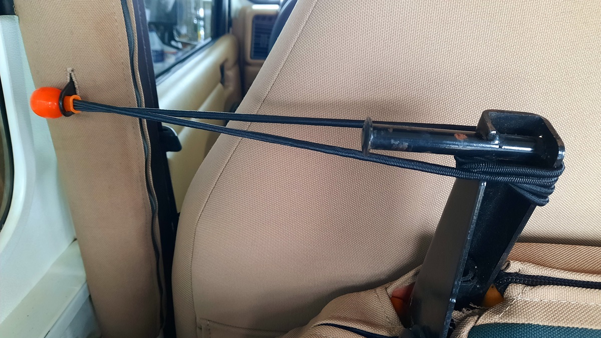

I came across a post about a rear seat retainer strap that came with the TJ to keep the rear seat from falling down when it was in the upright folded position.
https://wranglertjforum.com/threads/rear-seat-retainer-strap-is-so-worthless-that-it-is-rare.50383/

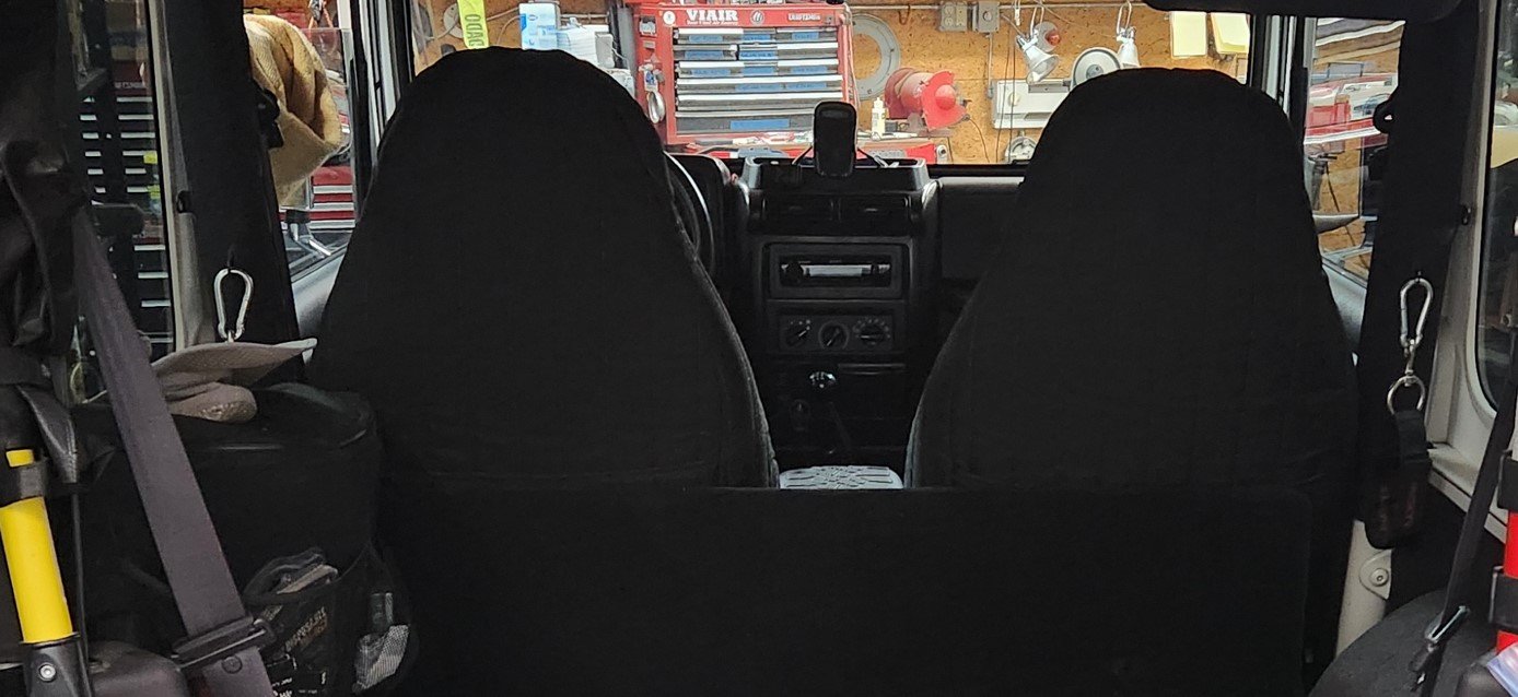

Since I bought my TJ used, it didn't come with the factory strap and I didn't even know it existed. I've been using a bungee cord to hold my seat upright when I needed extra space in the back.

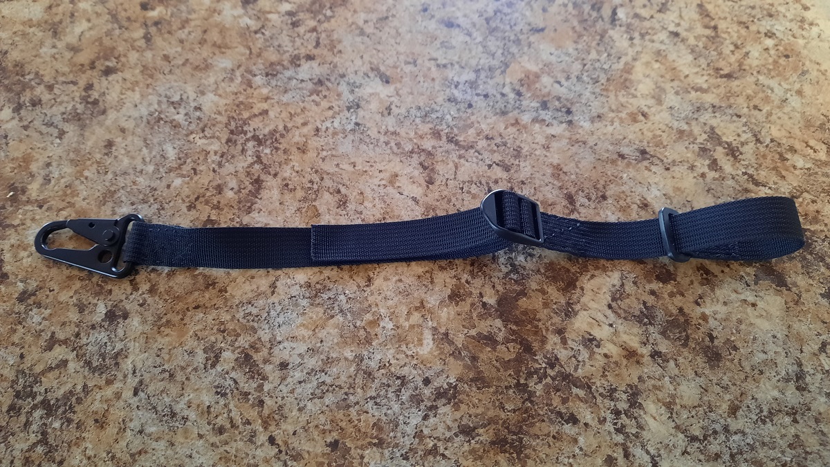

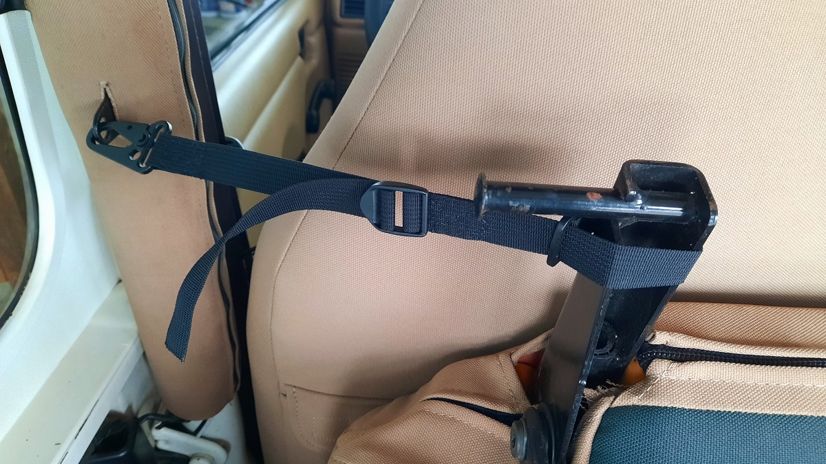

After reading the post about the factory strap, it got me to thinking I could make an improved version. I decided to make an adjustable strap so I could tighten it up and keep the seat from moving unlike the factory strap that wasn't adjustable or the bungee cord that would flex.
Here is what I came up with using parts I had on hand. I used 3/4" mil-spec nylon webbing, one 3/4" plastic loop, one 3/4" plastic strap adjuster and one 1" steel HK snap hook. I used three 3/4" tri-glide slides on the prototype so I could make adjustments but removed them and sewed the three ends when I had the lengths I wanted.
Now I can pull the strap as tight as I need it to keep the seat from moving when folded up. When not in use I can leave it hanging from the snap hook on the roll bar or just put it in the back corner of the hardtop next to the wiring connector. Works great, looks better than the bungee cord and holds the seat nice and tight.
Figured I would post it in case anyone wanted to make one for themself. If you have a soft top and can't use the bracket on the roll bar, you can substitute a plastic loop for the HK snap hook and wrap it around your roll bar so it'll tighten when you pull the strap tight or maybe a buckle for a quick attachment.

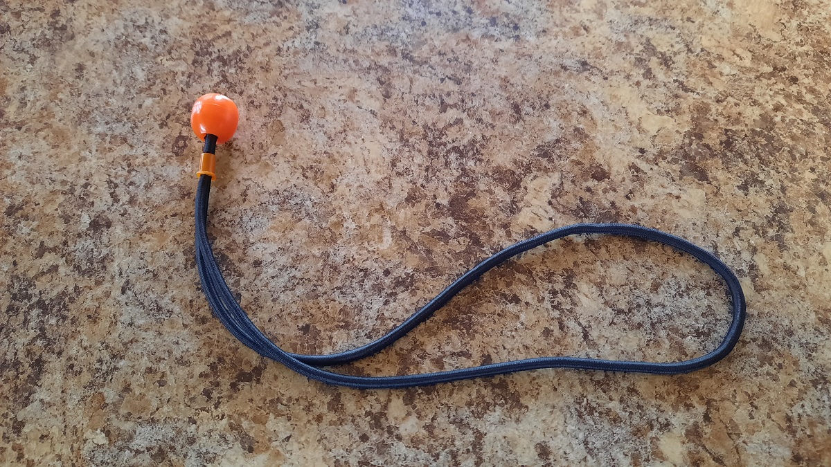

I always used a bungee strap and attached it to one soft top bracket and stretched it to the other side. Your method is actually pretty close to what the factory manual says to do.

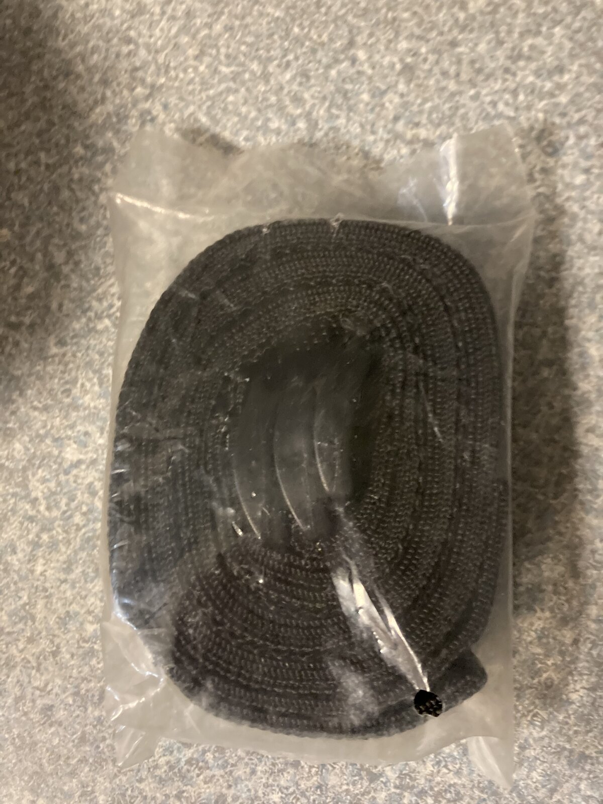

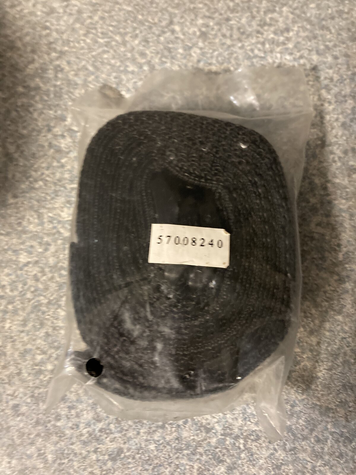

found this in the glove box when i bought my jeep a couple years ago. not sure if it’s a seat strap that this thread is about or not. nylon strap with plastic adjustable slides to take up slack. may not even be oem jeep. still sealed in bag.

Is there a link to this strap? Did you use one or two?

Just yesterday the nylon strap I use in the Jeep broke. The plastic buckle snapped into several pieces as I was tightening the strap. Had to use the strap like a rope and tie it in a knot.
If you can find a metal buckle it will last forever, but the plastic buckles like this don't hold up well. The Arizona summer heat kills anything made of plastic.

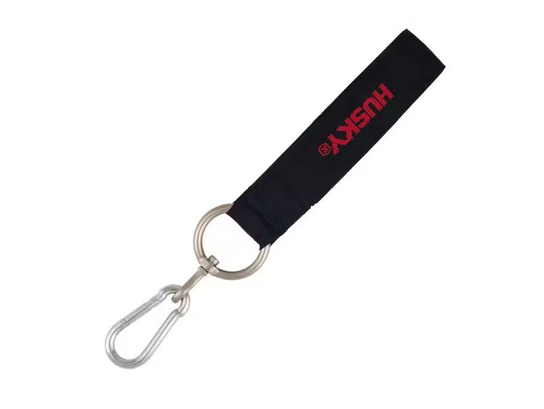

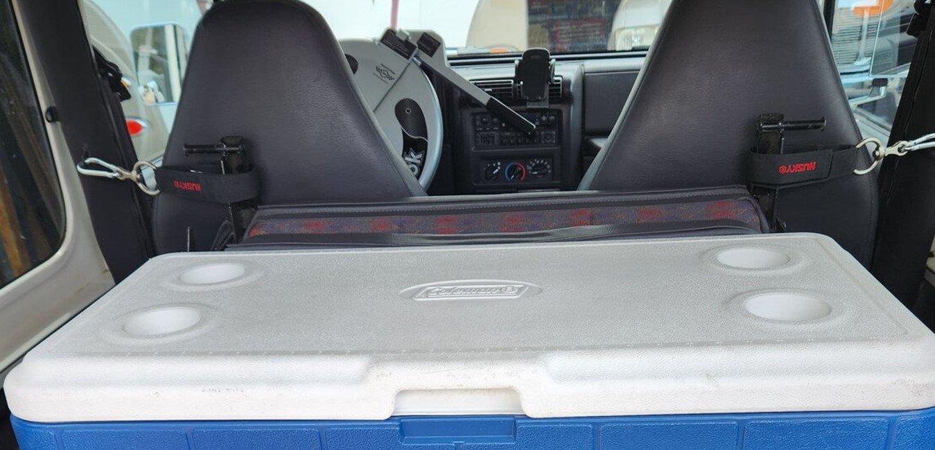

These work great and the loop size is instantly adjustable with Velcro, no sewing required. I'm using 2. When the back seat is out or in use they just hang there out of the way then when I want to fold it up it only takes a second to slip the loops on. The Velcro is so strong it never even thinks about loosening up. If I recall I put bigger carabiners on them as the ones they came with were too small to swing to a 90 degree angle from the attachment point. One would probably work fine but I had them anyway.
