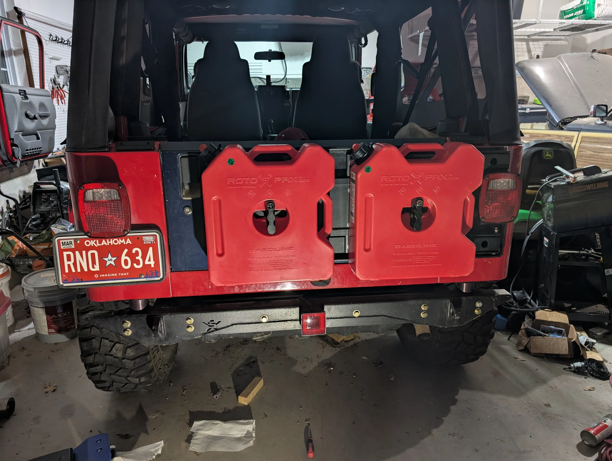

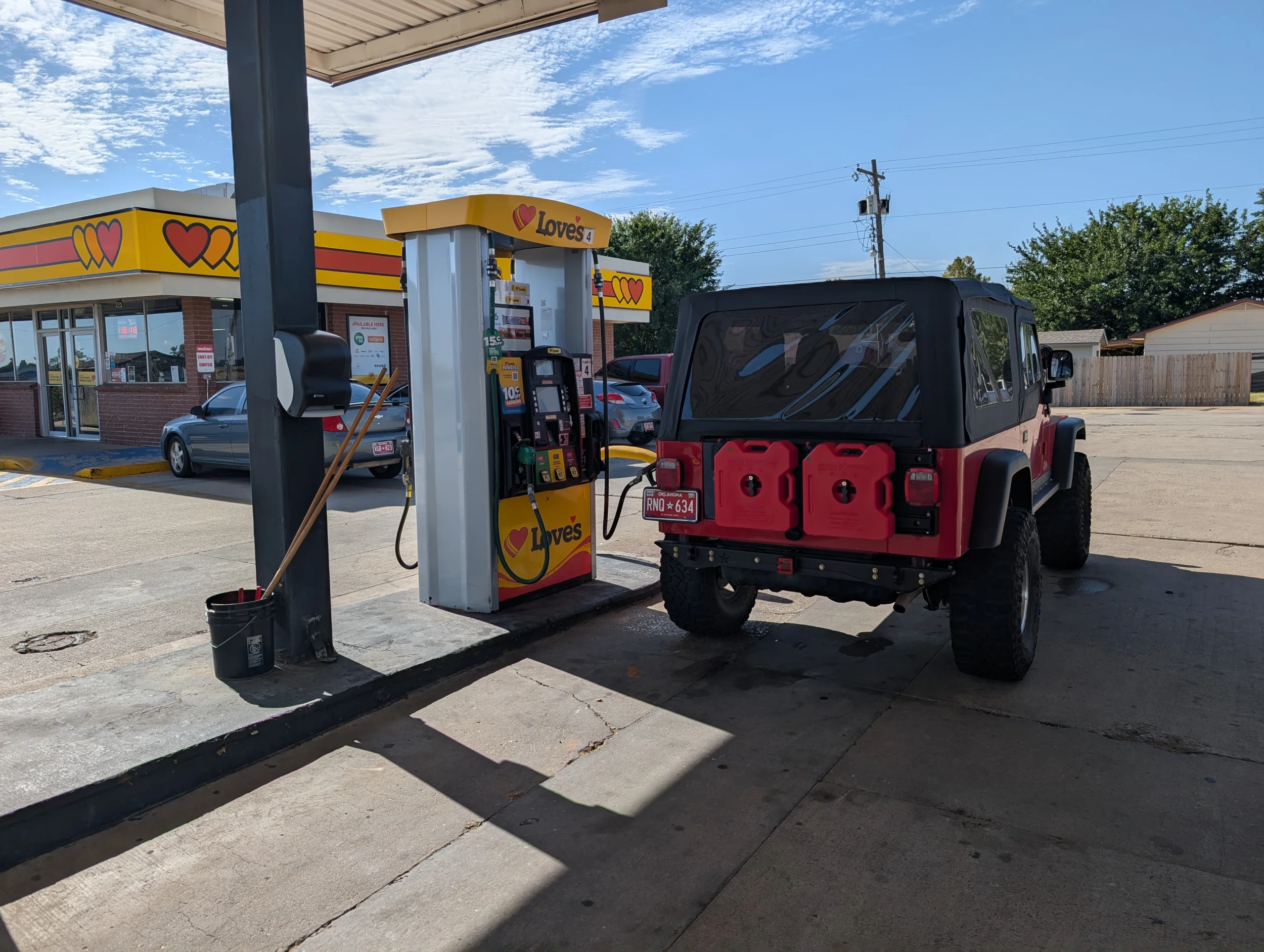

This years Colorado trip includes a 135 mile stretch between fuel stops so I'm gonna carry extra. Since I don't have a spare, the tailgate seems like a good place to carry it. Got a couple of 3 gal rotopax cans and rigging up a mount using the MORryde reinforcement.

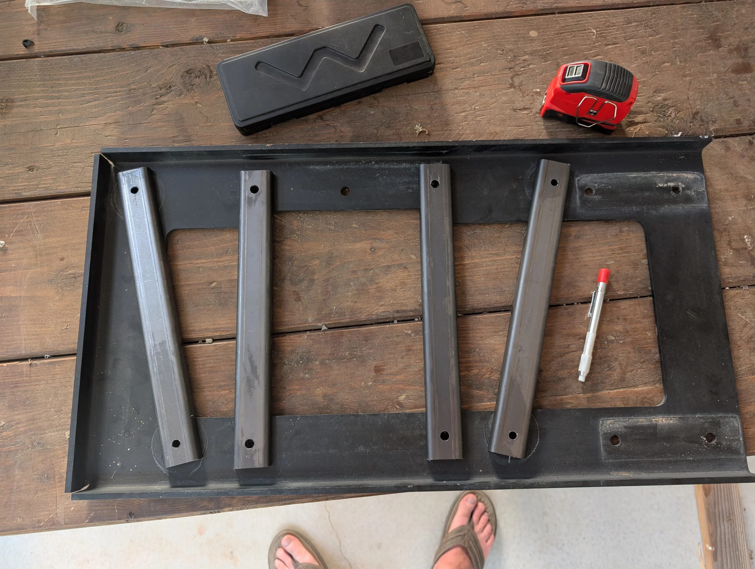

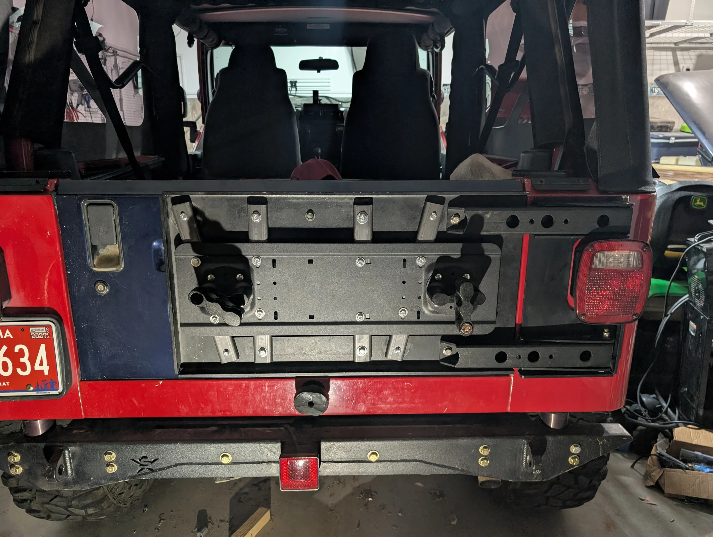

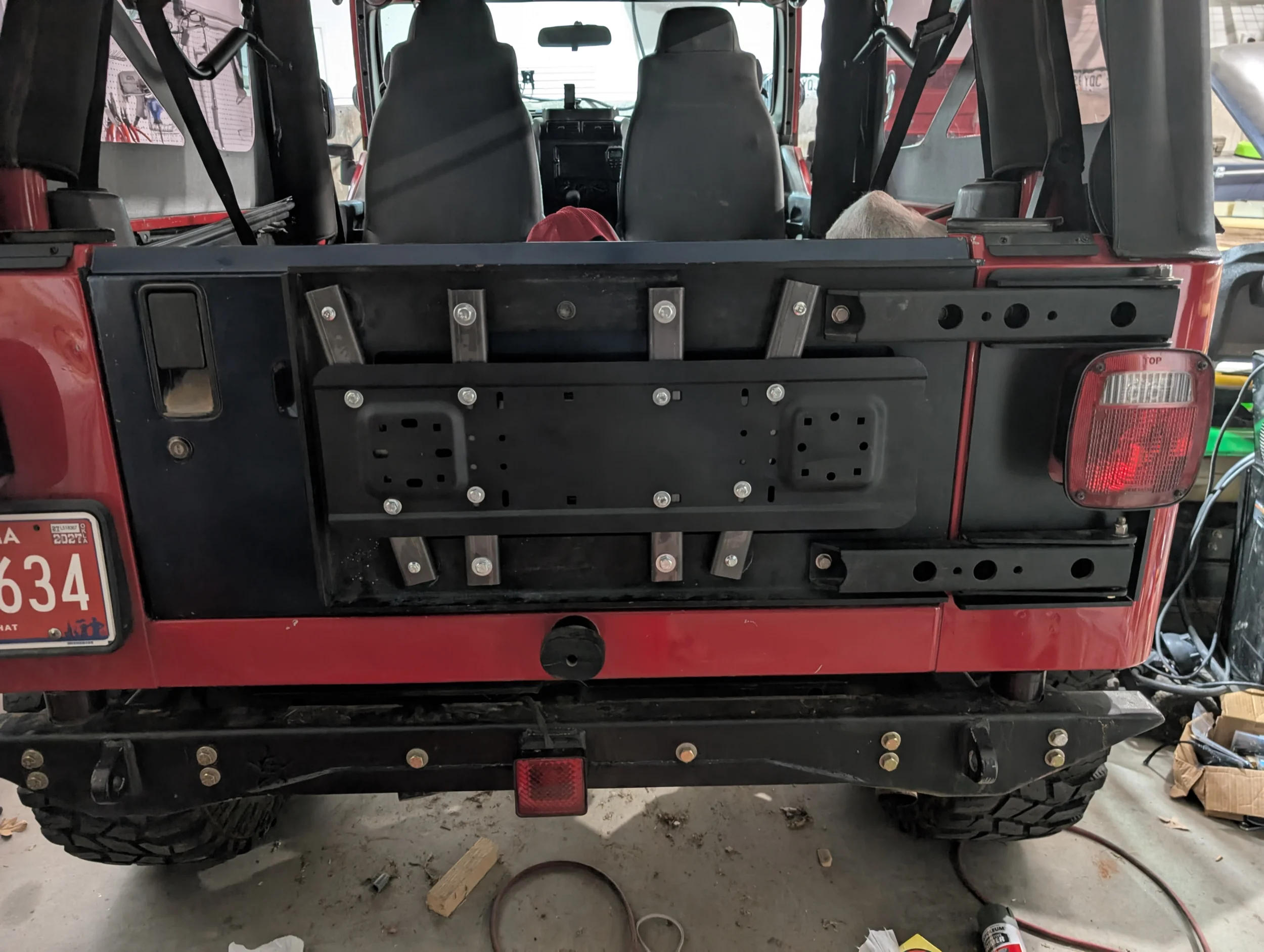

These 1.5" x .5" x 1/8" C channels will bridge between the upper and lower spare mount bolts and the upper and lower tire snubber bolts and provide structure for the RX-UP 2-can mount plate to attach to.
I realize there are bolt on options that utilize the spare tire mount but I want them as tucked as possible to minimize load on the tailgate as well as exposure to poor departure angle judgement.

This photo was taken seconds before realizing I had to take it back off to get the fasteners in. The bolts that hold the rotopax mounts to the long plate are carriage bolts and they have to point away from the tank.
What makes that tedious is that each of those mounting points to the tailgate has two washers and an oversized nut as spacers to keep from crushing the channel, and with bolts short enough not to hit the inside of the tailgate, it's a fiddly process to get it all back together.
The tailgate shuts like they're not even there and it doesn't rattle or move around. I'm not filling them up until my last fuel stop before hitting the long stretch, but it's 6 gallons so only 36 more pounds, a far cry from the 92lb spare I had there and tucked a lot tighter to the axis of the hinge and latch.

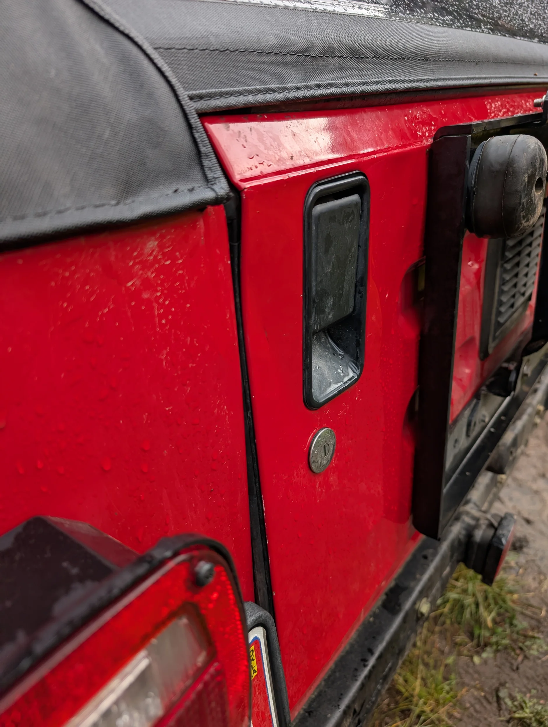

In general I also think the early tailgate is a better design. Not only does it not have the ugly ass vent but the latch cover is metal and bolts on, which helps contain any rattling from the latch mechanism.
