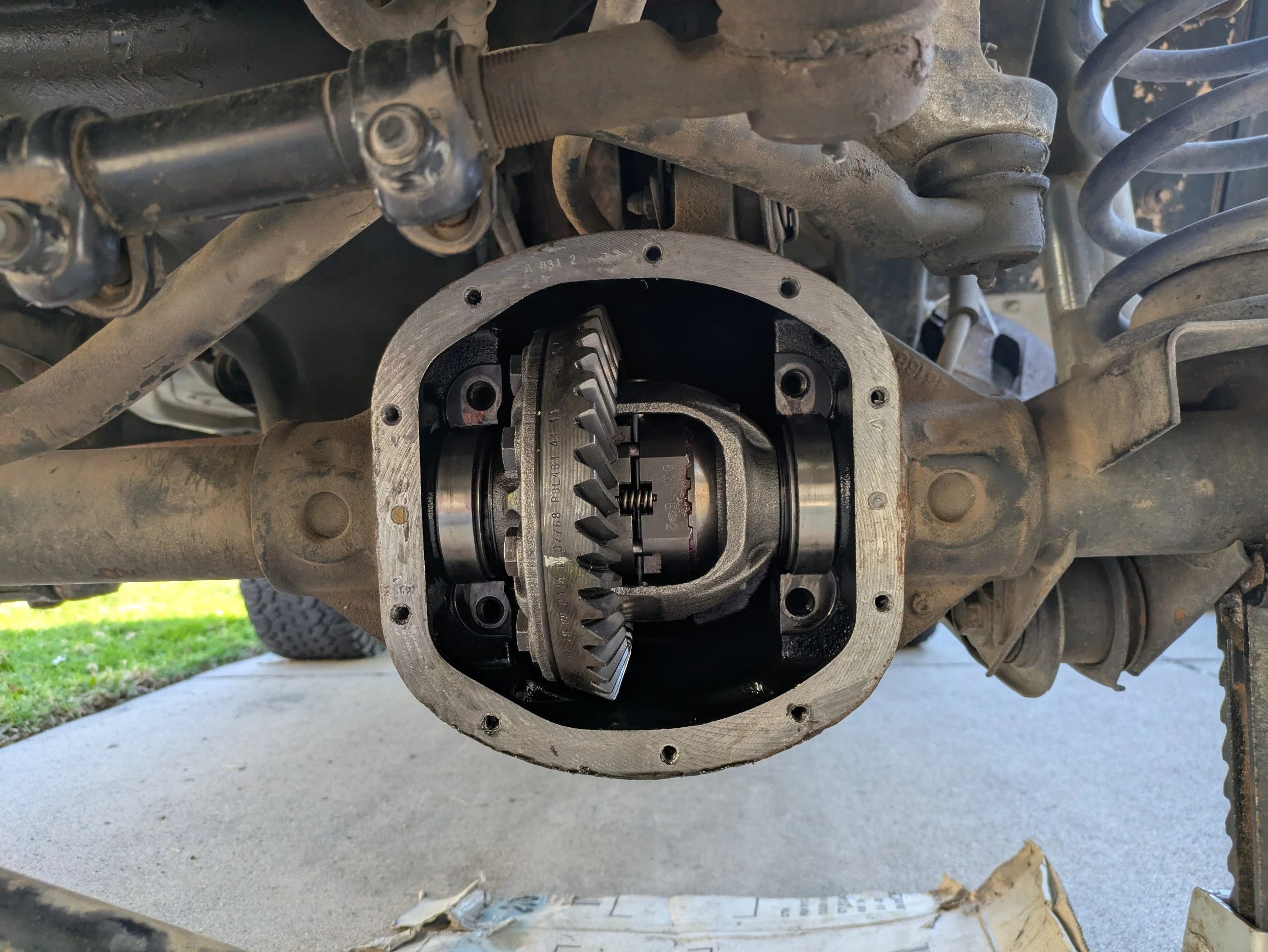

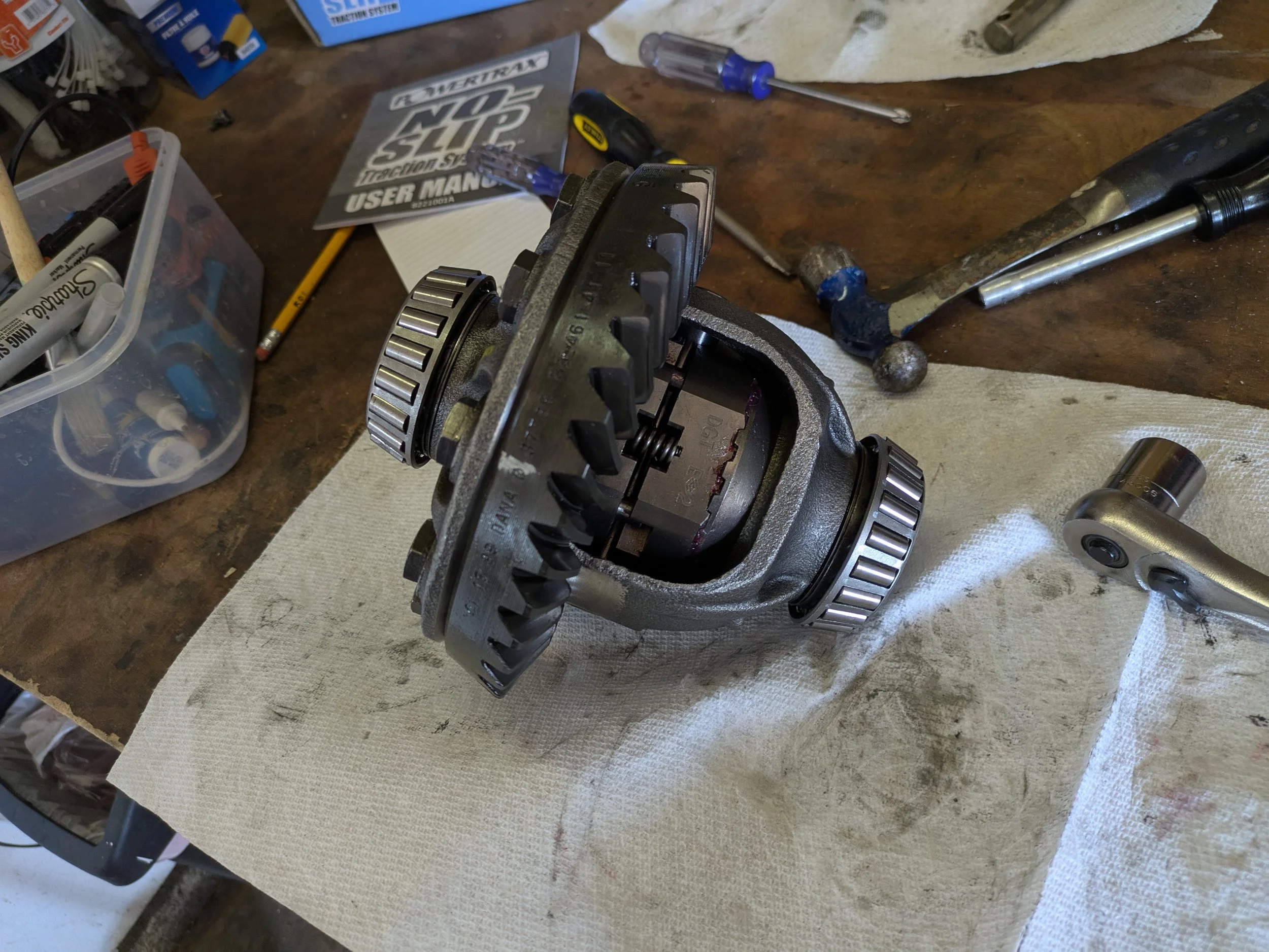

Got the locker installed in the carrier today. Ring gear back on, and got the carrier back in the axle without too much fuss. It basically slid in by hand with just a couple hammer taps to drive it in.
Got the bearing caps back on and closed up the diff.
Basically just need to reassemble the axles, hubs and brakes and test out the locker for engagement.

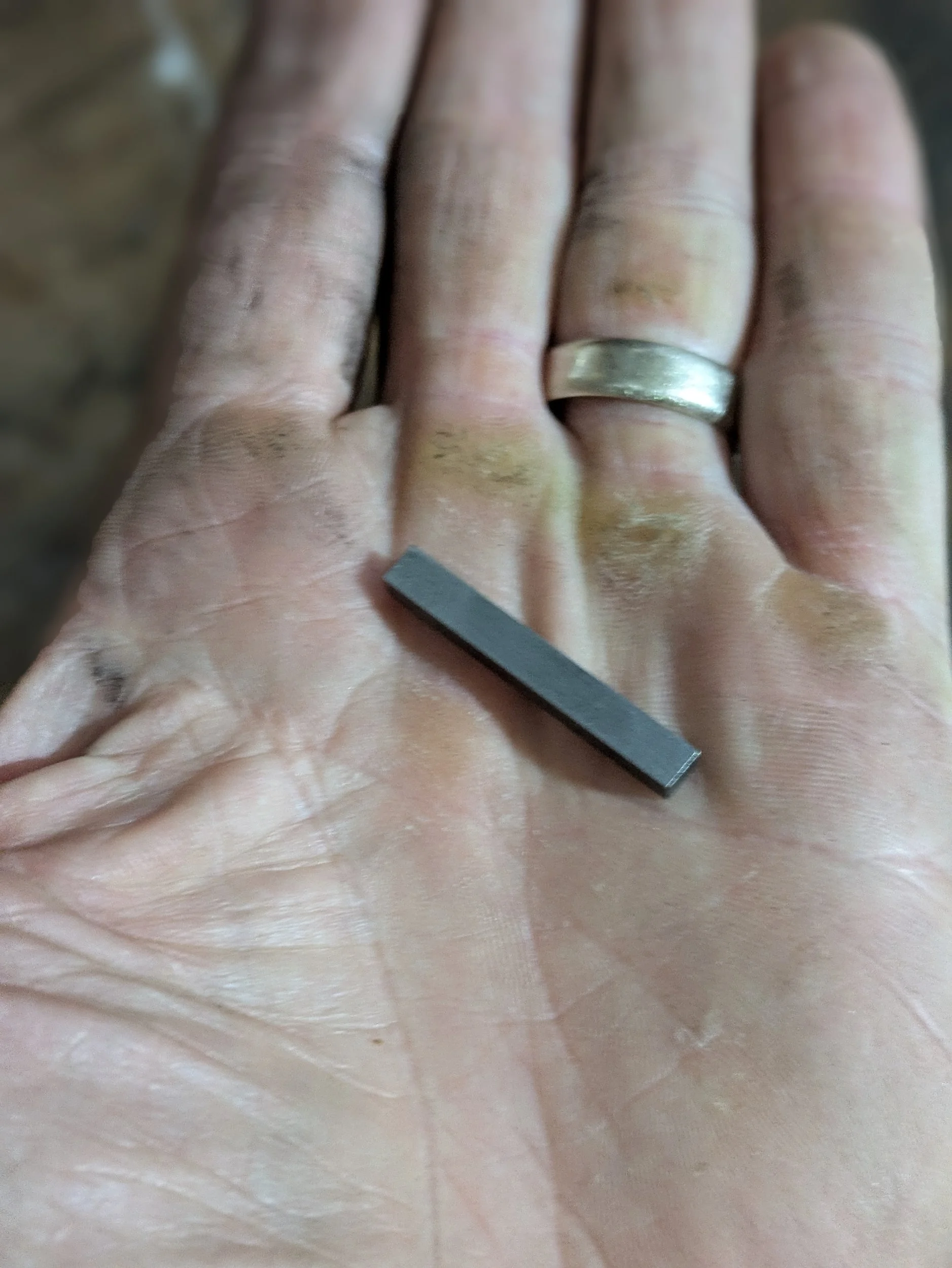

Did you do all the feeler-gauge checking between the cam gears? I think its funny, for the Aussie, you NEED to make sure you have the right tolerance between the cam gears. BUT if you don't, and it still passes the "spin test", it doesn't matter.
Yes, it came with a feeler gauge, tolerances were good.
I hate to say it because I'm not done yet, but it went pretty smoothly, other than having to grind for clearance.
Wow fancy I had to go buy my own feeler gauges!! It's not supposed to be hard so I'll be optimistic for you. It will make a huge difference offroad for you. Definitely one of the best things I ever did to improve offroad performance
It came with this. The gauge should not fit between the cam gears on the wider, but should fit on the narrow gauge.

Oh that's pretty nice I had to buy a set of gauges and then stack them up to get to the distance required.

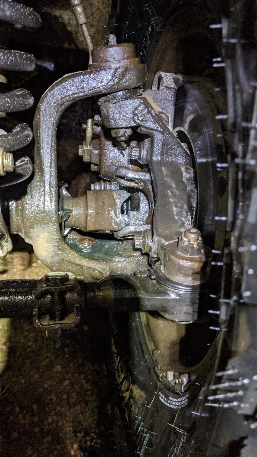

Well, if you get unlucky and it breaks, hopefully you do it in a lucky way like I did, I still drove home on the highway with this
I think its alot worse to break a shaft in the dana 35
I guess I broke the u-joint more than the axle. Same diff really
If all you broke was the shaft, that's pretty lucky, the axle had no where to walk out it looks like? Bet that sounded terrible going down the road though.
Just an FYI on feeler gauges check for front locker install. I did not have the gauges required so I used NUMBERED drill bits in the sizes recommended, go and no go method. Worked perfect. I would also suggest buying a housing spreader for install. I did not have one and it fought me all the way. Spreaders can be had for under $100 on Amazon.
