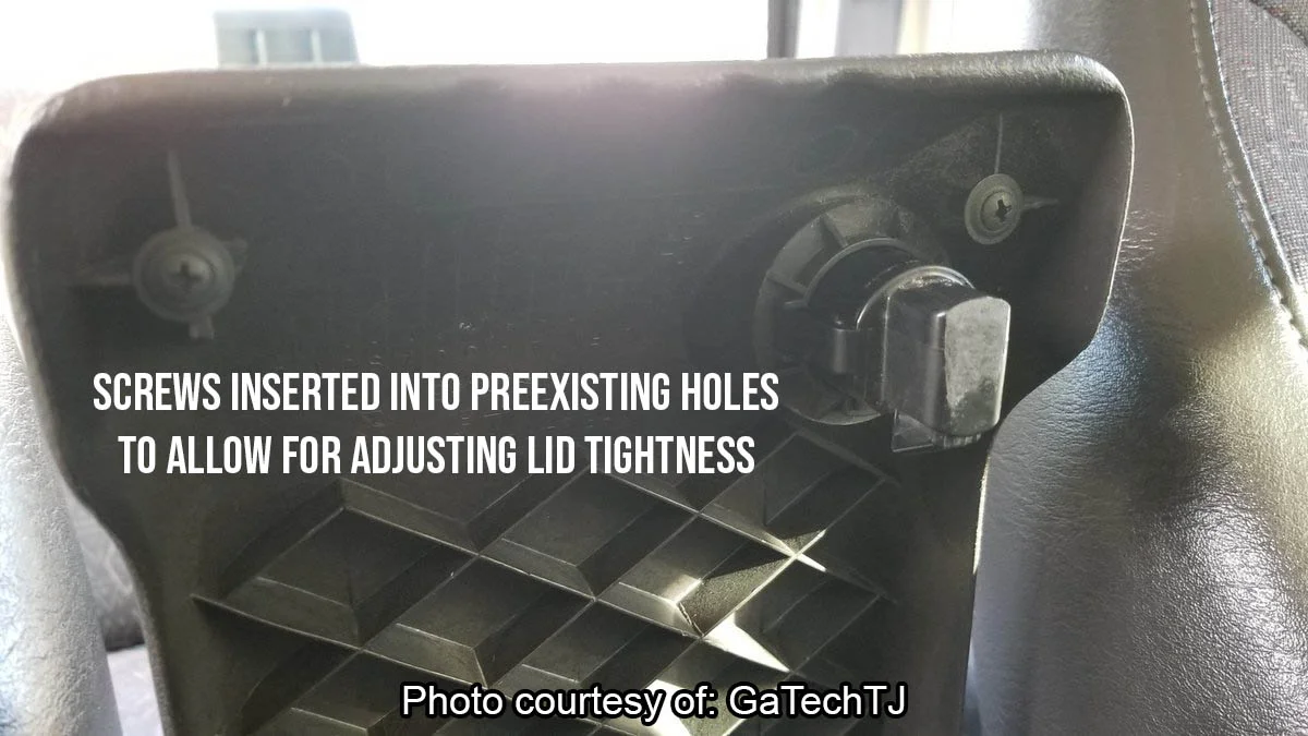

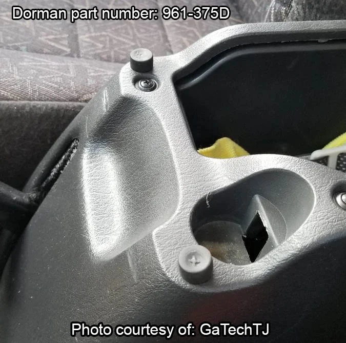

The first post now has a section for parts alternatives. I've got it so that it shows a reference page for pictures and details that are shared.
So, here's the first. Again, thanks to @GaTechTJ for the Dorman info.

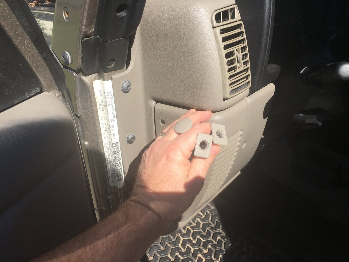

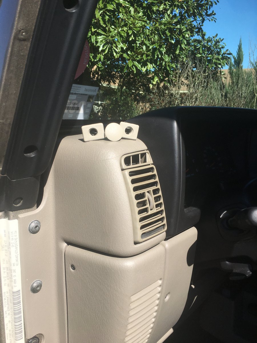

Before I knew of the Dorman part, I ordered a pack of button bumpers off of ebay. LINK
As you can see in the picture, the dimensions in the description aren't correct. They got the right numbers, they just used them wrong. The diameter of the narrowest point is 0.38", which makes it fit snugly into the 0.25" hole. The downside is their height. They aren't as tall as the OE bumpers. Their height isn't a problem, just personal preference. I may try GaTechTj's adjustment method at some point.
These are made up of dense rubber. Far more dense than the original that I took out.

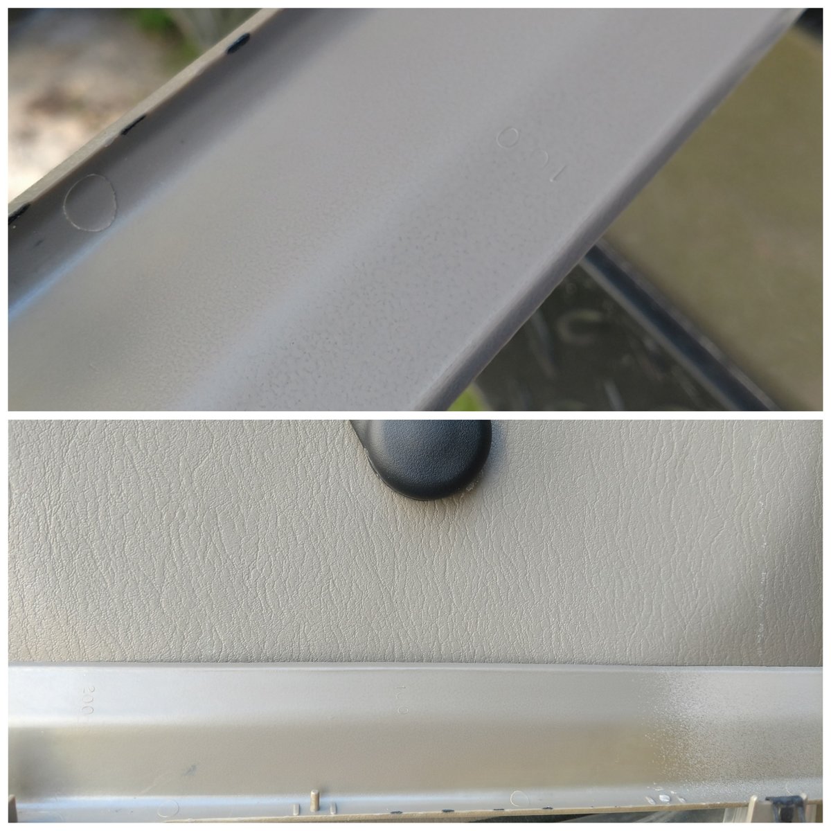

Just for the sake of trying, I sprayed a small section of the top side of it that drops down behind the firewall. It did look a little better, but still a really big difference.

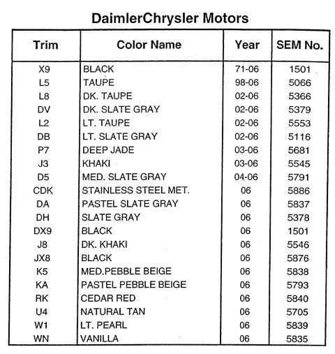

I got some helpful info yesterday. I got back in touch with them at SEM Products. I was initially referred to the 15833, but I showed the results that I had with the 15833, so he went back in to research it. He came back and told me that the 15833 was in fact a lighter shade that was used in 2008, and then told me that our color needs to be mixed. The color for that is shown in the "Trim Codes Formulas" on their resource page that I sent a link to.
Here's the one showing our khaki (PN: 5545):

The middle section of that bottom picture is the 5545 and the lighter part on the right is the 15833?
That's right. I just flipped the trim piece again, and sprayed the 5545 off to the left this time. Even to the naked eye, it's difficult to see where it was sprayed. I took the close-up picture to try showing where it was sprayed. In that picture you can see the color of the plastic and the 5545 side-by-side.
