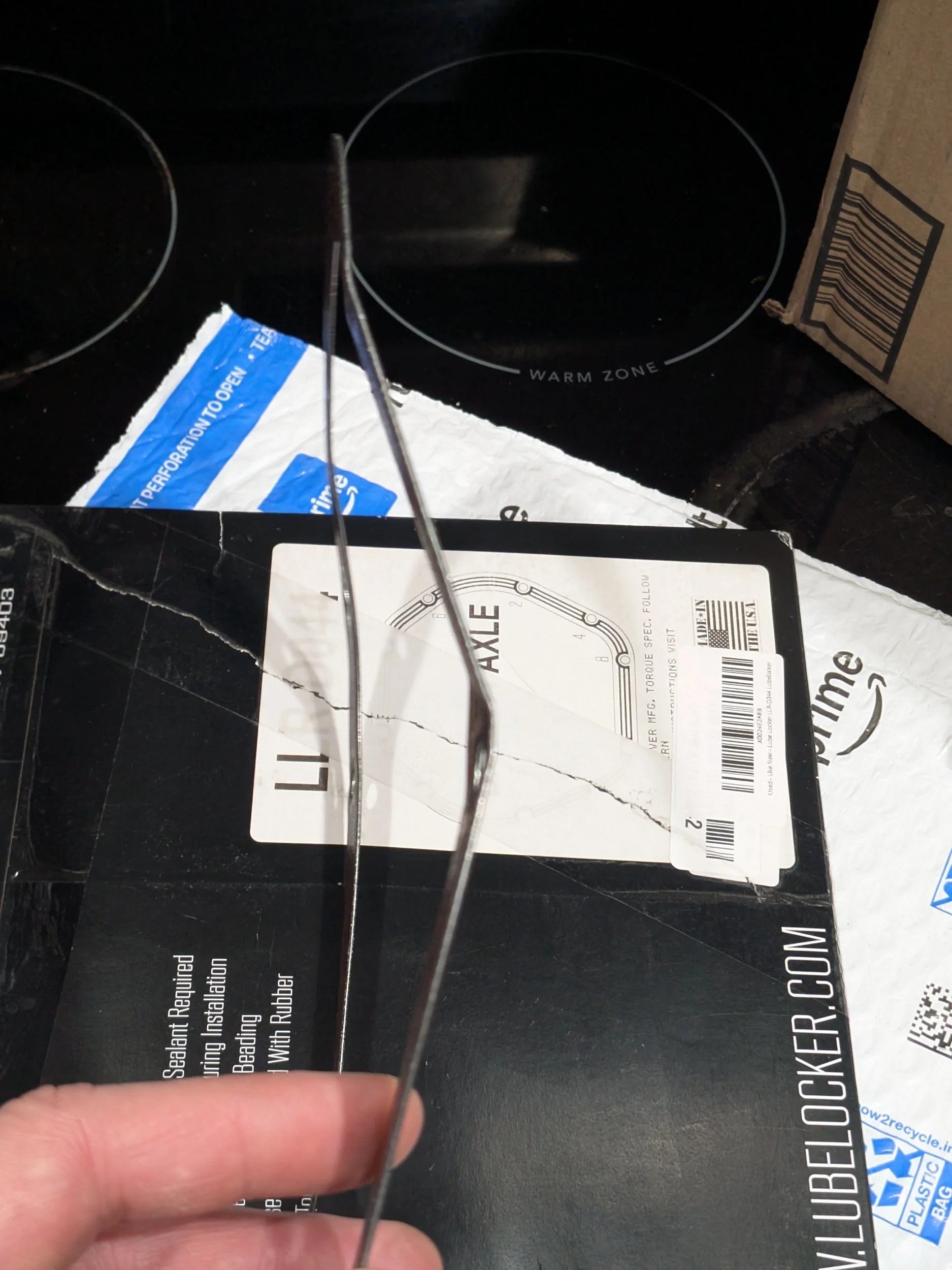

Is a bend like this still usable or is this trash?
I'm changing my differential fluid this weekend for first time on my 2004 Jeep Rubicon. Is the Lube Locker gasket ok? Also, the gear oil is GL-5?

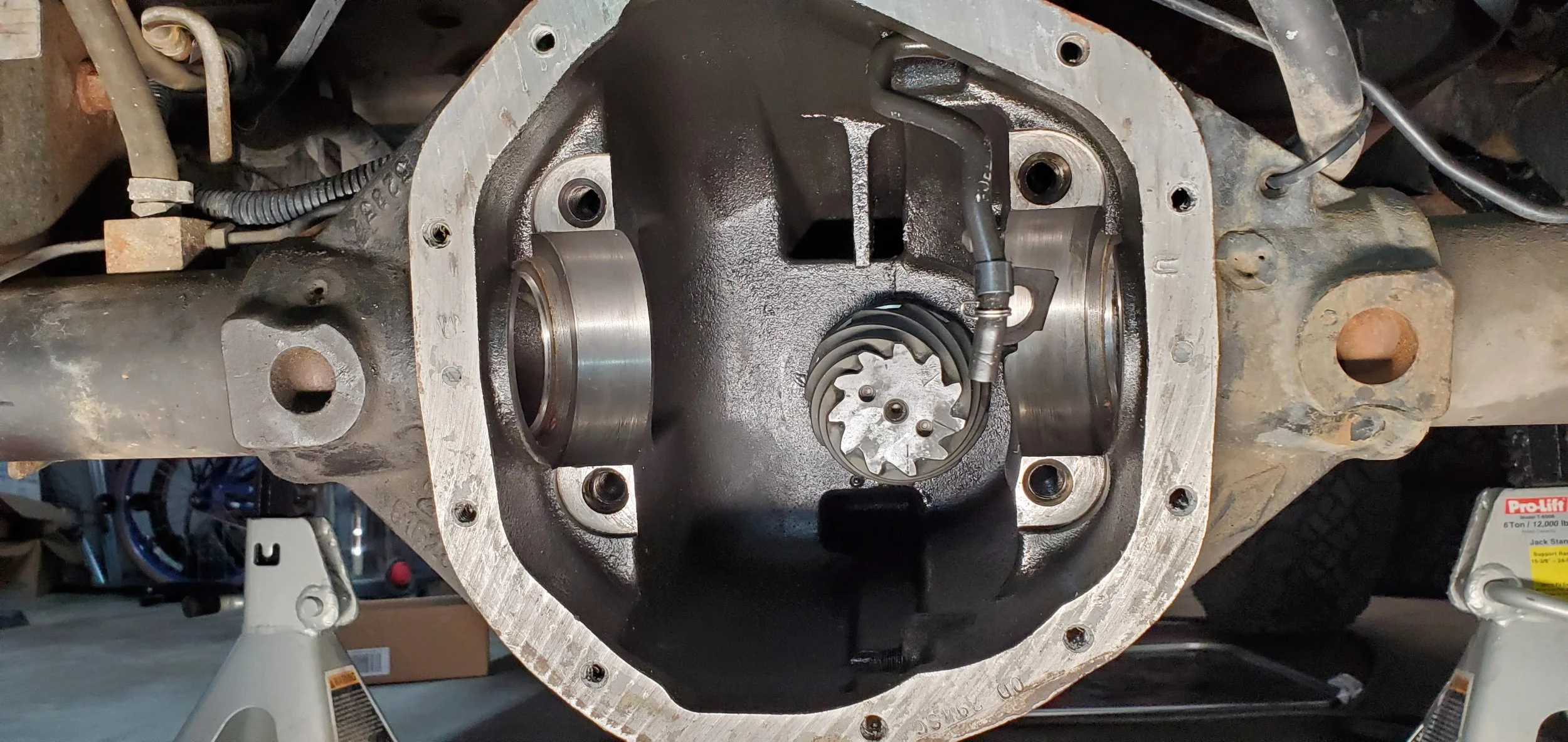

I have a Rubicon and I don't see a drain plug on either end. I'm not the original owner though so someone might have changed the covers in the 15 years I didn't own it.
Its on the side of the main differential housing on the right side. Not the cover. The cover has a fill plug.

Look straight below the pinion in this photo and you can see the threads for the drain plug coming in from the right side.
I guess I've only ever seen pictures of aftermarket covers with drain plugs on them.
