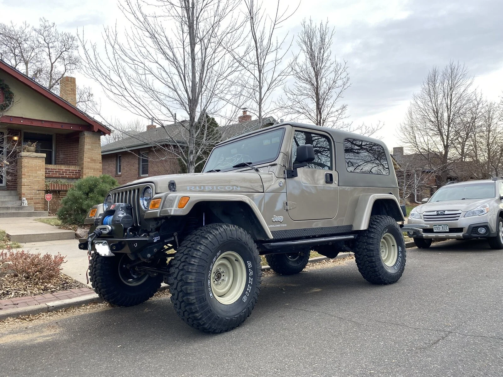

Is This Angle Normal for a Drag Link End? Chasing Death Wobble
Should I put some lock tight on the flag but to keep it from backing out?

Loctite should not be needed. Was the play in the joint or was the bolt moving?
It seemed like the track bar was able shift slightly back and forth (side to side) and I think I could see the flag nut moving back and forth ever so slightly. I need to check torque on it again. I’ll look again tonight and take a video.

When I install the new wheels and tires I will make sure to follow this procedure. I did something similar with my old setup. Thank you.
Re checked torque on axle side of trackbar its still at 75 ft pounds. Maybe its just the joint thats moving? Look at lower right of the joint:
There is play in the upper control arm bushing as stated earlier, these will be replaced with johnny joints:
Tie rod end seems normal to me:
I found out first hand if you have play in the front right upper at the axle it sure will have death wobble- a track bar needs to have good connections - check this out -see the dark ring around this axle end track bar bushing ? This clevite has 9/16-14mm bolt and no hole elongation or improper torque, the movement is being allowed because this manufacturer puts cheap bushings in an otherwise stout bar-
Why was looking at it ? Because I could feel it when I drive it - it creates a need to push against road crown, steering wheel shakes a tad on bumps, a slight bump steer and the need to micro correct a little too much - because the axle moving steers for you.
Wanted to update this thread. As of now my death wobble is gone. I think it's a combination of the upper control arm Johnny joints I installed on the Dana 44 (the rubber ones were allowing movement) and the new wheels and tires. The shop that mounted them said the steelies were out of spec but they got them super close. Nice having a 4x4 shop mount and balance as they know how to deal with big tires. Hoping the death wobble stays away but I have done 150 miles on the highway with bumps and nothing.
