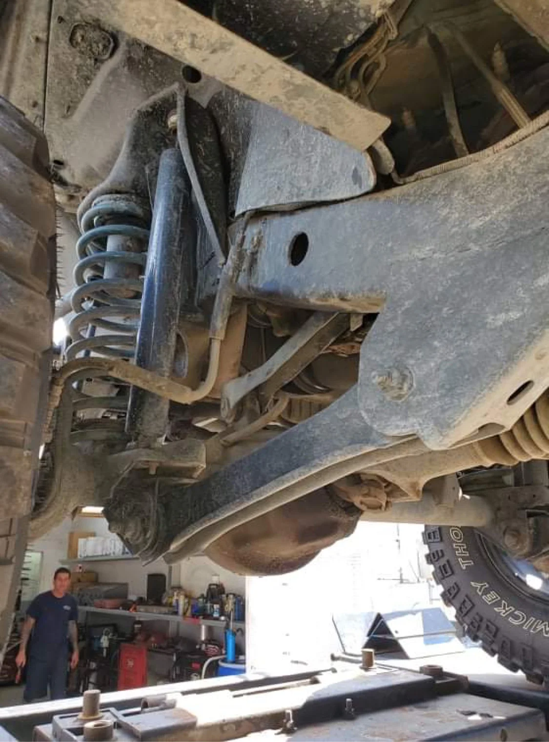

I tapped on the center side by the skid plate and a piece of rust fell down but the seller said it was from the undercoat under the frame. He recently lifted the jeep and the mechanic said when the Jeep was lifted that the metal guard under the frame has to be dropped down away from the frame. Thus exposing 20 years worth of muck undercoat etc.

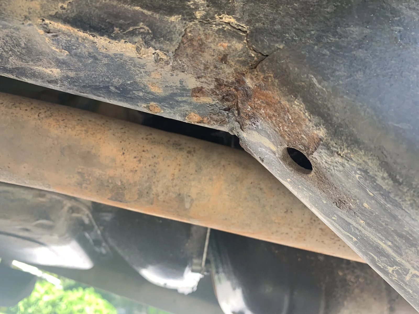

Pass for me but I'm on the west coast and am a rust snob..the east coast and Midwest guys will be along shortly to tell you how nice it is..in the end are you comfortable with rust? The one pic shows heavy corrosion right in front of the lower control arm mount..that is where these frames like to rust

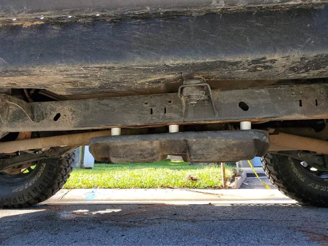

Yes... the rust you see on the outside of the frame is from when the skid plate was bolted directly to the frame without spacers for the lift. Water gets between there and it corrodes, but usually it's just surface rust. And the rust you see on the ends of the frame are probably from a hitch that was subsequently removed. If it's just surface rust, it can be cleaned up and painted with POR-15. But definitely check inside the frame to confirm.

Not sure what you are trying to say—looks like water got behind the undercoating and is starting to corrode it. Look at how thick the metal is in that hole: clearly it's not rotting. This needs to be cleaned up certainly, and he should confirm the inside of the frame is OK—who knows, maybe it's not—but once again that does not scream to me "frame rot!" purely judging by exterior.
Yes, there are west coast snobs who run away from any hint of rust and east coast naifs who see a frame rotting in half and send it, but you can take a rational look at this frame and say, it's not perfect, but with a little bit of work it's probably fine.

It doesn't matter how thick the metal is where that hole is on the bracket, what matters is how thick the metal is on the frame rail where I circled.
Sure, and the only way we'll find out is if he takes a borescope to the inside of the frame. Arguing about the exterior condition is pointless.
It doesn't matter how thick the metal is where that hole is on the bracket, what matters is how thick the metal is on the frame rail where I circled.View attachment 283176

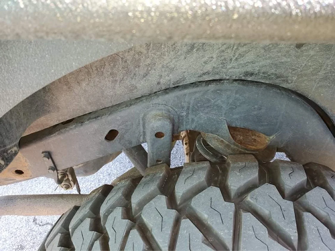

Most frames don’t even have undercoating and you can see the factory welds where the bracket was welded on.

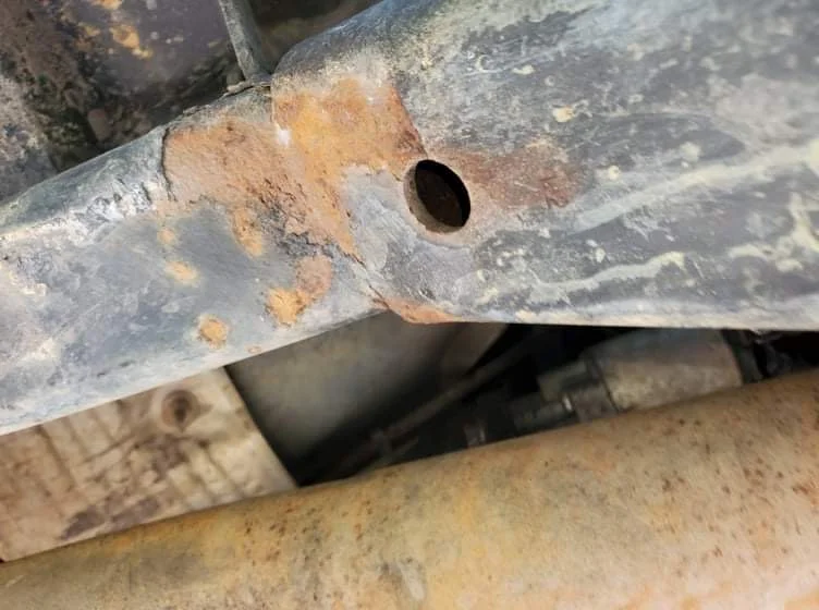

The seller just sent me this. He took a hammer to that concerned area and brushed it with a wire brush. He said just the outside coating is coming off and that the inside of the frame is smooth to the touch.
