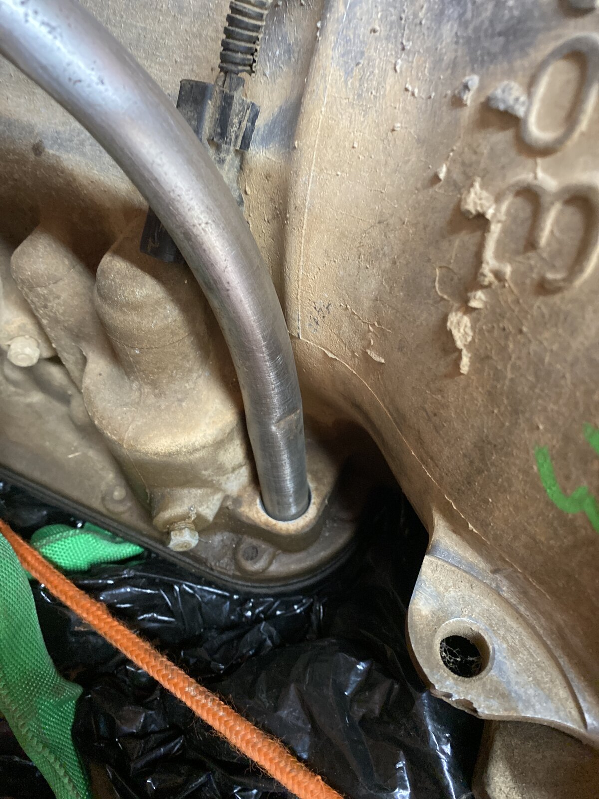

Here’s my dip stick for my 32RH swap. Can you tell if it’s the correct one for a 2002 32RH trans ?
OP
Eddie Greenlee
Eddie Greenlee
Mar 5, 2016
2,584
Mississippi

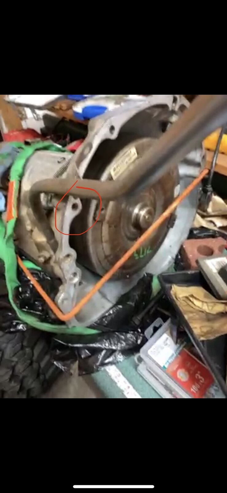

Stick the dipstick tube in the hole on the side of the transmission. Swing it around until the mounting tab lines up with the bolt in the bellhousing. No other dipstick tube will line up.

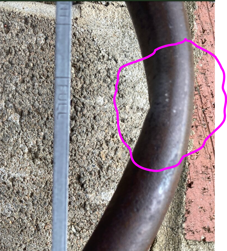

I saw that too . Guess I’ll try and get a refund and look for another. Good luck to me ha
Take a hammer and gently tap on the sides of the kink while trying to tweak it back to where it used to be. That should help the bracket line up with the bolt hole. The kink is just affecting fitment maybe and it won't affect how the mess works if you can get it bolted up.
Thanks I’ll try that

Even if you get it to mount you don’t know if the stick reads the correct fluid level if it’s not from a 32rh.
That part can be figured out. All we have to do is mark the tube where it enters the trans and then measure how much the dipstick sticks past the end of the tube. That will get it more than close enough to keep the trans working well.
