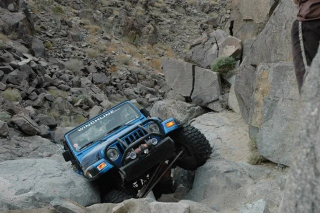

Don't misinterpret. They didn't give up without a fight. They pushed the grill over and the fan hit the shroud. The corner of the grill was caved in a bit. He is a member on here. I may point him here and get his version.
This is the trail, this is not the hard spot.
Reactions: JMT
Why would any TJ owner think that he/she could run a trail like that and not receive a significant amount of damage if not properly equipped to do so?

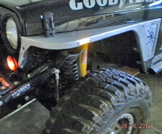

Aluminum Defender Zero which is flush with the body. I don't think they make them any more.
They don't. They quit production rather than solve a simple design issue and add a small brace behind the welded joint at the outer channel. The fenders cracked at the welds and rather than fix the problem, they discontinued the product.
According to them, they were also built out of 6061, but they never answered my question on how they managed to bend such a tight corner in that material. Conclusion: they couldn't have been T6 and bent, so they had to be either welded or not-T6. That was shortly before they started disappearing. Come to think of it, they didn't answer any of the questions I had about that fender... :unsure:
I wonder how common the cracks really are in the PSC aluminum Defenders. After noticing my post-impact wrinkled tub & a few small gouges in the front of mine I looked for a crack but they're still fine. I knew they had been discontinued a few years ago but wasn't sure if maybe they had that design flaw fixed by now. At any rate mine are still crack-free.
Well, they actually are out of 6061 T6 and that channel isn't bent. It is welded out of 3 pieces and then ground to the radii on all those corners. Stupid way to make that and no doubt something to do with the elimination of the product.
I had originally asked them if the material was press-formed and then tempered to T6, and all I got back was: "We do not do temper press forming. It is not needed on the way we manufacture them." Technically true, I guess...
And again, it is understanding the material and how to manufacture items out of it. By the time they got through with all the welding, it was no longer tempered and had similar strength to one of the grades that could be bent to make the channel. They spent a lot of time and money making a product out of a material that wasn't suitable for the method they used to manufacture it. And, that lead to a problem that caused the failures in the form of cracks at the welds.
That's why I was concerned: if it was welded and ground there was no way that the corner was still tempered after all that heat was applied, so the most important part of the structure was...well, absent. And I just didn't get a warm and fuzzy feeling when asking them those questions...so I eventually started looking towards GenRight, who also don't give me warm and/or fuzzy feelings. They give me flap-wheely feelings, but that's a story for another time, when I will get to prove how good I am at sniveling.
