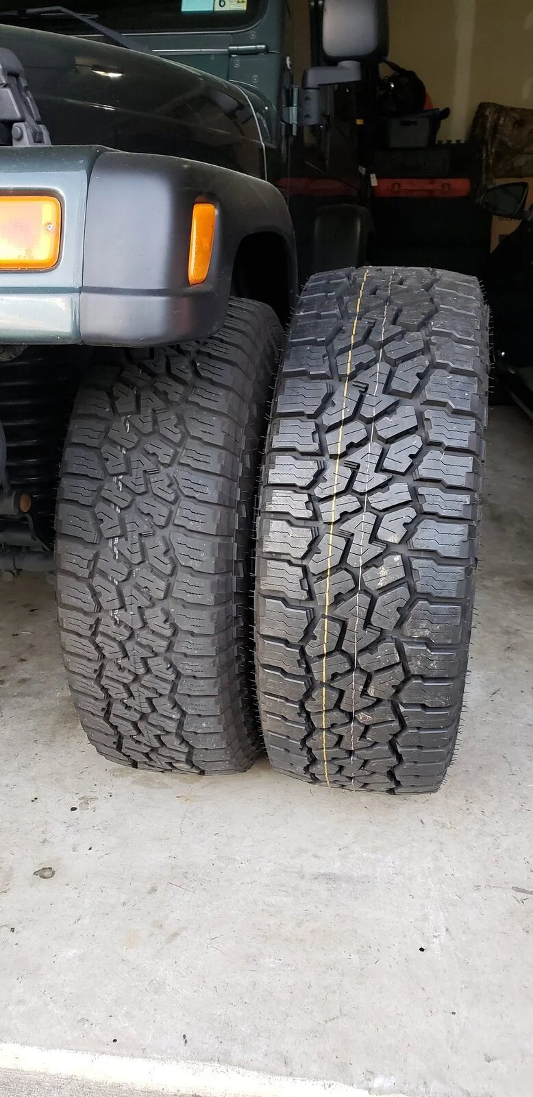

Picked up a gently used set of "take of" 5 JT tires for $400. They are the optional upgrade for JL and JT Jeeps, Falken WildPeak AT3, and are 285/70R17. These are "C" rated, have 14/32 tread left (new was 18/32), and had no plugs. The LJ currently has Falken ATSs, but in a smaller 265/75R16.
SIZE
UTQG
Tire Weight​
LT285/70R17
116/113Q C
None​
2,755 lbs​
50 psi​
18/32"​
63 lbs​
7.5-9"​
8.5"​
11.1"​
9.6"​
32.8"​
634​

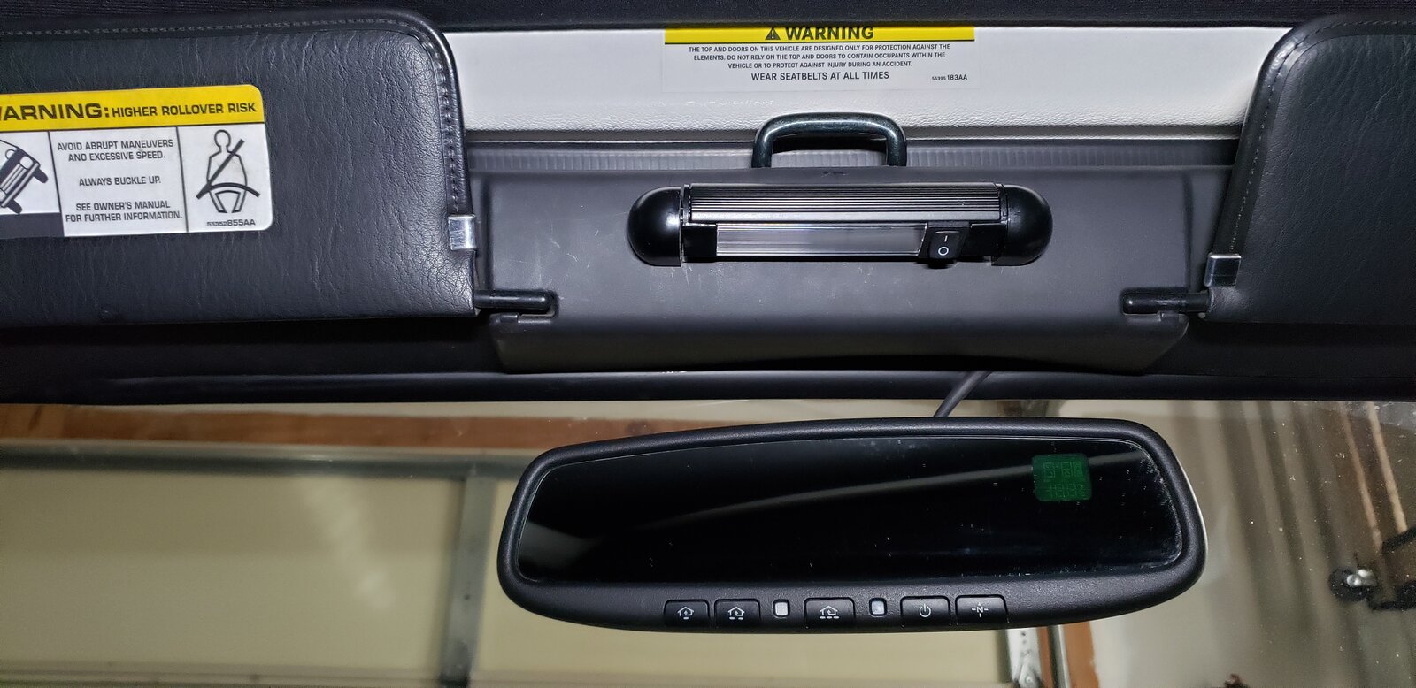

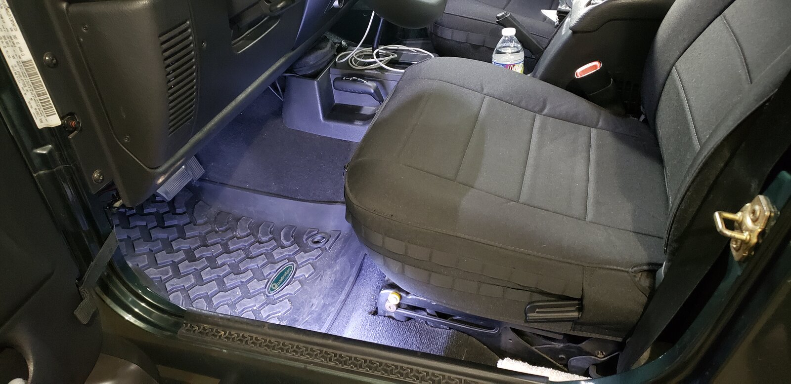

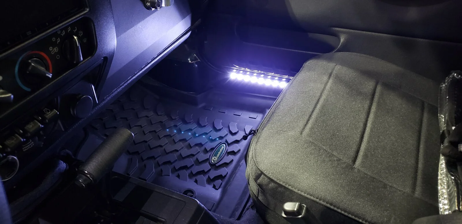

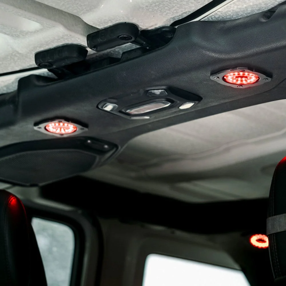

I've been wanting to install additional lighting inside the Jeep. The specific two places I wanted to augment are better overhead lighting up front and increased foot well lighting. However, the search has been frustrating, because I couldn't find an option that looks like it came from the factory. After weeks of searching, I finally found two products that fit very nicely.

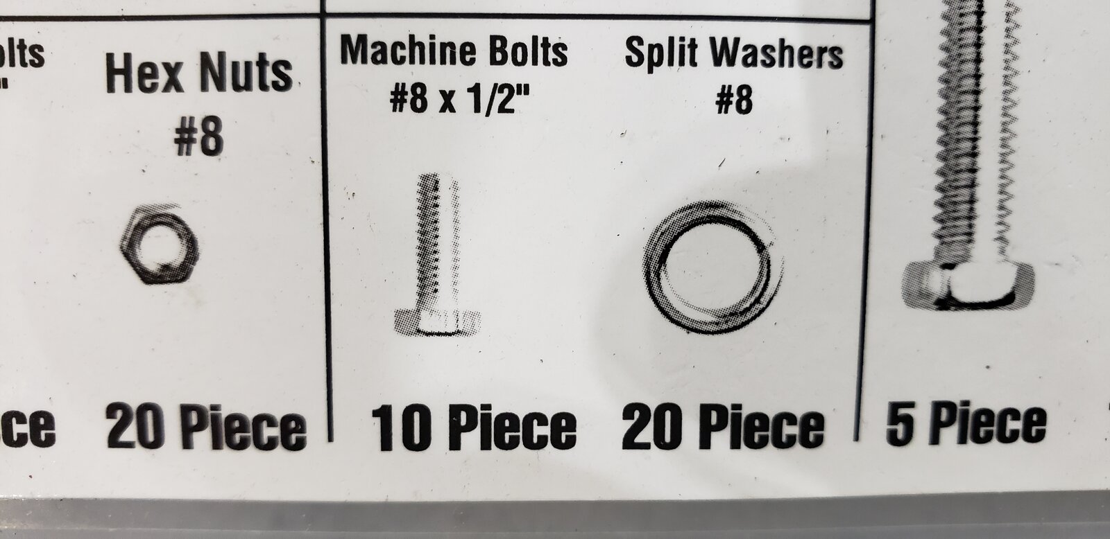

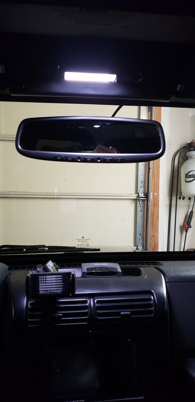

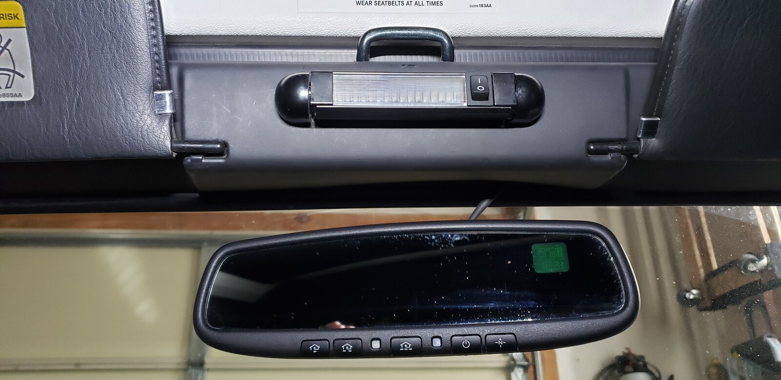

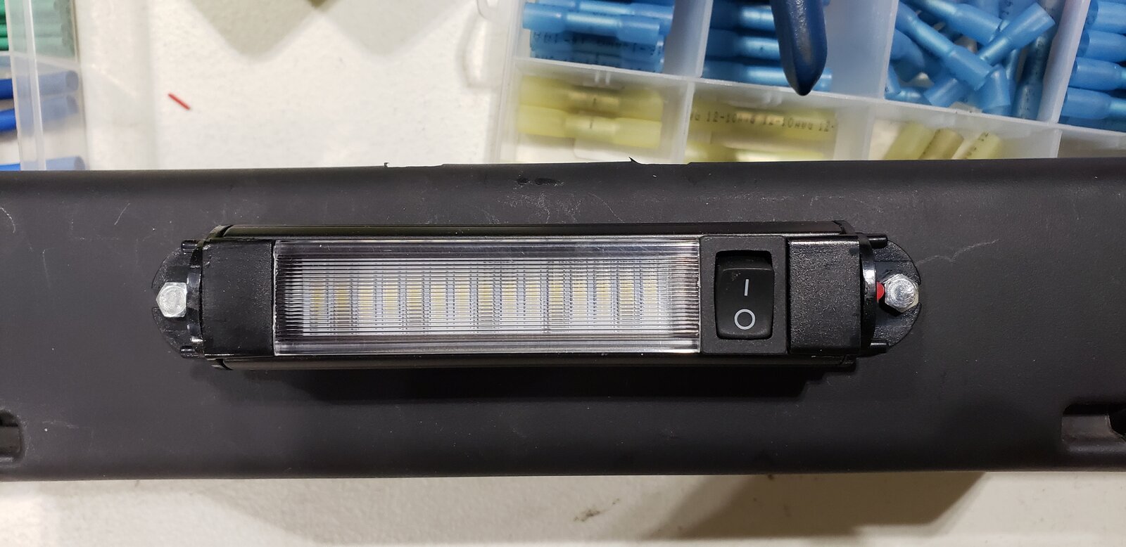

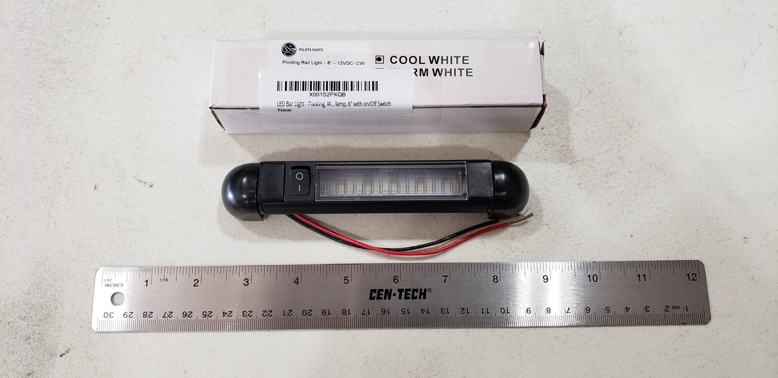

This first one is small enough to fit perfectly in the plastic cover above the rear view mirror. You do have to drill three small holes, so you can bolt the light down and feed the wire through. The light comes with small screws, but these won't work. I replaced those with a #8 1/2" machine bolt, lock washer, and nut.
https://www.amazon.com/dp/B0051BSFY6/?tag=wranglerorg-20

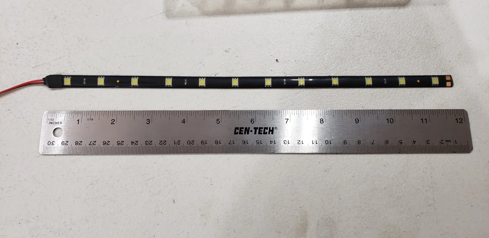

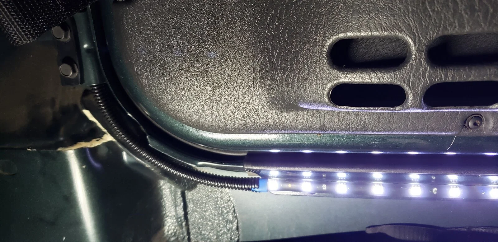

The second one is 1" LED strip that happens to fit perfectly at the top of the rocker. There is a small metal strip that runs across the top of the rocker, so I cleaned it with alcohol and then stuck the LED light strip to it, using the double sided tape that comes with the light.
https://www.amazon.com/dp/B01N4OPLUF/?tag=wranglerorg-20

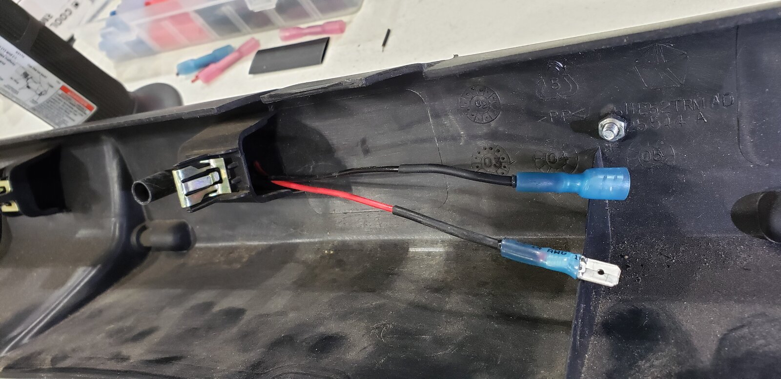

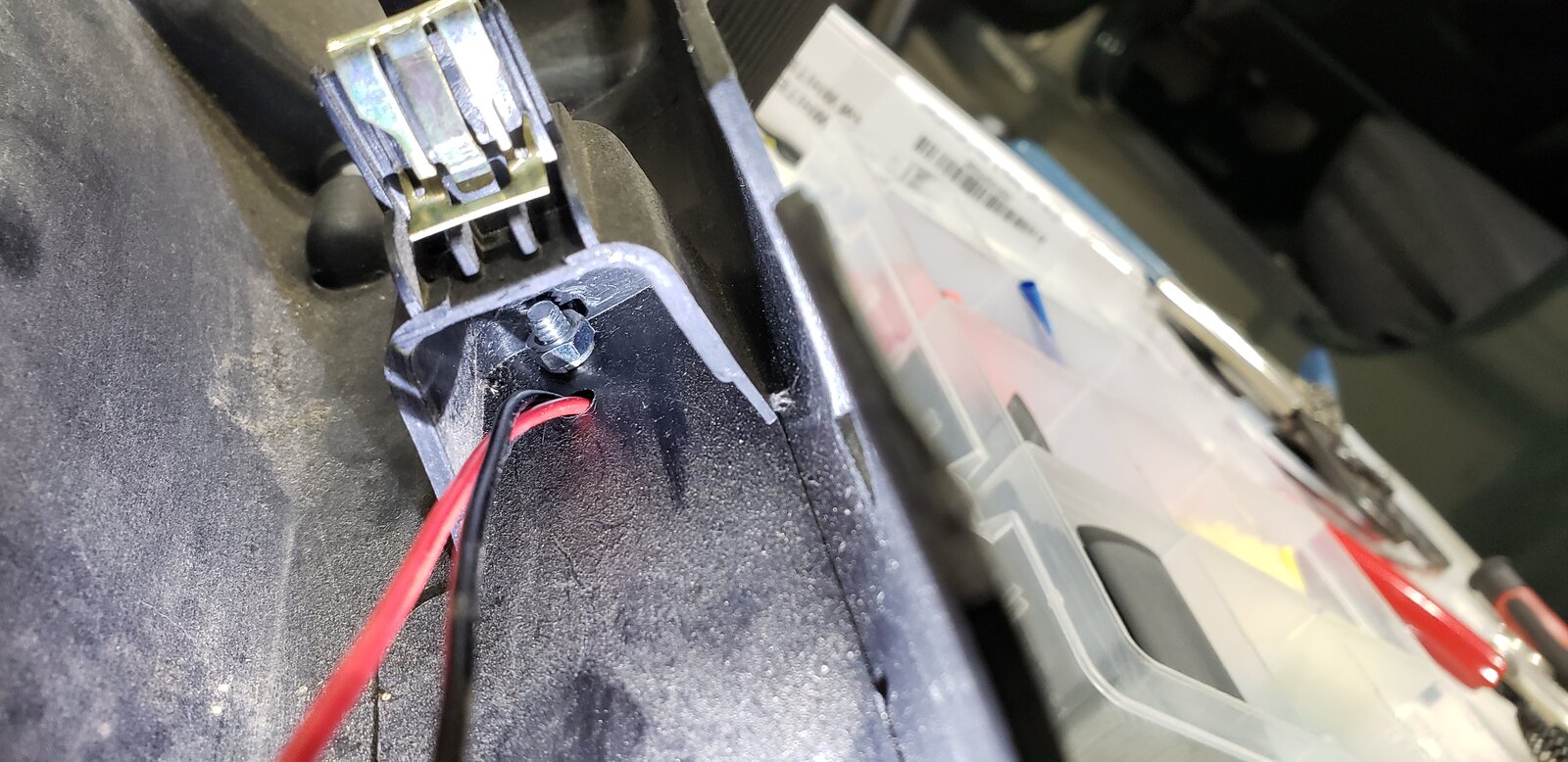

Both lights were tied into the factory harness, at the stock small foot well light harness. This way, when the door is opened, the lights come on automatically. The top light is awesome, because it has a switch, in case you want it turned off, and it swivels almost 90°. For the top light, I used male/female connectors, so it could be removed easily.

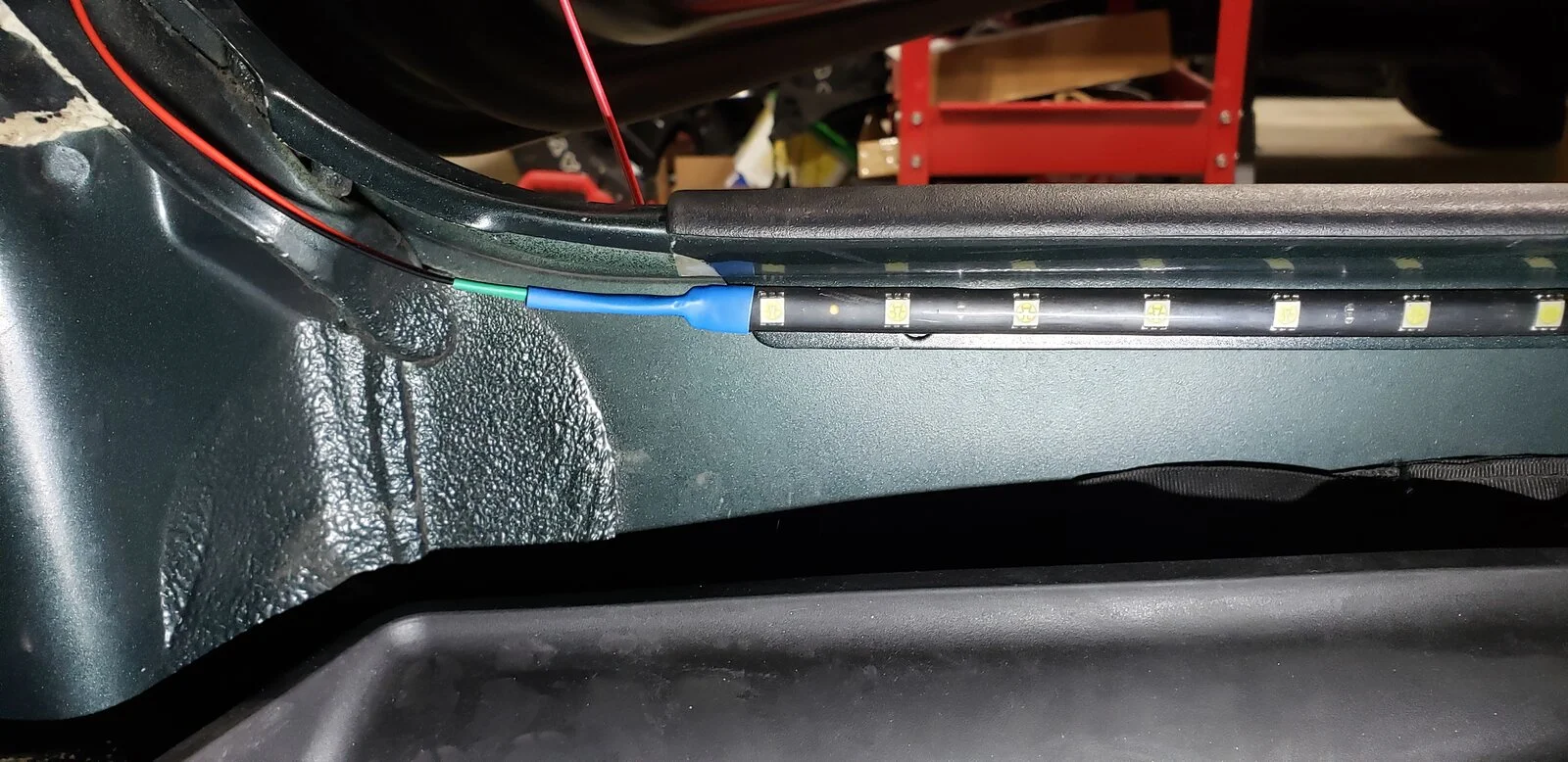

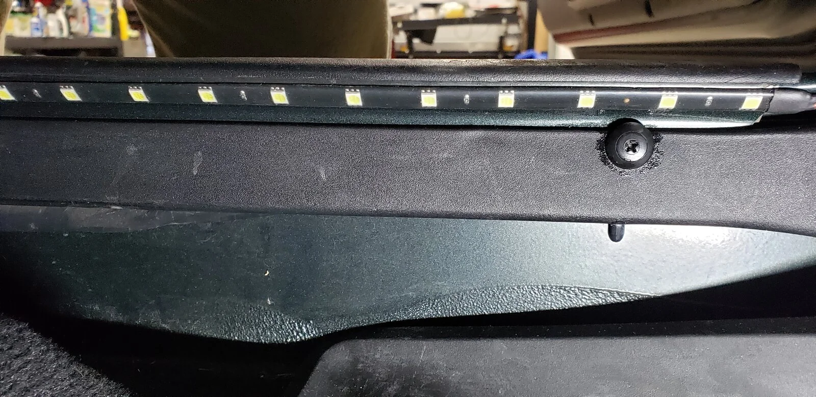

What if you put those led light strips you used for the foot well under the lip the hardtop sits on.
Reactions: Irun
Mind reader. I've been looking at that. They fit perfectly there. I'm thinking about tying those into the opening of the tailgate.

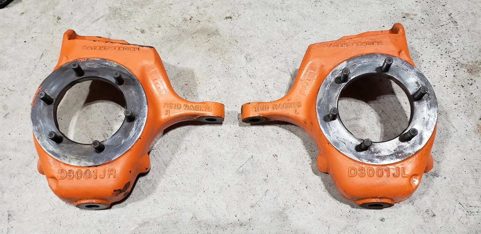

Beginning stages for the front hub conversion. These have been cleaned, but will require blasting. Originally, they were powder coated. However, I'll likely just paint them. That way touch ups will be easier. All the parts are in, with the exception of the stub shafts. Those are scheduled to be here in a few days. The conversion requires 5x5.5 wheels, so that is the last decision to make.
