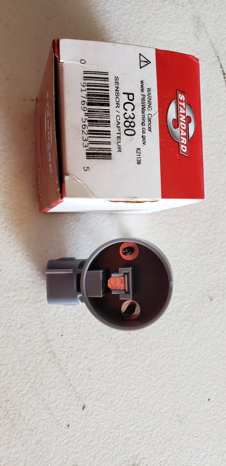

Well crap, the Jeep gave me a no start yesterday. I did finally manage to get it started, but it tripped a P0340, Camshaft Position sensor code. I checked the voltage on the ECU and battery side and all was good. After looking at the sensor, it's clearly a cheap aftermarket replacement. I also tested the hall effect and it occasionally would not drop to 0 volts when it should have.

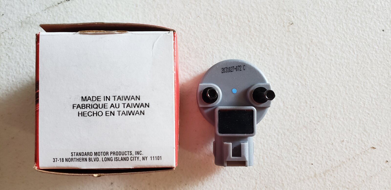

After doing a little research, it looks like the Mopar sensor is no longer available. My plan is to call around at a few dealers and see if I can locate one as old stock. In the interim, I've ordered a Standard Motor Products sensor, PC380. They claim to be made in Mexico, where some of the Mopar sensors were made, and have the broadest sensor range. We shall see!

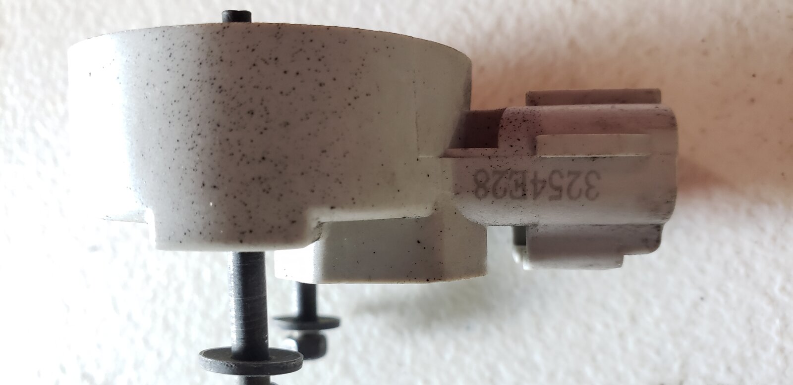

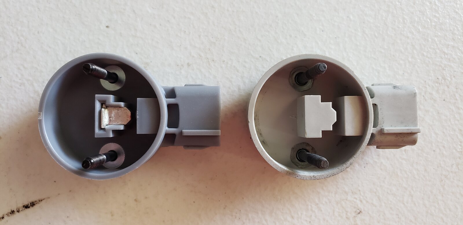

The new SMP cam position sensor is in. The old sensor is the one on the right.
