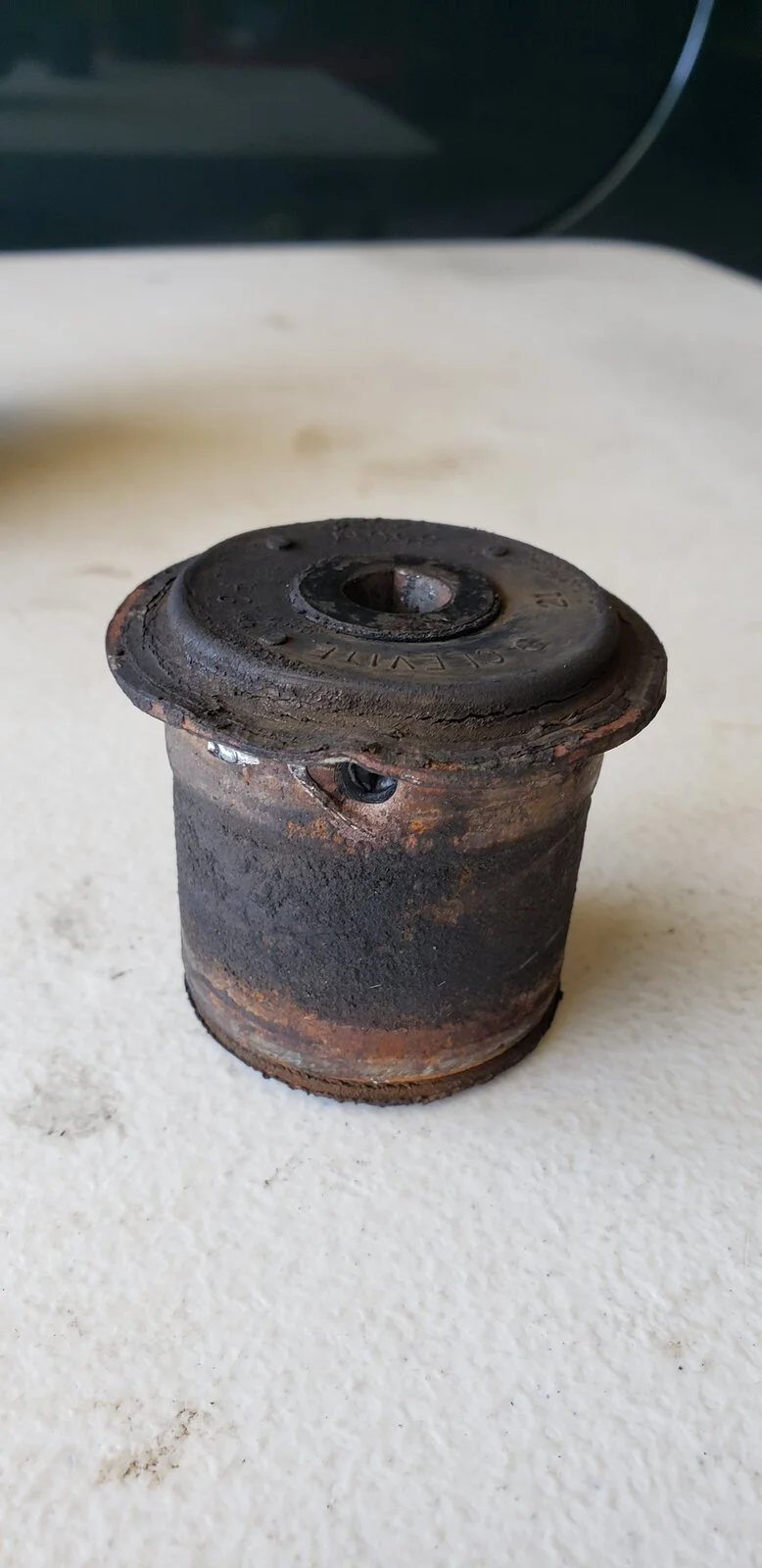

The upper control arms, and axle side bushings, are my main contender as the problem area. When I said I replaced the control arms with Savvy arms, I left out one small detail. I was a short on time, so I replaced all the arms, except for the front uppers. I looked at these this morning and I've got noticeable movement in the control arm bushings themselves. I don't see much deflection in the axle side bushings, but that is a little hard to tell, given the state of the stock upper arm bushings.
To be honest, I suspected this would be an issue. Anytime I don't do what I know should be done, I'm reminded of why I just fix it all in the first place. I'm not looking forward to replacing the axle side bushings. I've only ever done that once and it was not a pleasant experience! :(
Well, that's where I would start looking. You can test it by toeing it out some (1/2" total, I believe) and if the DW goes away, you'll know for sure.

This was not fun! :cautious:
