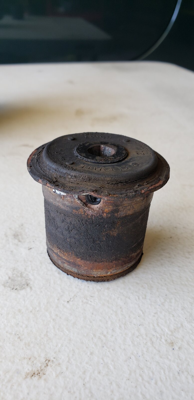

Diff side? What method did you use to get it out?
Passenger side. I have a puller, but it requires you to remove the center steel sleeve. I could not get that out, so I used a cold chisel on the inside of the bracket to break the bushing free. Went around the bushing with the chisel until I could get the air hammer between the bracket and bushing. Two bursts with the air hammer and it came free. It really wasn't hard, there just isn't much space to work with.

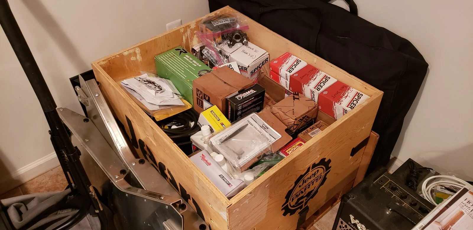

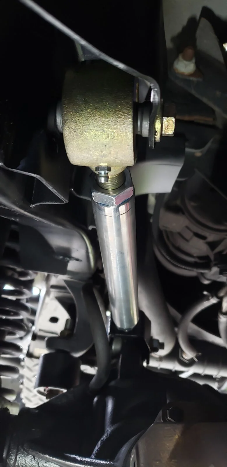

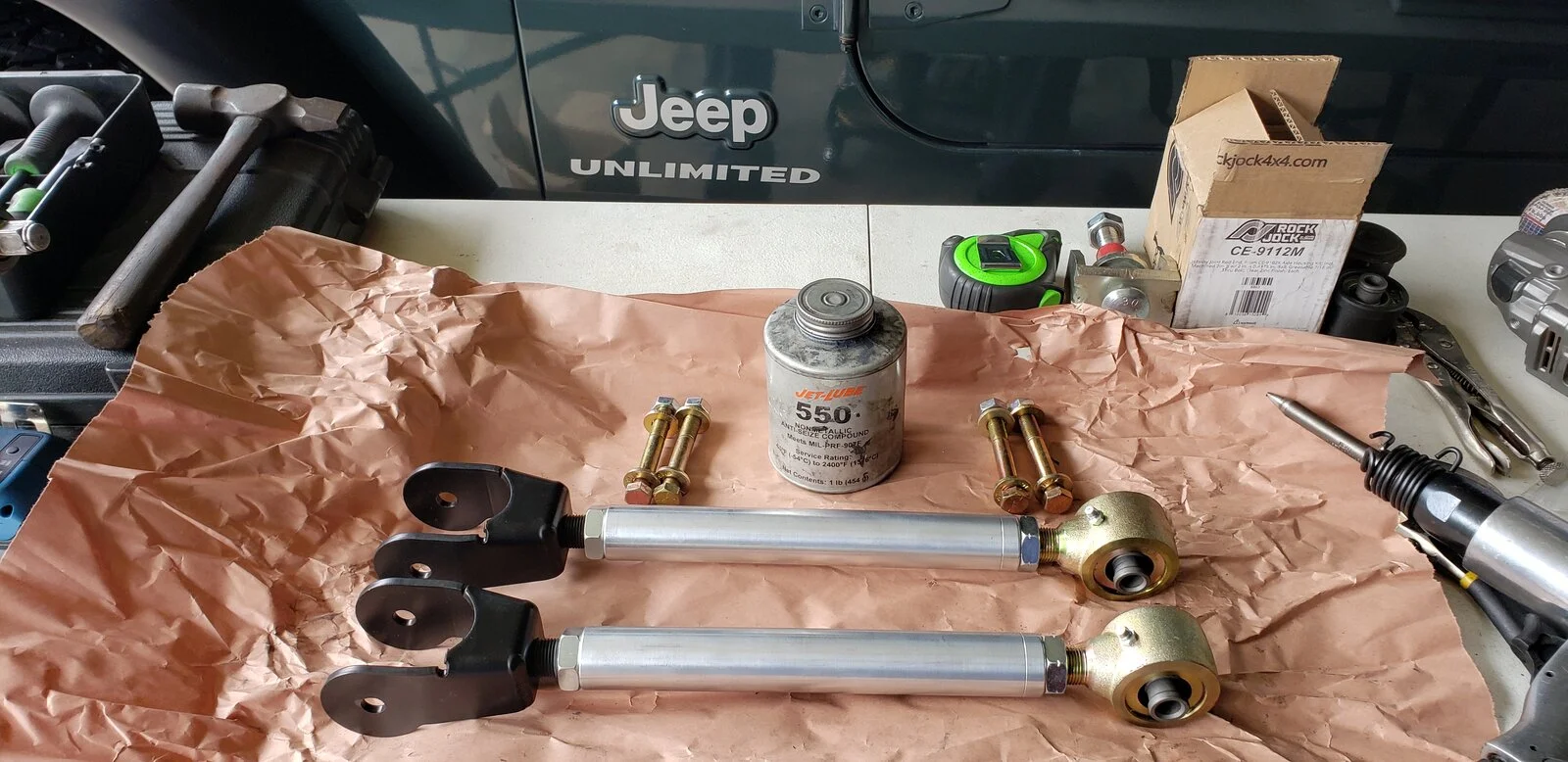

After talking to @sjalkian and seeing his build I know a mid arm and shock outboarding is in my future for this Jeep. However, that won't happen for a year or two. In the interim I need to finish up with installing the remaining two Savvy short arms. Hopefully my bushings will be here tomorrow and I can wrap this part up. After that I've got a crate of parts to start digging into!

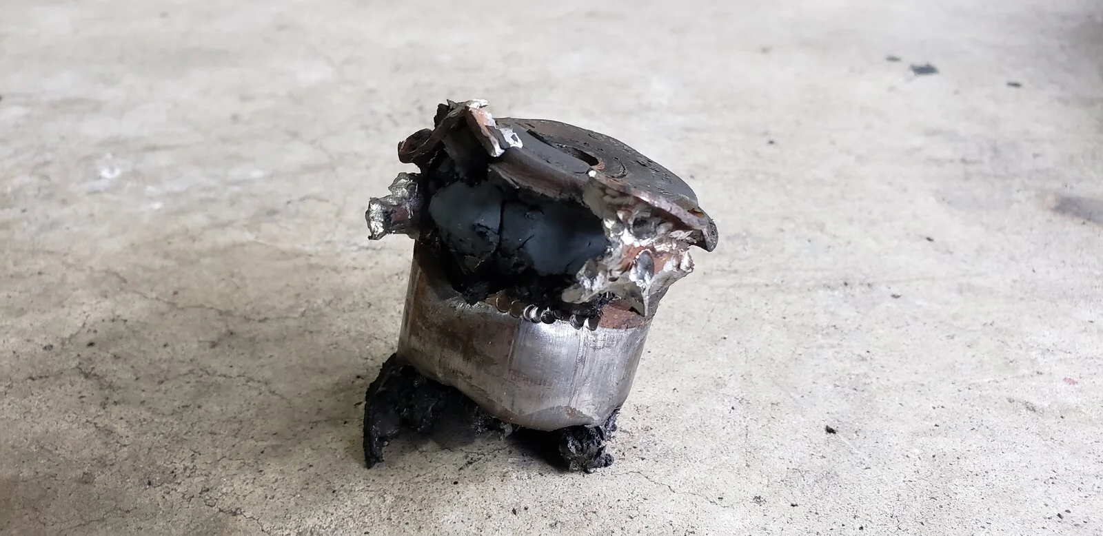

This thing continues to fight me every step of the way. I spent an hour today removing the bushing in the center housing. I've never had one as stubborn as this! 🤬
