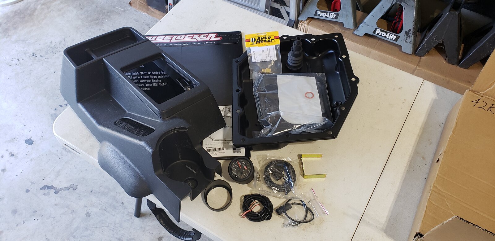

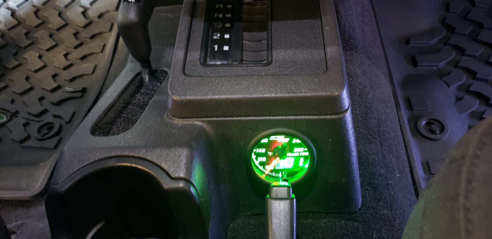

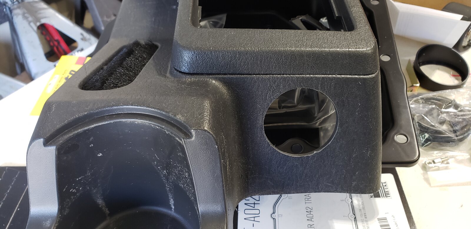

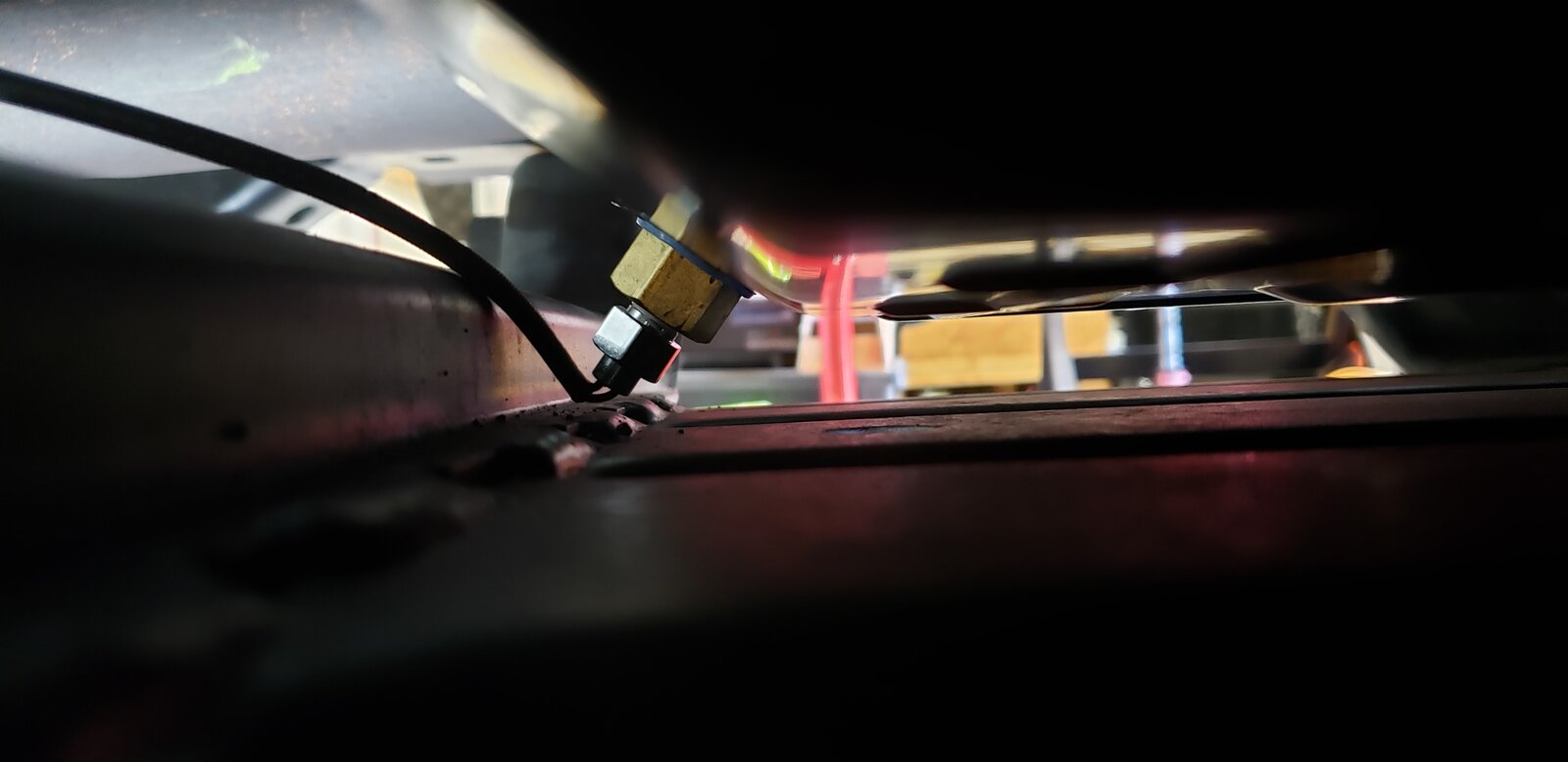

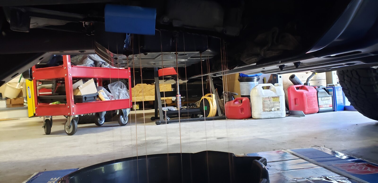

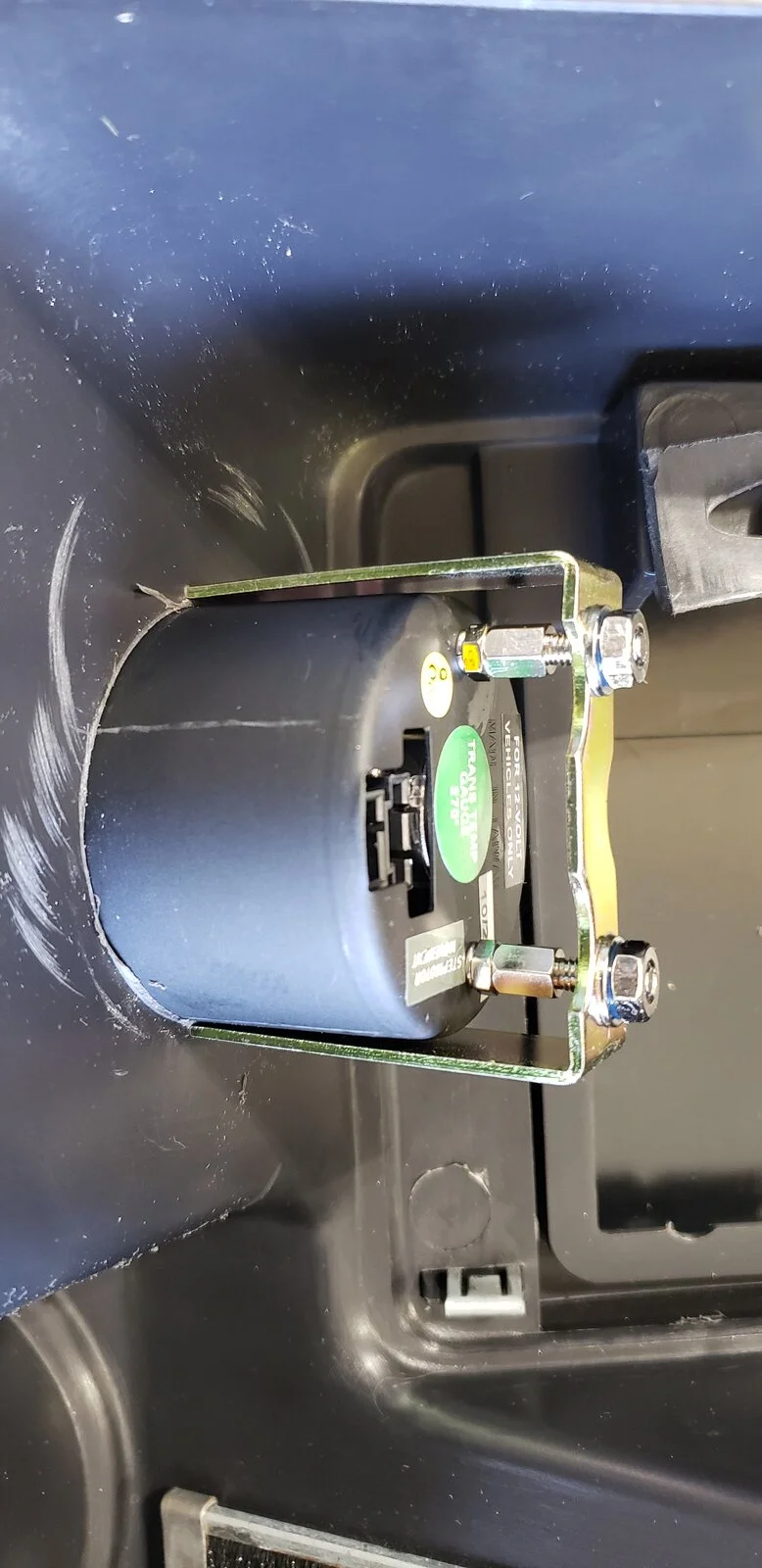

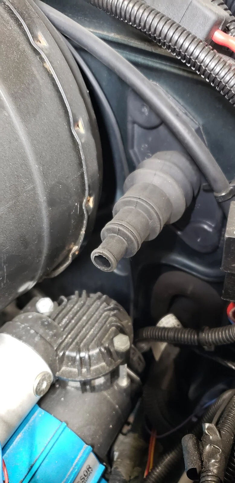

I'd like to get a good baseline of transmission temperatures before installing the transmission cooler. With that in mind, I spent a few hours today installing a transmission temperature gauge. It wasn't the color I'd want, but it was in a box of parts that were included when I bought the Jeep. If it bugs me enough, I'll swap it out later.
Well looking at the quality of the installation, the color will bug you. 🤘

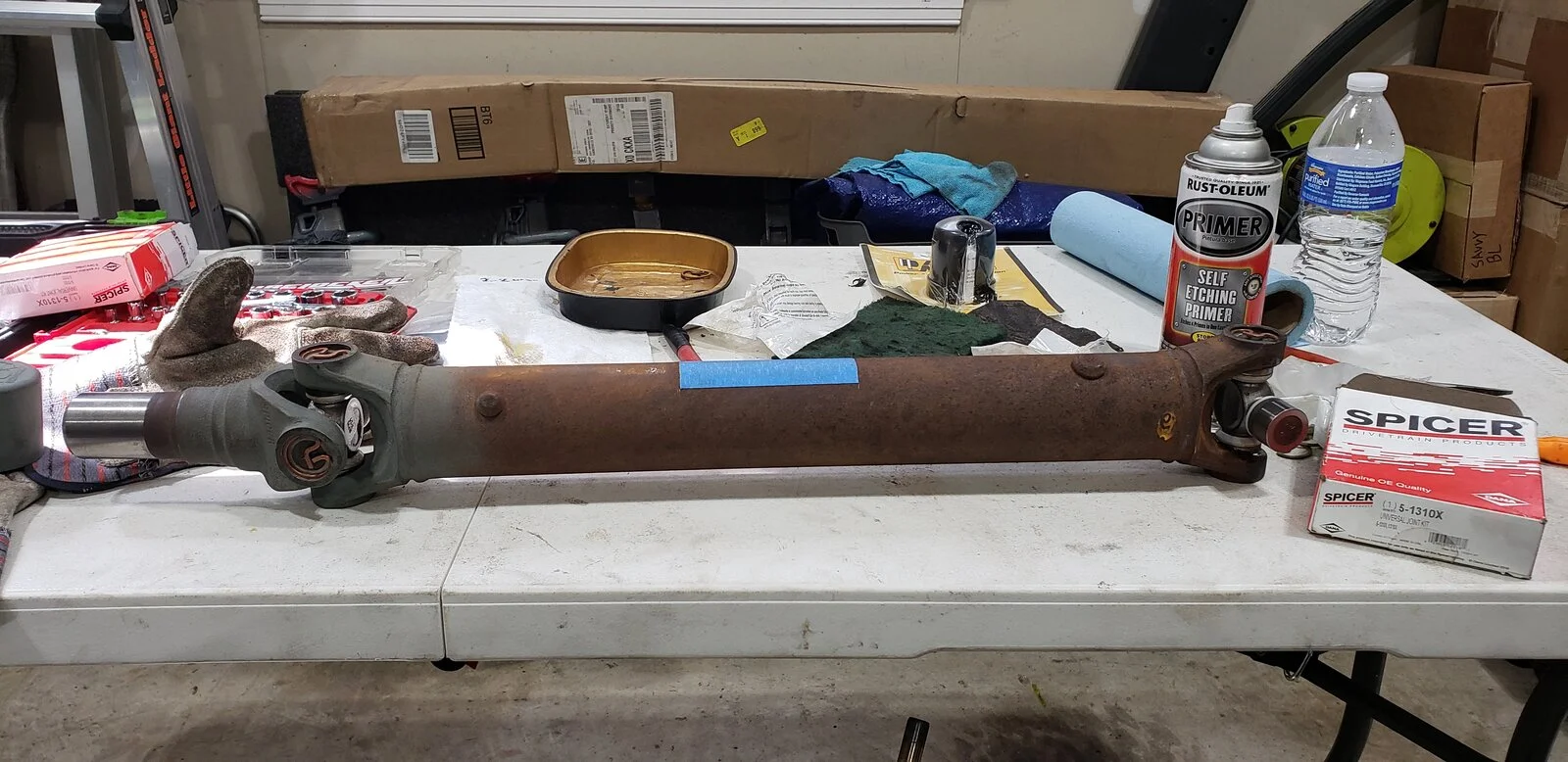

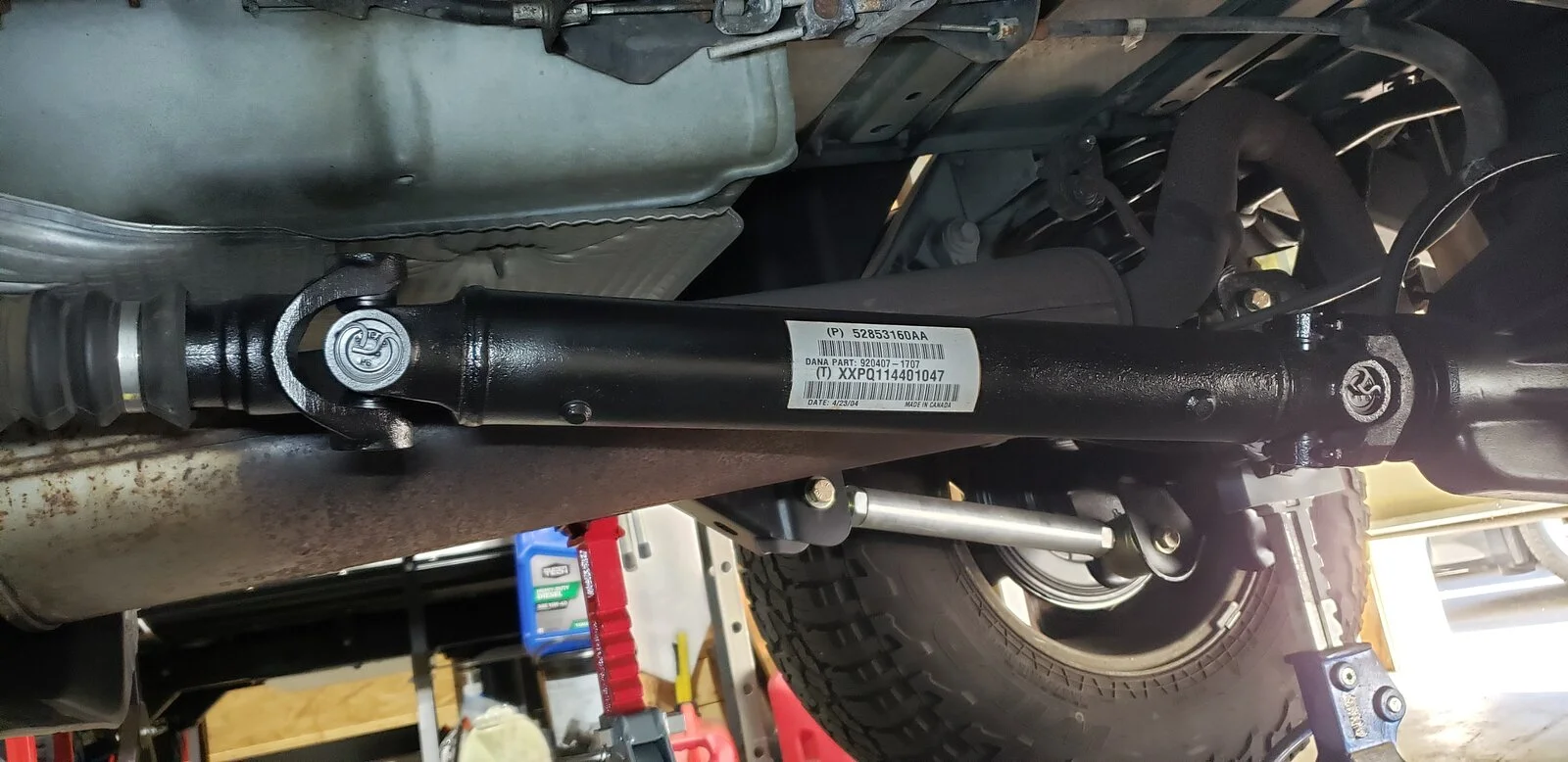

I'm not saying it's fast, but it's a record for me. 45 minutes to remove and rebuild the rear drive shaft.

Nice work on the gauge install. Did you use this Dorman pan?
I did. For anyone interested, here is the entire parts list:
Parts Used
Dorman 69001 Nylon Rib Drain Plug Gasket, Fits M14, 1/2https://www.amazon.com/gp/product/B00NF17LQM/?tag=wranglerorg-20
Dorman 265-818 Transmission Oil Panhttps://www.amazon.com/gp/product/B00Z7O4OVA/?tag=wranglerorg-20
Universal Firewall Boothttps://www.amazon.com/dp/B08LGNDD2G/?tag=wranglerorg-20
LUBE LOCKER LLT-A042https://www.amazon.com/gp/product/B00BOU6UJA/?tag=wranglerorg-20
AUTO METER 2267 Oil/Temperature Metric Adapterhttps://www.amazon.com/gp/product/B00062YVOI/?tag=wranglerorg-20
Mopar 68218057AB ATF+4, 1 Quart (6 Pack)https://www.amazon.com/dp/B07VFJYQJ3/?tag=wranglerorg-20
Genuine Mopar Transmission Filter 68059549AAhttps://www.amazon.com/dp/B00F6E49UW/?tag=wranglerorg-20
MaxTow Double Vision 260 F Transmission Temperature Gauge Kit - Includes Electronic Sensor - Black Gauge Face - Blue LED Illuminated Dial - Analog & Digital Readouts - for Trucks - 2-1/16" 52mmhttps://www.amazon.com/dp/B01MS4HDXC/?tag=wranglerorg-20
