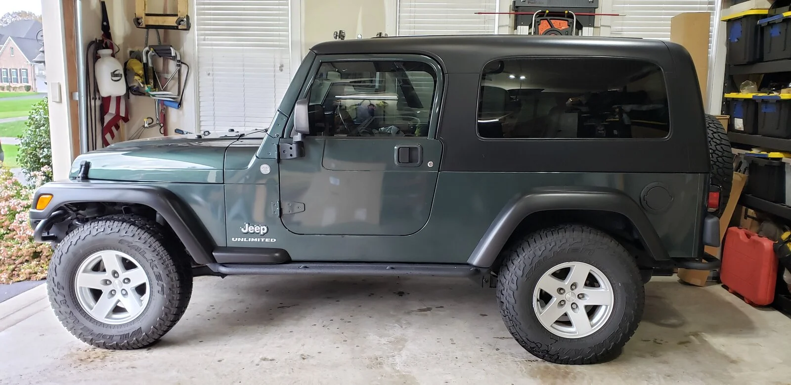

- I degreased under the hood, at least as much as I could reasonably get to. Once the front of the engine is disassembled, for the cooling and timing system refresh, I'll do more detailed work there. The Jeep was also washed and is now finally in the garage. However, it doesn't quite look the same as the blue one. Stock is a good look though!

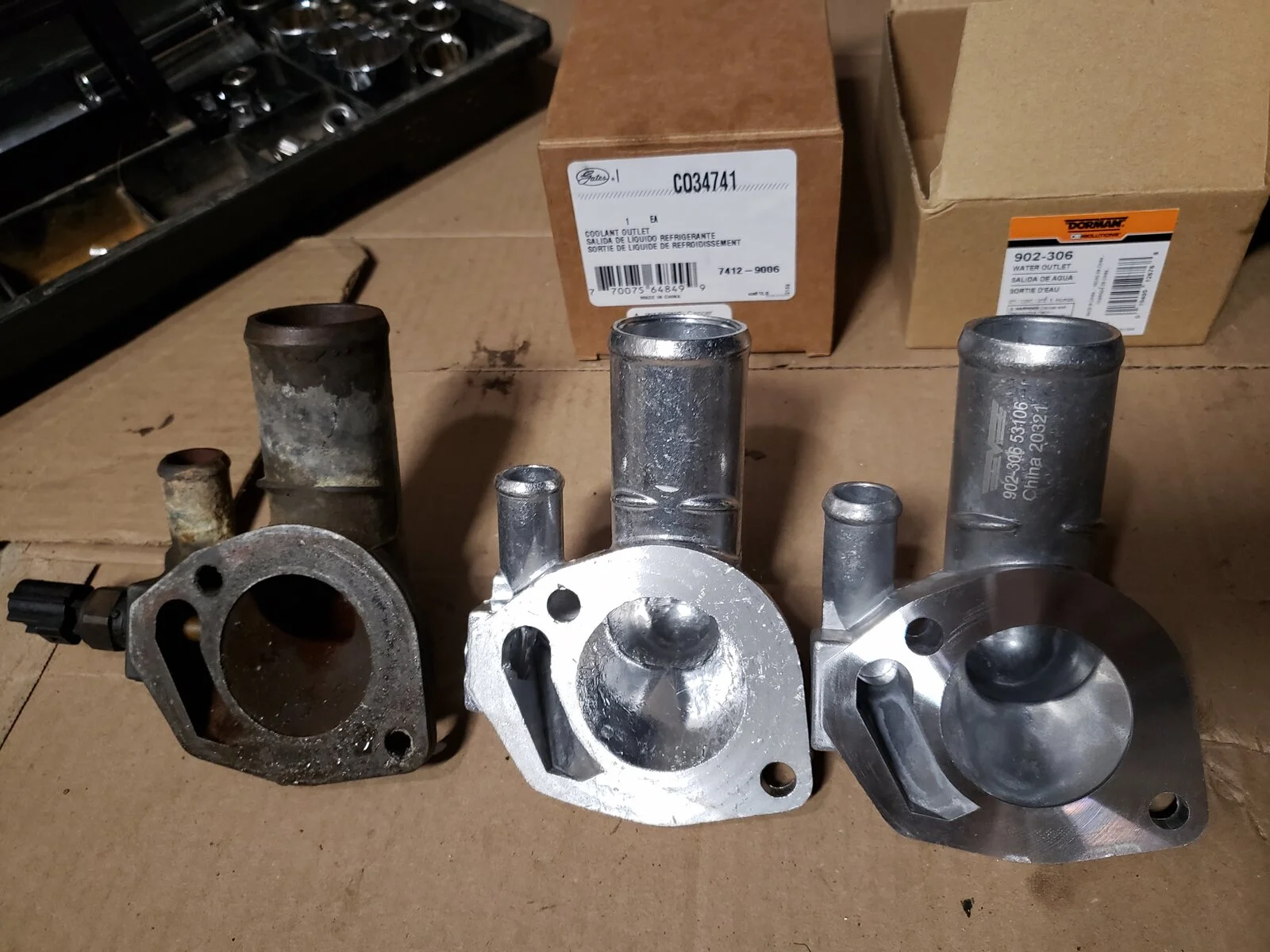

Hey @Irun , can you post a pic of your gates tstat housing?
Like you, I've had good luck with their water pumps, but when I bought their tstat housing it was pretty rough ... more than I felt like cleaning up. I had much better luck w/ the Dorman.
Reactions: Irun
I'll take a picture of mine when I get back home this evening. I don't remember them being that rough before, but what a huge difference between the Gates and Dorman. Night and day! :oops:

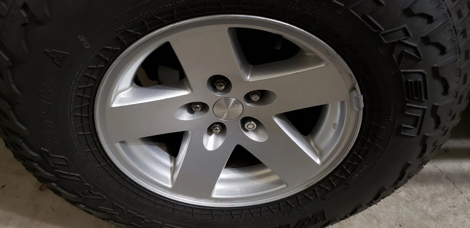

Jeff knew this and was holding out on me. I had no idea there were different style Moab wheels. It looks like the ones on this Jeep are the one year, 2006, wheels. Learned something new today!
Reactions: Alex01 and Wildman
Oops, as a fellow Jeep encyclopedia, I just figured you knew, my bad. Those are indeed 2006 wheels, which are my favorite style. The lip gives them a bit more character.
