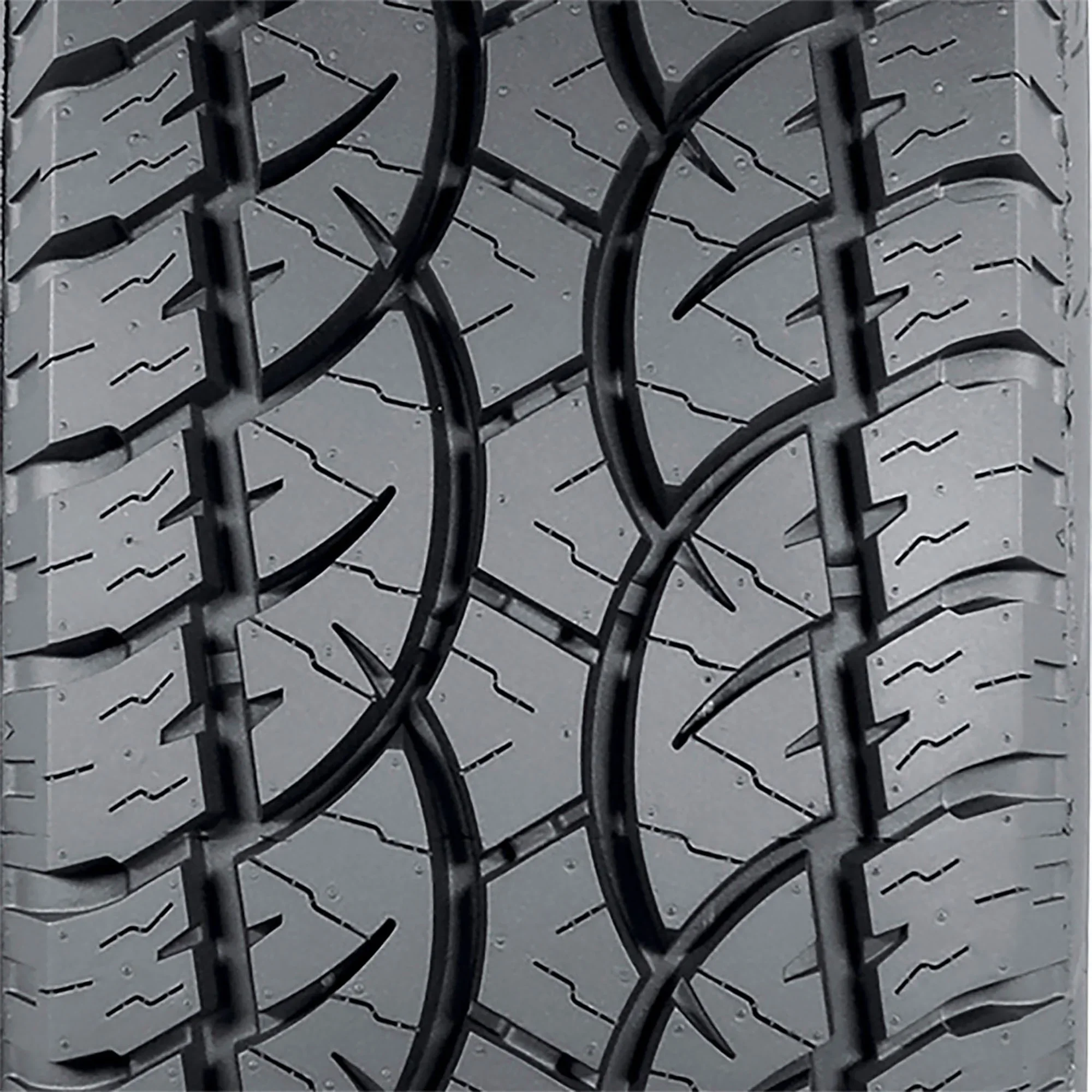

I’ve got 33/12.50R15 Falken Wildpeak A/T3s on my TJ & I’ve never experienced those symptoms.
