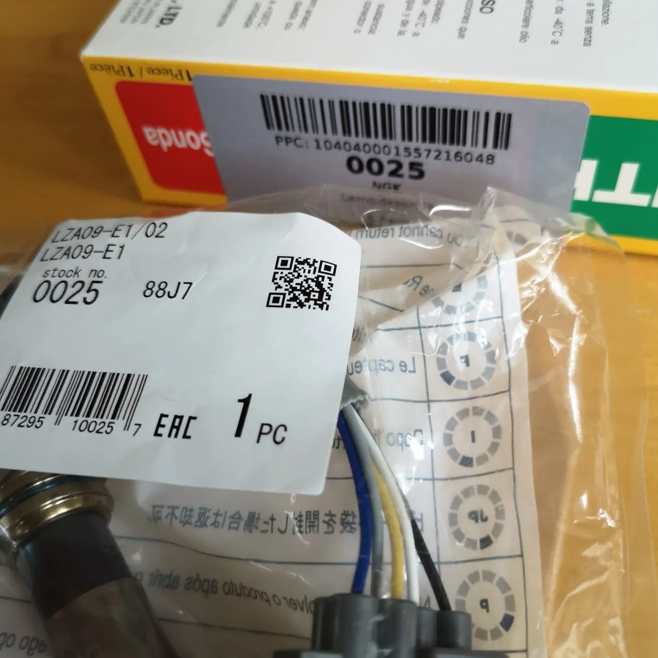

Just received the "NGK #23506 - Bank 1, Sensor 1 (Upstream)" and it has 5 wires !? Gray, white, blue, yellow, black.
Old sensor only has 4 wires, 1 black and 3 white (no connector).
I'm not making sense in this. Can I disregard one of the 5 wires, which one?

According to factory service manual, there is only 4 wires on the bank1 sensor1 but the recommended "NGK #23506" has 5 wires. Does anyond know, which of these five can be left out?
