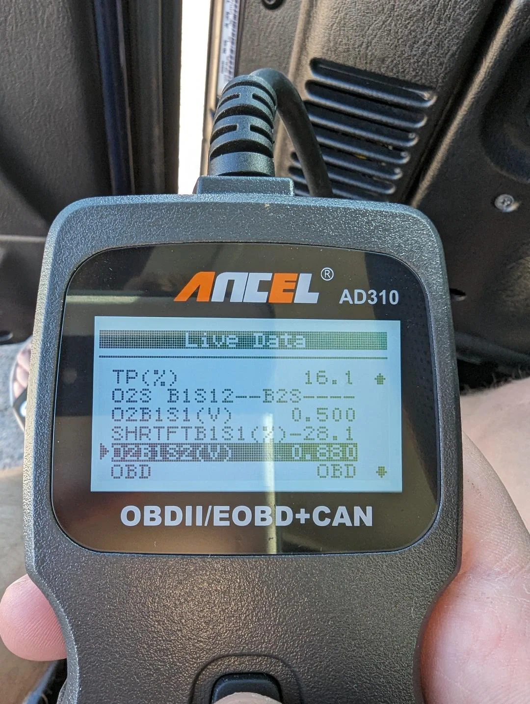

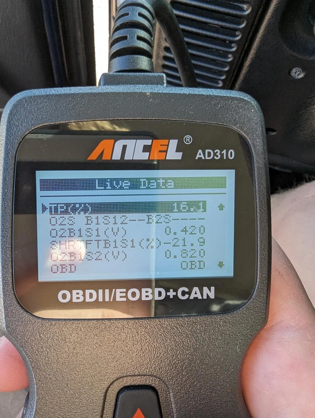

I just went out with the code reader and got values under .9v

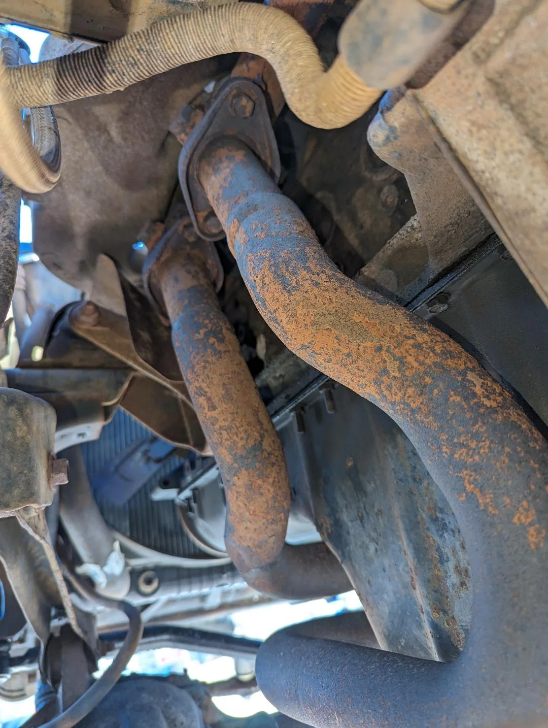

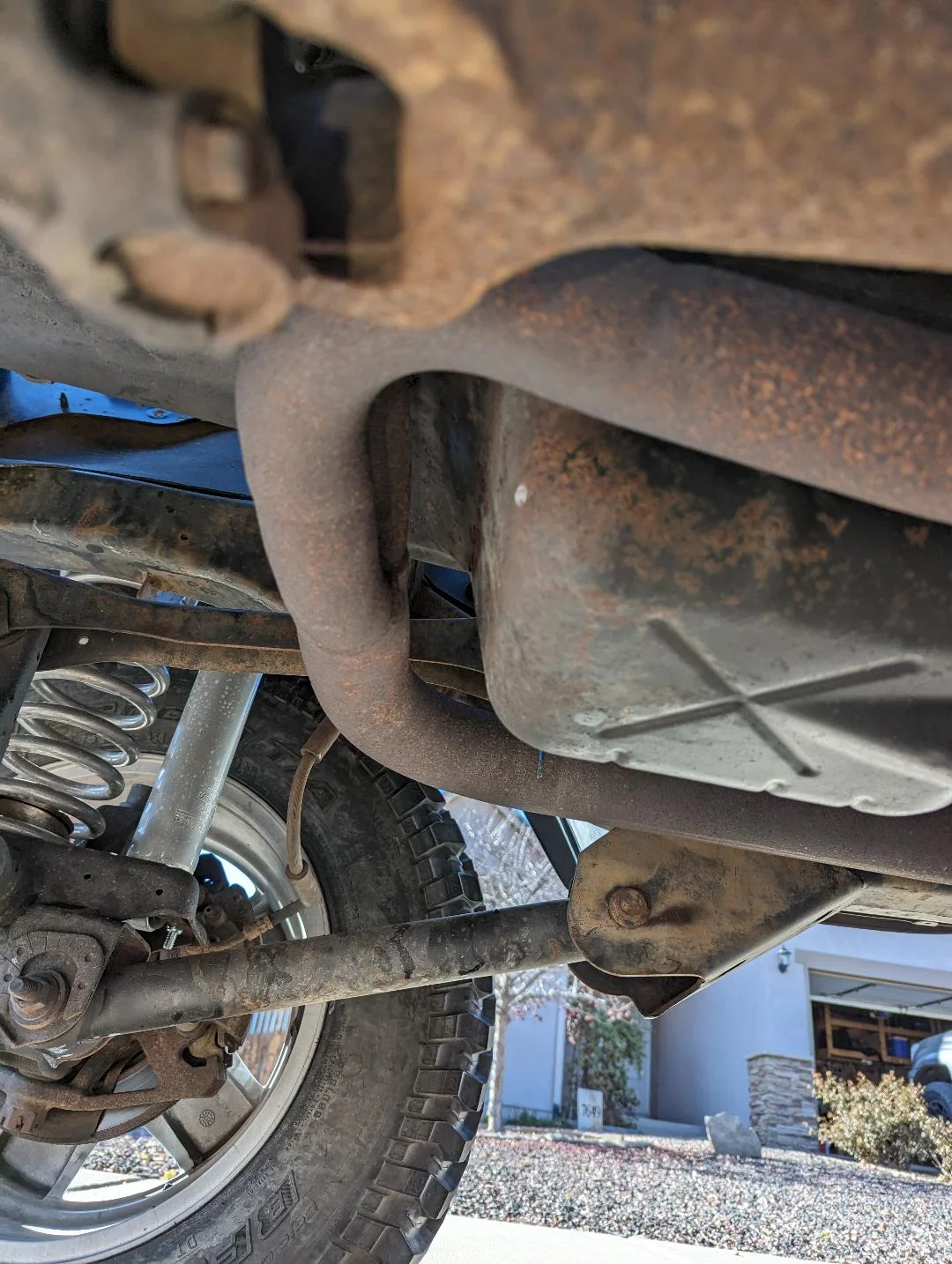

I've only owned this vehicle for about a month. Gas milage is around 9-10MPG but that seems lower than what others are stating 16-18mpg. my tires are 255/75/r17 and my speedometer is accurate maybe +2MPH

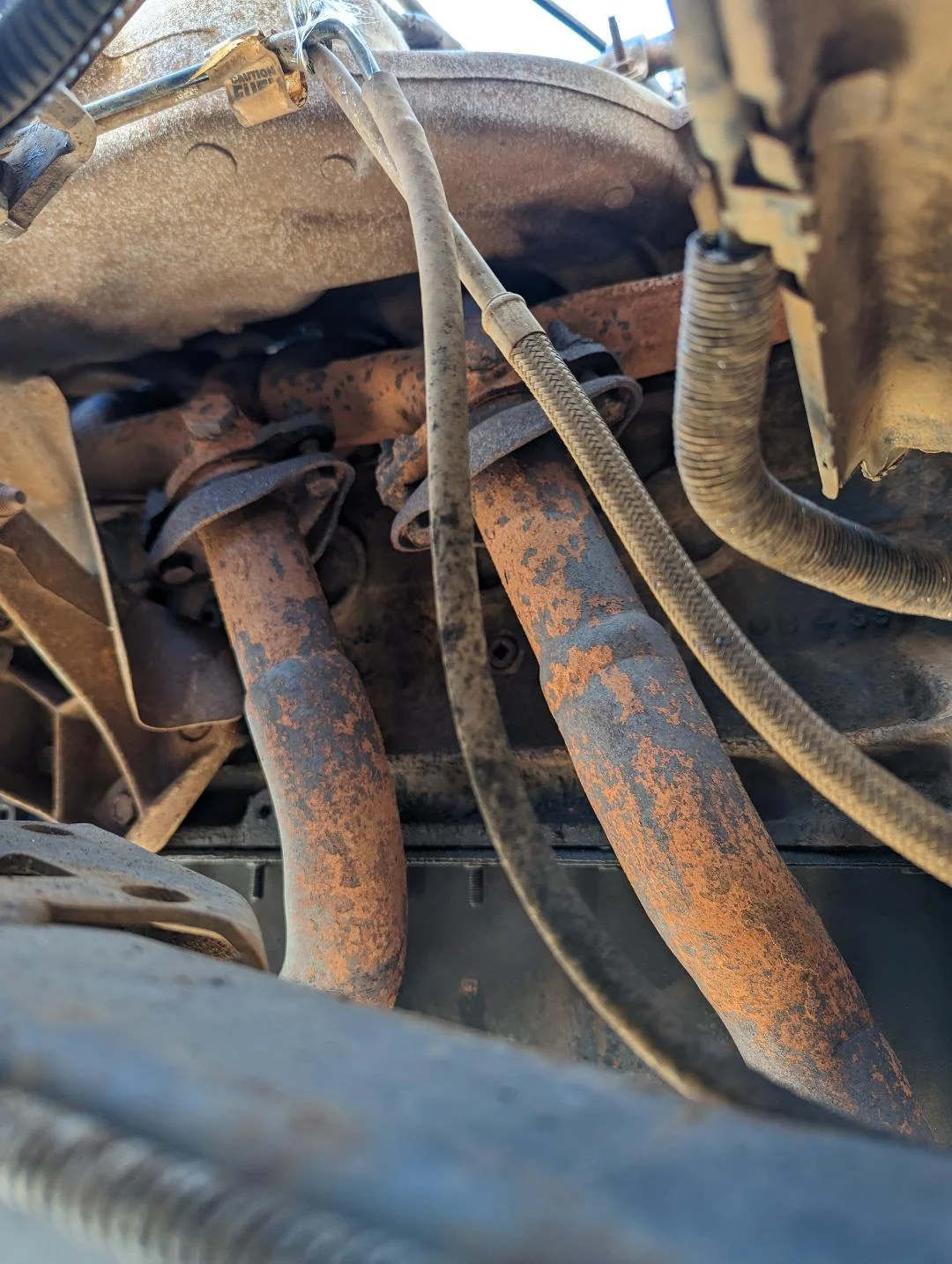

No leaks from the downpipe back. I haven't checked the headers yet as the manifold is blocking it.
Sorry new to jeeps my previous vehicles were Subaru and somehow it seems TJs are more picky than a WRX.
Got a code reader? View live data for the O2s and see if they're running up to but not past .9v.
What's the gas mileage? Has it changed for you...or what's the history here? Speedo accurate?
Check for exhaust leaks? Especially cracked headers?
I recently redid all my 97's exhaust, banks headers...old ones broke into pieces on removal...new Magnaflow cat...made most of my down pipe and used a Hooker cat back exhaust.
-Mac

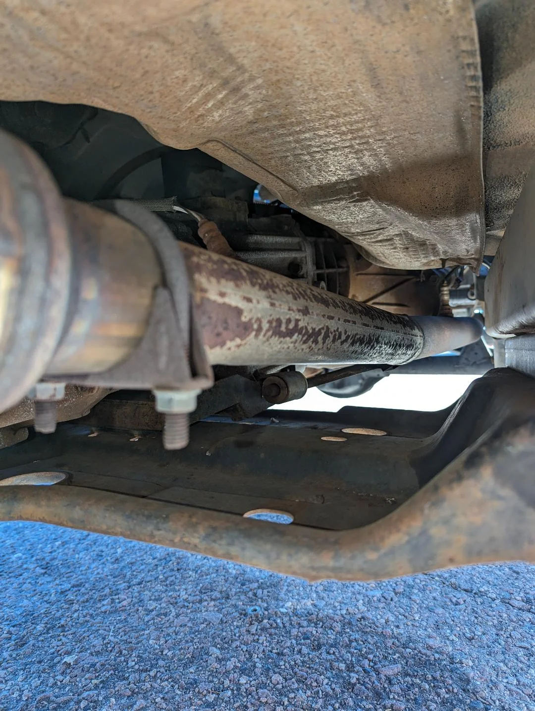

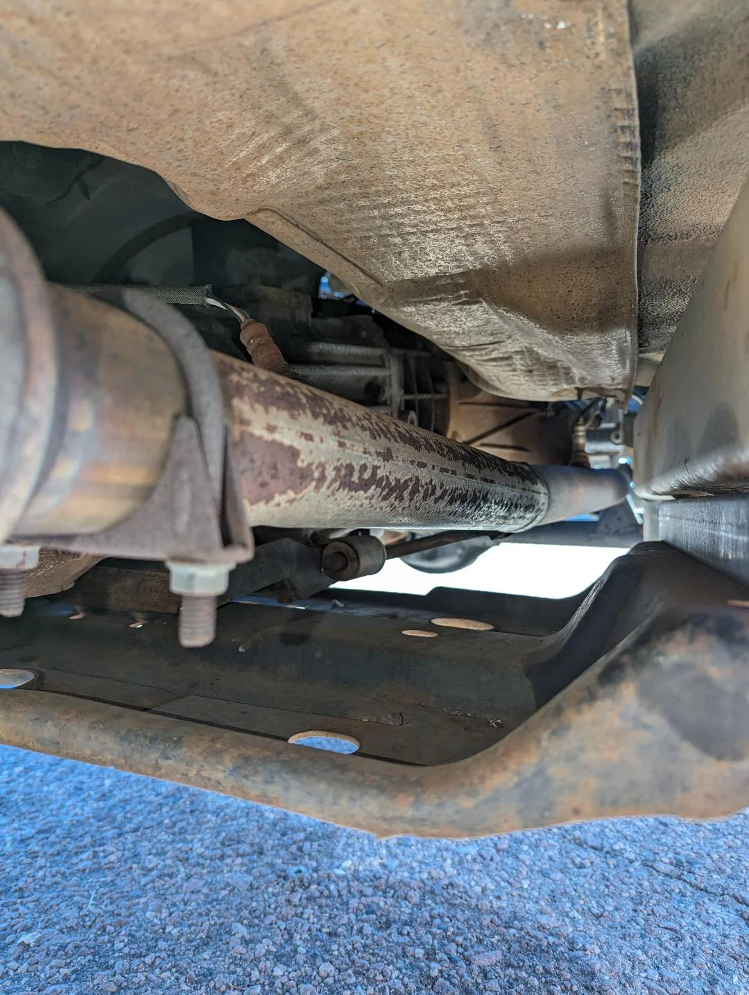

Also does the cat delete negatively affect the vehicle? This is the current exhaust from the PO.

9-10 is low. But it also depends on the accuracy of your speedometer. Most folks get 13-14 mpg.
The cat shouldn't affect your mileage. I kept mine on to cut down on fumes and because Oregon is essentially northern California...no rules yet but I'd rather just be ready.
-Mac
If you're not throwing any codes I wouldn't worry about the missing CAT. Chances are you need to clean or replace the Idle Air Control Valve. (I'd bet that it, is your culprit.)

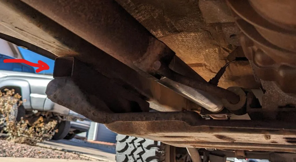

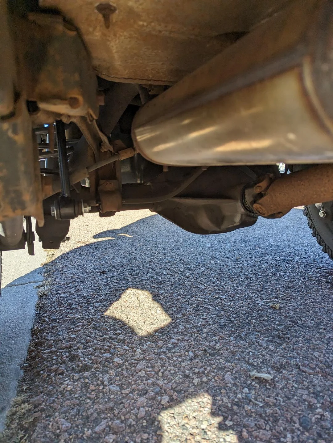

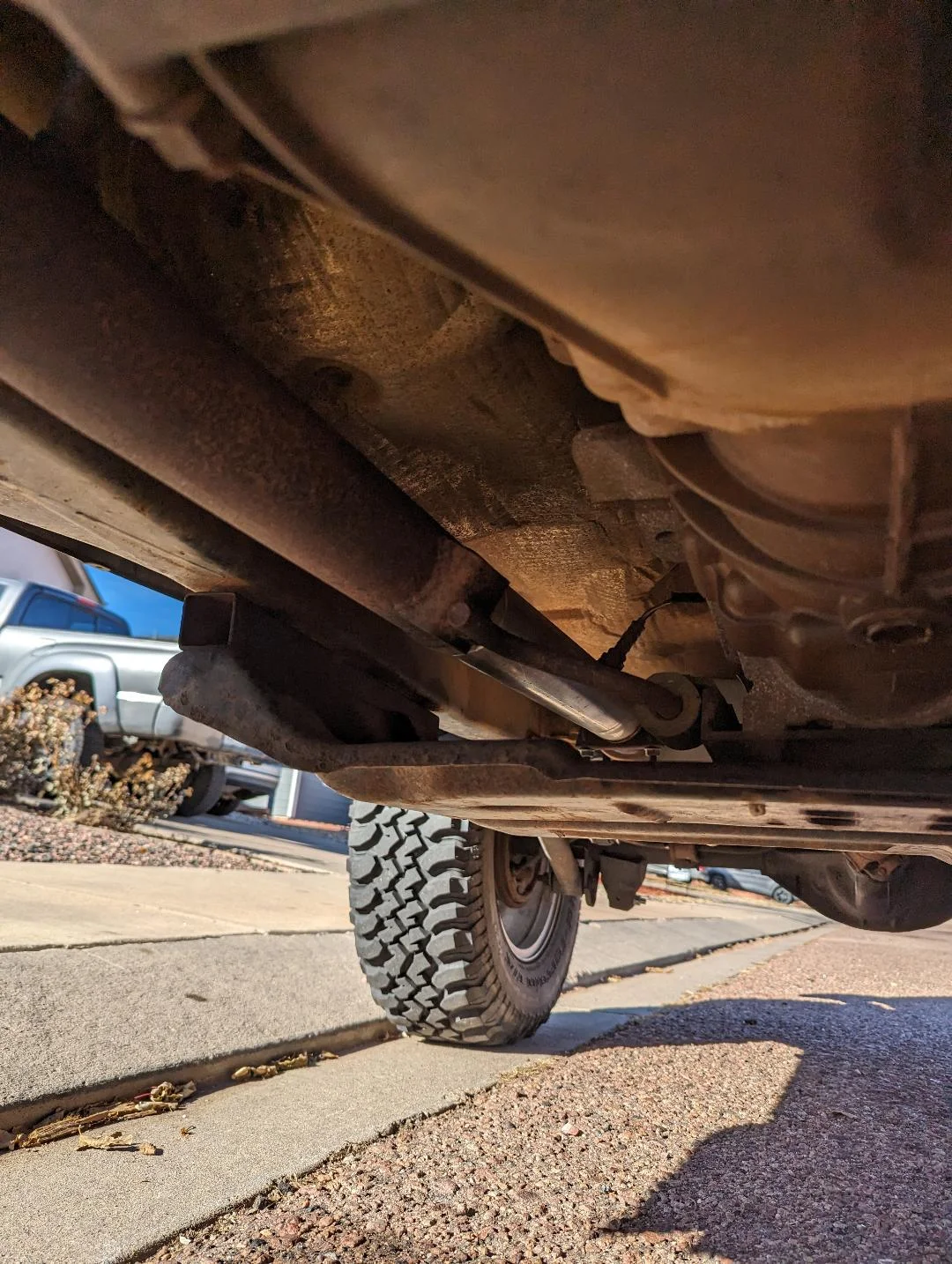

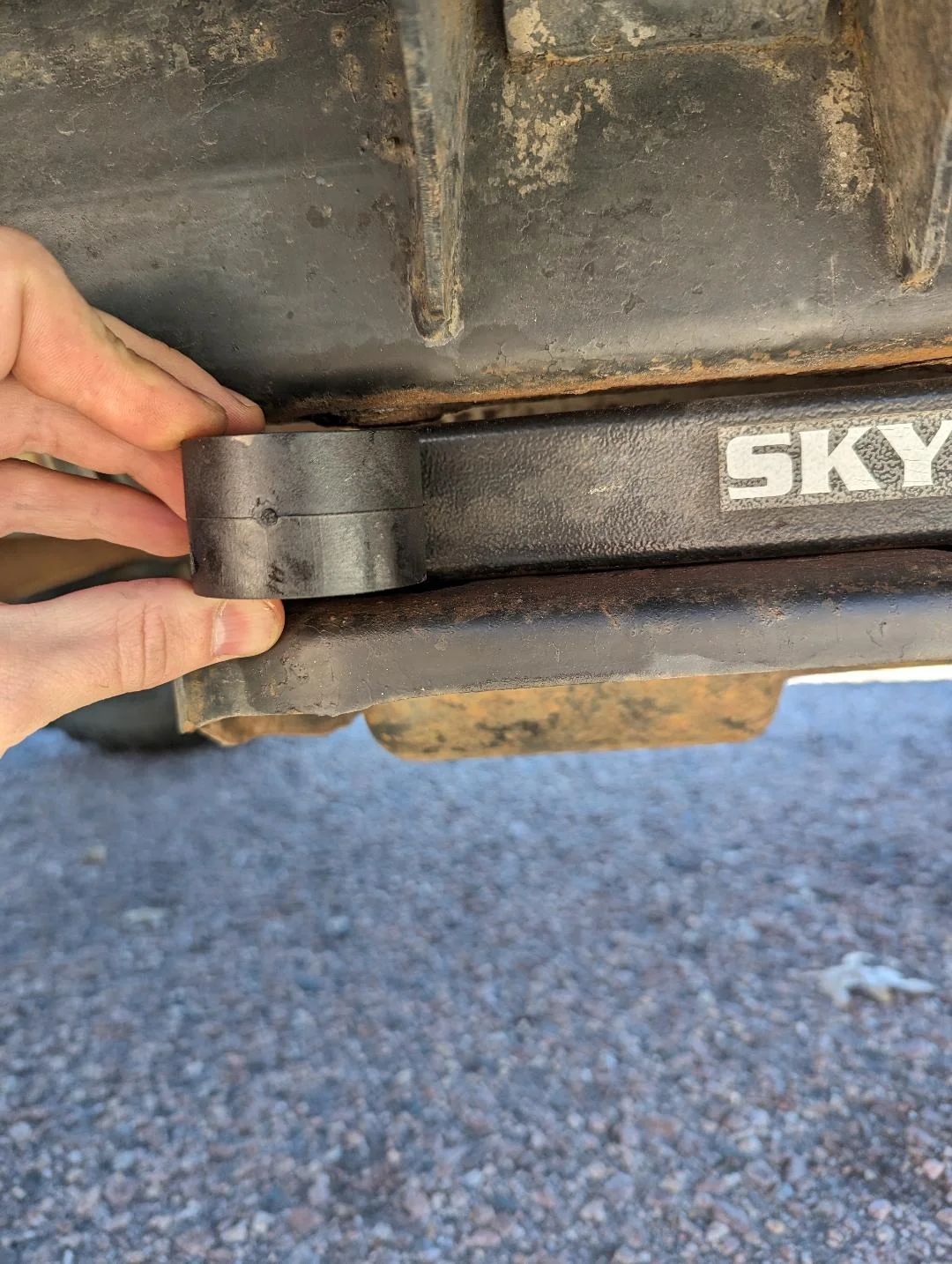

Edit: I just looked at your profile... if you only have 3" of lift, that is WAY too much transfer case drop!!!
Side note.... question actually... How much lift does your Jeep have?
Because that (red arrow) is a whole lot of transfer case drop!!!

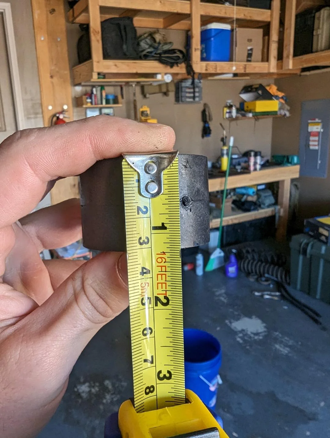

My LJ had a skyjacker lift on it when I bought it. The springs are the only components left. The kit must have included a drop and whoever installed the lift just followed directions and installed the drop. Not required for the LJ, even in a 4-5 inch lift. It was included in the kit if it was being installed in a TJ. I took out the drop and it was just fine. I did not start getting vibrations until I went even higher with an aftermarket skid

The Lift height is 3.25" It came with that skyjacker transfer case drop. the shocks and springs were real tired so I swapped them with a matching rough country set. the Rough Country kit came with similarly sized drop spacers so I didn't see the need to change it over.

Covering their backsides against drive line vibrations I guess... I hae a 3" Rancho on my first TJ and it only have about a 3/4" drop for the skid.. It just looks like a lot.
