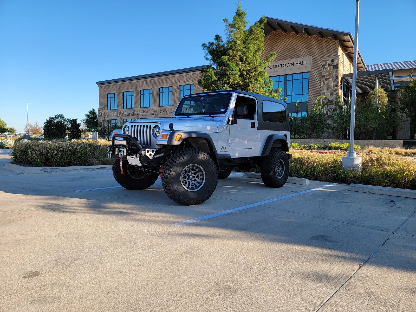

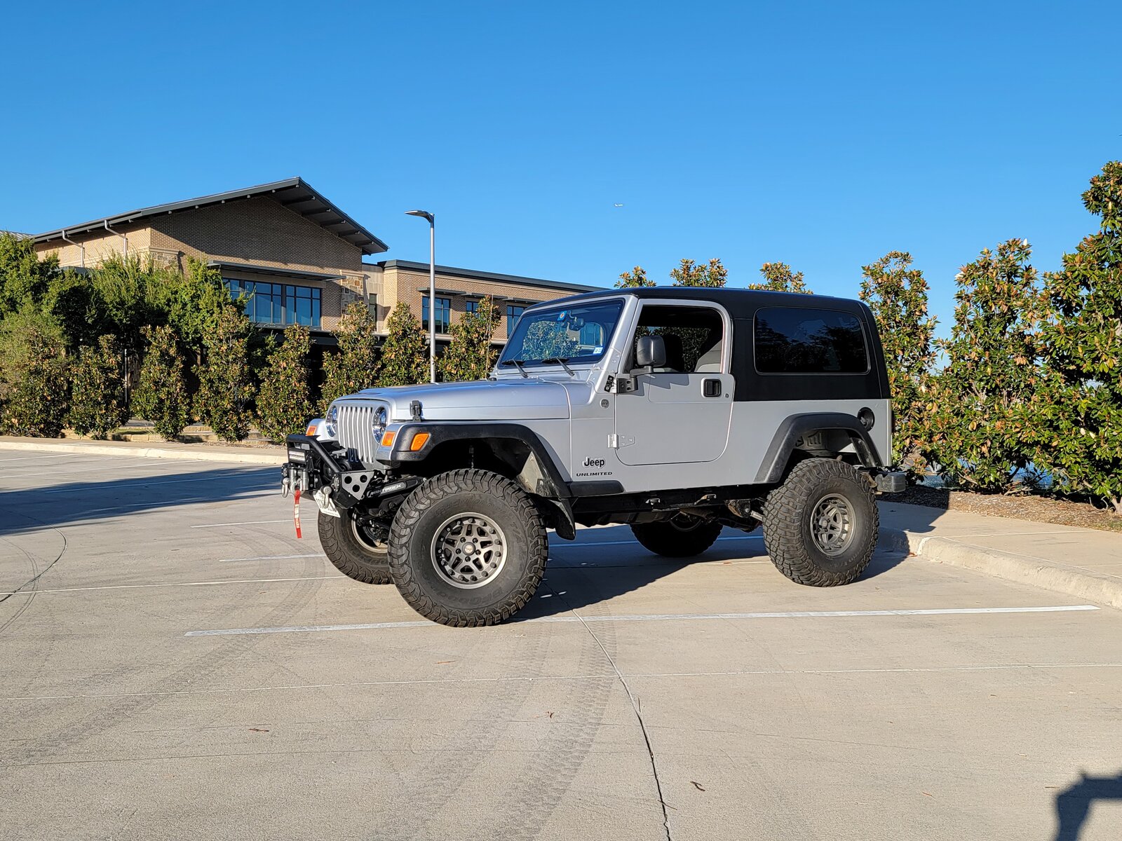

I made a 1.5" body lift for it this week and installed it today with a 1" motor lift as well. Then I spent the rest of the day cleaning off the top of the frame and the drivetrain that is newly exposed. Besides the obvious clearance I think one of the biggest benefits to a body lift is access to clean the frame and other parts normally hidden.
What wheels are these?
