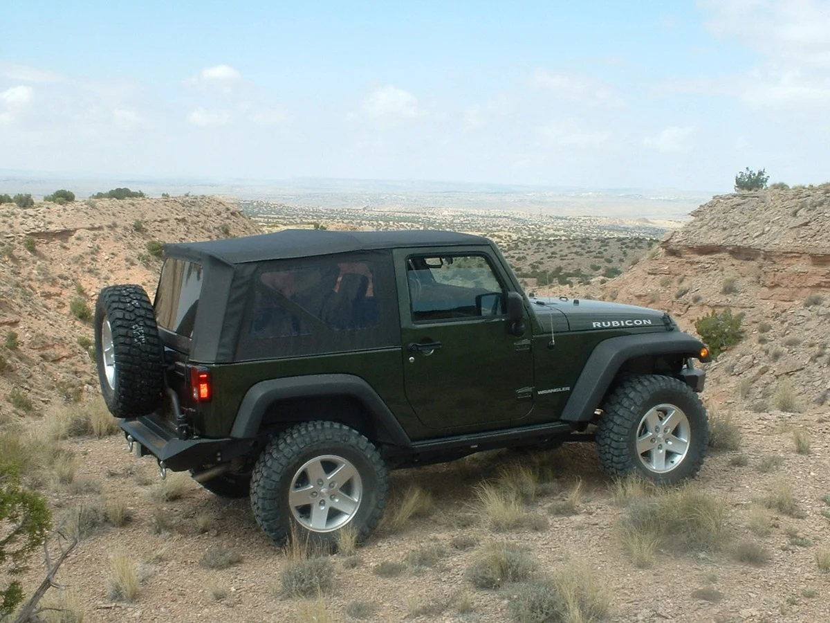

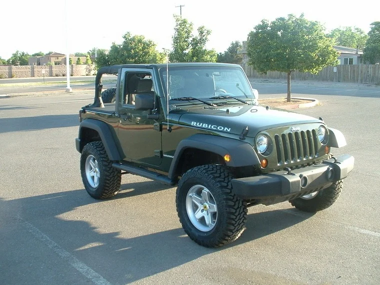

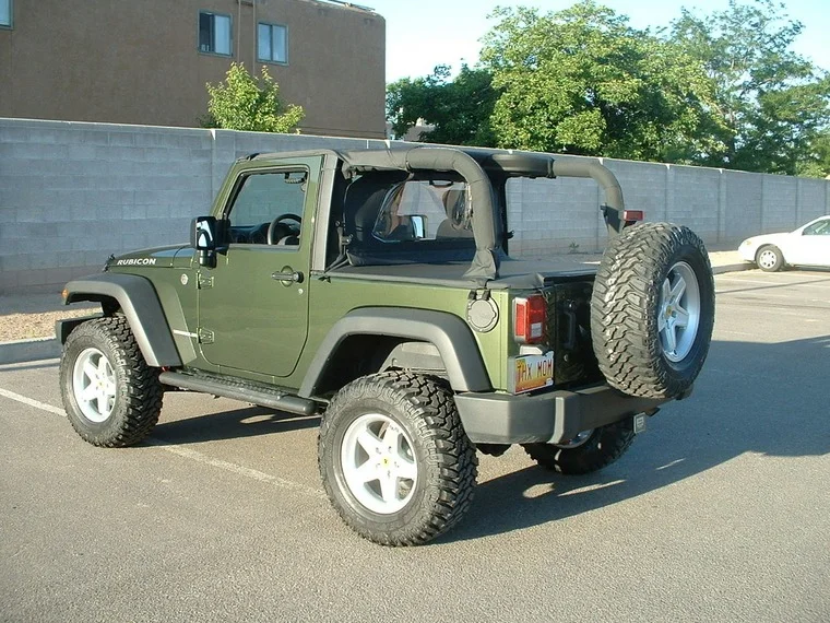

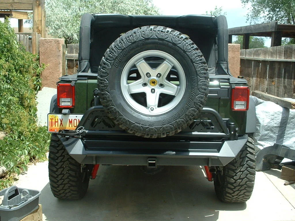

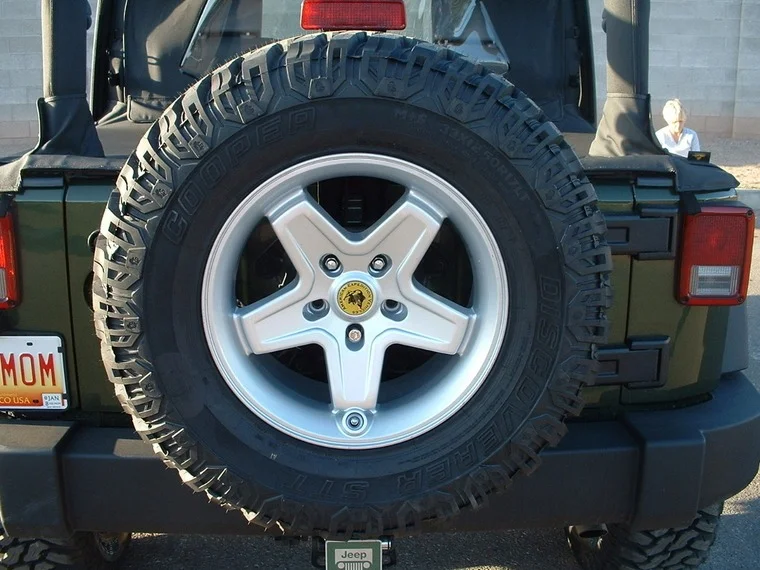

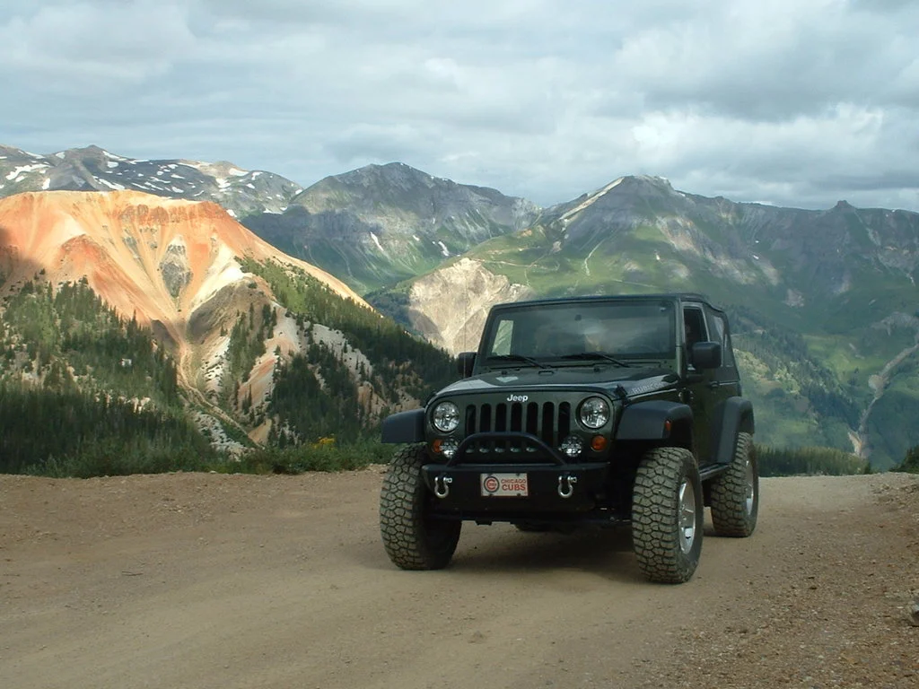

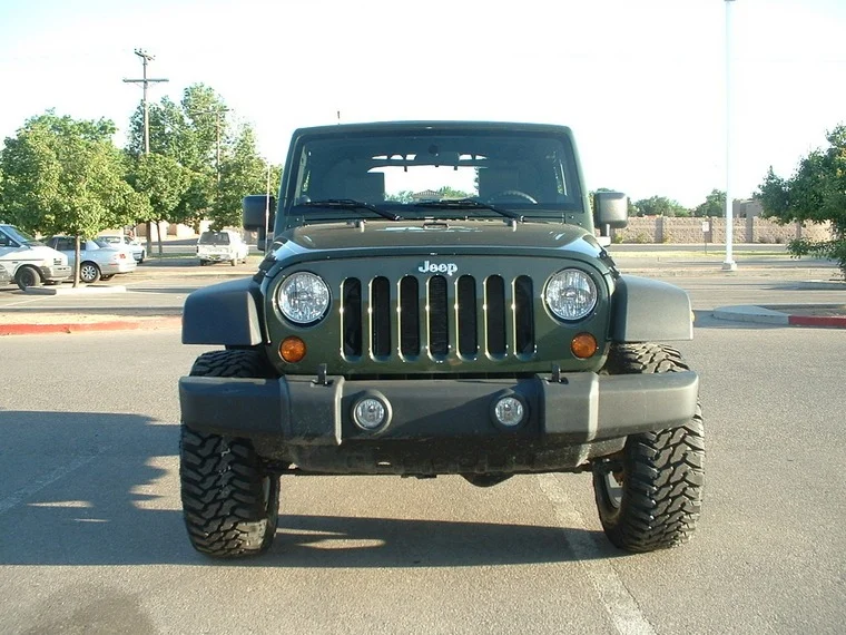

I know you're thinking 35s and more than likely you'll end up there. When I had my 2007 JKR, it ran with the OME setup, and at one time 33 x 12.50 Cooper STT, then 285/75-17 KM2s later on. That was one capable JKR, with the smallest lift I thought it needed for 33s, and even with the 4.10 gears, it did great. 6-speed NSG370, which I was no fan of, but it worked fine off road. Just clunky sounding. This was my JKR
View attachment 68366View attachment 68367View attachment 68368View attachment 68369View attachment 68370View attachment 68371View attachment 68372
That looked very good! Love that green
