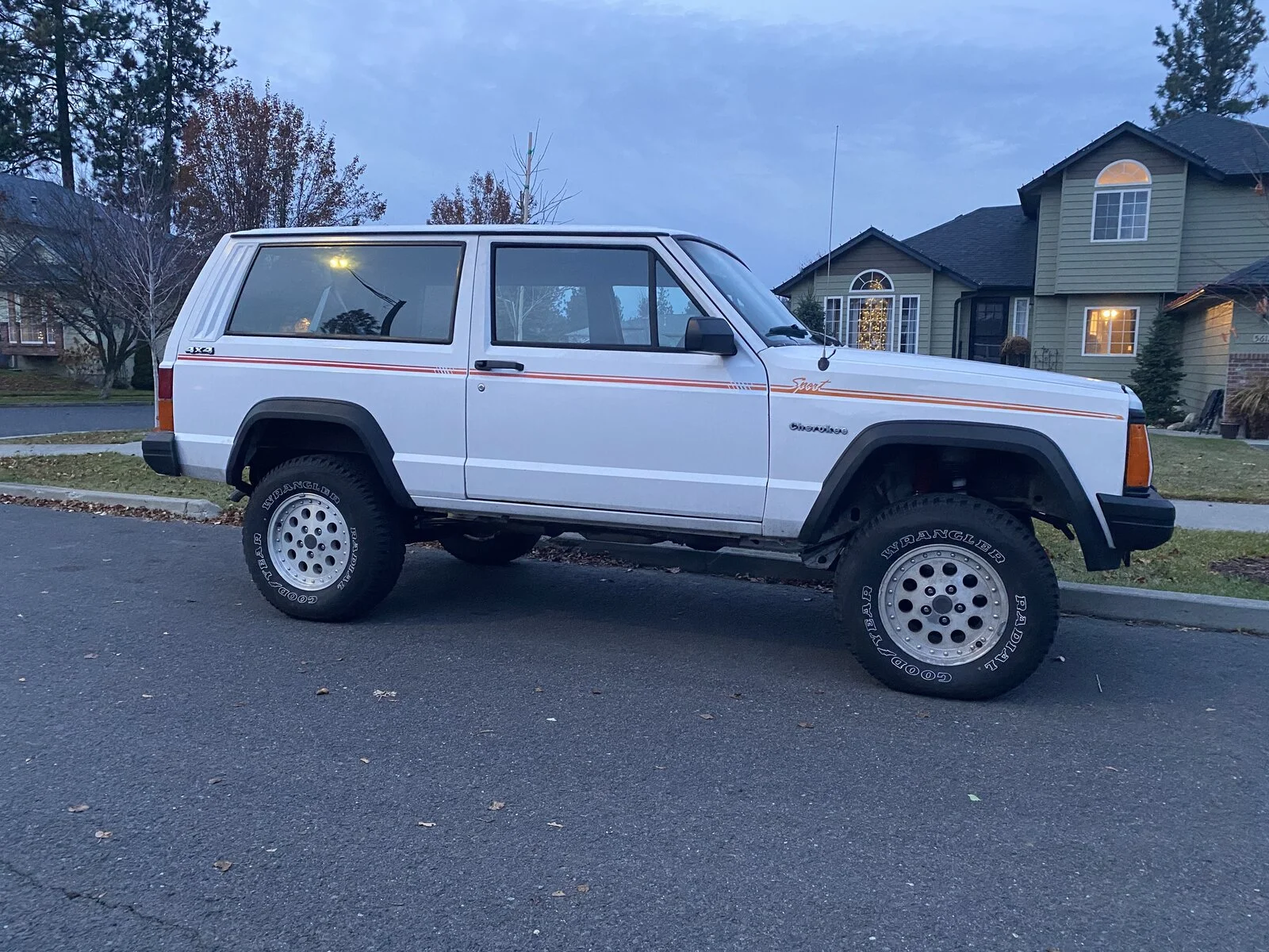

Done! Thanks to everyone’s suggestions. All helpful. First time leafs, hopefully last time. 🙄 @DrDmoney, did exactly what you said and with a little prying was able to get a screwdriver in the hole, bolt from the other side, little urging and good to go. Shocks installed. Everything torqued down to spec at ride height. 3 1/4” of lift. New lugs. No driveline vibes. I’ll post pics tomorrow. Rake is really really bad. 😂
front coils next weekend. 😅

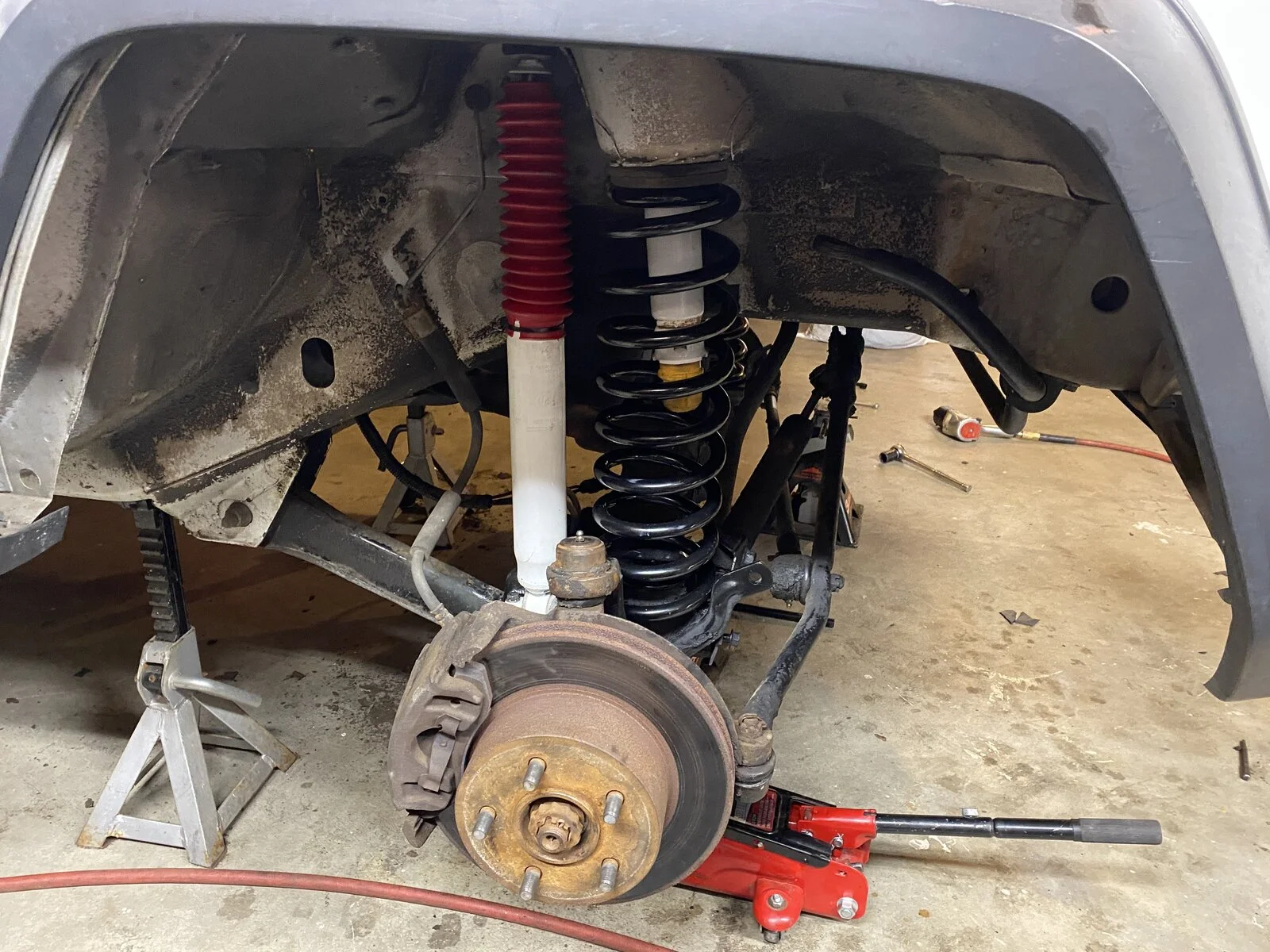

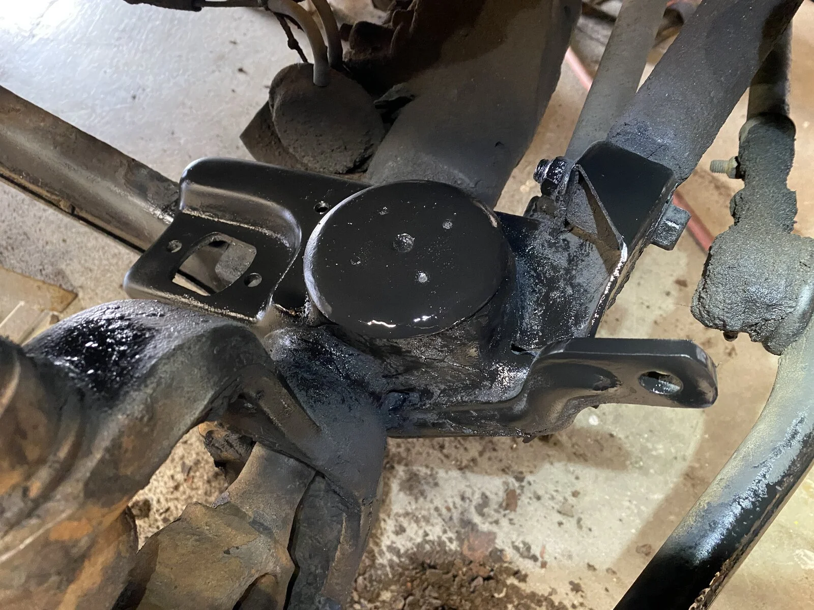

Coils installed. Went a lot easier than the leafs.

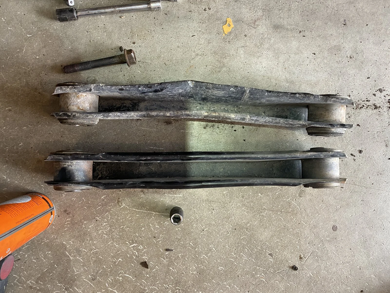

Drivers side CA was bent. Luckily I kept my old set off the TJ, so she took one for the team.

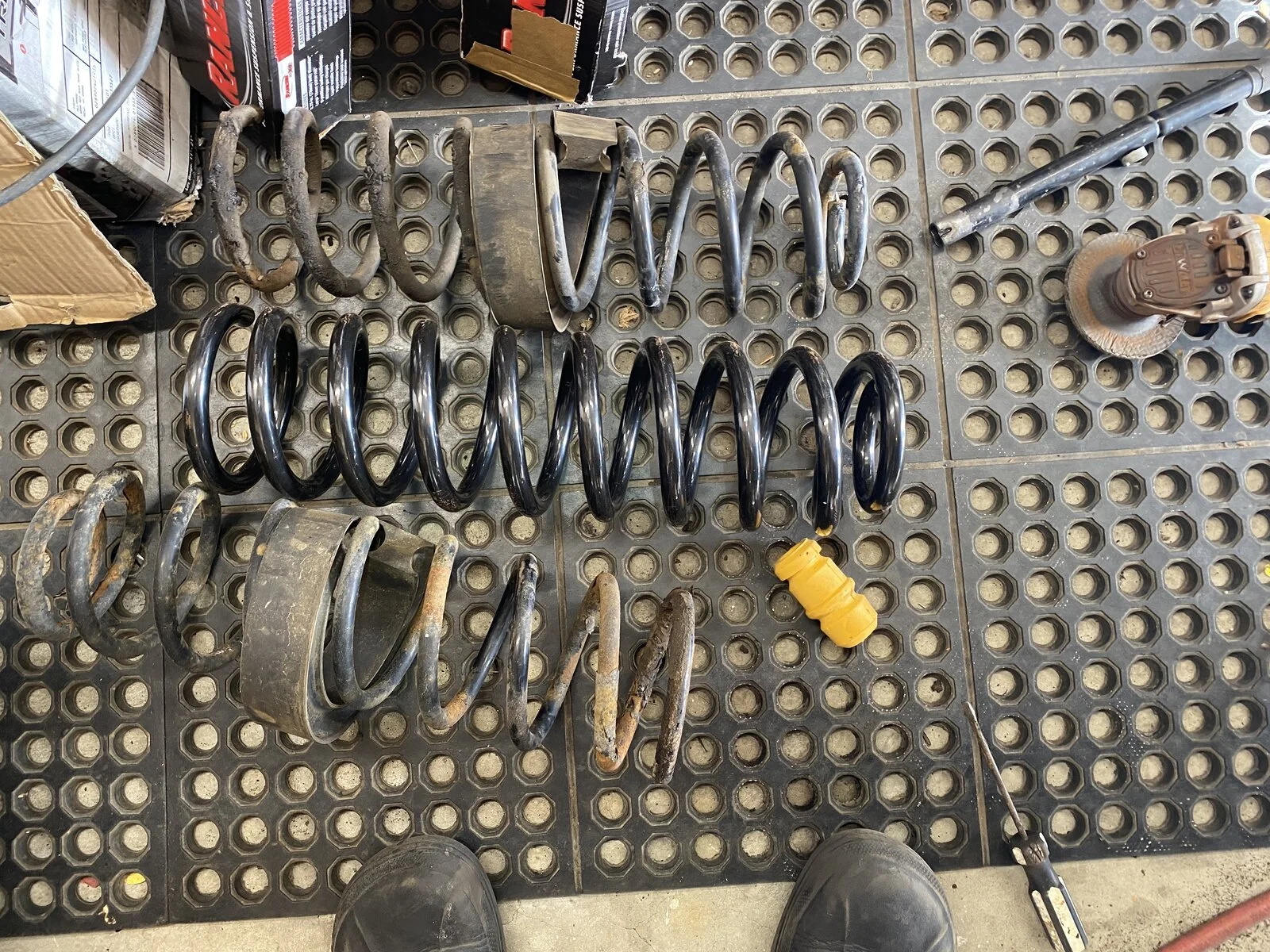

The jounces were toast. New ones much better.

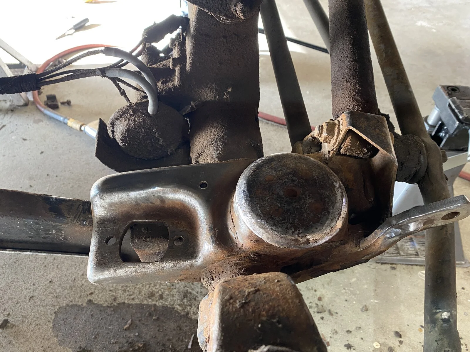

Lots of surface rust. Did the best I could to prep and paint the lower perch and shock mount area.
Shocks and coils on.

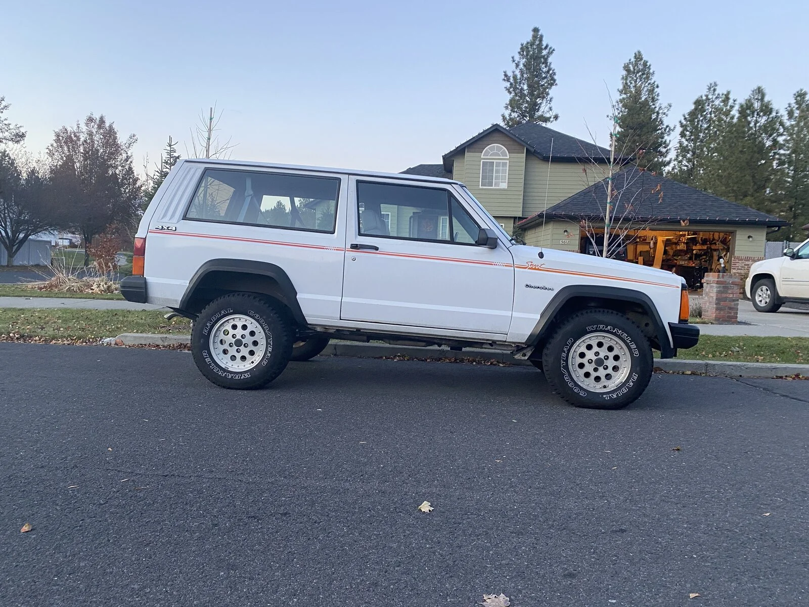

Very little rake. Going 32’s?
Going to go to 31's and see what happens. The 3" for XJ's is usually a 31 max tire size without trimming. The good thing is that there are no driveline vibes. That was a goal. I didn't want to get into it that far. This is my daughters XJ. Right now I'm about $1000 total into this rig.
Yes, very little rake if any. The front is slightly higher than the rear, but it's hard to tell unless you are really looking.
That’s going to look good. (y)
