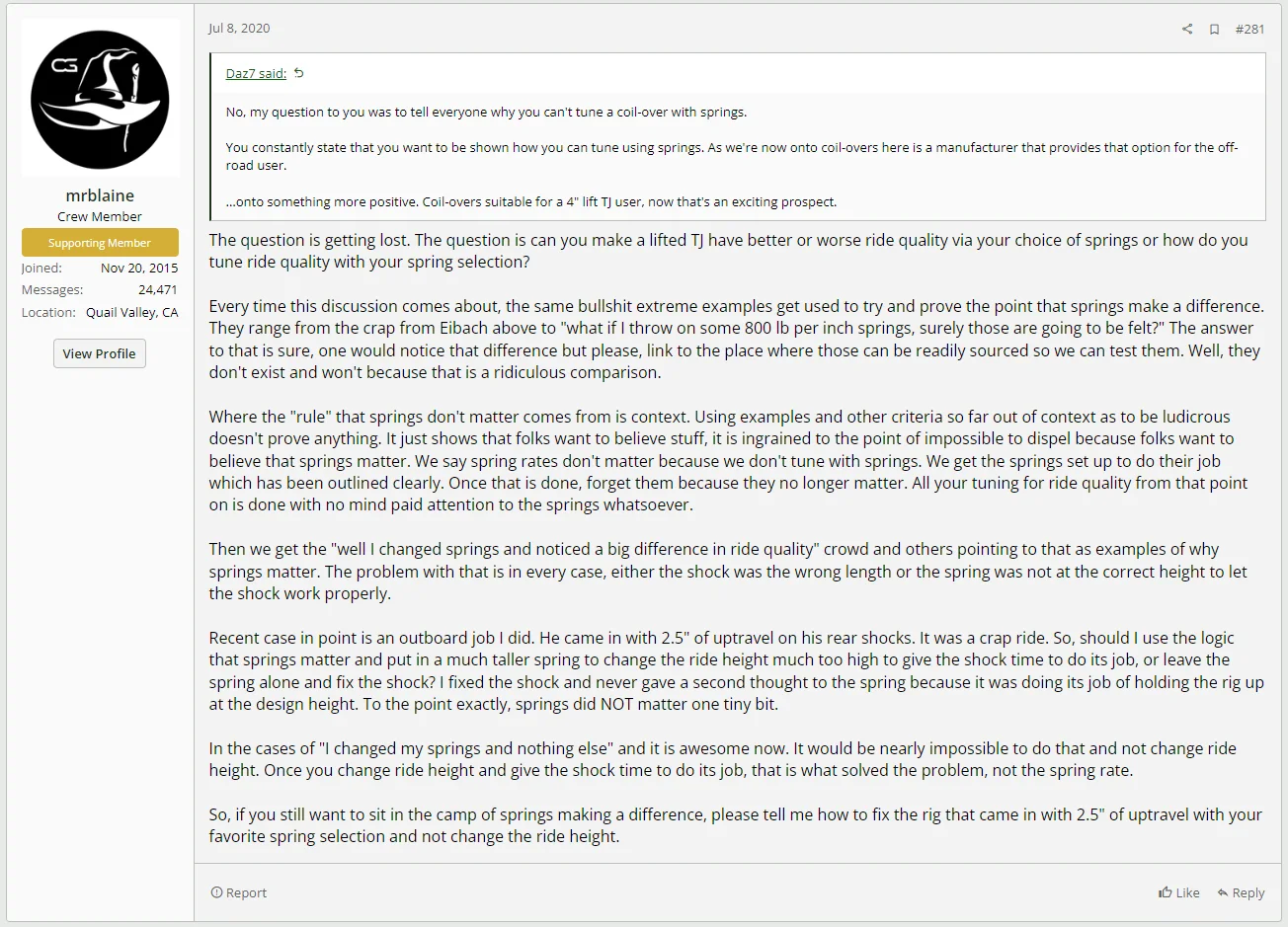

There is really little benefit to a good honest discussion about much when so many are still struggling with just the basics. I'll be glad to discuss anything of value and importance the day that everyone accepts the truth about springs and pulls their heads out of their asses. You figure out how to make that happen and away we go, until then, not so much because why?

You continue to obfuscate, and I think to some level intentionally. This is in the same vein as the bomber fab comparison - what is missing is the context of that statement. All that needs to be said on this topic has been said multiple times over. Below is one of the best summaries - and I am sharing this not for you, but for others that may see this ClusterF of a thread and happen to come this far out.
