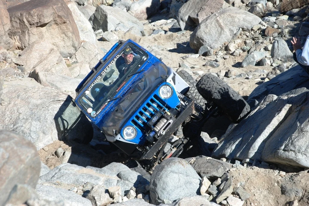

Even this TJ, built by mrblaine with a suspension lift and bigger tires, had no problem with rolling as shown here. The camera for this photo was being held level so the amount this TJ is tipped to one side is not exaggerated. Nope, it did not roll.

Low-COG builds for Wranglers are simply not needed. Though I guess It would be possible for a clueless type to build his Wrangler to easily tip if he fucked up and screwed up every possible thing that make it easier to roll but it would be a terrible build by a clueless dumbass indeed that might raise the odds of a roll/tip.
My favorite part is how much fun that guy is having. Look at that grin!
