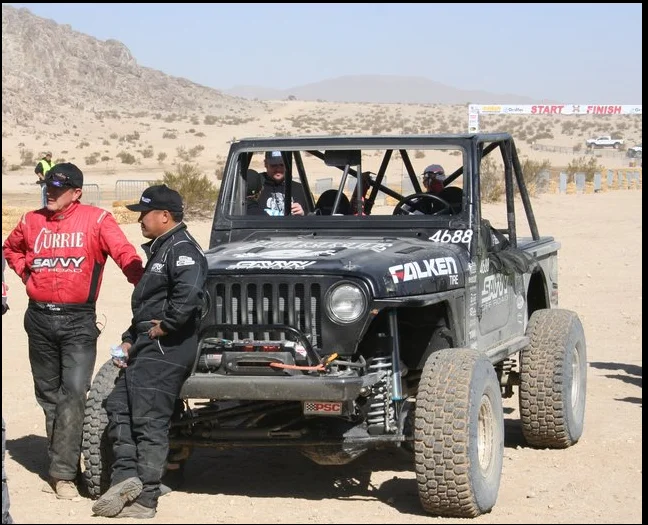

nearly stock rig beat the crap out of a fully built race rig... almost 2 full hours over the next stock rig. John Currie then had to choose between racing against or co-driving with Casey Currie
That wasn't Glen Helen. That was the first EMC they raced in.
Ran out of talent today! Bittersweet win today at Glen Helen . I was the last 4600 on the course and did a nice roll. Lost enough tranny fluid so I could not complete my 12th lap. Dallas was right there to pull me back to the pits. Thanks Dallas!

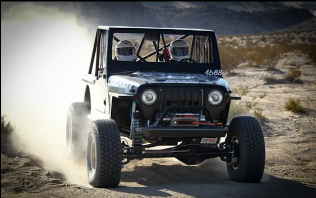

Oddly, there is a lot of dissecting discussion about the Savvy mid-arm. For reasons unbeknownst to me, there always seems to be a very large memory block of where, how, and why that particular suspension came to be a product and why it even exists.
https://www.moderntiredealer.com/articles/28054-team-falken-scores-second-win-with-savvy-off-road
Can not hate on something unless you leave out some of the facts.
