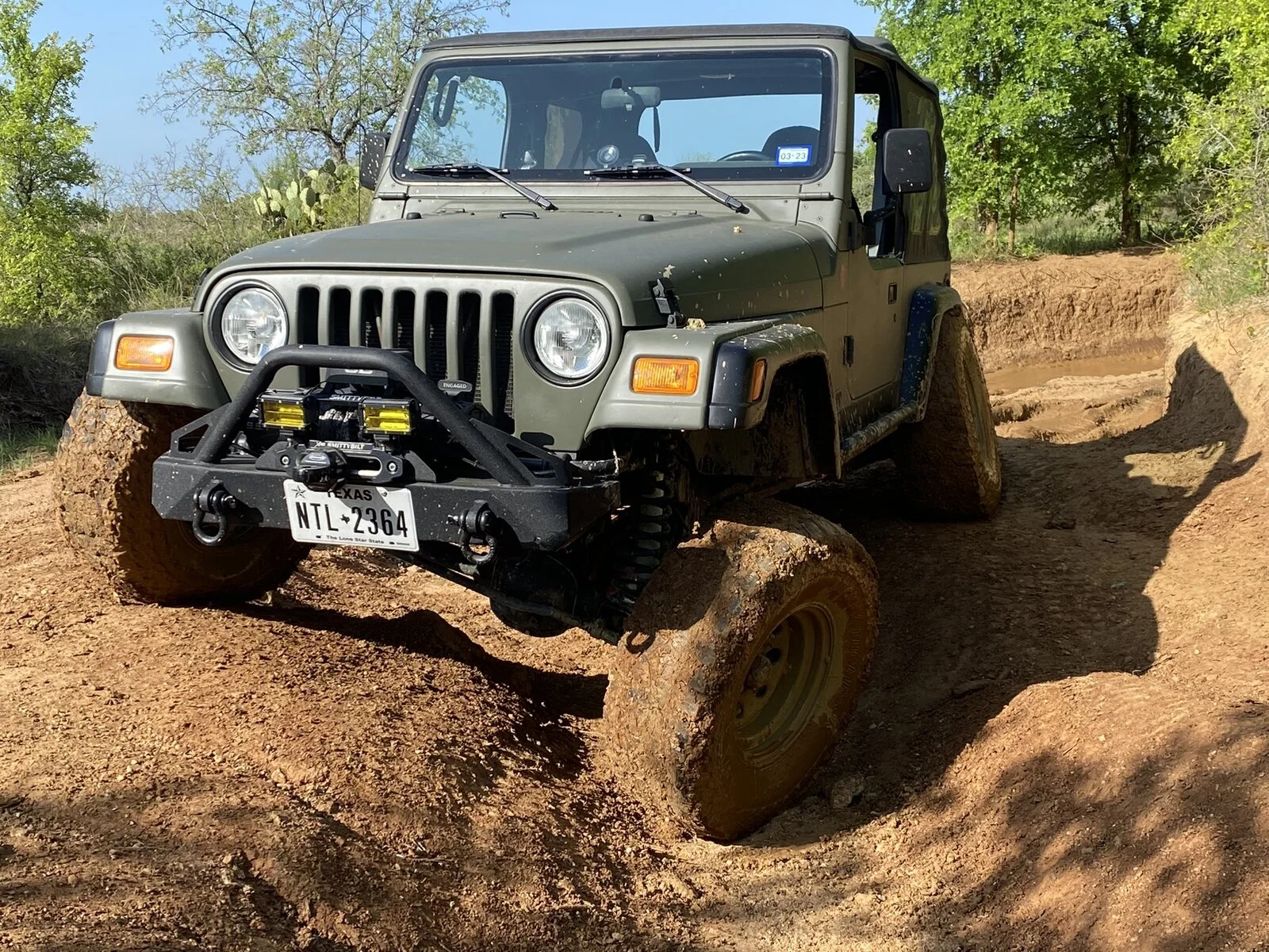

I am running 33s. I pieced together a lift with 2” ProComp springs, Rancho 5000x shocks and added a Daystar 1 3/4” spacer on the front. I added the spacer to level the front because of the front bumper and winch. Some may disagree with the spacer but it works for me. I haven’t added any bumpstops. I get some fender flare rub at full stuff but the the plastic flares give nicely when stuffed. I didn’t have to do a transfer case drop.
Kevin
Great looking Jeep!
