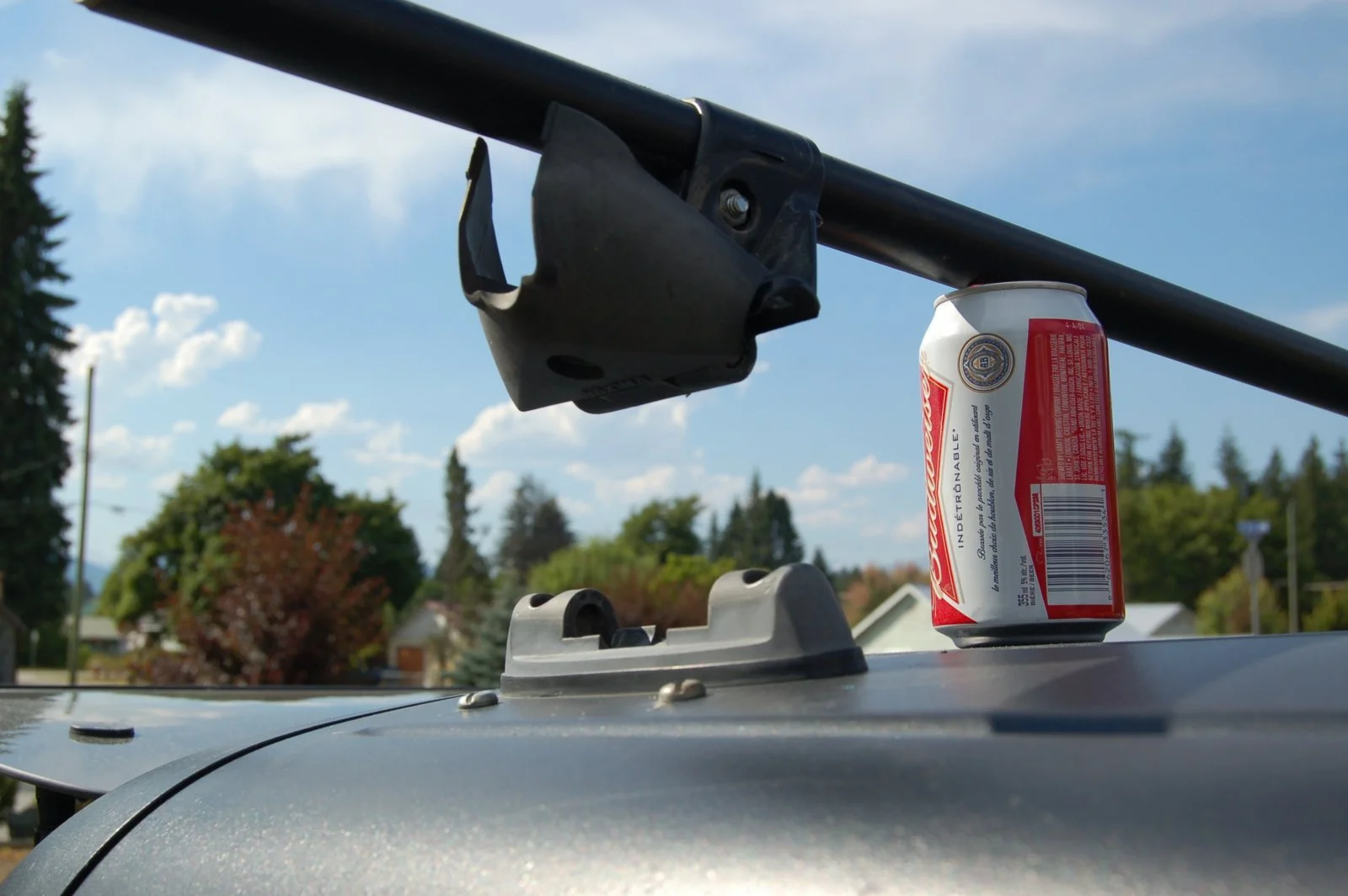

I lift mine using the roof racks.... those use 8 bolts plus a load distribution wedge. not so sure about 4 eye bolts tho. Heres the Yakima system...
