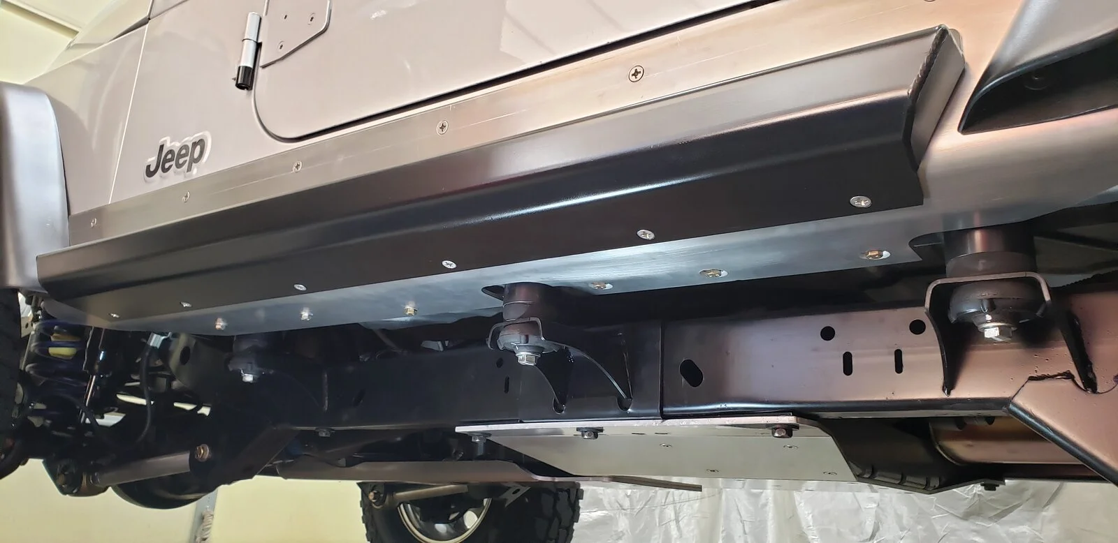

I mean that your understanding (and therefore your conclusion above) is incorrect. Smittybilt sliders and the rest of them designed similarly are junk.
Understand how the body mounts work. Understand how those three mounts under the doors sit in dimples on the underside of the tub and how they are very purposefully designed to compress a specific amount to carry the weight of the tub, while also unitizing the body and frame. Understand what the torque boxes are for. It will quickly become clear why why it is dumb to sandwich a slider between the body mounts and tub.
Good sliders have many bolts going into the body and torque boxes and leave the body mounts to do their job. Here is a good slider. This thread has some good photos. There are many threads on frame mounted vs tub mounted, spend some time reading and thinking. If you want the final cliff notes, read this post written by someone that truly understands this stuff.

I waited for a year and a half for savvy and they never became available. Genright is the next best thing in my eyes, and if you dont want to do the miniboats they have regular rock gaurds.
