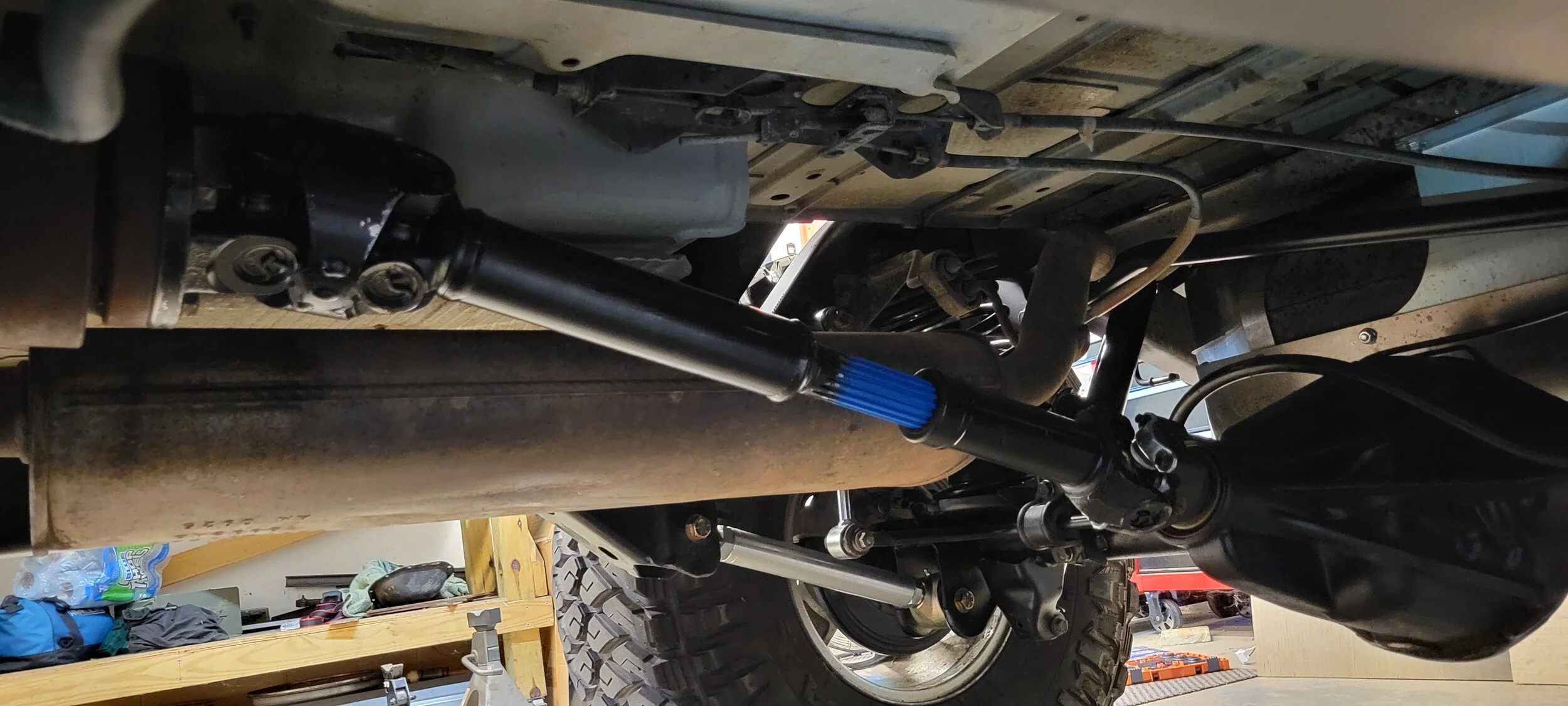

Question for anyone who has one of these. Does your cv have the spicer boot? I ordered one for the front shaft rebuild but noticed the tom woods shaft doesnt have one. Is it needed? It seems it would be subject to a lot grit and such but maybe the boot keeps it in. Factory cv shaft has it. It looks like tom woods uses a smaller seal. Just more curious than anything. View attachment 533152View attachment 533153View attachment 533154
Is the tom woods a greasable centering yoke? That extra part looks like its for a factory non greaseable centering yoke
Yeah that's why it's different and your right. That would be why my factory cv has one. Good news is the new yoke I have for the front won't need it because I am putting in a greasable yoke so we are all good. I should have checked that greasable yoke first.

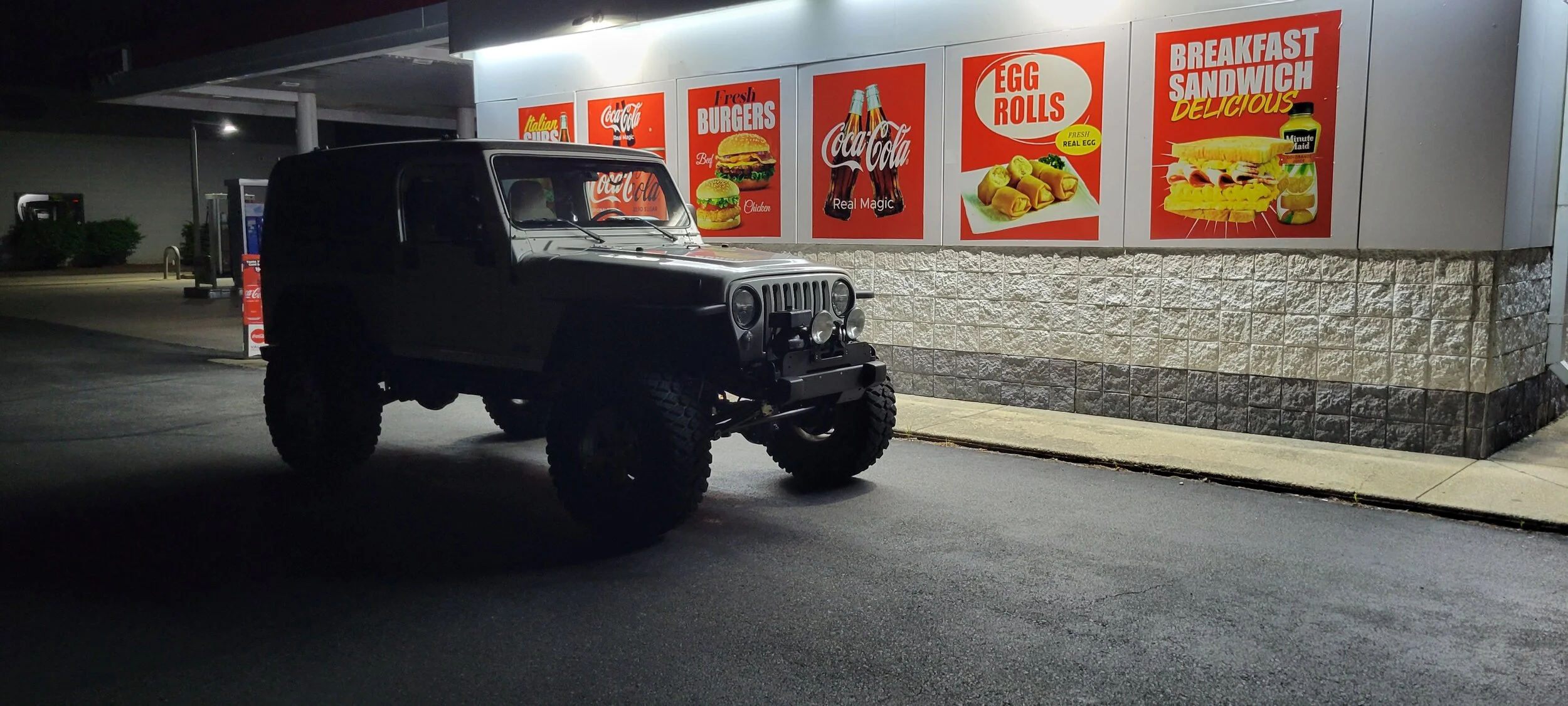

It's alive!
Ride is good. I need to do some more testing to see if anything needs adjusting. Diffs never got over 160 so that's good.
Just ran around the industrial park some. Idle has abit more vibes than I would like. Hoping that will settle some as I couldn't see any tub contact at idle. It did settle down a little during the test run.
What was amazing was the big brake kit. @mrblaine makes a fine product and it locked up the 35s during the break in. I saw smoke roll past the headlights and that infamous burnt rubber smell immediately after. Nothing else was burning because I had to pull over and check.

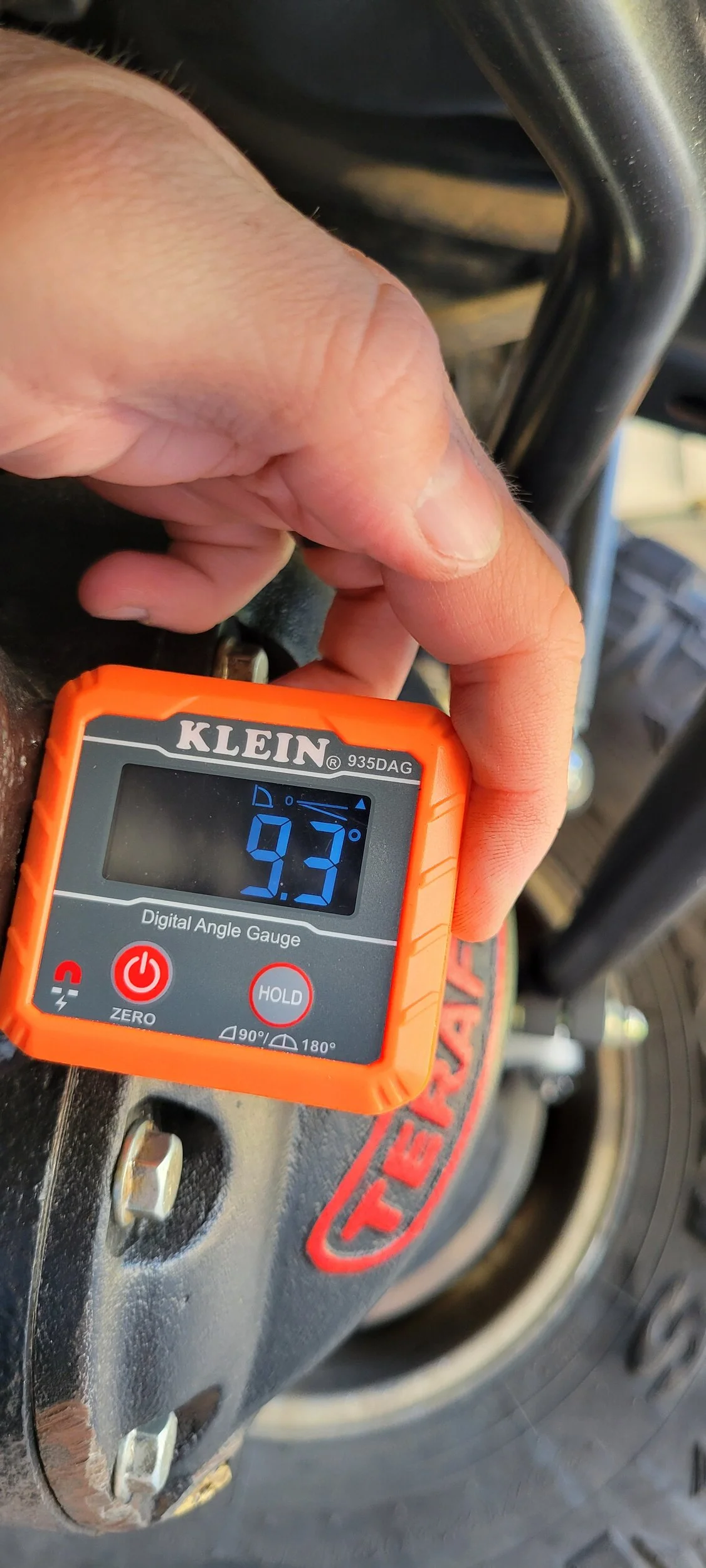

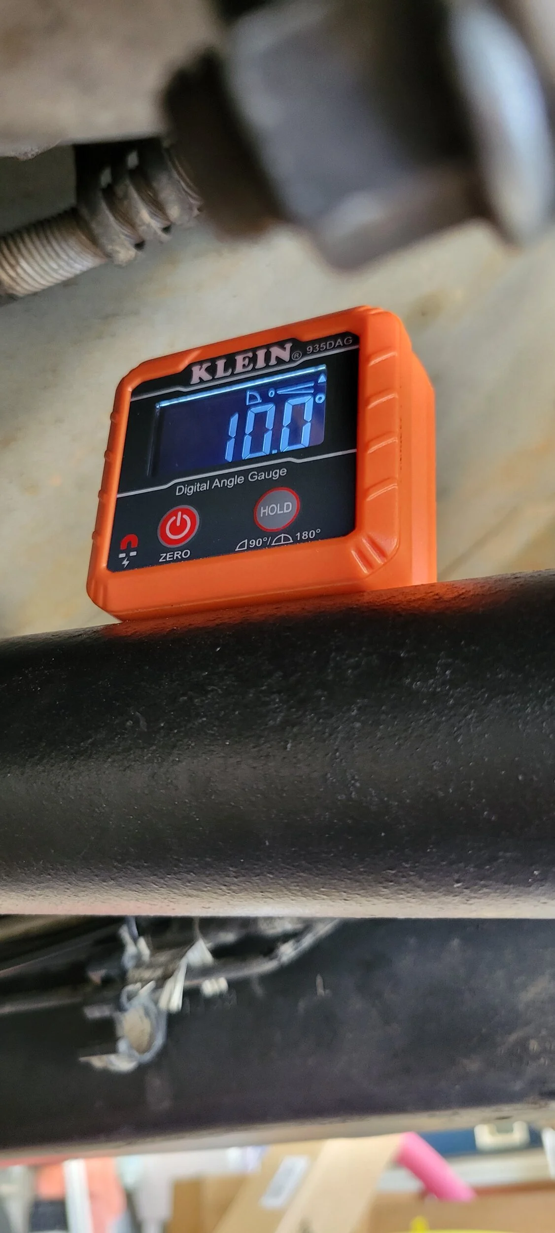

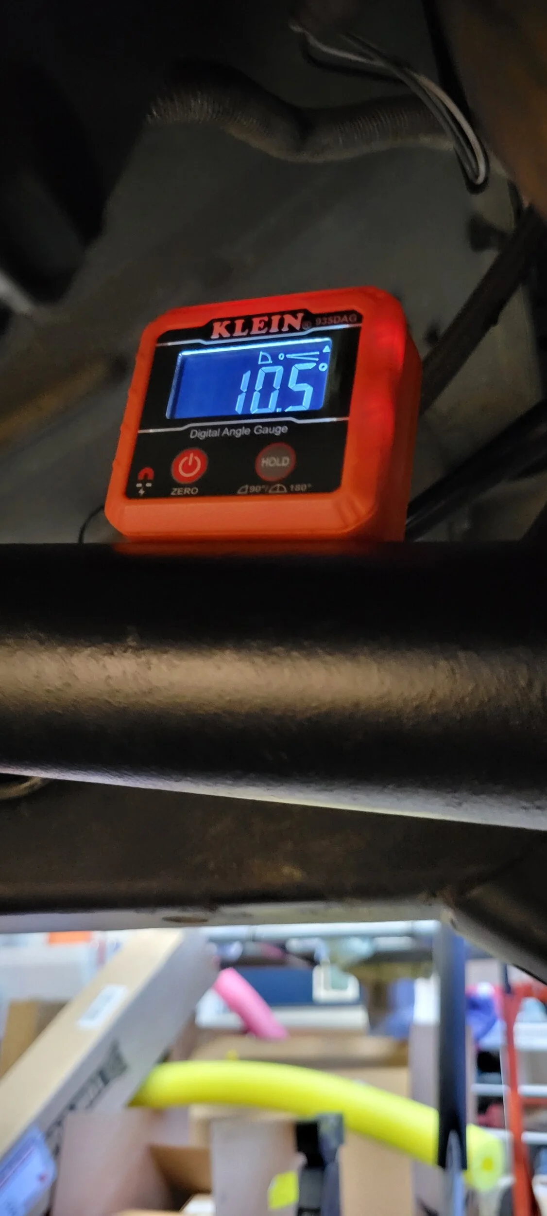

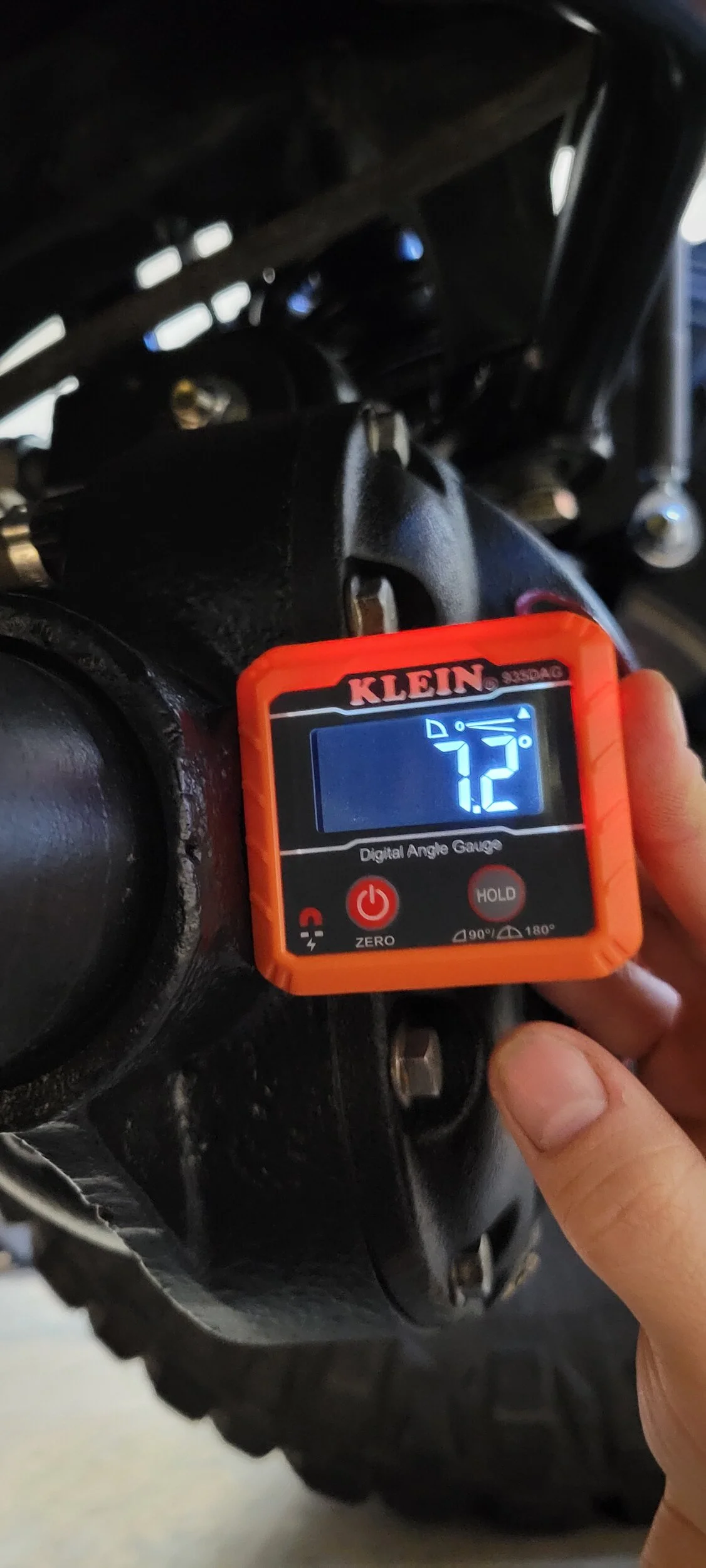

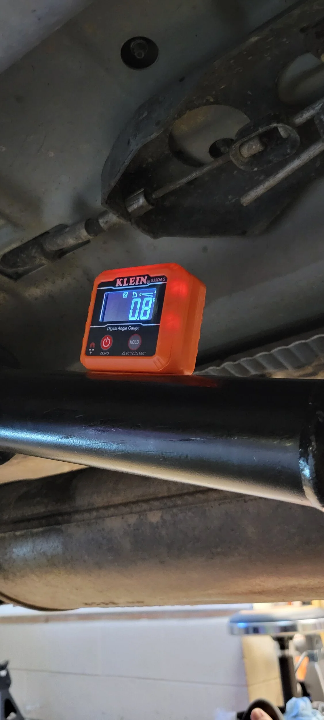

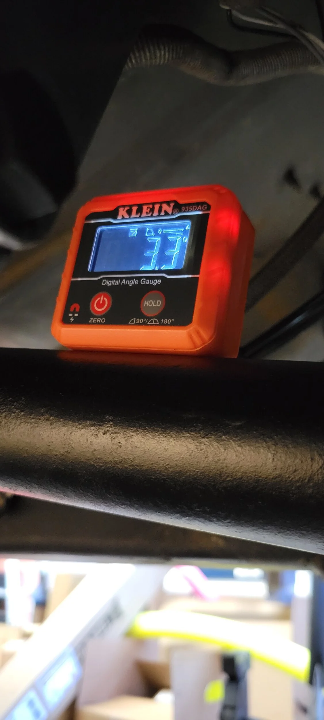

I need to adjust the front a pinion a little more. I have just over a 3 degree delta between the pinion angle and drive shaft angle. I noticed a small amount if vibes but nothing crazy but I haven't gone over 50mph yet with the gear break in.

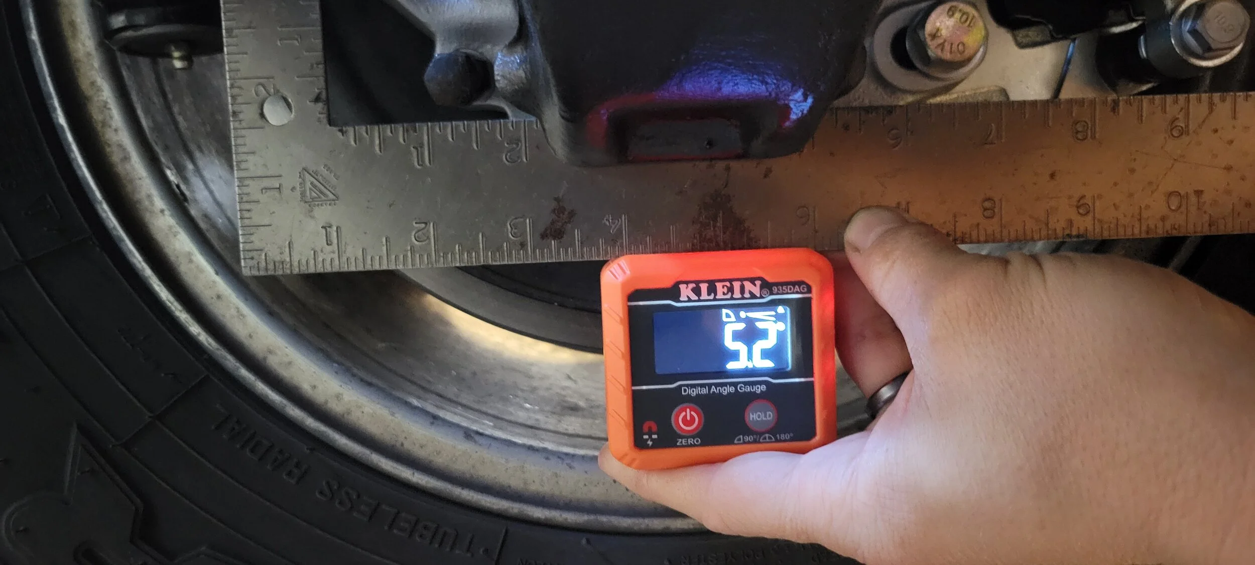

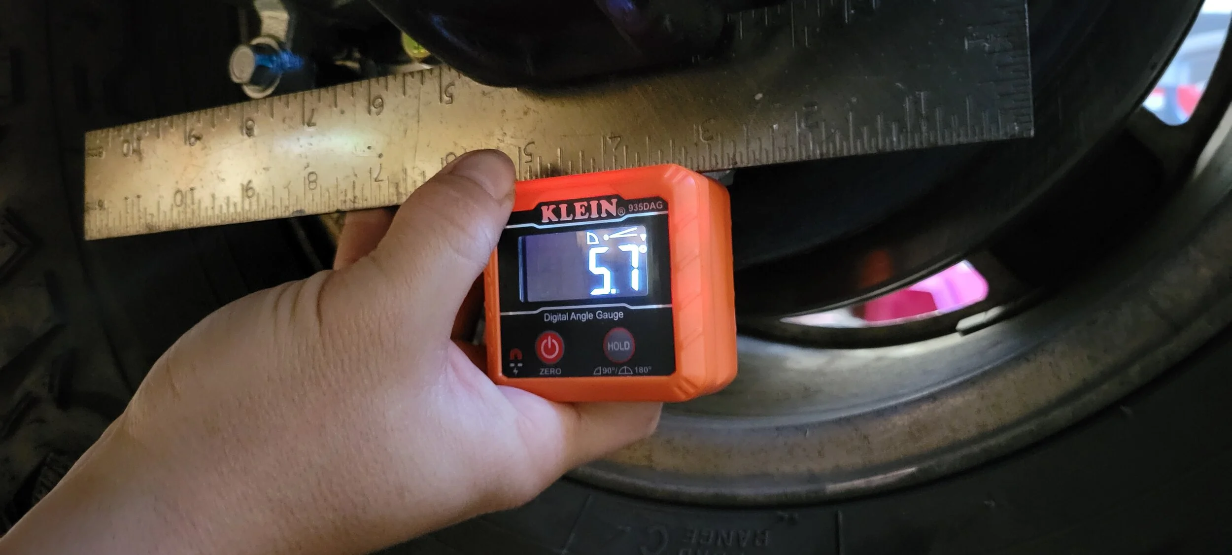

Caster is around 5 degrees right now for this hpd30.
Drivers side
Passenger side
Rear pinion is 1 degree lower than the ds and seems be running smooth!

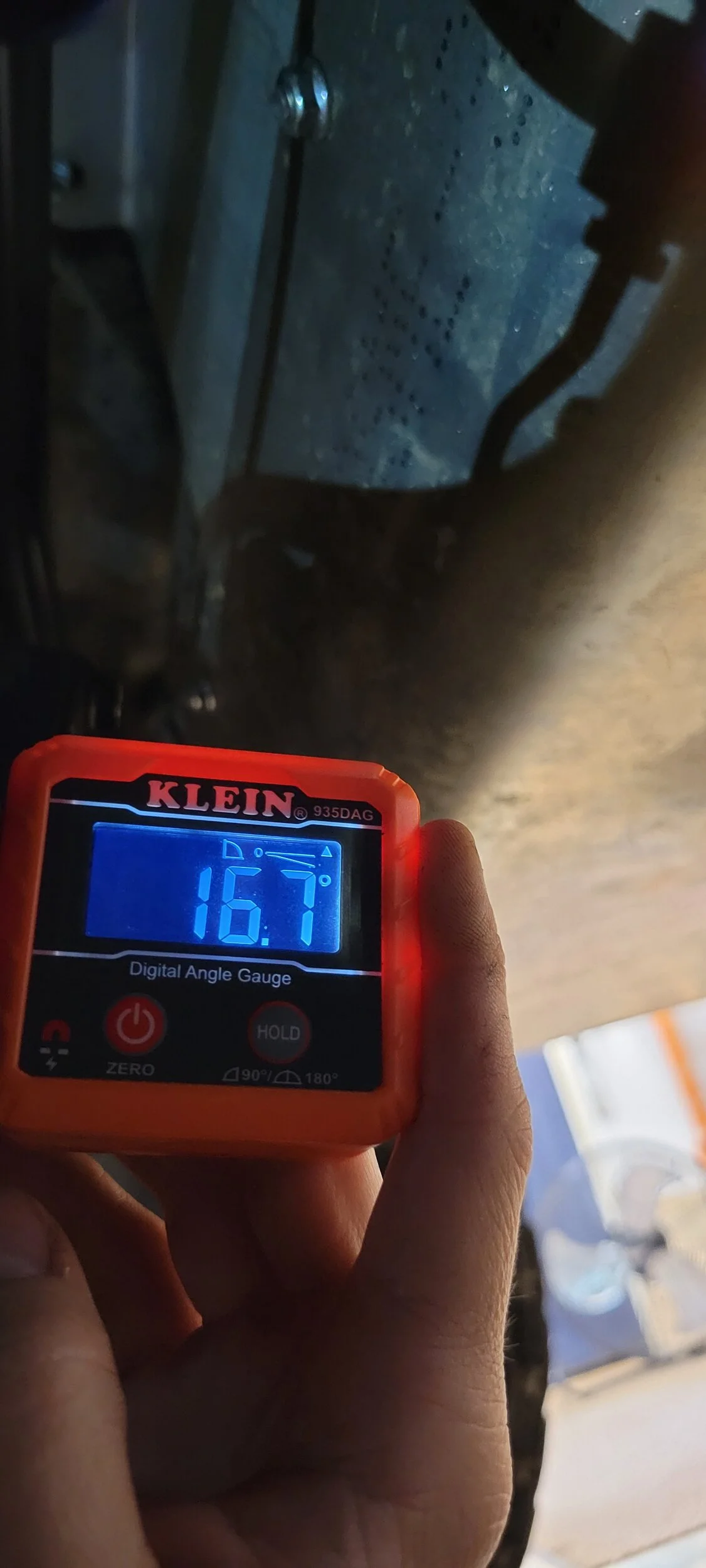

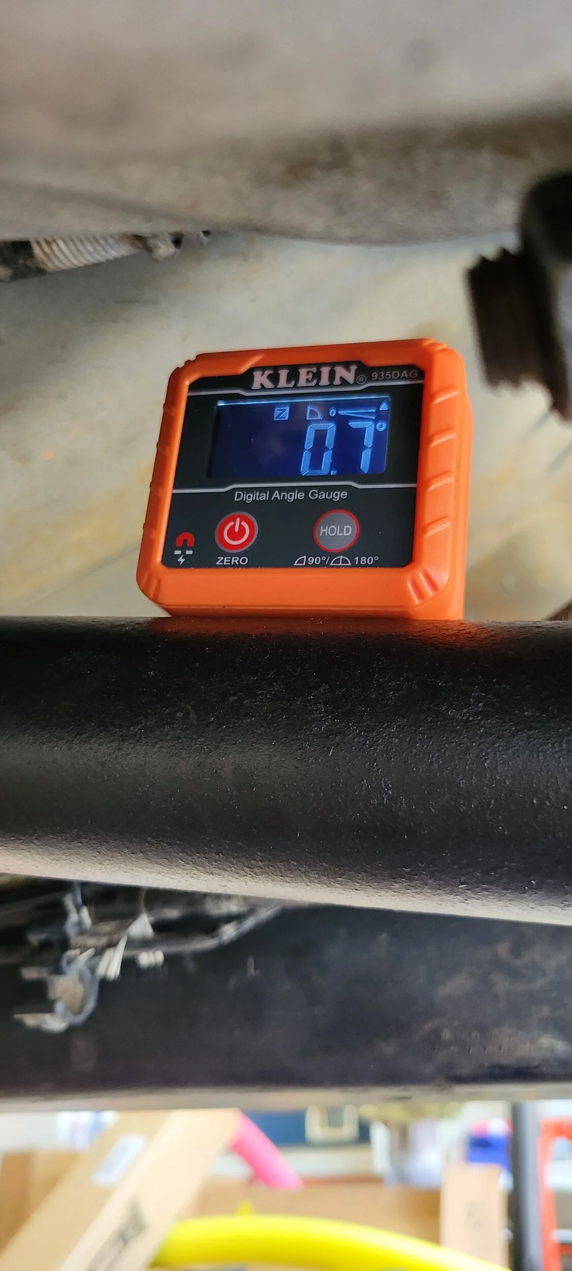

Adjusted the front pinion angle to under a degree of difference at lunch today. and took it for a spin. Vibration is very minimal. I get some when slowing, almost to a complete stop but that maybe more tire related than drive shaft.
I will drive it around some more for testing. If needed I should be able to adjust to zero difference.

Caster is between 3.5 to 4.

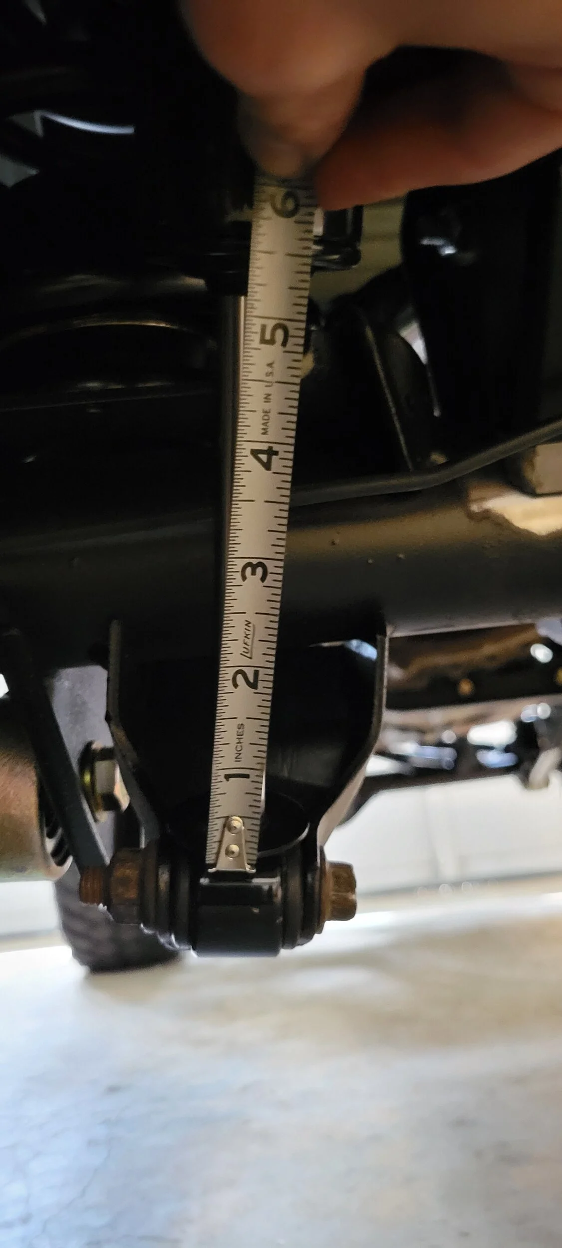

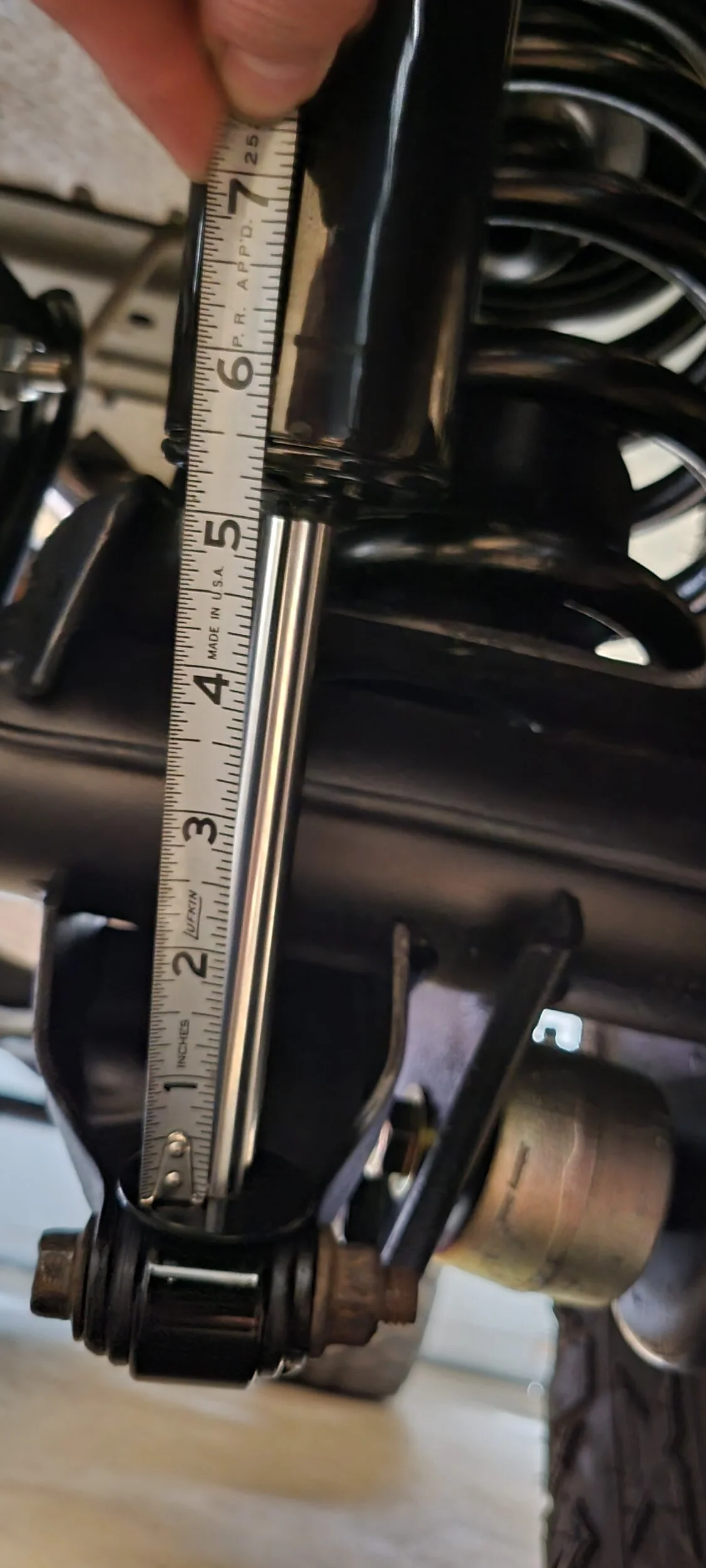

The ride with these blackmaxx shocks seems softer than my previous Ranchos. Especially the rear shocks, b8528. I thought the rear shocks would have a worse split than this. Initially it was pushing 7 inches up and 3 down.
At ride height it's about a 52/48 split with currie lj springs and a full tank of gas. Roughly 5.125 up out of 10.02 travel shock. I am really happy about it as it should leave some room for squat with kids, a cooler, tools and trail gear.

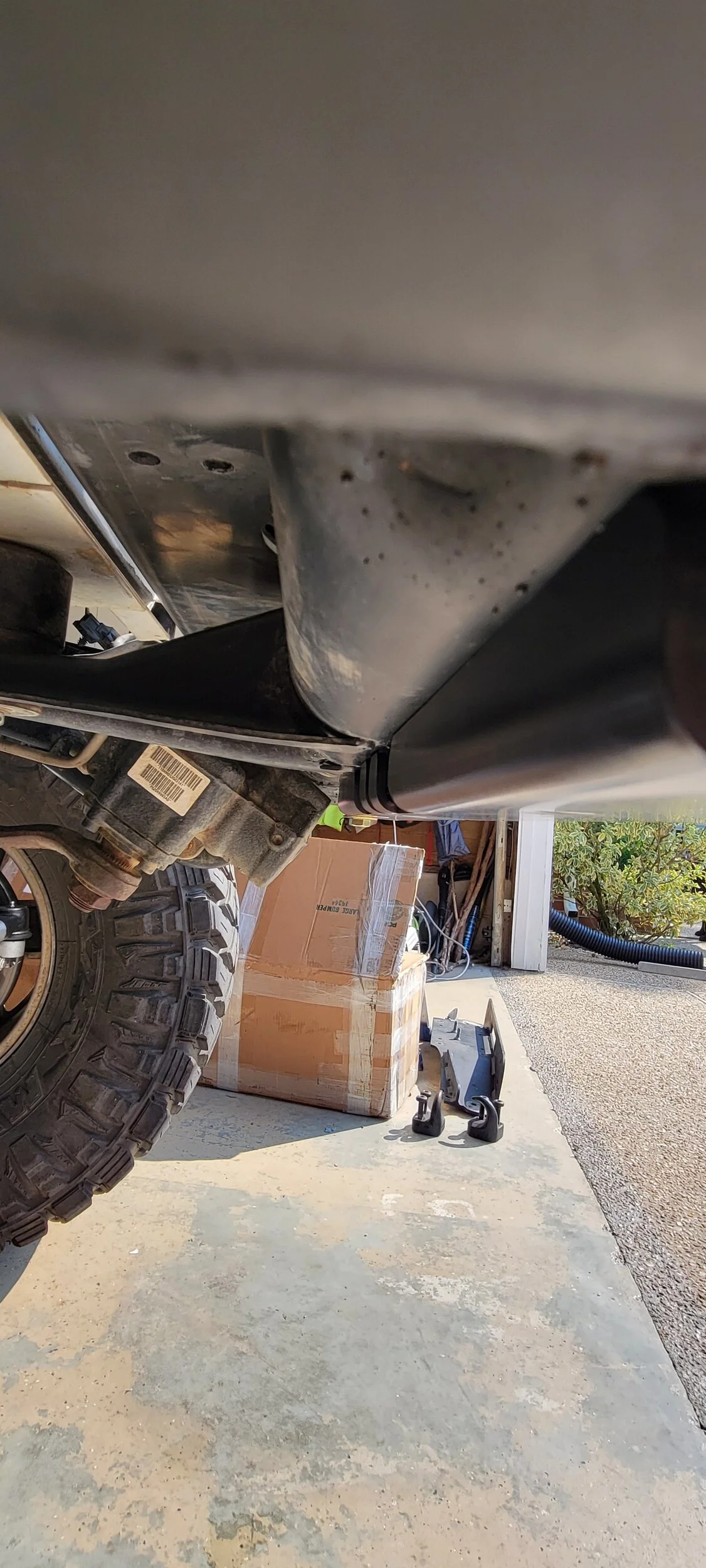

@Irun did you run a walker exhaust on the lj too? I couldn't find it in the build thread but I may have missed it. I have the muffler and 2 band clamps on order. I may be able to just reuse my factory tail pipe with an extension since it seems the lj muffler may be longer
I haven't yet done my Savyy belly skid, so my muffler is still stock. Once I install the belly skid, I'll do exactly what you said, i.e. reuse my good tailpipe, add in the Walker Quiet Flow, and use a piece of exhaust pipe to make up the difference. Technically, my muff;er is still in great shape, but it's huge and is only nominally quieter than the Walker in my TJ.

Thanks! My walker and clamps showed up today! My muffler has a small hole in it, which it's had foe while. Not from rust but a busted seam.
I was going to do all this when I weld up the trac bar bracket.

Is the LJ muffler any bigger than the tj version? My 05 rubi muffler was louder than the cheap napa muffler it replaced
The lj muffler is really big. I wouldn't be surprised if the difference in length is all in the muffler.

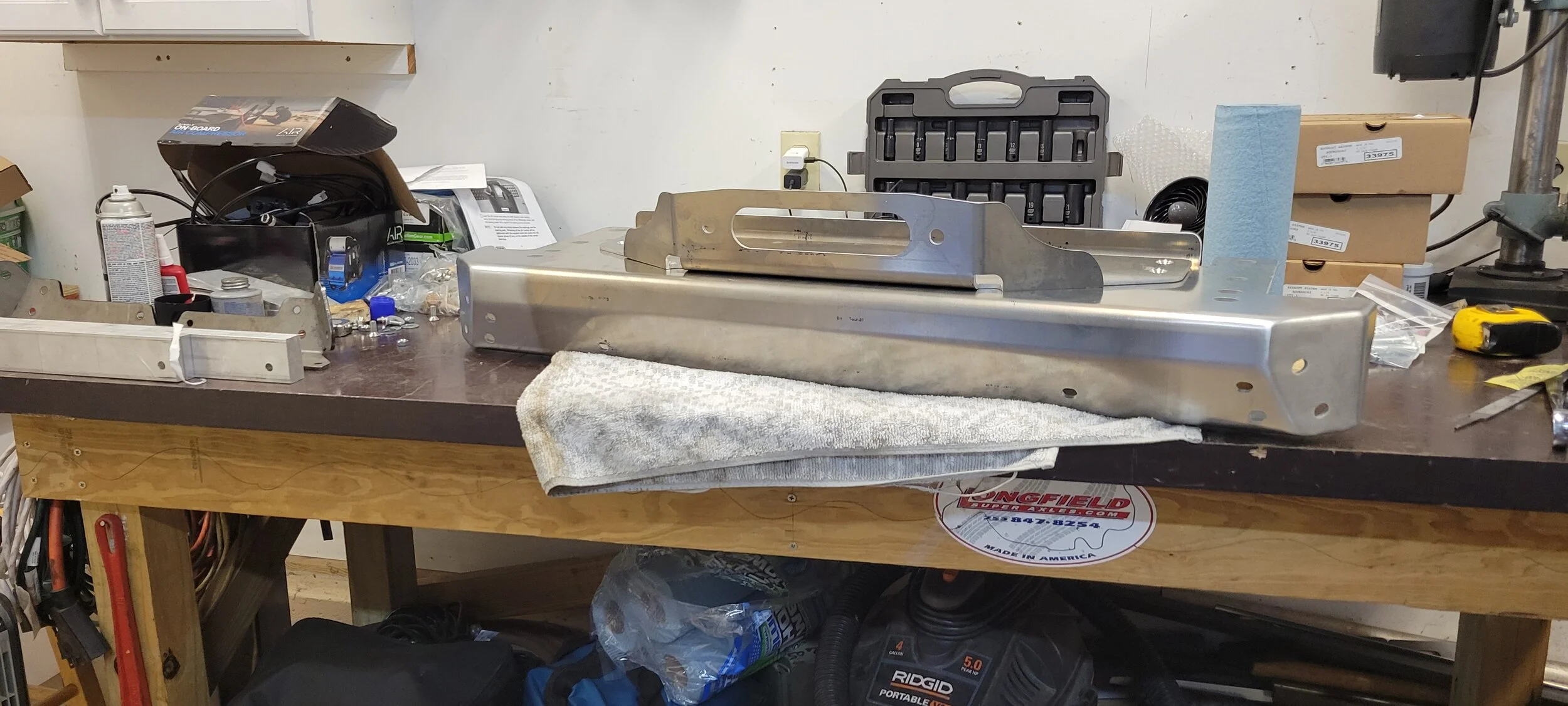

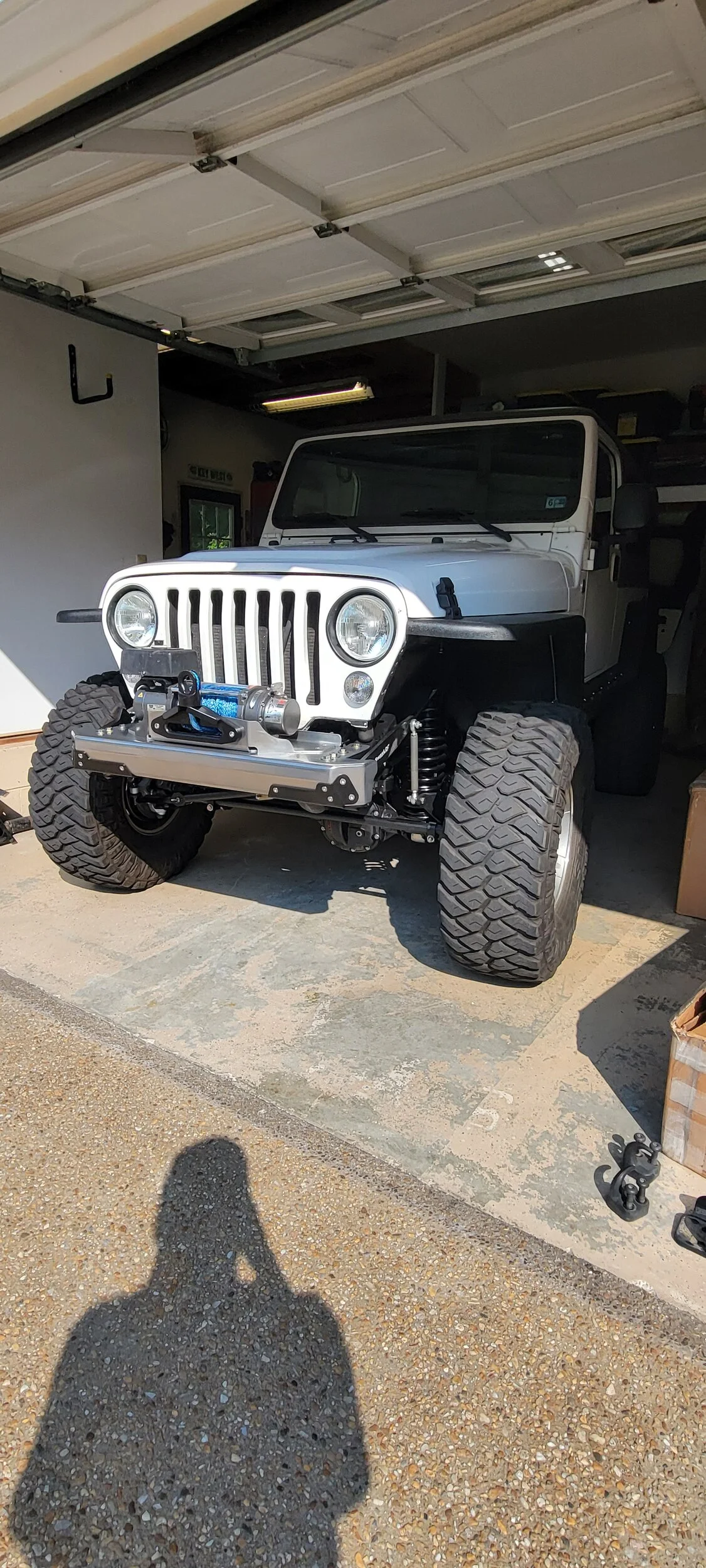

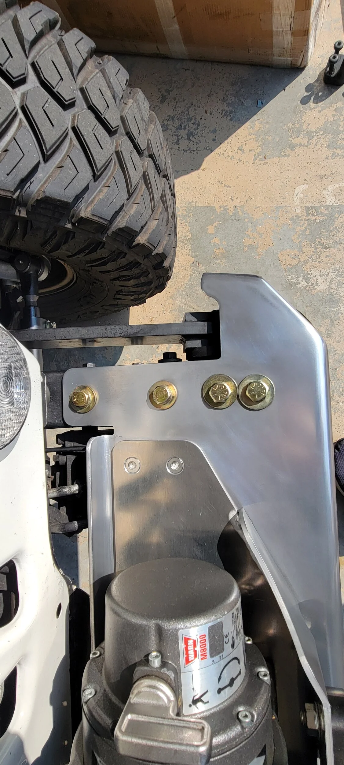

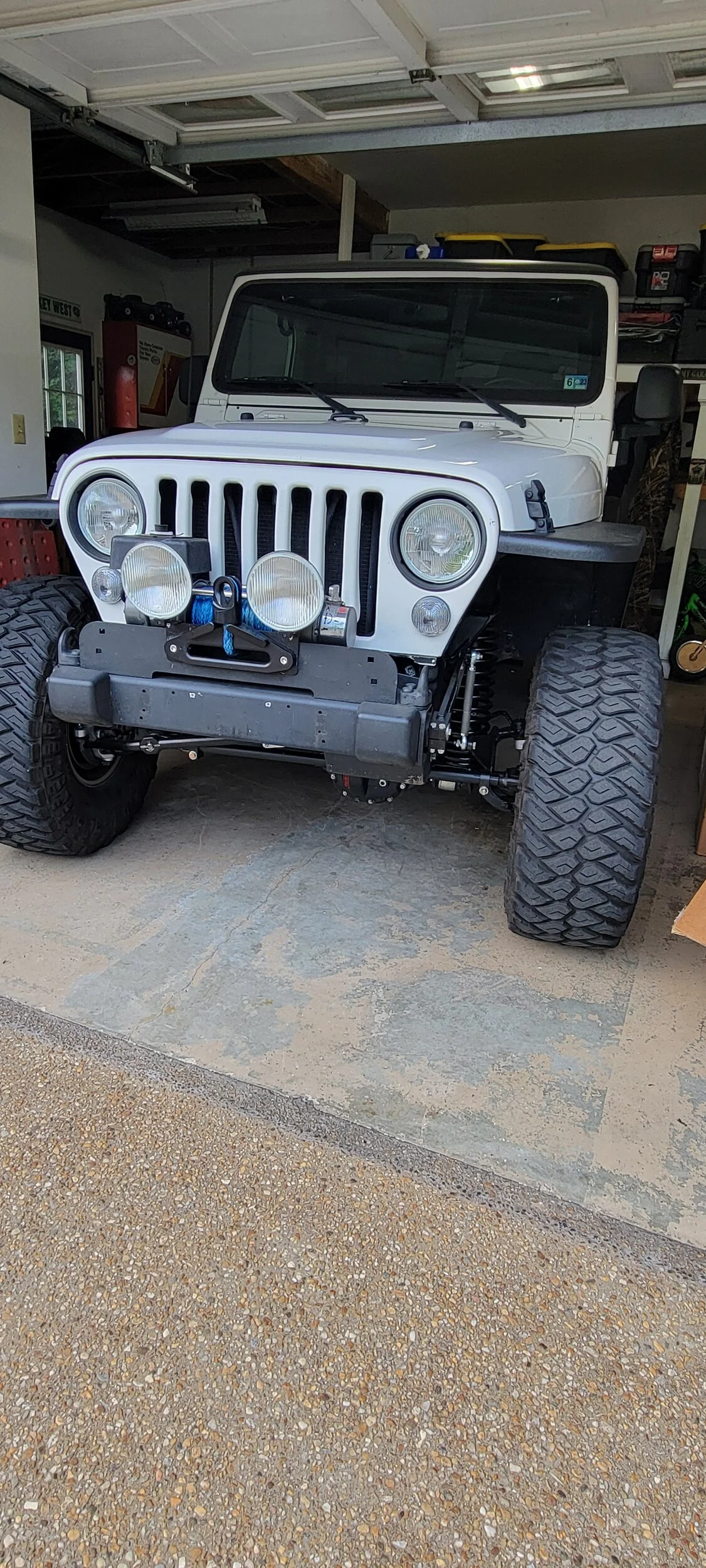

@Fluxor front bumper on! Polished it up and mounted the winch. It went on easy and I just blue loctite the smaller fasteners. No issues and is very well made! Clears the sway loc with enough room. Really dig it!
I can't decide if I'm going to leave it raw or try and polish it up a bit more. I sanded it starting at 800 grit and ending at 2000. Sanding was needed to blend the welding corners.
The winch mount was just polished as it came.
Before and after!
Before sanding and polishing
