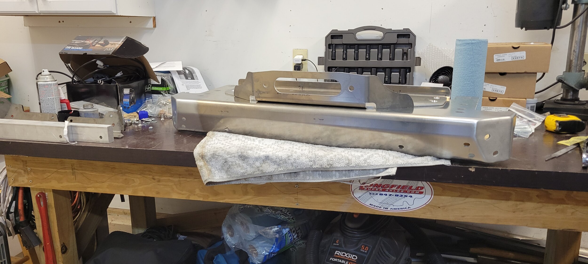

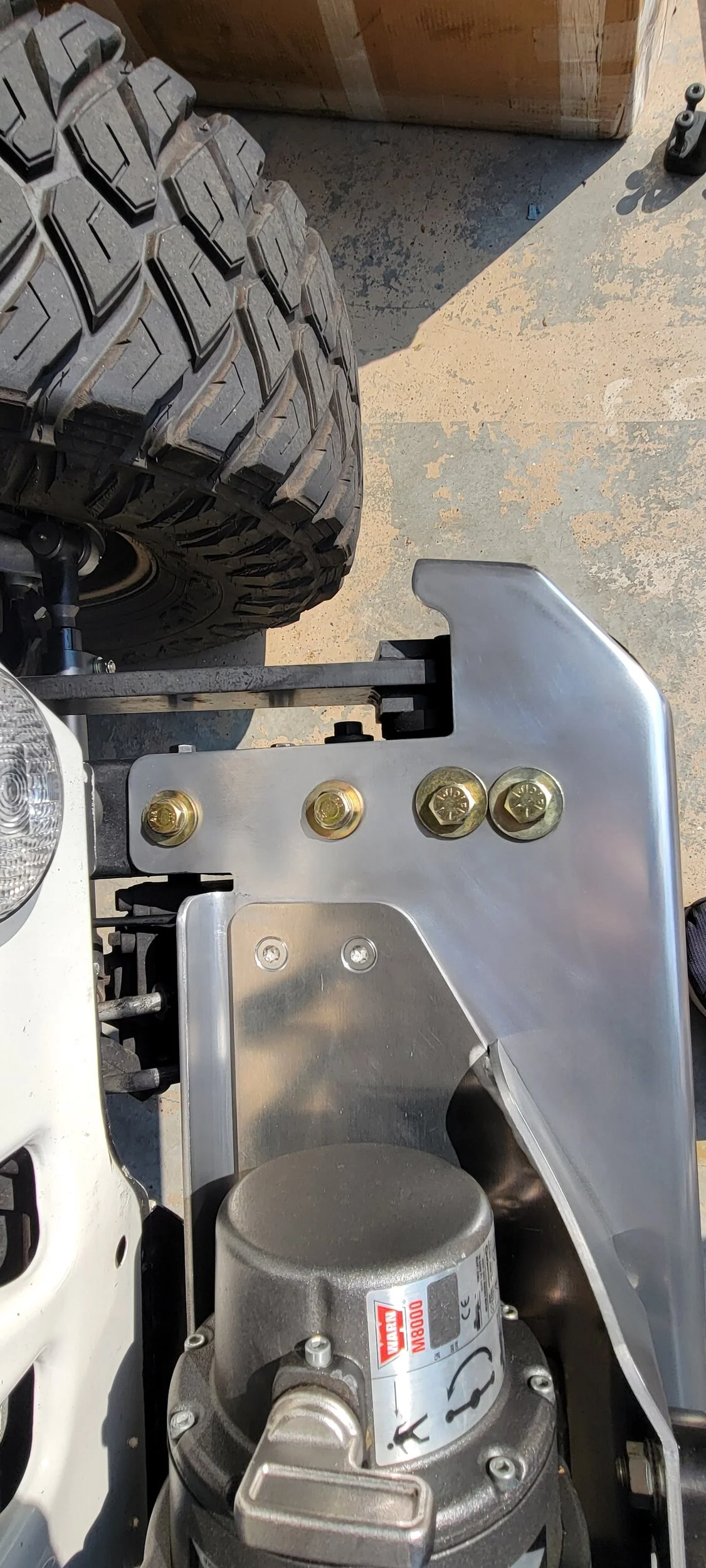

I used Chemical guys heavy metal polish and a random orbital buffer. Using it on the winch mount turned out really good. You tell the bumper is a little duller than than the winch mount. I did not sand the winch mount.
I may try some additional polishing compounds or some more sanding. The bends are the hardest to sand. I used a orbital sander as well for that. Hand sanded the round parts.
This the bumper as received. The blending is very good so I wonder what it would have looked like just polished and not sanded.
I did the same procedure as my sliders trying to match them. I may polish both as I think the corners unpainted would turn out better.

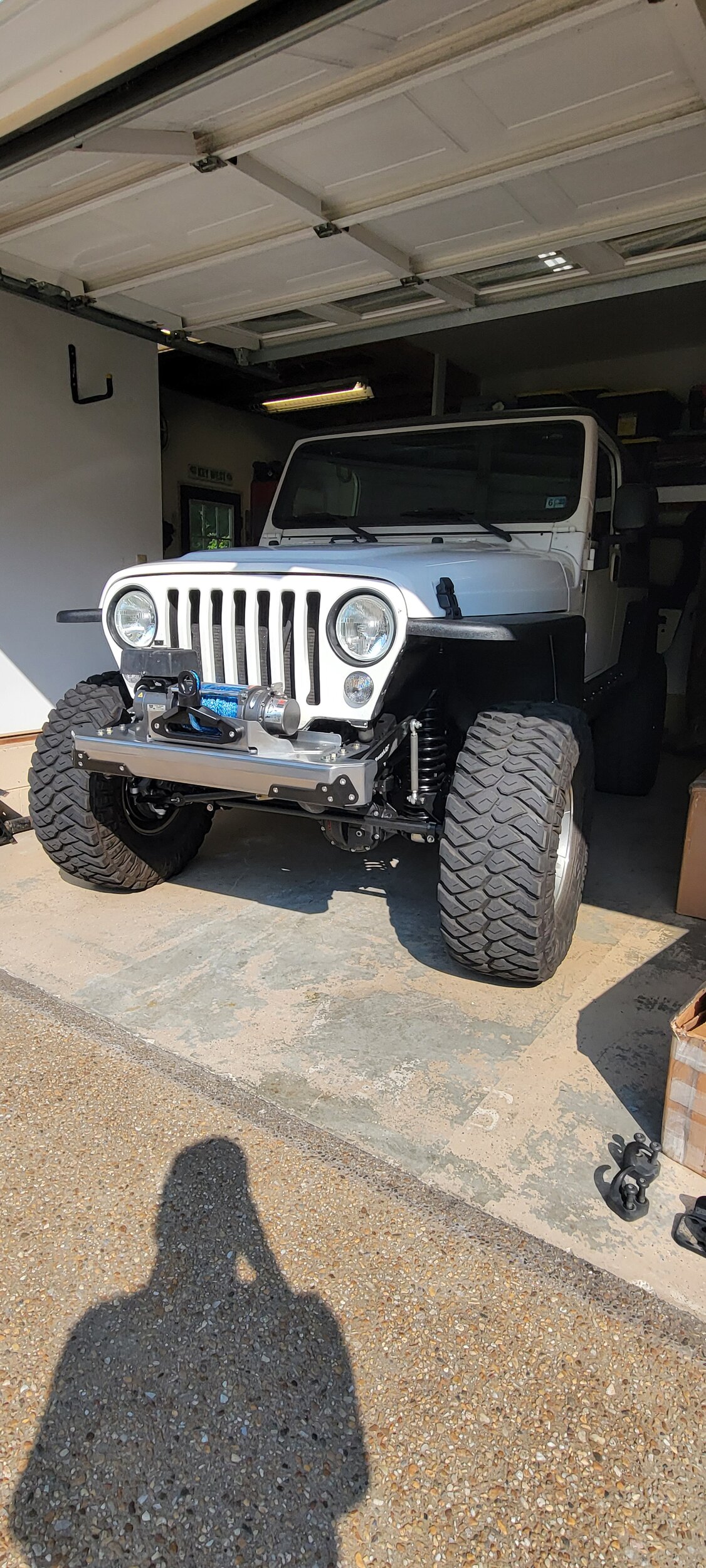

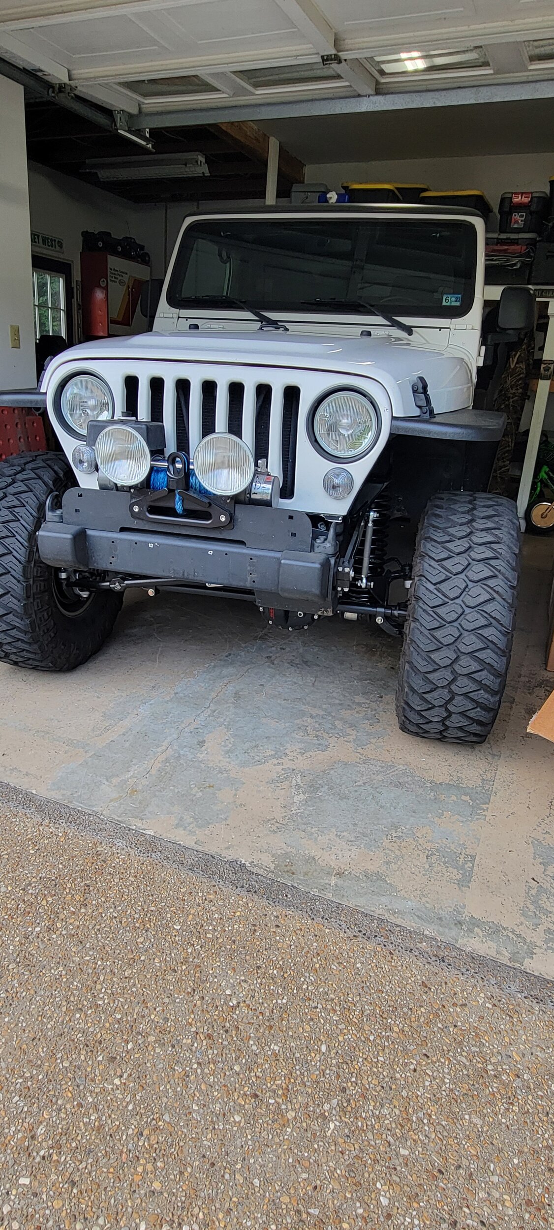

@Fluxor front bumper on! Polished it up and mounted the winch. It went on easy and I just blue loctite the smaller fasteners. No issues and is very well made! Clears the sway loc with enough room. Really dig it!
I can't decide if I'm going to leave it raw or try and polish it up a bit more. I sanded it starting at 800 grit and ending at 2000. Sanding was needed to blend the welding corners.
The winch mount was just polished as it came.

The Jeep is looking awesome. Fantastic work!

Very nice. I was pondering what to do about the steel corner guards - paint black, clear coat or color match.
But the black looks great, I might do the same.

Thanks! I thought about clearing them or doing a silver to try and match the aluminum. I figured I would try the black since the fairlead I'd black, my savvy sliders are black and polished aluminum.
I think it works pretty well and touch up should be easy.

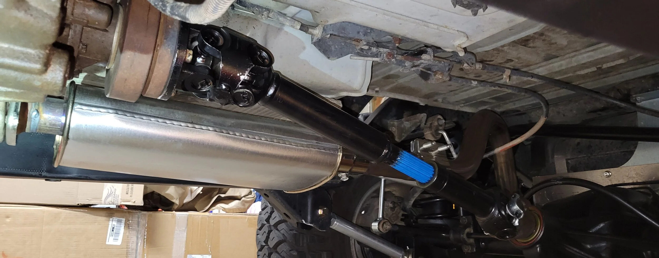

I was hoping to get this exhaust done today but walker parts are being uncooperative.

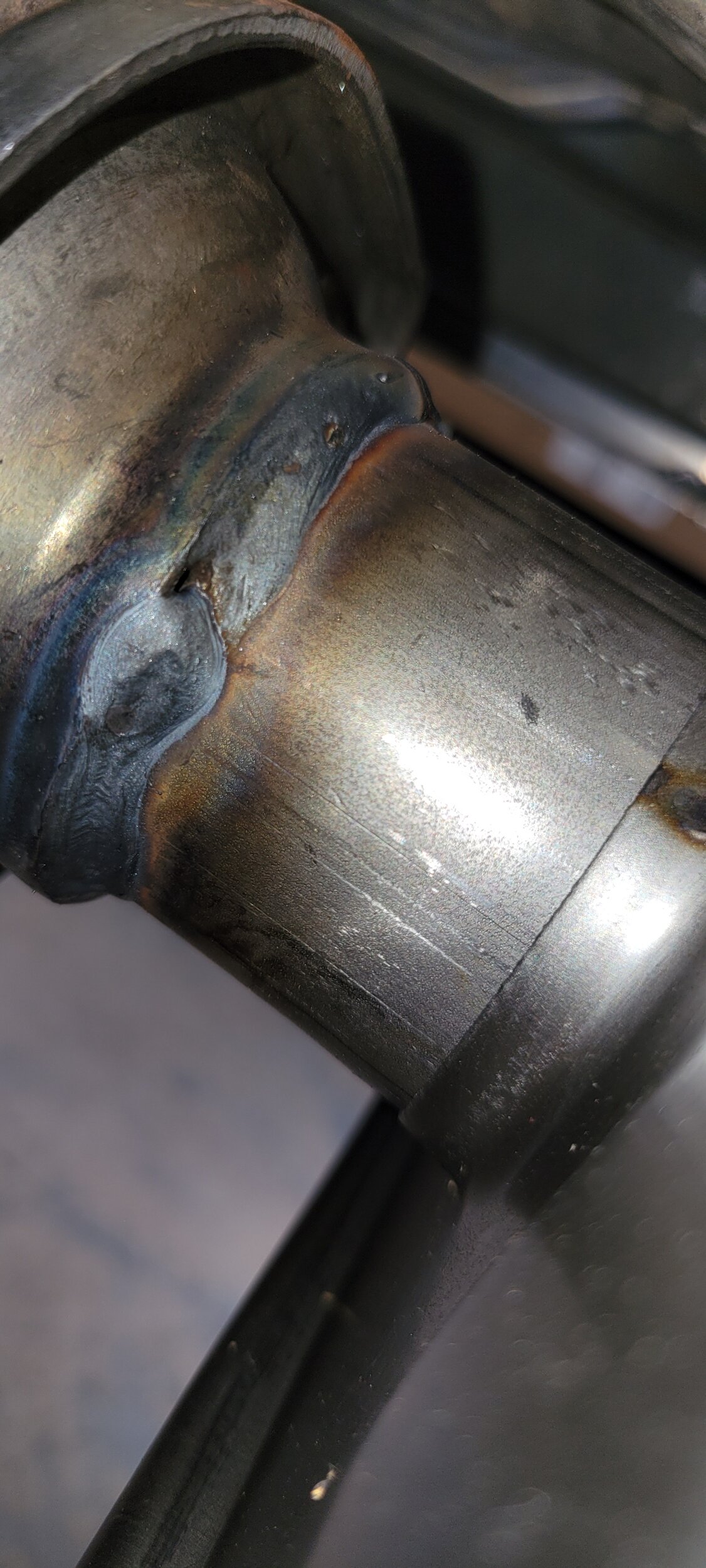

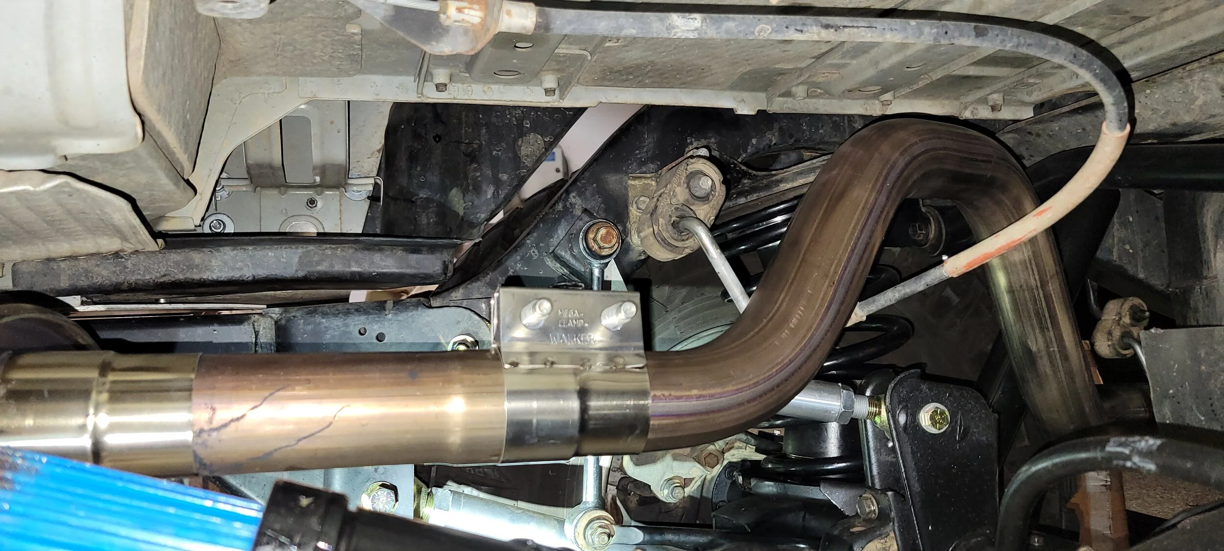

The new stainless walker muffler leaks. They didn't weld it all the way around at the cat flange and I didn't catch it.
My walker stainless clamps also leak at the tail pipe connections and won't get any tighter. No amount of adjustments seem to work.
I forgot how much exhaust work sucks.
I ordered a replacement muffler, lucky it was an Amazon purchase. I also am just going to take to a local exhaust shop to see what options they can offer on welding up the connections.
If going to a shop, have them weld in some v-bands so you can easily take apart the exhaust when needed. They really are a time saver.

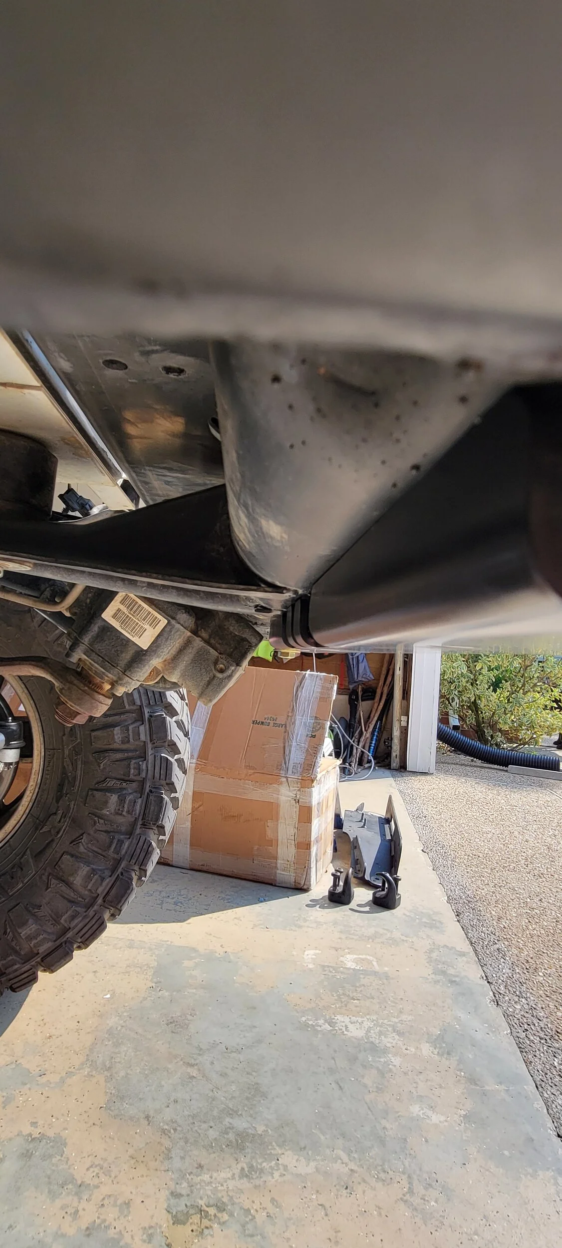

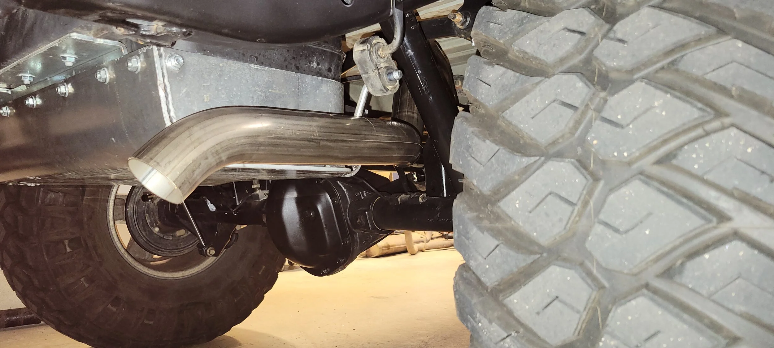

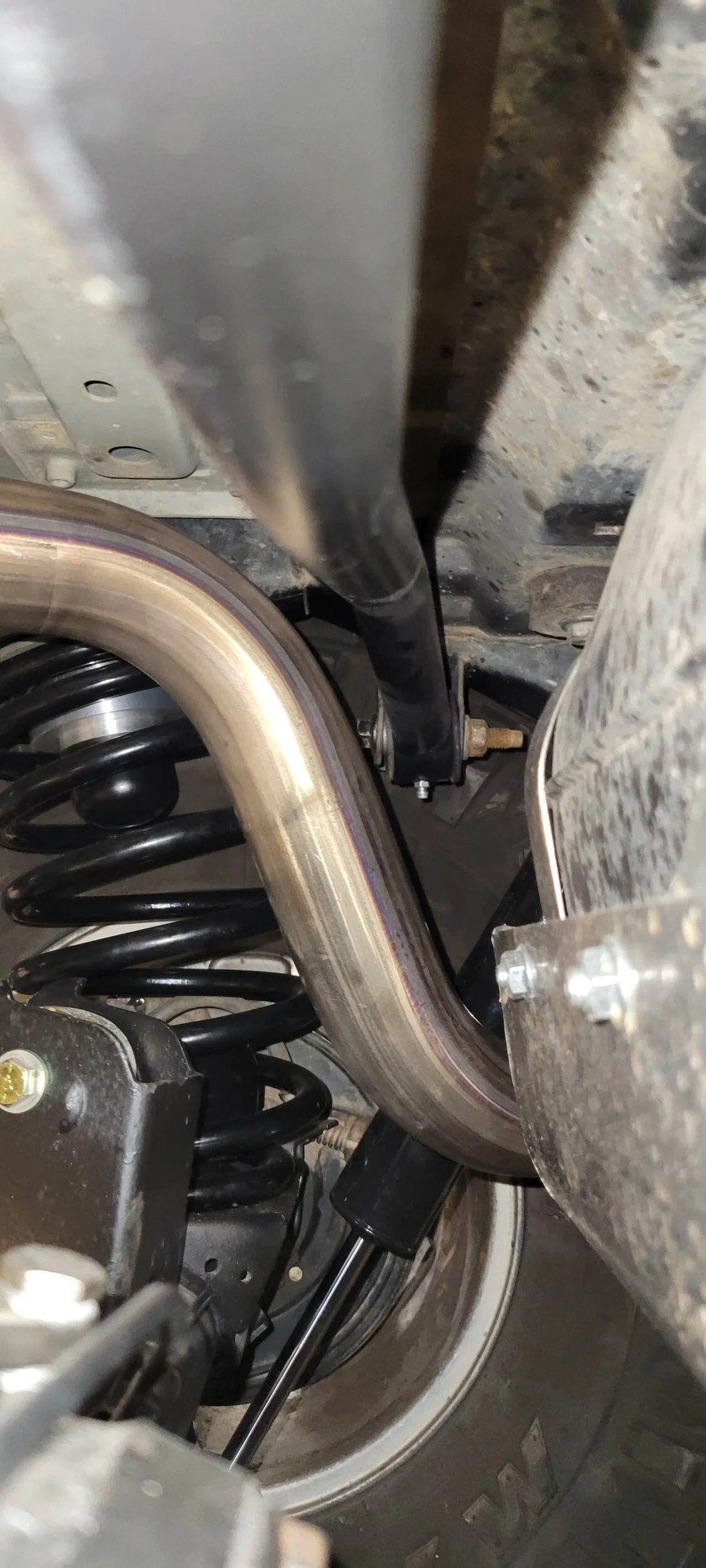

I think it's good now. I found another walker stainless locally. This walker muffler is really quiet, basically stock. I kind of wanted a little grumble. I think my stock exhaust was louder at idle anyway. 😅
I get a little leak by the clamps. I'll see how it does for a while.
Main think is everything is stainless down to clamps and it clears the track bar and shock. Its also just above the bottom of tank skid.
I need to cut this tailpipe a little just for looks. I don't like that hook down very much. Plus my stock one nearly bent shut on rocks.
