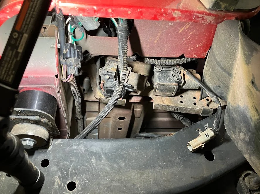

First I played around with a few locations in the back fender/corner of the tub, there's actually a few options:
This is using the stock bracket right under/next to the evap pump on the passenger side. Shoot a few self tappers in it, and bobs your unkle.

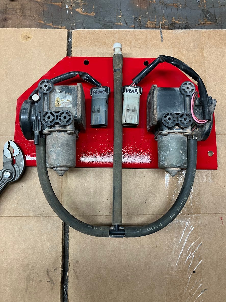

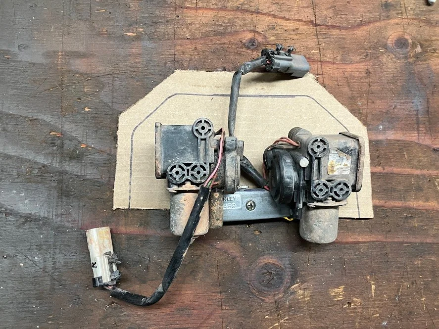

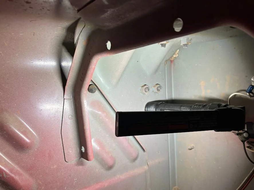

But I landed on using the existing fender brace, and designing a bracket in CAD to CNC plasma cut.
CAD v1:
CAD v2. Note that the holes for the OEM bushings aren't a circle, nor are they "square" to each other. So make sure you measure properly:

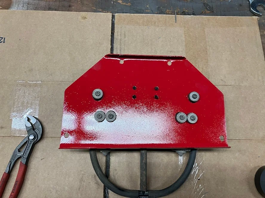

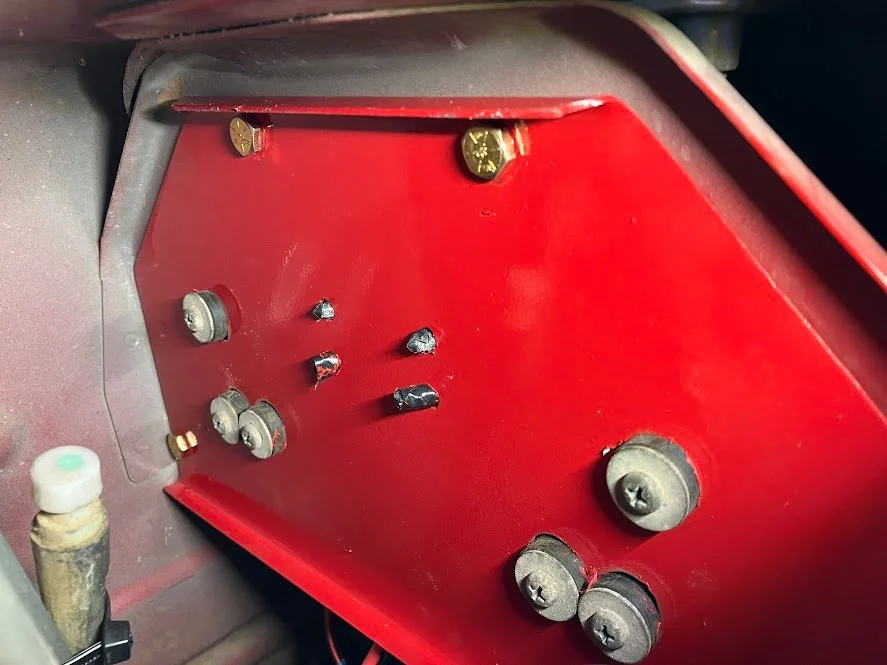

Drilled some holes in the fender support bracket:

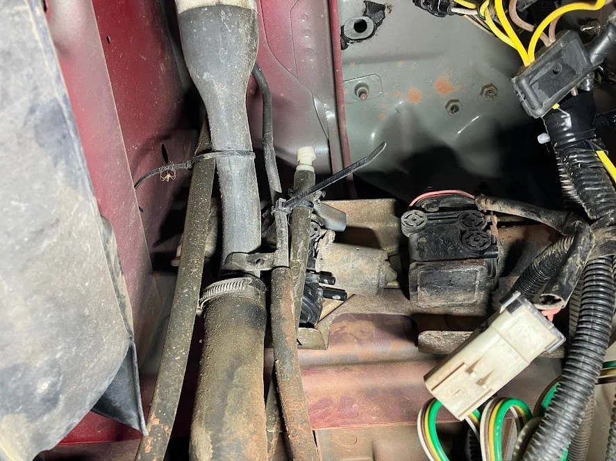

Did some painting, and mounted the compressors using the OEM bushings. The line with the Tee, and the short vent is the air intake, which was already previously in this same fenderwell location:
And the backside:

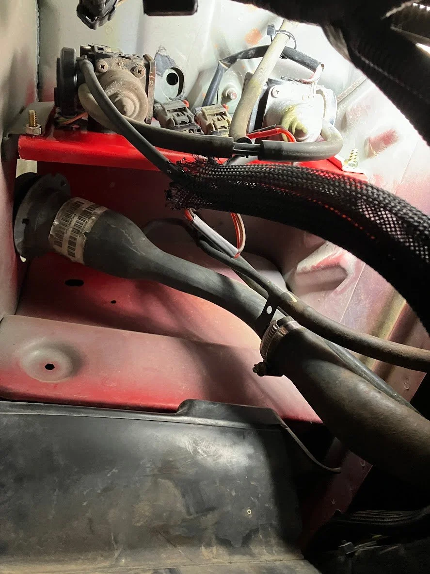

Installed. Running hose, and wire here was very easy. I have a body lift, but there's already bulky stuff running here from the factory without a body lift. :
View from the gas cap hole:
Overall I'm really happy with it. If I were to make it again, I would put the 1/4-20 bolt holes in locations based on how easy they are to access with a drill. I kind of just chose at random, and some were a little awkward, even with a low profile drill. When I was in there drilling, I realized there were easier locations to drill that would have been just fine. Self tappers would work too, and probably be easier. Otherwise, it's a very simple bracket and could be made by someone with hand tools. I put a couple bends for strength, but I don't think it was necessary. I used 16g steel, which was probably about right. I bought a 50ft spool of 5/32 vacuum tubing, and ran completely new lines to my front and rear axles. I have plenty left over. There's a TON of room in this cavity on an LJ. I'm able to pass my bracket up through the bottom fully assembled with pumps and all. and there's still lots of room to spare. I even wonder if the pumps could be relocated here for a TJ with some creative bracketry, because there's a fair amount of room up there even on a TJ.

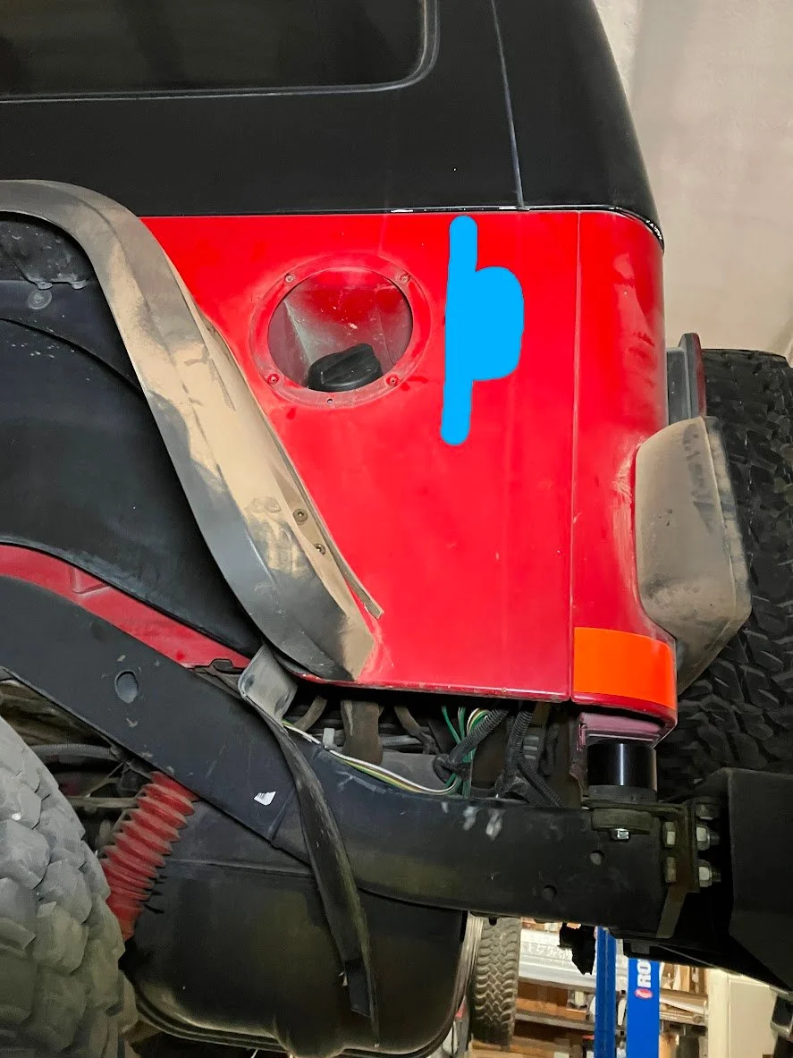

I just popped the bottom flap on my 97 TJ and I think it could definitely be done up there too. This same bracket wouldn’t work, and You’d have to remove the filler neck temporarily and use the filler body hole quite a bit to get it installed. But I think with the right bracket there’s definitely enough room in there.
