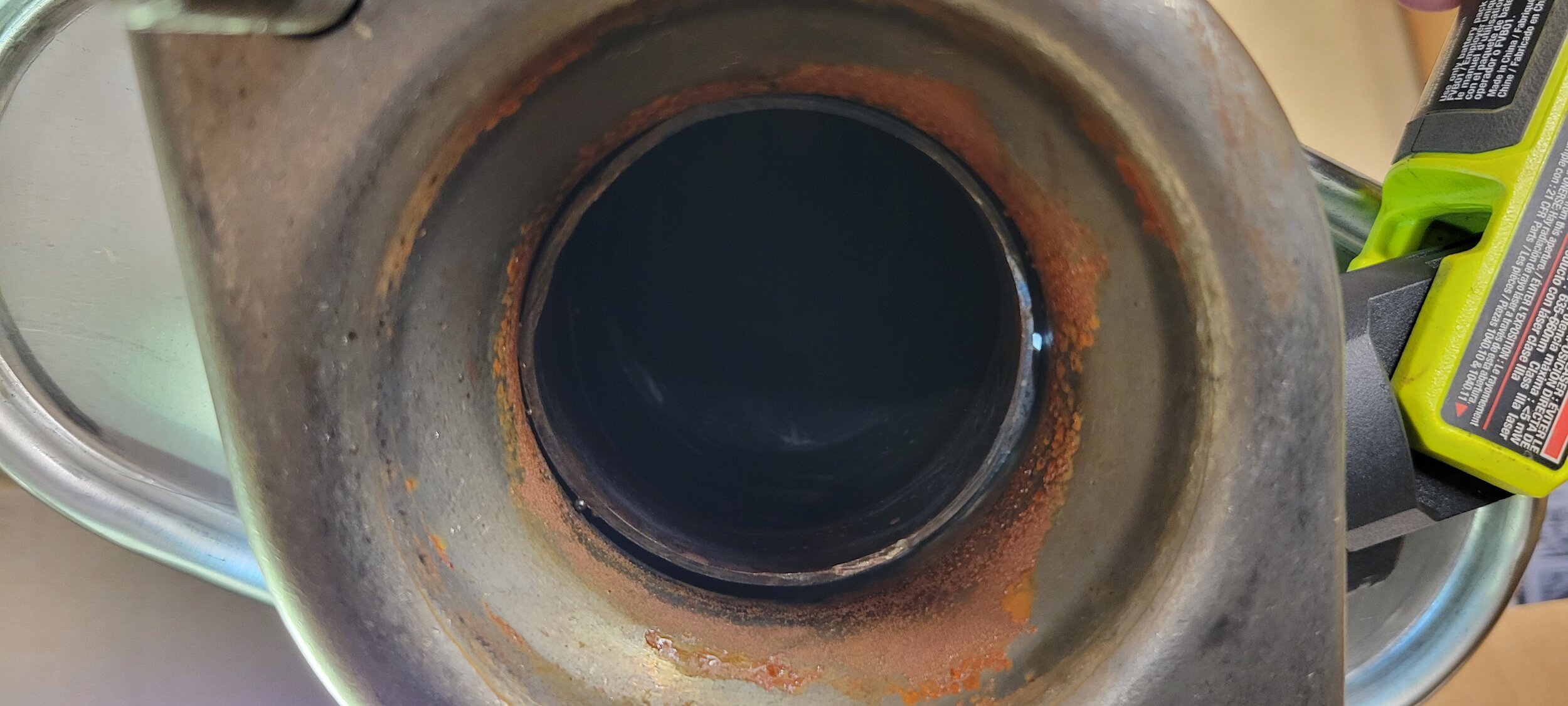

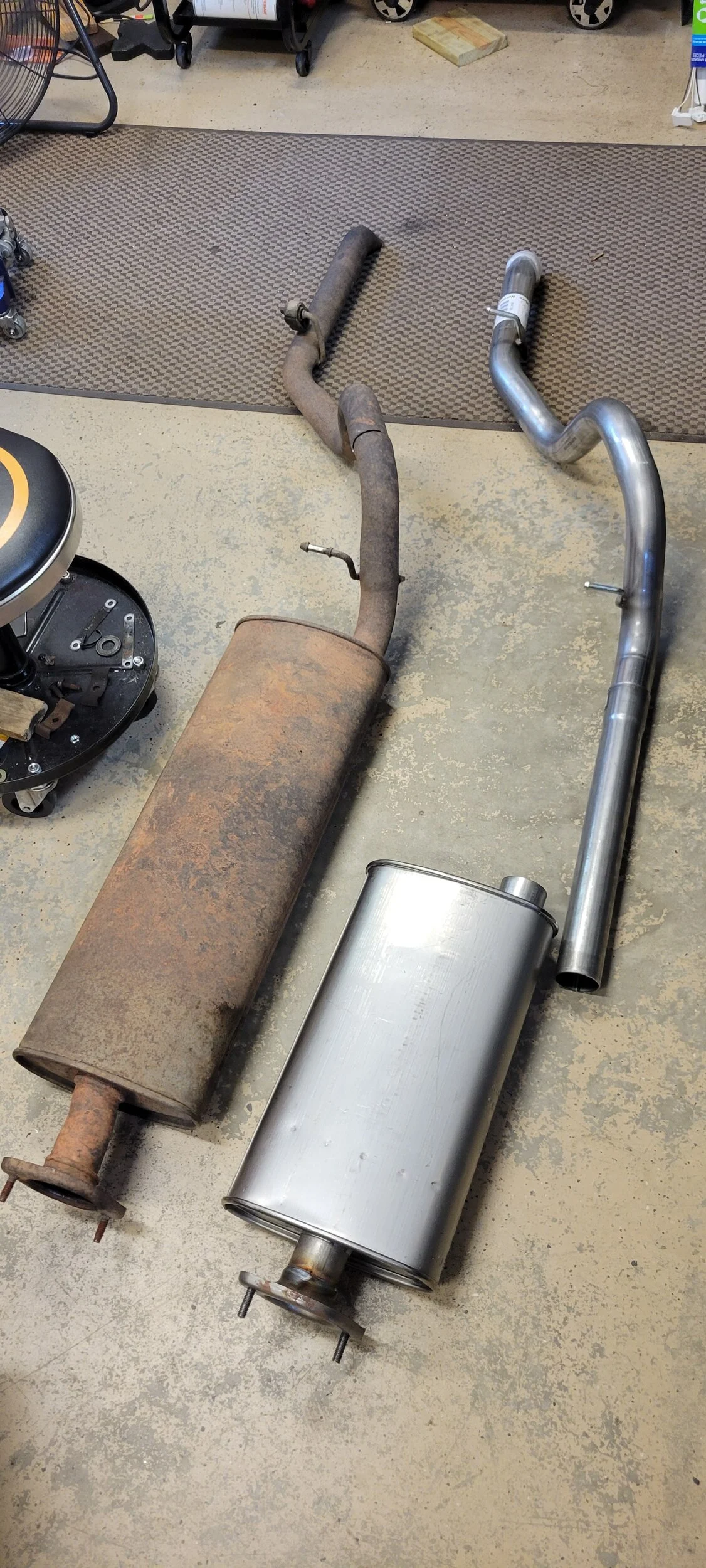

Here is the muffler hole and cause of my previous leak. Can't believe I missed this before install or that it made out the door.

Here is the muffler hole and cuase of my precious leak. Can't believe I missed this before install or that it made out the door.
That sucks, but on the plus side the muffler is both compact and quiet 🤫
Yes it is. I can actually get to that upper control arm bolt now 😂.

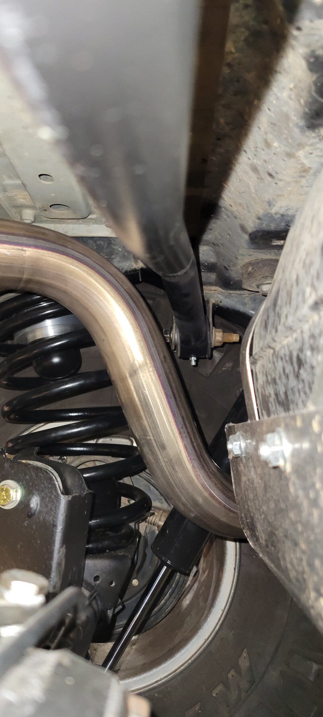

Exhaust pipe is a northeastern Exhaust unit in stainless. I wanted mandrel bends vs the crimp bends the Walker unit has. Price was about the same too.
Walker 33231 is their stainless version if the 2.25 butt clamp

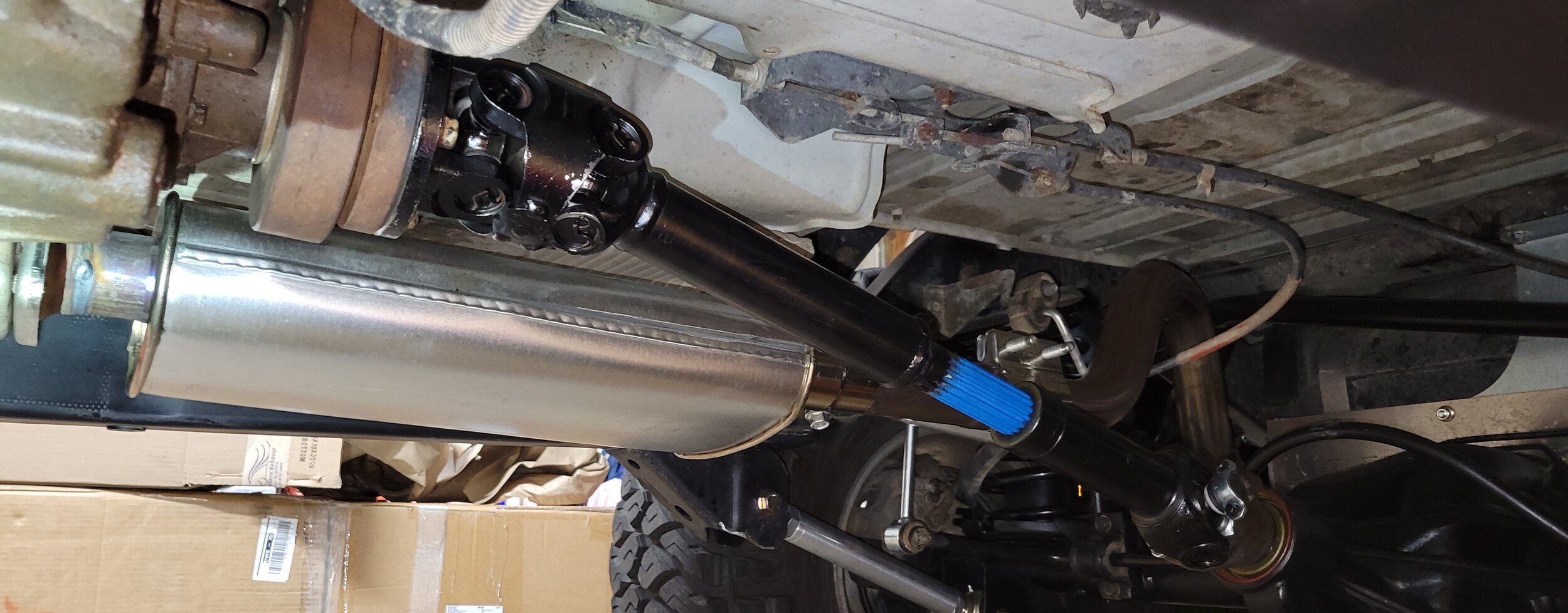

I think it's good now. I found another walker stainless locally. This walker muffler is really quiet, basically stock. I kind of wanted a little grumble. I think my stock exhaust was louder at idle anyway. 😅

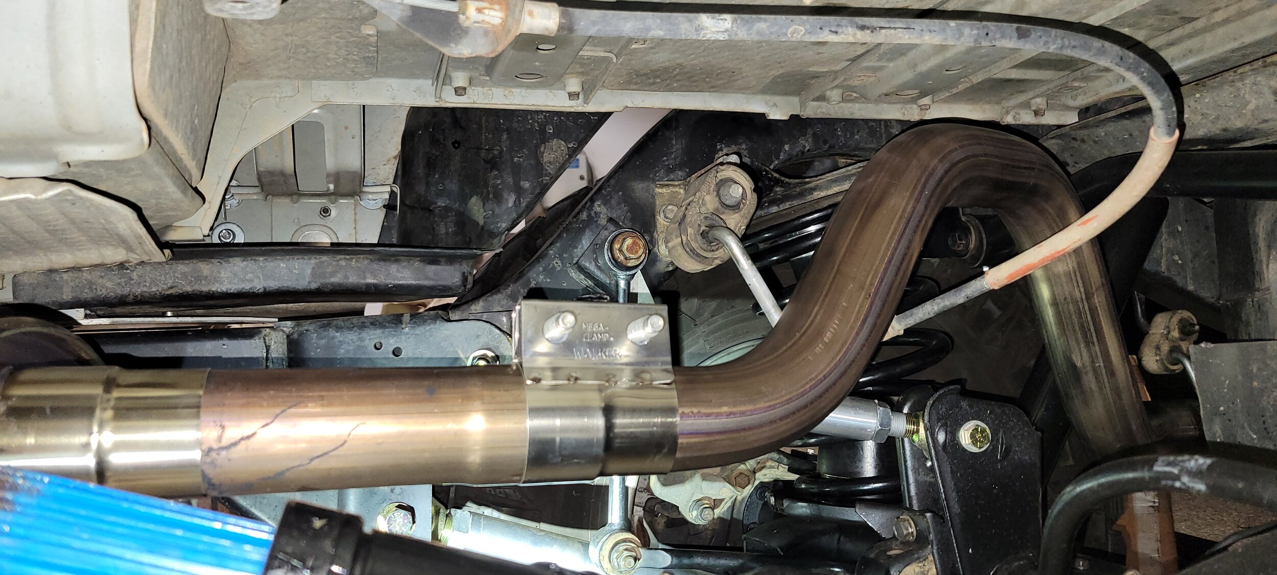

I get a little leak by the clamps. I'll see how it does for a while.
Main think is everything is stainless down to clamps and it clears the track bar and shock. Its also just above the bottom of tank skid.View attachment 535868

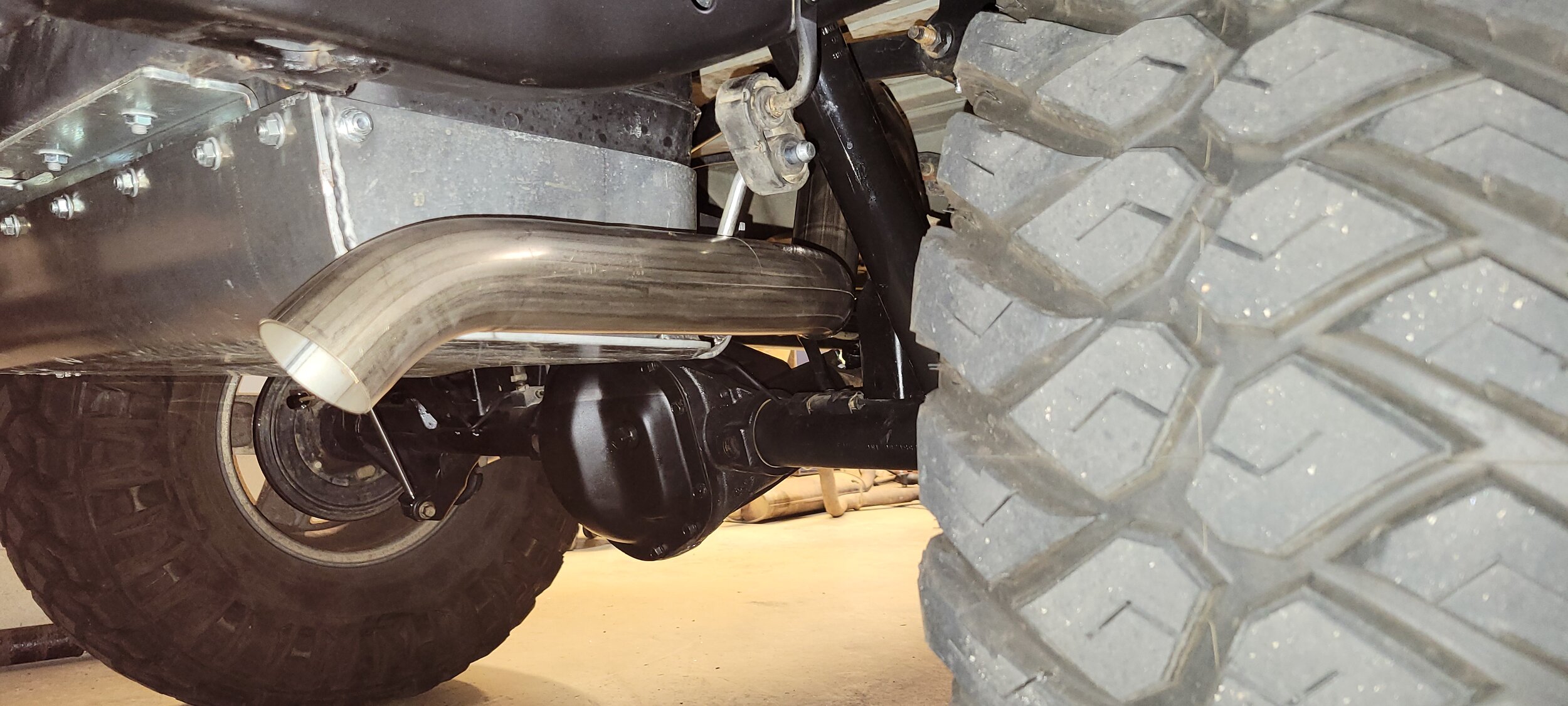

I need to cut this tailpipe a little just for looks. I don't like that hook down very much. Plus my stock one nearly bent shut on rocks.
My walker had a nice rumble to it. Give it a little time to break in and hopefully it'll give you what you're looking for sound-wise. Wife could always tell when I was coming home when I was around the corner (dog was always ready to greet me too ;) No stealth mode like the rest of my 'fleet').
I had a flowmaster not long after getting the TJ and my buddy put a 'stock' replacement in his TJ. He had a similar sound as mine over time. It was good enough that I went 'stock' when I replaced the flowmaster.
