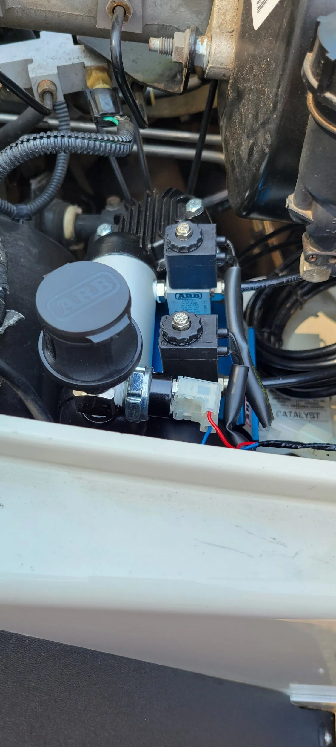

Also added an arb pump up kit to the compressor in case I ever need it for emergencies. The clip on air chuck it comes with is petty nice!

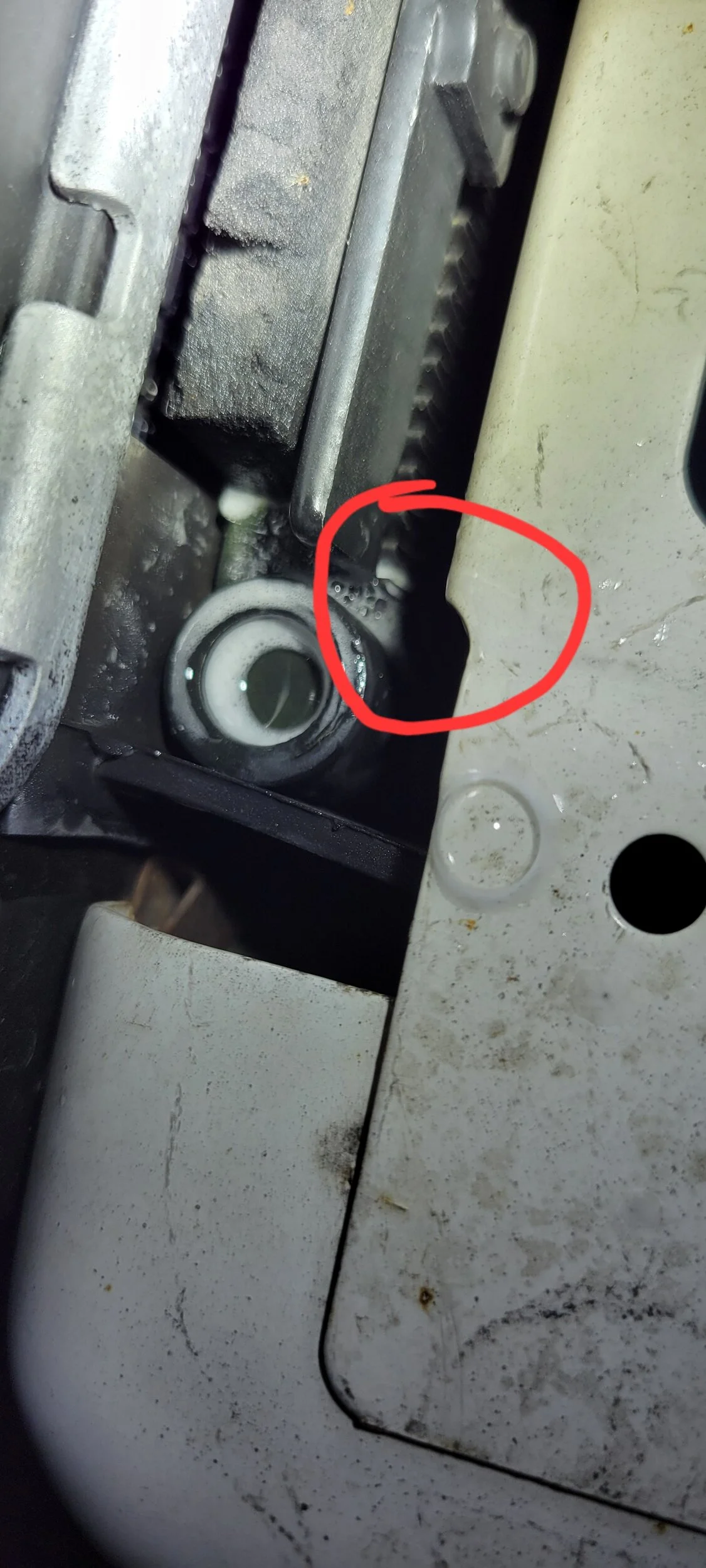

Found to source of my slow ac leak that seems to be leaking faster.
Aging jeep problems. I'll get a new one en route. Anything else I should do while I'm in there? New dryer and orifice tube? though they are both fairly new from the heater core and new evaporator done last year. New shader valves. Compressor seems fine.

If your humidity isn't extremely high and you plug the openings quick i don't think I'd do a new accumulator. If its a pain to get someone else to pull the system down and charge it then the extra 60$ for orifice and dryer could be cheap isurance?
Reactions: Longwhitejeep
It's real humid 😆. I have a new accumulator and orifice tube coming with the condensor from jeep air.
Reactions: Rickyd
I understand the accumulator/dryer, but what happens to the orifice tube to make it go bad, Rick?
On mine, the shader valve is stuck and leaks intermittently. That's why I need that entire line with the tube. Jeep air had it though. My compressor is still working fine but that would be the last original part in the system.

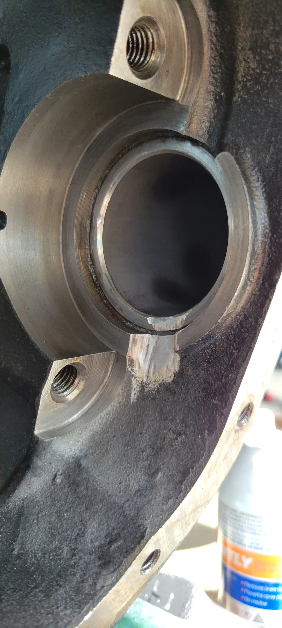

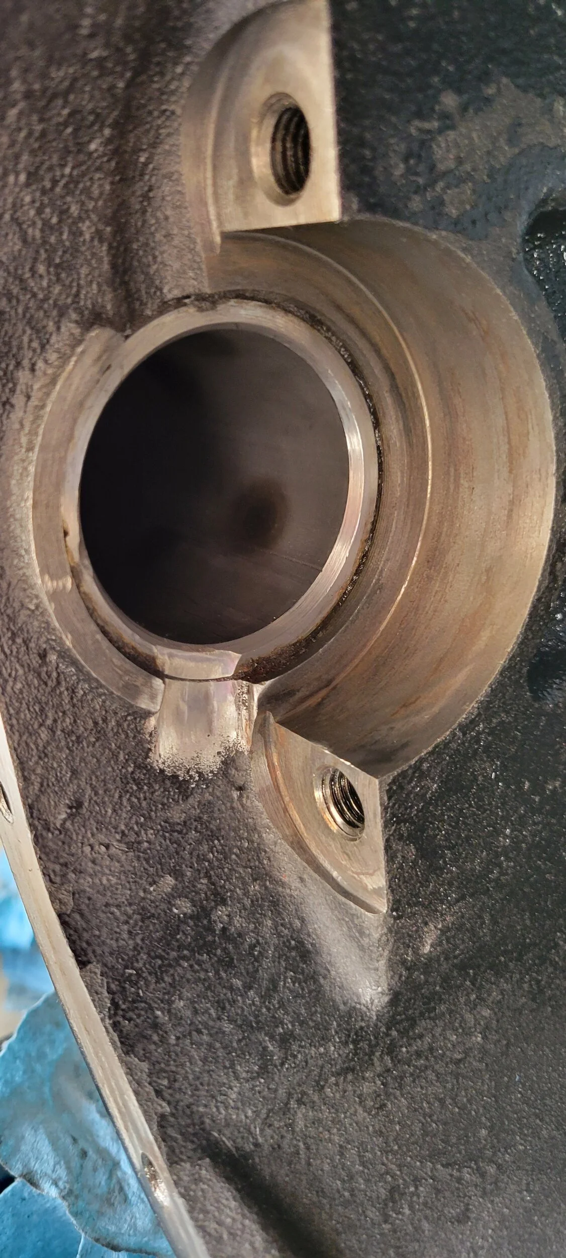

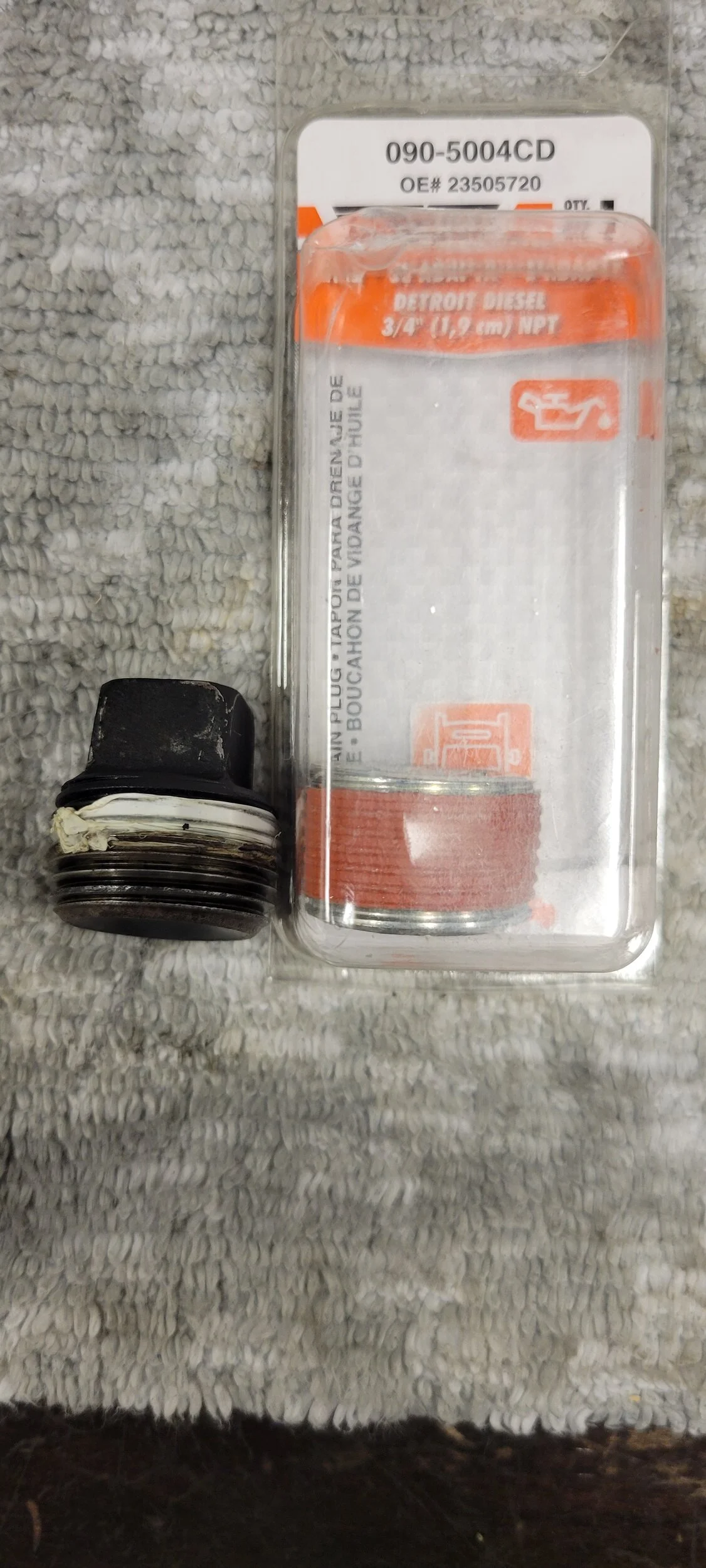

I need to open up the oil drain in the rear axle. I keep spitting gear oil out the breather on speeds above 70mph and arb said to open the drain up more. So I can mess with that for now and shouldn't be too bad.

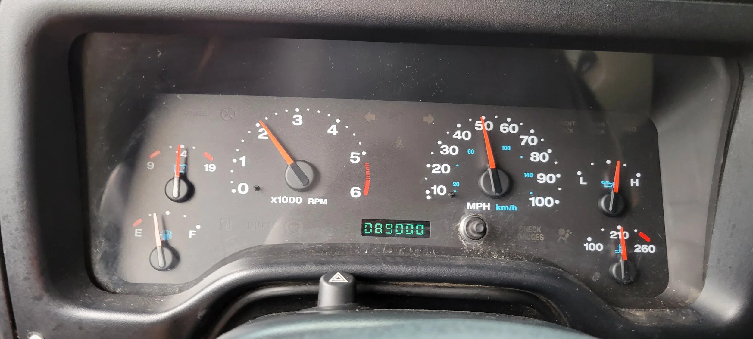

I didn't go back in time or anything when I hit this mileage.
Otherwise the jeep drives great. The Walker clamp at the muffler leaks so I may swap it with a u bolt style clamp as they seal better at the cost of being removable.

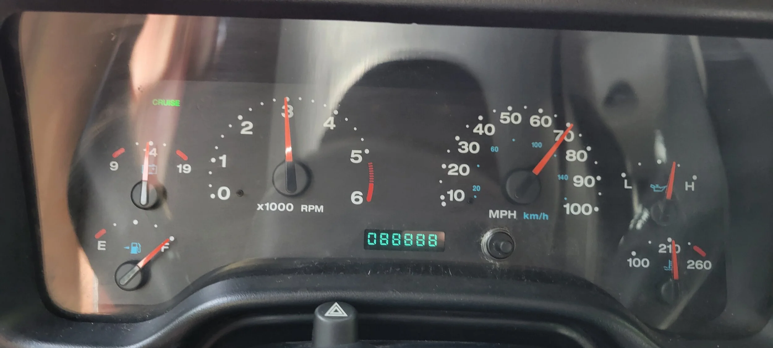

Pic also shows rpm with 35s at 70 mph and 5.13s for anyone wondering what that looks like.

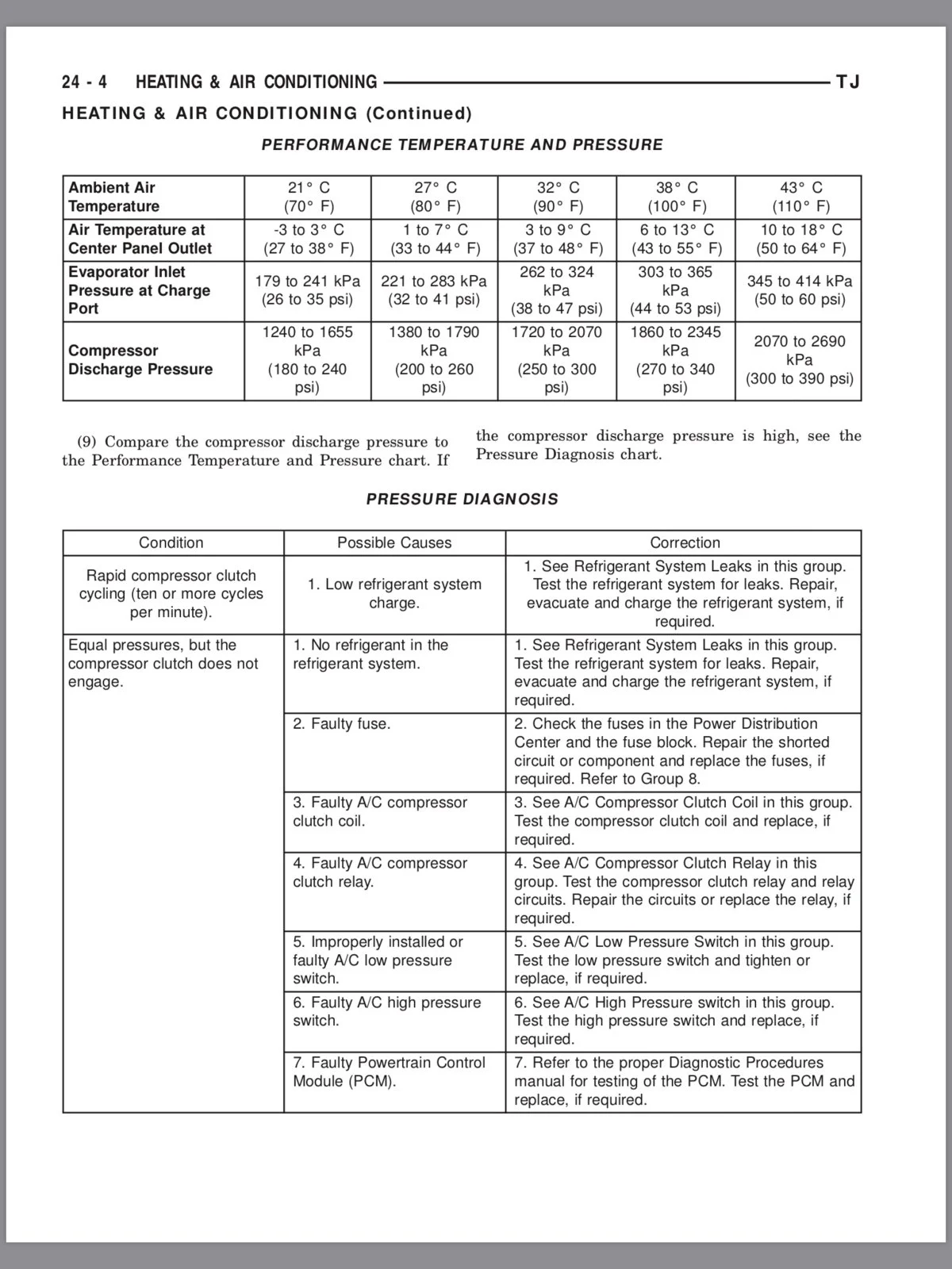

Ac is working! Condensor in yesterday and pulled s vacuum today. Getting 38 degrees out the center stack vents. Pressures within spec for 90 degrees ambient temp per the chart below. Feels good to get ac back.

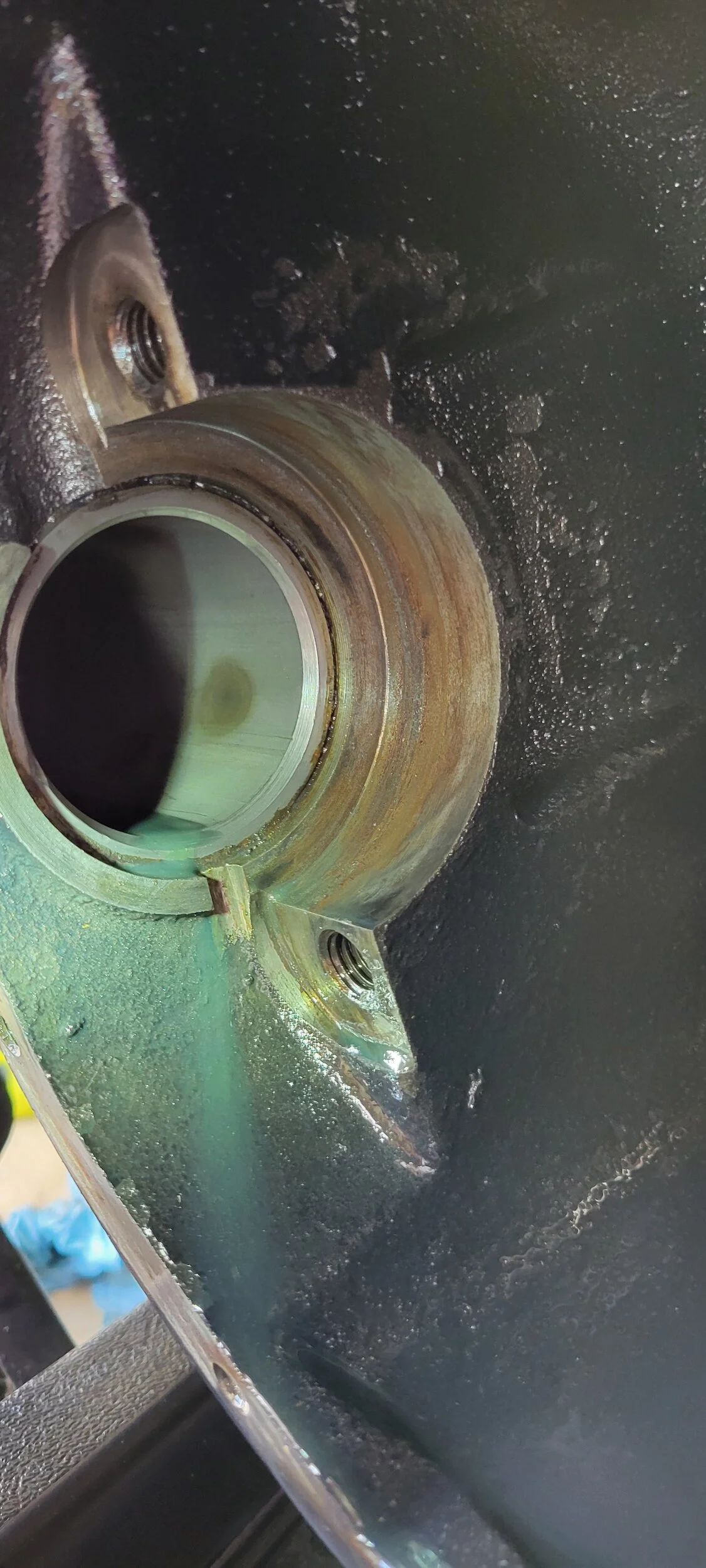

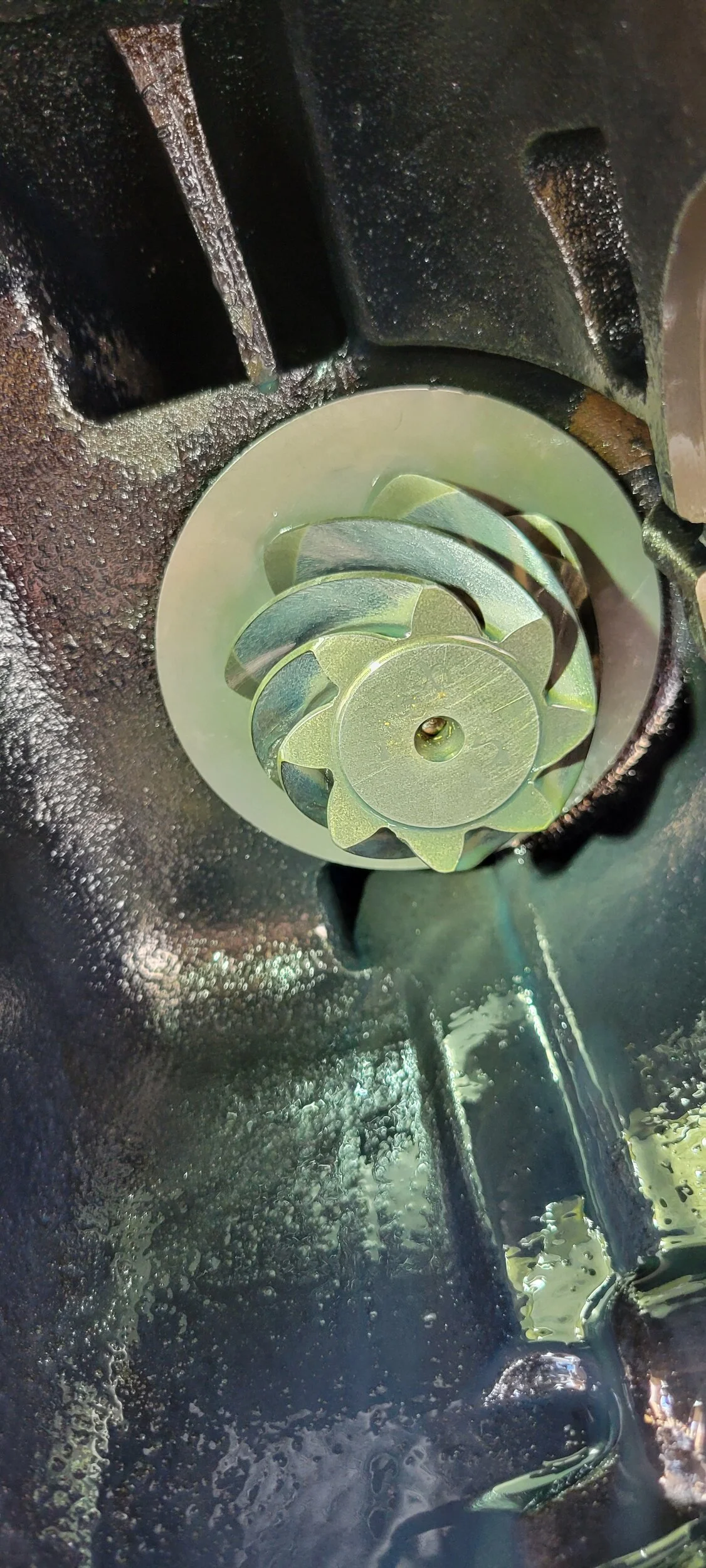

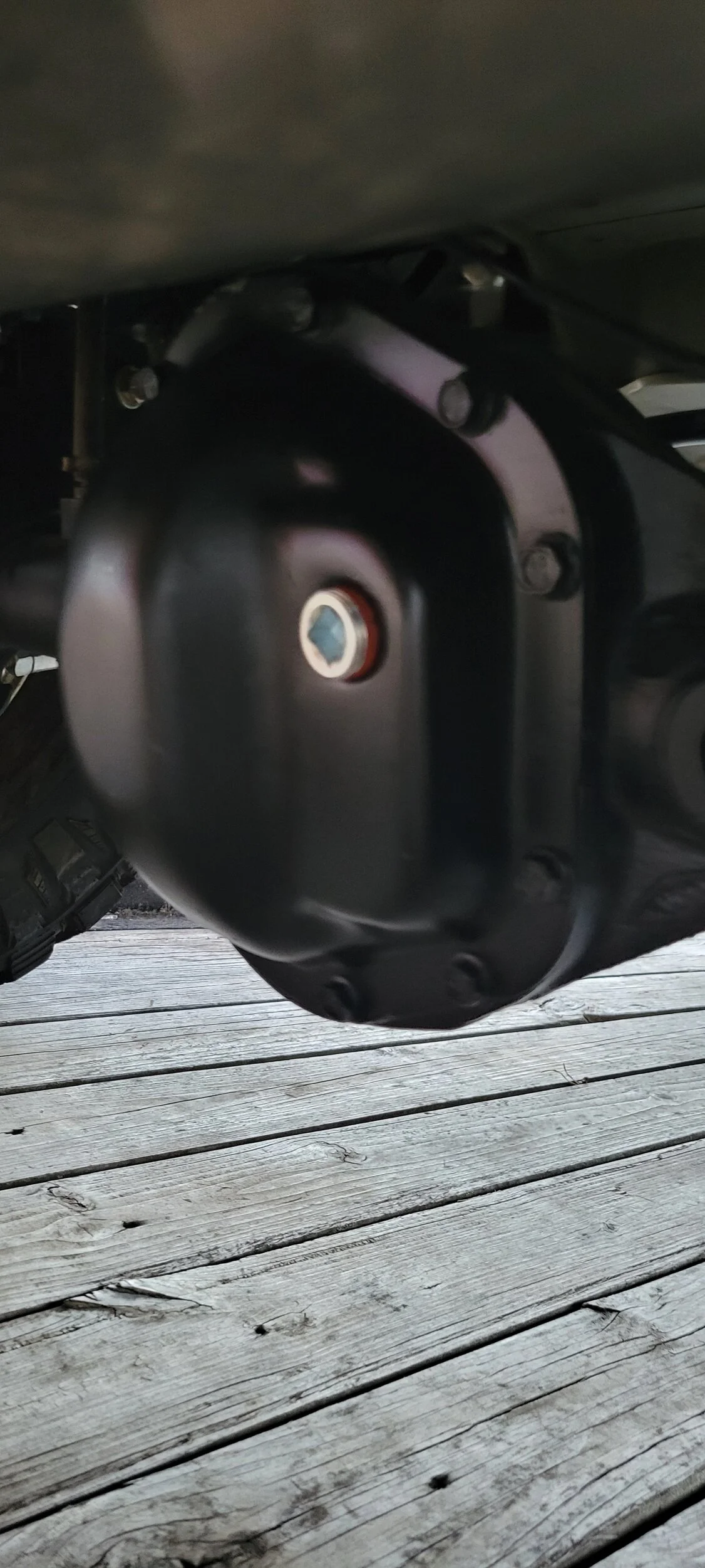

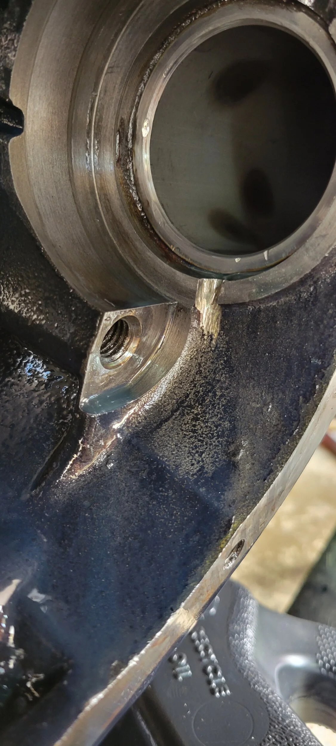

Fixed the rear oil drains since it keeps spewing gear oil on longer interstate runs. Matched the gap of the upper oil inlet on the axle tube, about 11/16" on my axle. Diff back together and no air leaks.
I'm waiting on some longer wheel studs before I put the shafts back in and confirm its all good. There wasn't enough thread engagement for my liking with these wheel spacers.
Before
after
Pinion gear looks good
Jeep dialed in, ac working and no oil out the vent breather.
