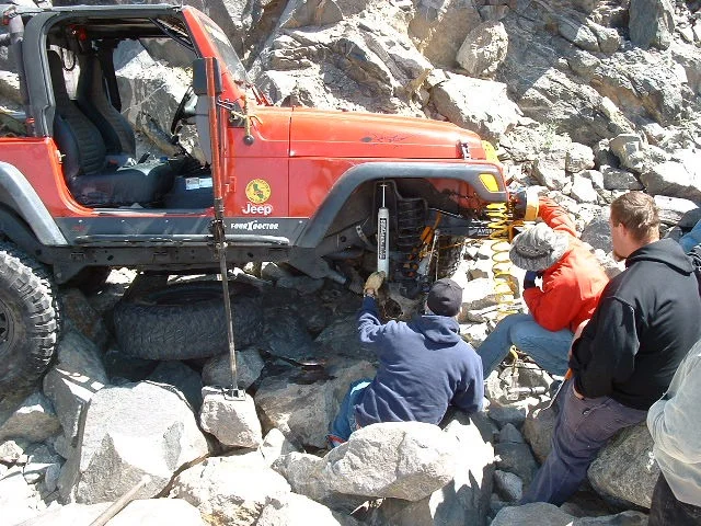

Seeing this photo of the last time I used my Hi-Lift in 2003 was the clincher for me to never use one again.

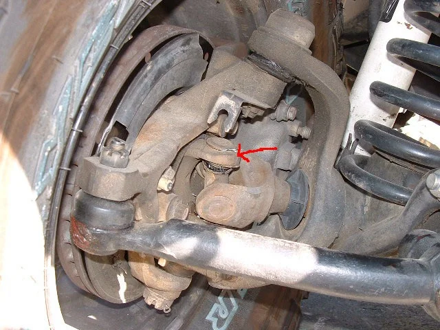

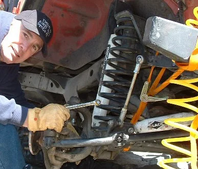

This photo was taken on Sledgehammer in Johnson Valley after I broke a front axle shaft on my previous (stolen) TJ. I'm removing it so I can finish the trail in 3wd which makes it tough to finish that particular trail. The jack was straight when I first jacked up the side but the Hi-Lift is so unstable at tall lift heights that it started leaning without me realizing it. With more experience with that level of repair I would have known to use the bottle jack to simply jack up the front axle which would have worked better, faster, and far more safely.
This is an embarrassing photo for me but it was good for learning a lesson... don't use a Hi-Lift when a bottle jack will do. Oh... that big rock placed precariously under the Hi-Lift was only because the Hi-Lift couldn't lift the Jeep up far enough to get the axle up high enough to get the tire off & tear the axle down. Yes the axle was strapped to the frame. The second photo shows where the axle broke, the third shows where the axle had been strapped up to the frame in a futile attempt to prevent it from sagging while jacking the body up with the Hi-Lift.

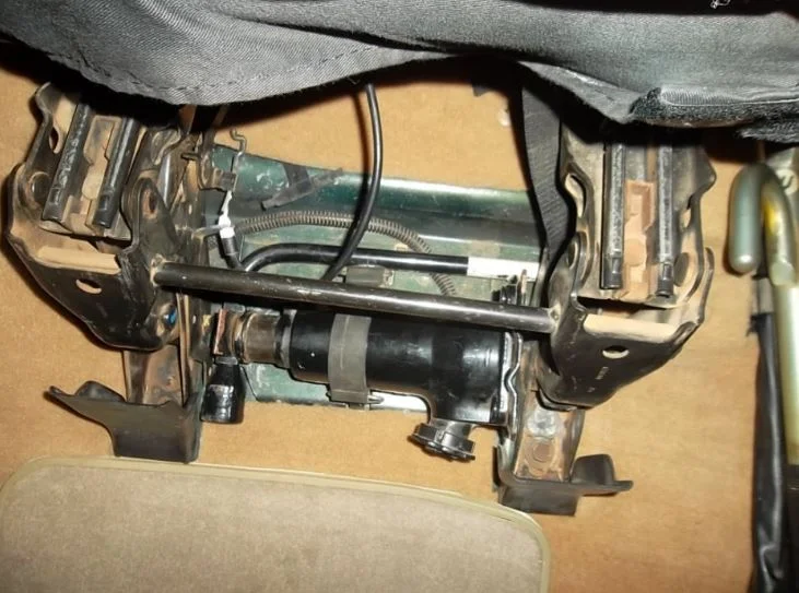

When the factory jack is mounted in its mounting bracket under the seat, you unscrew it so the jack extends outward enough to hold the jack tightly between its two mounting points. When properly extended, the jack also serves to secure the jack handle and prevent it from rattling.
This is the best photo I have found which shows its mounting point. But IIRC, the owner has the below jack rotated 90 degrees from its proper orientation where the knob the jack handle fits into should be pointing straight up. That orientation allows it to lock into its bracket and gives good access to the knob so it can be turned to extend the jack so it locks firmly in place between its mounting brackets. I'd take a photo of mine but the shoulder harnesses that pass through the seat prevent me from moving the seat forward enough to expose the jack.
The tools are secured with the pair of velcro straps adjacent to the passenger side seat base
When it is mounted in its mounting bracket under the seat, you unscrew it so the jack extends outward enough to hold the jack tightly between its two mounting points. When properly extended, the jack also serves to secure the jack handle and prevent it from rattling.
Thats actually pretty cool, i've never seen how the stock jack was mounted as mine did not come with one...that absolutely makes sense though, I really like that!
