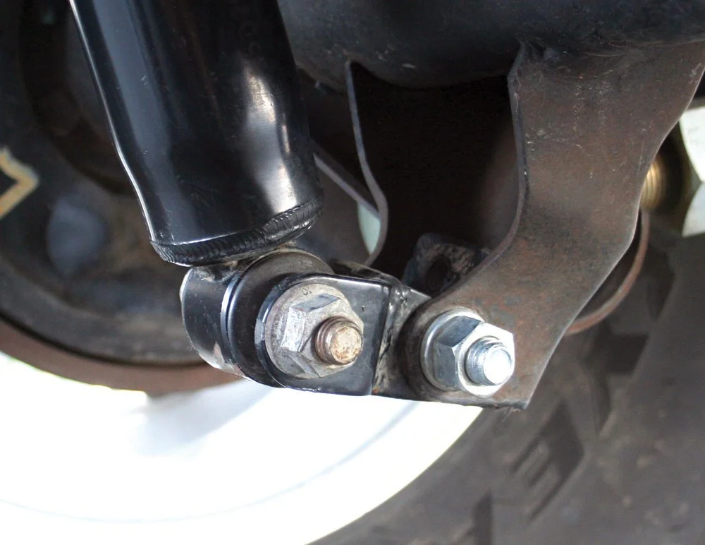

Why did you outboard?
To get lower shocks mounts up behind the axle instead of hanging well below the axle. Some trails don't give you options for different lines. Sometimes backing up resulted beating up the shock. I decided to buy more expensive shocks and didn't want to beat them up.
Brianj5600
Jul 4, 2018
2,261
Middle Tennessee
This is what mine looked like.
Which was always getting hung up and beat up.
