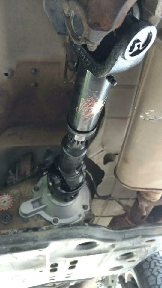

Lastly, do I need to be concerned about transfer case drop or motor mount lifting mentioned in kits since I have a slip yoke eliminator? Apparently I already have TC drop bushings that were left when the SYE was added but if I understand correctly they are not longer necessary with SYE?

With the sye and control arms, you do not need the motor mount lift or transfer case drop.

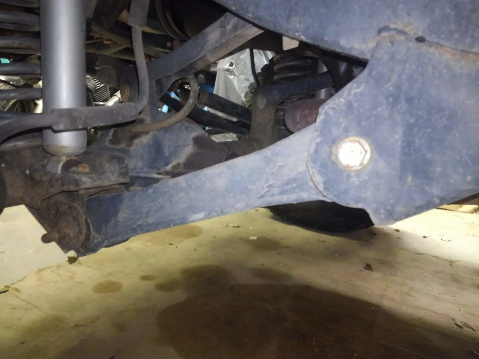

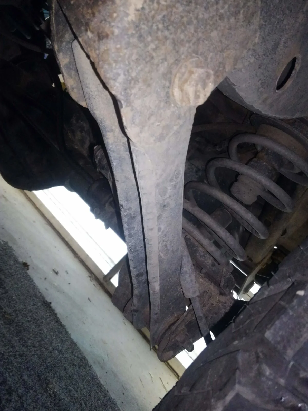

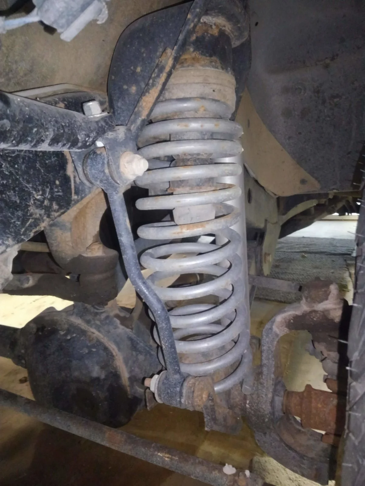

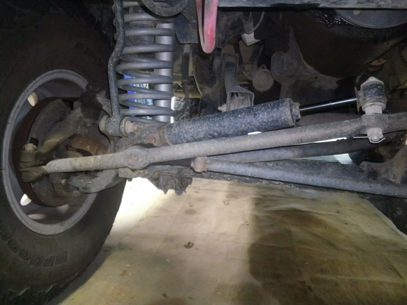

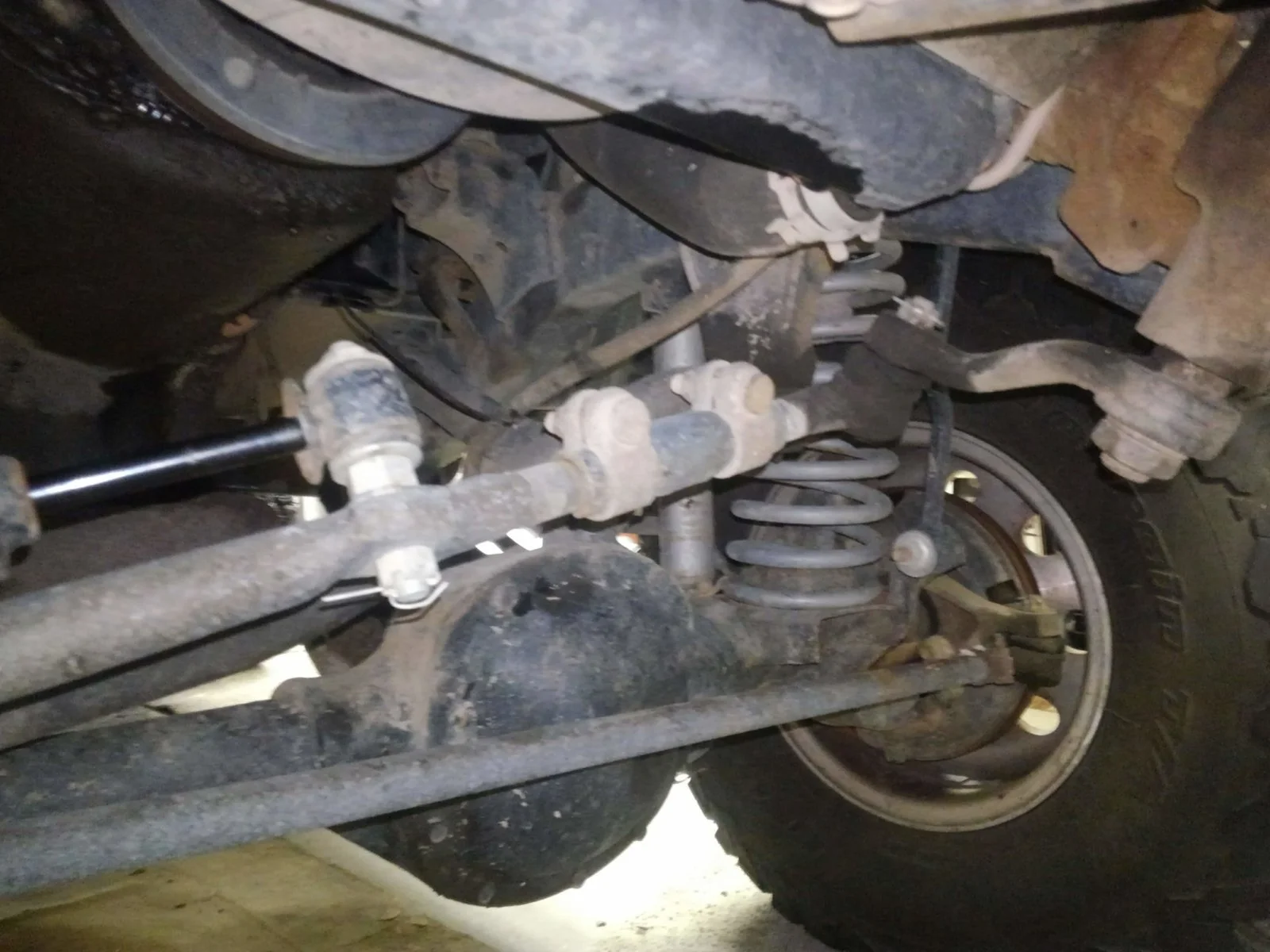

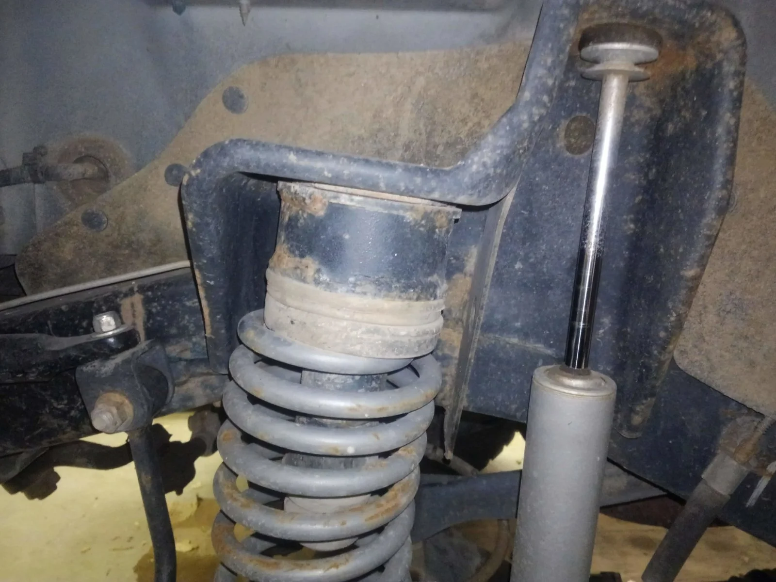

Would like comments/questions from the following front suspension photos. I apparently have 21" uncompressed front springs using a 2" spacer and two additional 3/4" isolators. I am guessing maybe the additional isolator could have been used with the front bumper and winch combo for leveling purposes.
My main question is what has been changed from stock as far as the upper bumpstops? Is it possible the rubber portion is fixed and is not designed to collapse into the cup like others I have seen negating the need for a bottom bumpstop? I'm trying to measures things accurately as far as cycling suspension and if I need to add an additional bottom bumpstop. I don't clearly understand what I have happening at the top and what components have been altered (perhaps just longer springs and a combination of a 2" spacers and isolators nothing with the bumpstop portion}?

I've cleaned up the front suspension a bit. I "centered" both springs as one was apparently not in the perch stop correctly. I also added lower bumpstops and replaced with recommended Rancho 2-3" lift shocks.

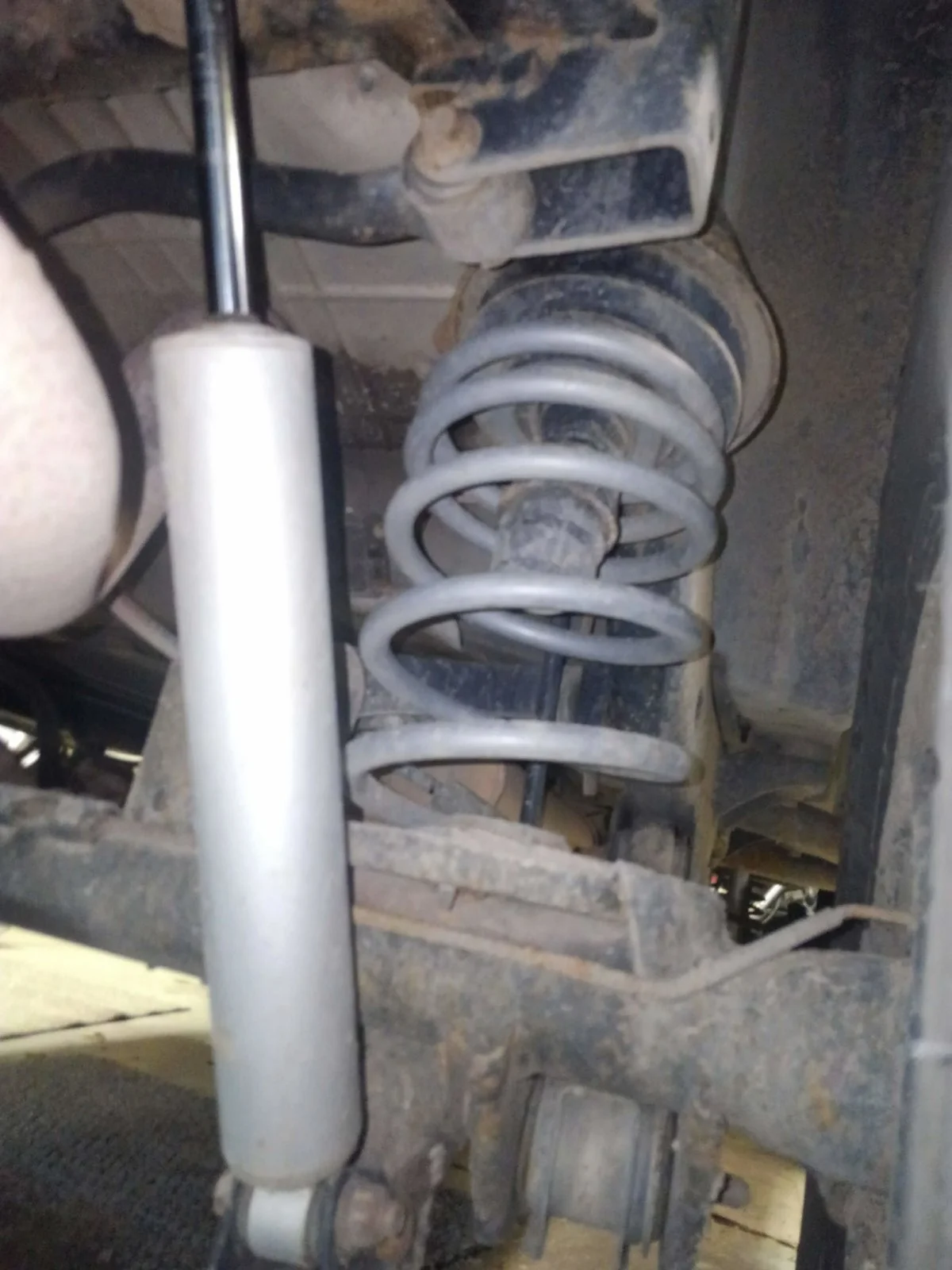

I'm curious if someone might be able to confirm a method for determining my actual lift height. I have roughly a 21" uncompressed spring which I think is 3" taller than stock along with a 2" hard spacer and perhaps an extra isolater. I rearranged the isolaters sandwiching the spacer between them as I thought it might be more appropriate than double stacked. I might experiment with getting rid of one of the isolaters or even the spacer if I can determine it will remain level and clear 33" tires correctly. I need to look closer at the rear as there must be a thinner (1"?) hard spacer there as well.
Also ...are the following OEM jounce bumpers or aftermarket? They do not seem like they would compress. If they do not compress maybe I need to remeasure/confirm what I have done as far as lower bumpstops. Will need to confirm the same in the rear.
