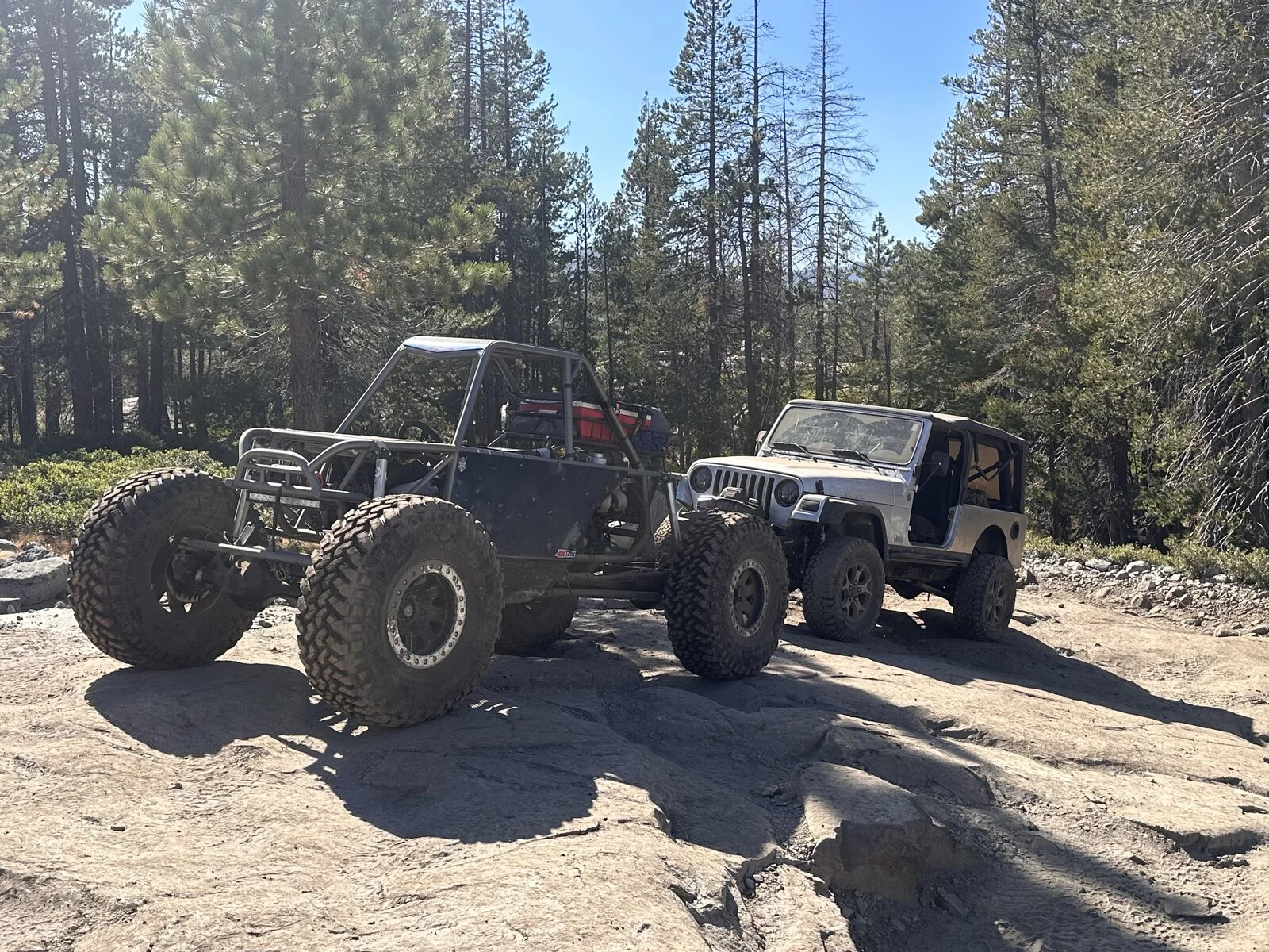

Likewise, I’ve heard the argument go either way, and I’m not yet convinced which path is better (high uptravel or lower COG).
We have a buggy in the family that I wheel with occasionally (sticky 40s, rear steer, tuned 14s, low belly height etc etc). Right now, it’s at 3” of up in the front, maybe 4” in the rear, and it’s insanely stable at highly off camber/articulation situations.
Obviously it’s construction is far from a TJ, but I wonder whether it’s stability is thanks to the low uptravel/COG, or in spite of it.
I’ve played around a bit with various shocks and shock mounts on my Jeep, and thus far, anything less than 4” of up in the rear, is unbearable on a rough road with a soft shock like the rancho. So right now I’m stuck running 6” up/2” down in the rear on these ranchos. I do pay the price offroad, but at least the big bumps a tad less jarring.
You need to assign some measurements and context to begin to compare. What does low belly height mean? What is the wheelbase? Is the terrain rough enough to involve dragging the underside and actually relying on the skids?

Belly is around 19.5” at the moment, which is pretty low for 40s and our area IMO. Wheelbase 107ish. The belly skid is pretty dinged up, if that’s any indication.
It is worthy to note that the cross section that the belly takes up is significantly smaller than the LJ’s whale belly. Probably a solid 3-4 times smaller surface area, which definitely makes a difference on the trail.
The low cog definitely helps. Less uptravel probably doesn't, but how much does it hurt? There is a point where the cog vs uptravel is ideal, is that point always at half the shock travel or is it sometimes less?
