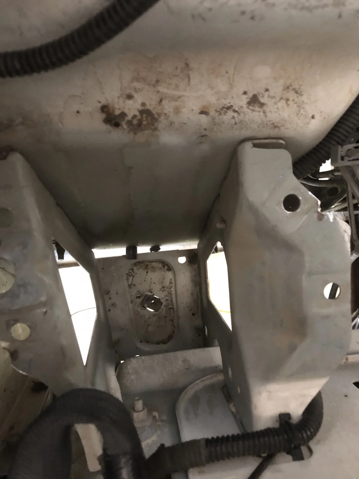

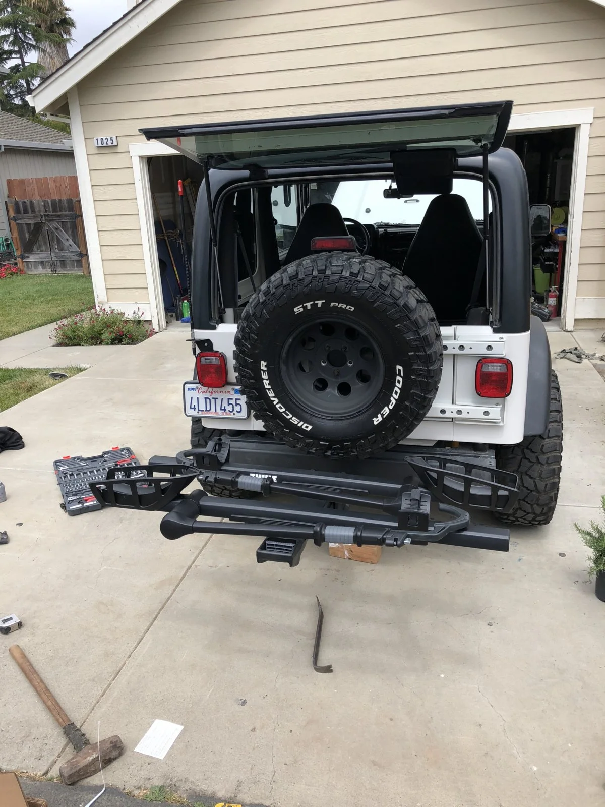

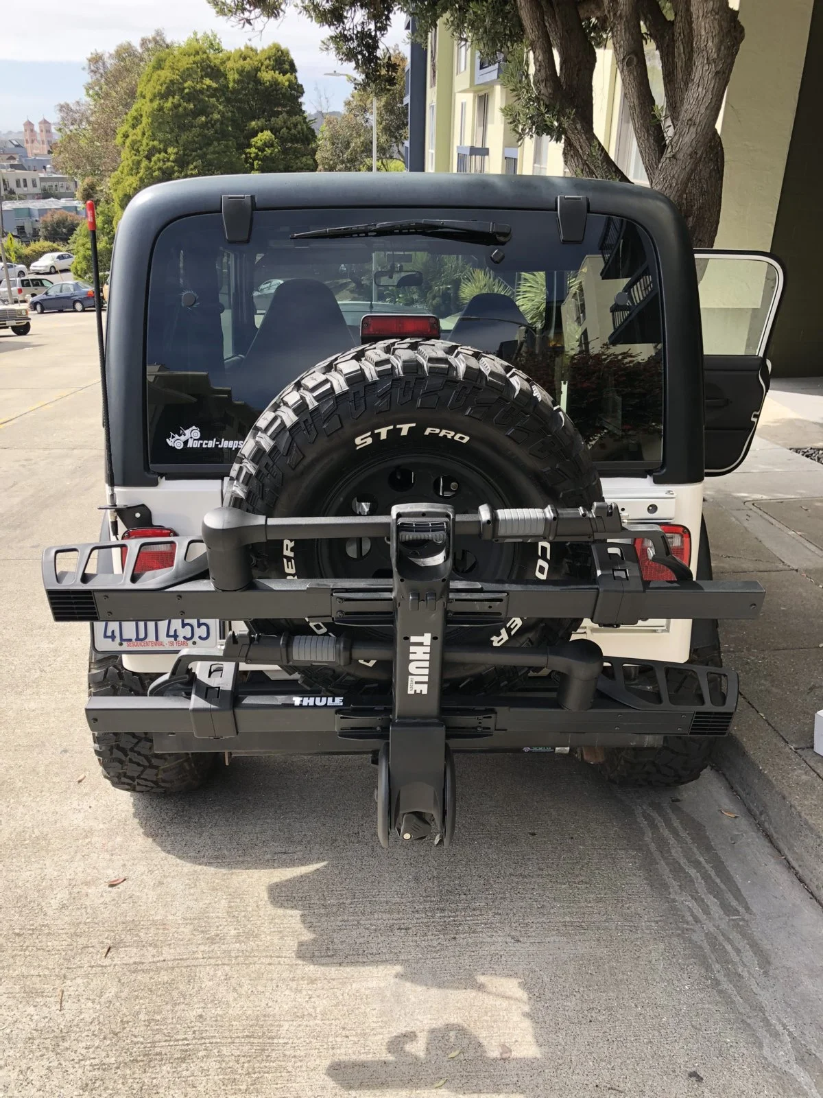

Hitch install today. Turns out my gas tank skid is a bit beat up making it so we had to ratchet the hitch to get the holes to line up due to the skid getting in the way. Also ridiculously expensive hardware didn’t fit in the frame hole so we had to grind down the head to get it to go in the frame. But it’s on and bike carrier installed (it has some issues with the tailgate opening and the bike carrier going full vertical due to my tire, I’m just driving with it horizontal and won’t have it on unless I’m using it). Going biking Monday so that will be the true test.

Also for the bike rack plan on getting something like a cheaper version of this https://www.amazon.com/dp/B01LY7GU9H/?tag=wranglerorg-20 so I can mount the rack lower, then I should be able to fold to 90 degrees, and open the tailgate by lowing the rack. Its a great rack though used it a few times now to go biking!

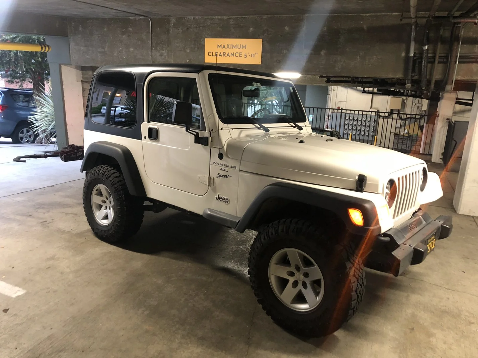

I posted it in different threads but thought I'd document it here, Saturday I quickly threw on the Moabs I bought from Chris. I need to adjust my bumpers on the tailgate to mount the spare, and adjust the steering stops but I'm liking the new lighter look.
A few minor appearance mods coming soon (chrome headlight bezel, OEM lugs) and I should be getting some used Savvy control arms from a forum member mid-august. Hoping to get an antirock soon, and rockers sometime after. I'm planning on painting the rocker guard aluminum backplate stone white with the step being powder coated black so it still looks very factory.

Chris's extra part bin build formerly known as Low COG overland-ish build.:)

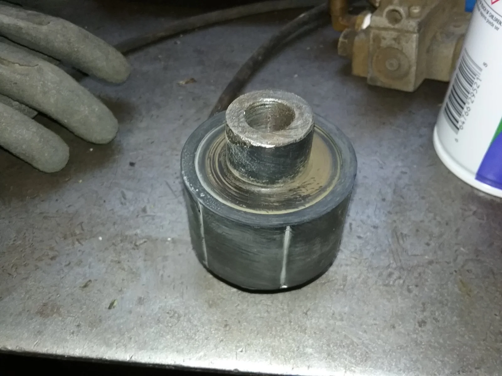

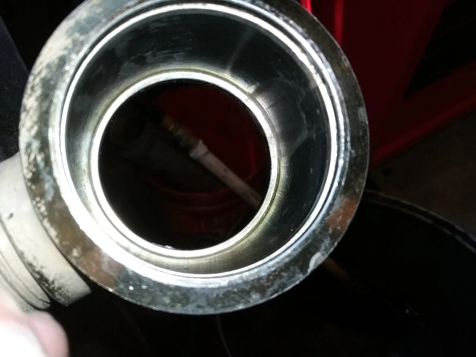

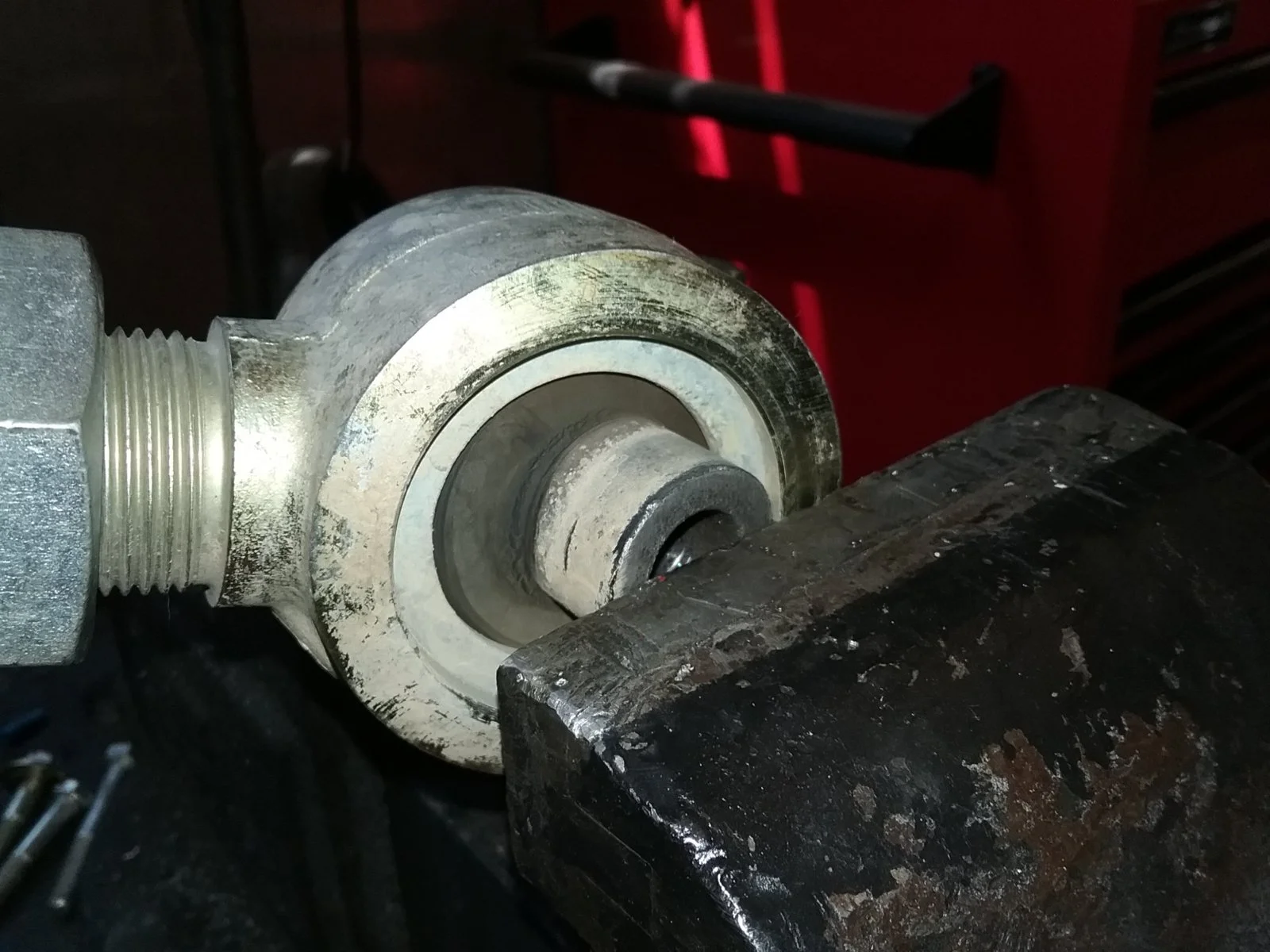

Here's a MC Duroflex joint, lower front after 30K miles with some offroading thrown in for good measure.
The only thing I can find wrong with the joint, and I don't think it has any detriment to the joint, is a tiny bit of cracking at the base of the shank when the joint is at full articulation. Jeep still feels tight and solid. these joints are WAY easier to service! A pair of snap ring pliers, and a mallet and these things pop right out.
