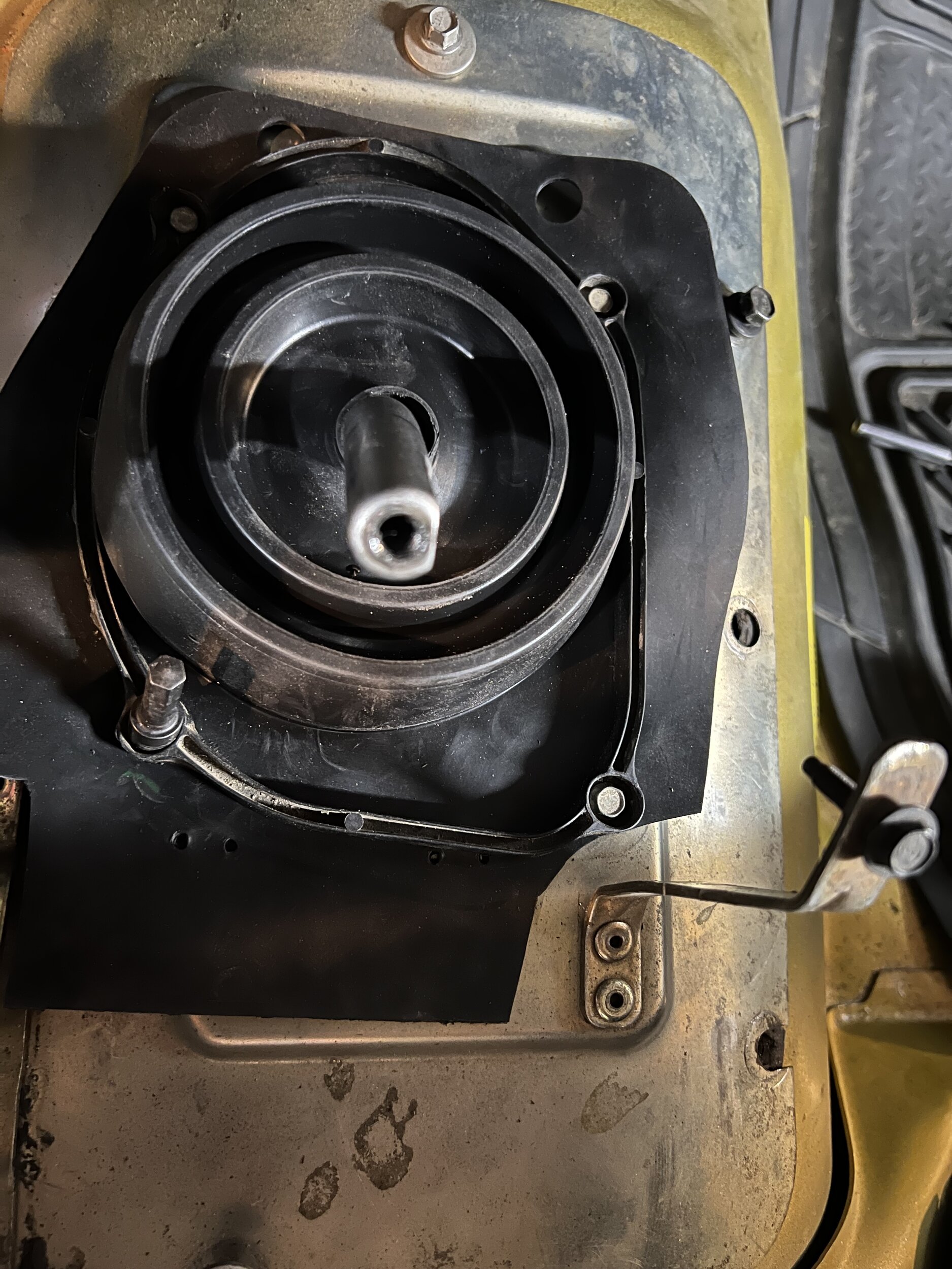

Low cost 2005-2006 inner shift boot replacement!
@Ptm

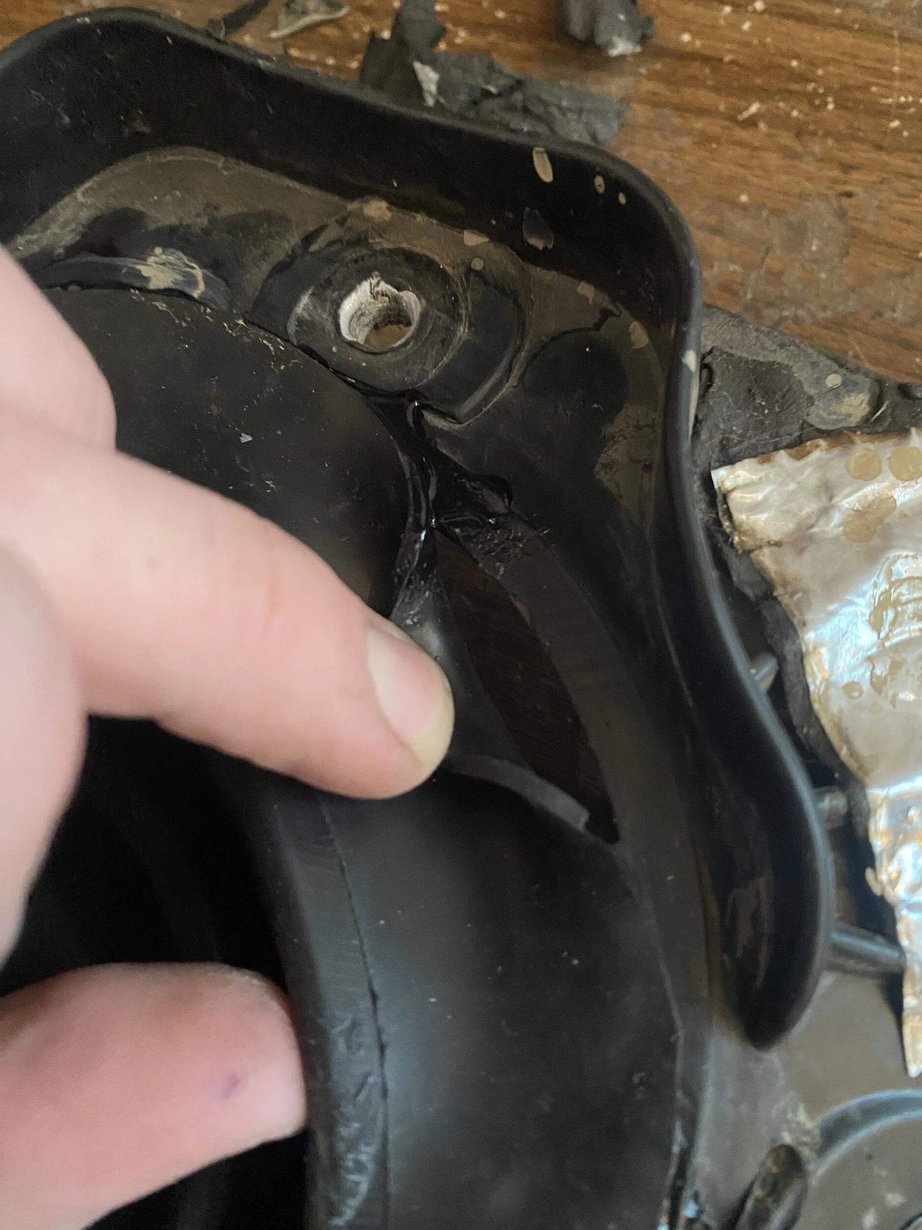

Thanks for this post! I did the same repair using the same boot. Only difference is I used Flex Seal rubber caulk which worked fantastic. The plastic “tower” where the console screw goes in was broken on mine so I plastic welded it up and drilled a new hole for the screw to go in. I have no idea how long it’ll last but it saved me $150+ on a new one. I’ll probably need a new boot later but for now, this is working perfectly.
Thanks for the idea!!

I glued mine together, but it started coming apart after a year. So I added four small screws to hold the rubber pieces together, and re-glued it. I think it will last much longer now.

Great idea! I just did it myself and saved $200 by using the same boot you did! The only thing I did different is attach the new boot to the bottom.

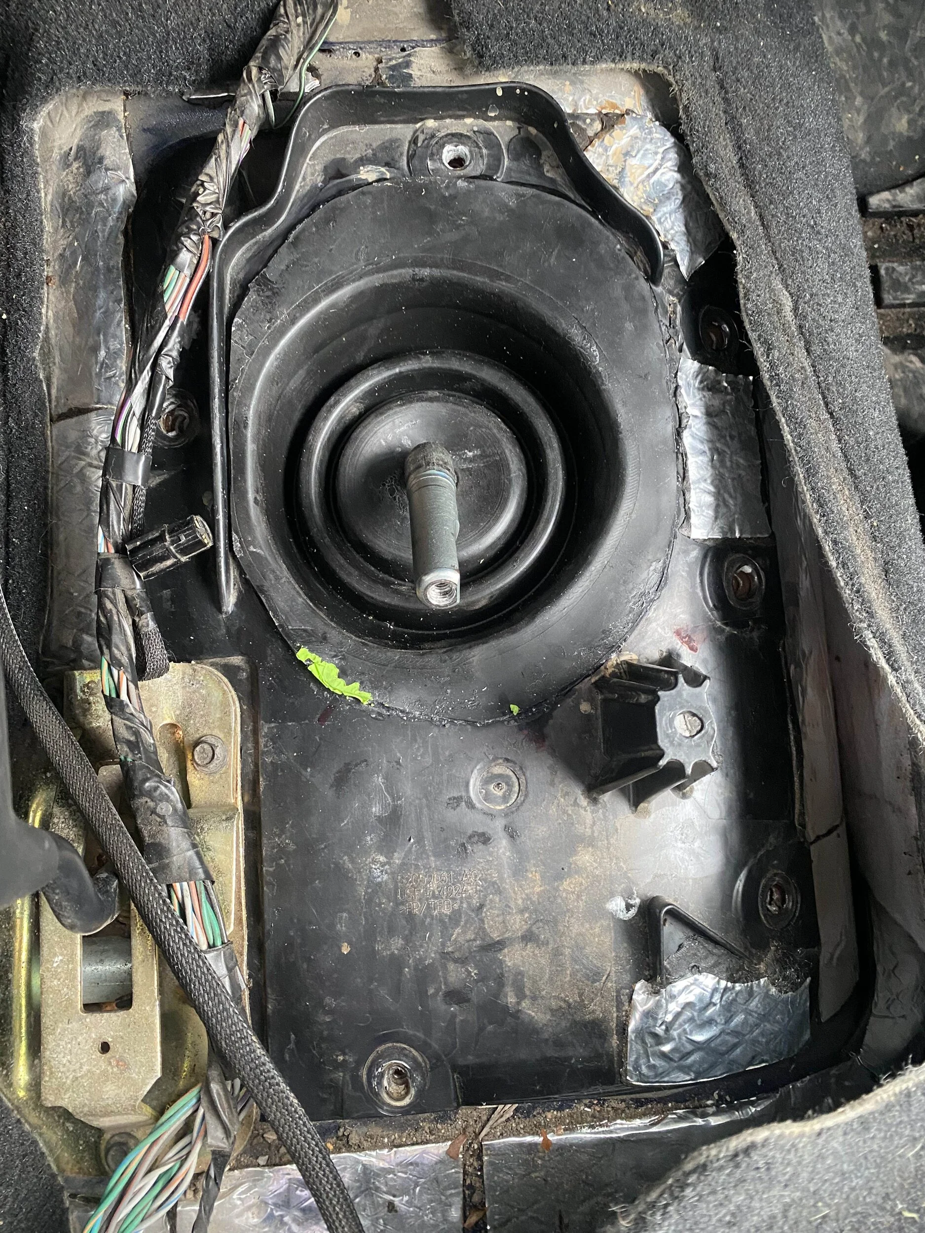

The lower boot covers the hole in the tub that allows the manual shifter to go into the transmission. Above that are all parts related to the console including the decorative and functional upper shift boot. If the heat is already in the cab due to a torn lower shift boot there’s nothing to really stop it.

A couple of thing I did differently;
- flip the gasket so it didn't get in the way of the shifter
- used CA glue (or rubber cement) to just adhere the new gasket to the old cut off one

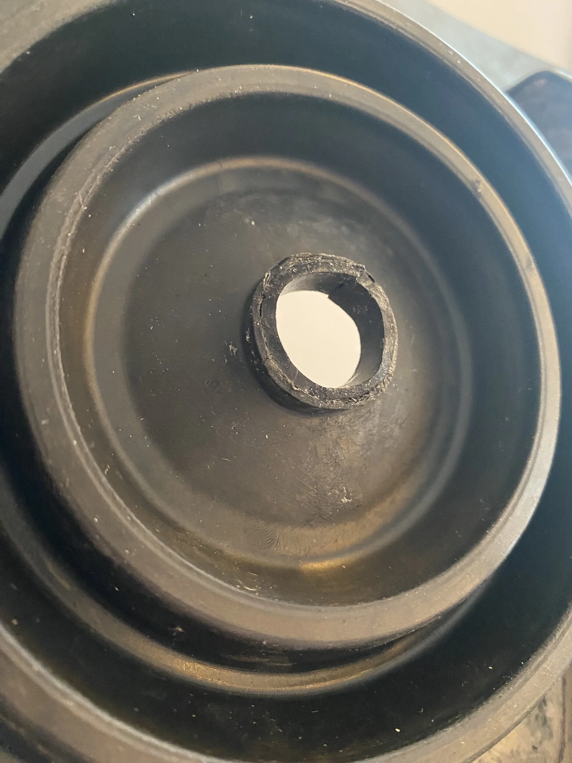

- used some excess gasket to glue a piece into the inner circle where the shifter goes through, this gave it a perfect fit
