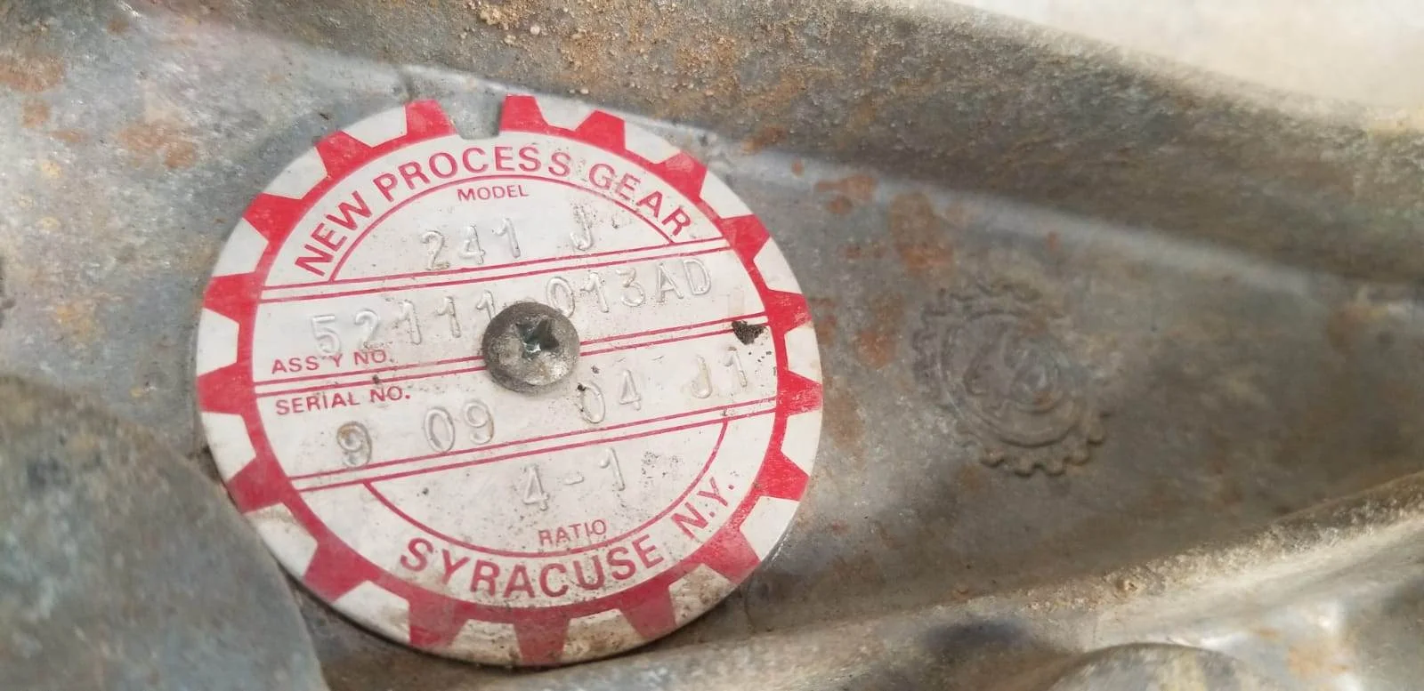

The other option is the 4.3:1 Atlas. I've run both the 241OR and Atlas. I prefer the Atlas because you can run the rig in 2wd low, which I actually use quite a bit
AND you can use the higher transmission gears in low range, making it NOT "useless for anything except rock crawling."
