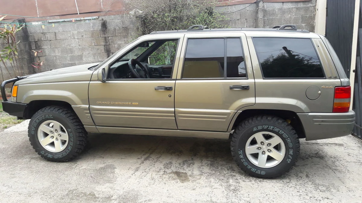

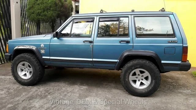

Really happy with the MR1X in my XJ.
My Dad's ZJ has Moab and both models has mud and rocks signals (some minor notches)
The offset of Mamba 0mm and the Moab 12.7mm are better that other oem wheels of 25.4mm.
Our trails are recreational and familiar kind.
Both with front Eaton Detroit Trutreac, Xj rear Truetrac and ZJ rear brand new Trac-Lok.
ZJ is better equipped with ARB bullbar and Warn VR8000 which.
Basicly, the decision was: I like but my XJ has 15" MT. And the ZJ had golden 16" wheels. So we decided to keep the actual tire diameter size.
In Costa Rica you have to import them, the used wheel stock is very limited.
Regards.
