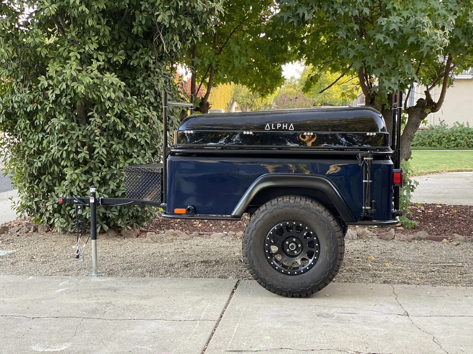

A couple up photos, the tent will actually be about 4” lower than this when camping but here’s max height. I will be raising the suspension on the the trailer 2” so I have enough suspension travel.
Thanks again to Blaine for the great idea for the rack it seems like it going to work perfect.

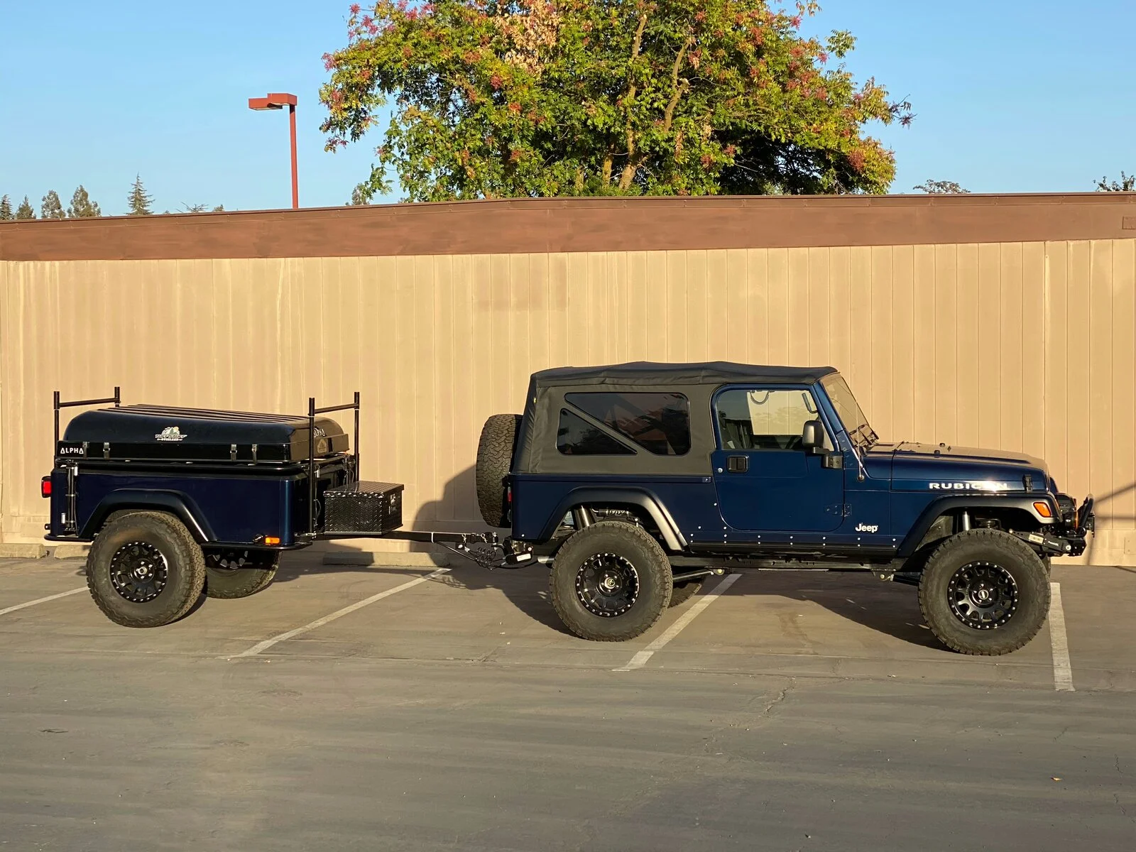

IT’S ALIVE!!!
First successful test tow of the trailer. It towed great, I really like that I can see around it with the stock mirrors, and something I didn’t expect is I can even see over it in the rear view mirror unless a small car is directly behind me I can see that they are there.
Still some misc wiring to finish and and things to bolt down in the tongue box plus some camping and rock lights etc. but I should be able to take it to DMV next week and get it registered.
One of the cool things about the way Blaine did the receiver is I can use any receiver designed for the Jeep stock, so I swapped out the square for round for aesthetic reasons, it only took about 5 minutes to out on.
I also lifted the trailer 2” and install bump stops to keep the tires out of the flares.

It feels very light behind the Jeep. It has no trouble towing it or stopping, I can barely tell it’s back there. My last trailer was very heavy on the Jeep.
Anyone have any idea what kind of tire pressure I should be running on the trailer on the street, with tires this big? I still need to weight it.
I run the same pressures as the Jeep. 28 lbs. loaded, 26 lbs. empty. Towed mine to Lake Tahoe and back with no issues. Interested to know what yours weighs with the tent on it and all.

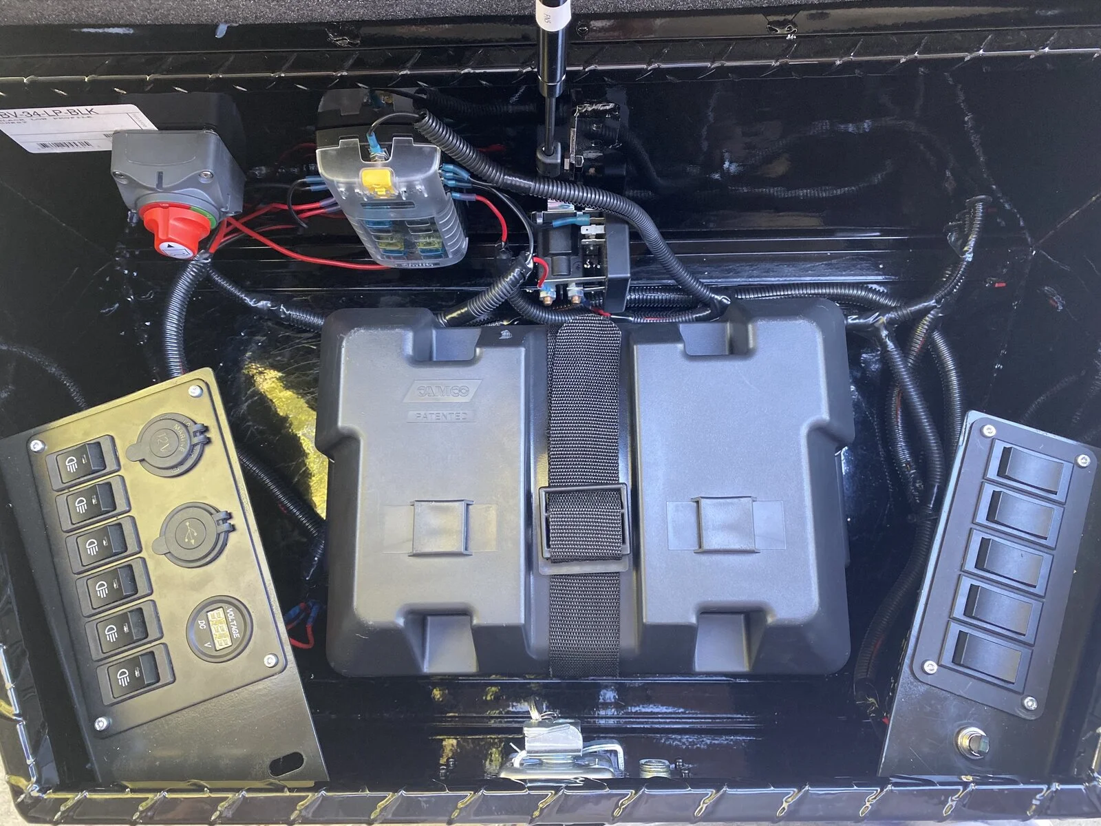

I also finished up the wiring in the tongue box today.
I still have to wire up accessories lights and will be changing out my switches in the right for the one Blaine linked so I can have one button that makes them all go up and down.
