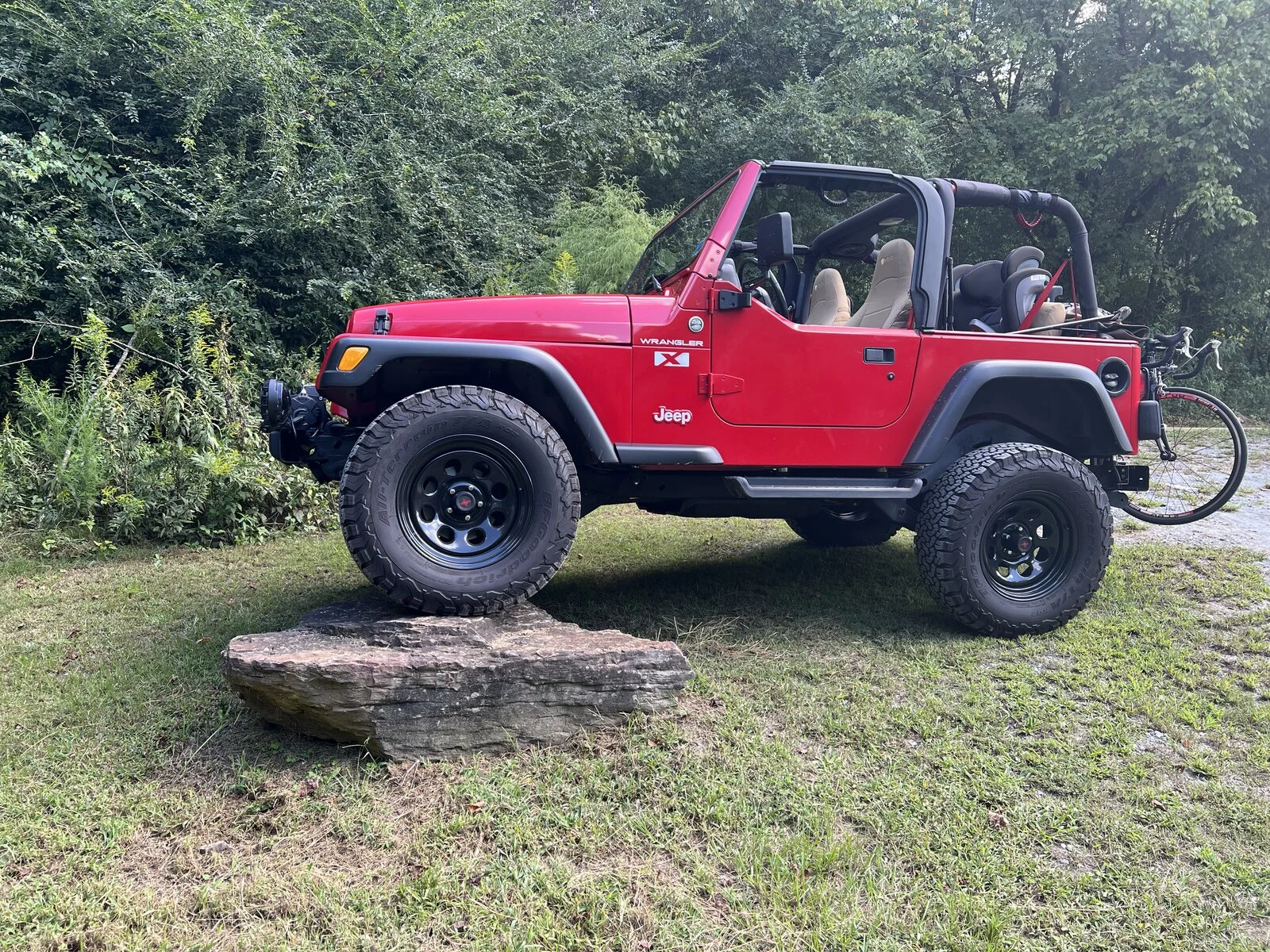

~2in suspension, 1in body, MML. No SYE, no adjustable track bar. 17x33s
