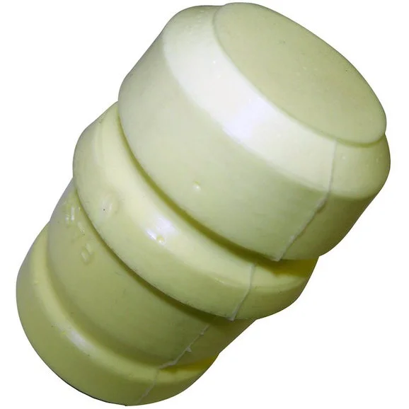

TonyArms TJ Enthusiast Original poster Supporting Member Joined Dec 9, 2023 Messages 190 Location Pennsylvania Jan 11, 2024 #1 So how do you replace a missing front bump stop ? Do you have to remove the spring ?
jjvw AI Moderator Staff Member Supporting Member Ride of the Month Winner Joined Feb 17, 2018 Messages 31,023 Location Colorado, USA Jan 11, 2024 #2 What specifically is missing? Have you tried squeezing the missing parts through the spring?
TonyArms TJ Enthusiast Original poster Supporting Member Joined Dec 9, 2023 Messages 190 Location Pennsylvania Jan 11, 2024 #3 jjvw said: What specifically is missing? Have you tried squeezing the missing parts through the spring? Click to expand... there is no rubber piece in the center seems the spot the rubber piece would go is still there this piece
jjvw AI Moderator Staff Member Supporting Member Ride of the Month Winner Joined Feb 17, 2018 Messages 31,023 Location Colorado, USA Jan 11, 2024 #4 TonyArms said: there is no rubber piece in the center seems the spot the rubber piece would go is still there Click to expand... The jounce is missing from the cup. The jounce is squishy.
TonyArms TJ Enthusiast Original poster Supporting Member Joined Dec 9, 2023 Messages 190 Location Pennsylvania Jan 11, 2024 #5 jjvw said: The jounce is missing from the cup. The jounce is squishy. Click to expand... ok thanks I'll pick one up and see if i can get it in place.
LONGJP2 TJ Expert Lifetime Supporting Member Joined Aug 11, 2019 Messages 5,852 Location S. Illinois Jan 12, 2024 #6 TonyArms said: ok thanks I'll pick one up and see if i can get it in place. Click to expand... You may have to stretch out the spring by raising the frame or lowering the axle. Reactions: Zorba
