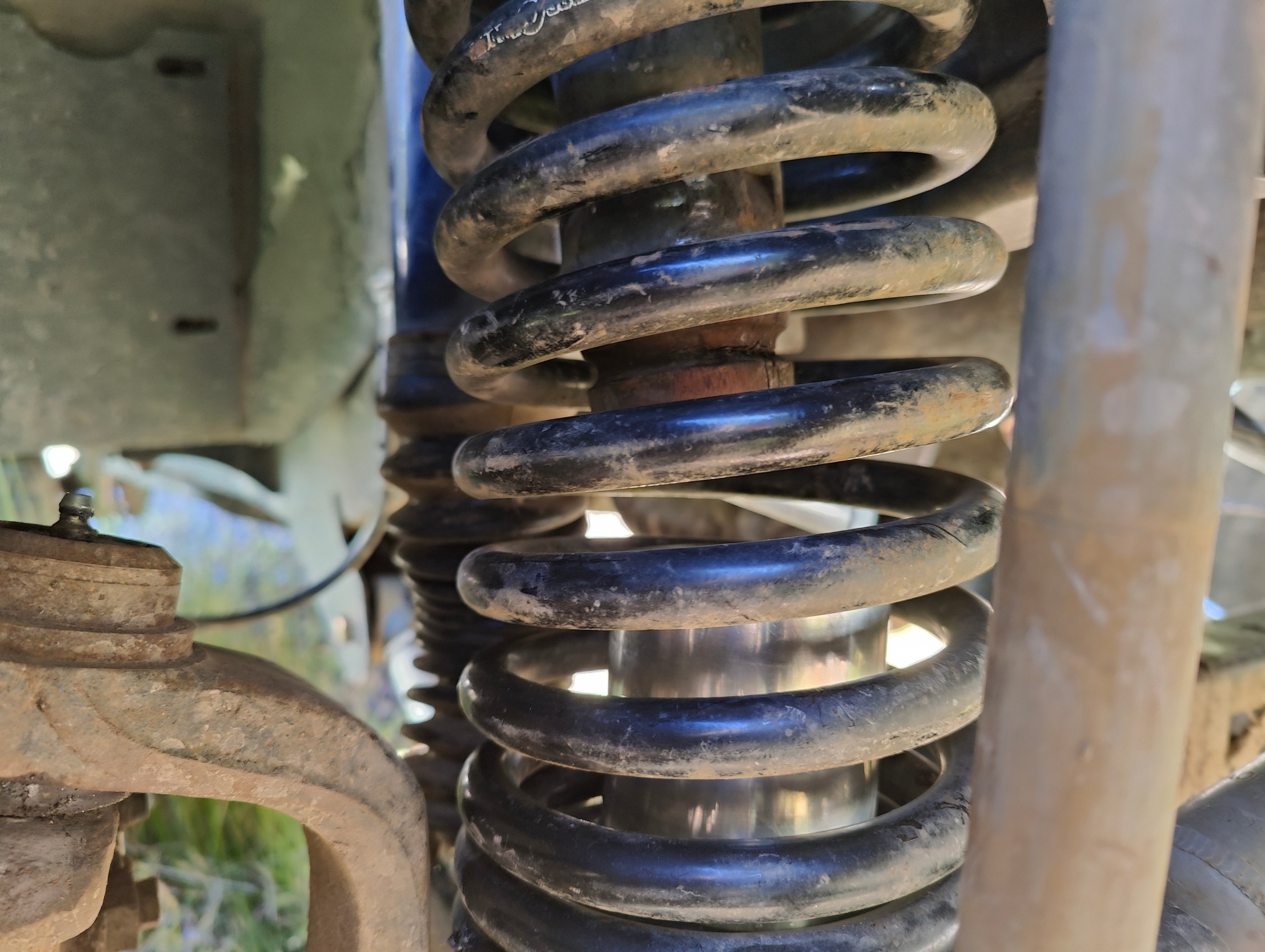

Since it’s mentioned sometimes splitting the extensions to the top and bottom for the front, I just want to know what is the max spacer thickness can go on the top of the jounce cup without getting caught in the springs during the bump? Can 3/4” or 1” spacer be added safely to the top?
IIRC, at one time I had 2 inches on top.
One of them was rubbing slightly, so I ground down the outer edge of the cup.
