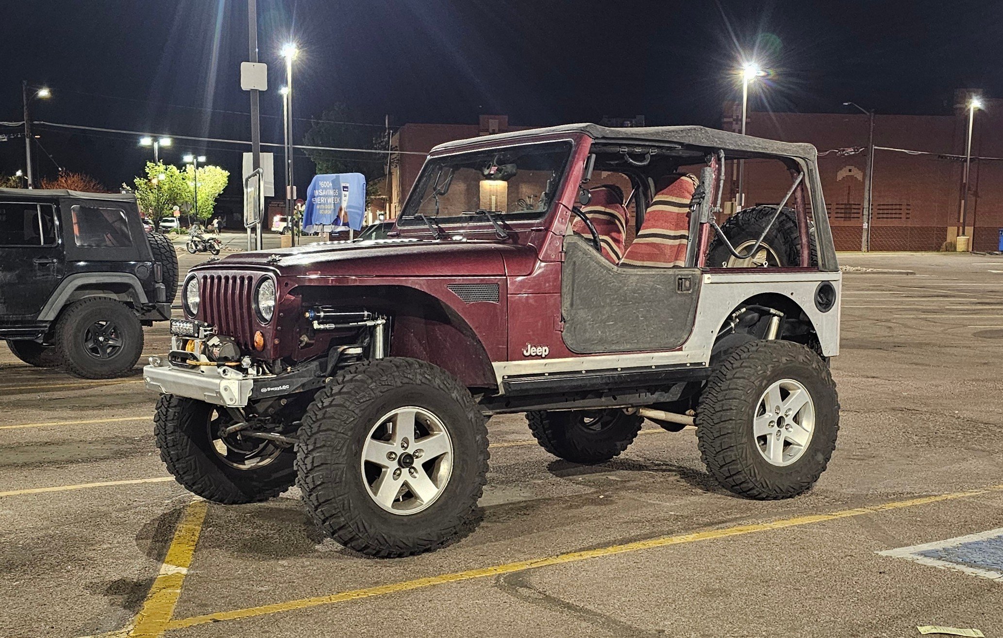

I have the poly towers with 12” shocks, the point of hard contact for me was the drivers axle coil bucket. With that much uptravel the trackbar swings the axle to the passenger side causing the interference with the DS coil bucket.

I have modified 12s up front. I did it without cutting the factory inner fenders, but it did require quite a bit of hammering sheet metal and trimming the tops of the poly towers. 11s are much easier to fit.

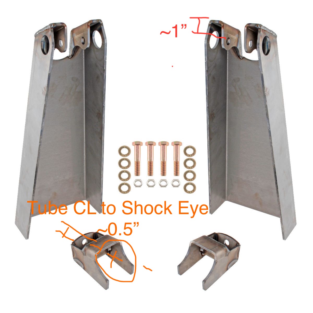

Thats what I was trying to find out where the towers end up from the frame or some other reference point. I cannot find any measurements on how far these can go up into the fender well compared to the stock mount. Looking only at pictures without parts on hand it looks like it could raise it 1.5-2” and the lower mount looks like it drops 1” so if those estimates are close I can get an 11” with near 50/50bias.

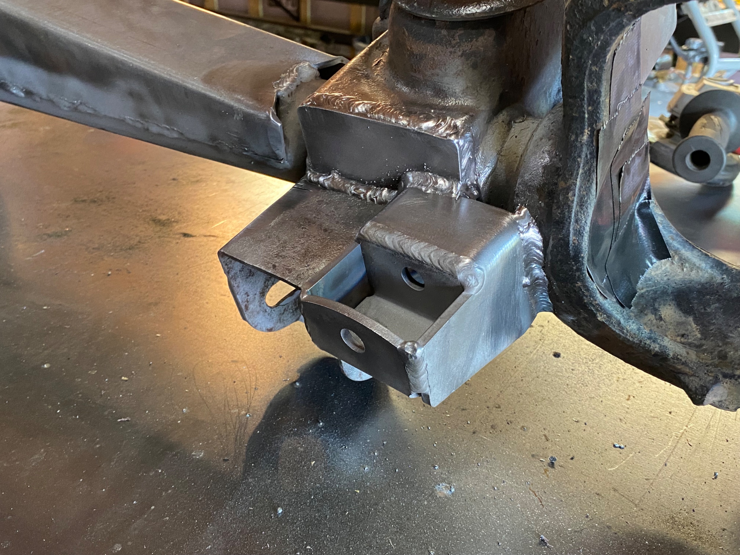

I'm not sure you'd be able to use poly's lower shock mounts in a coil sprung axle. Not sure if it was your intention.

On a normal F/R outboard with a 4"+1.25" lift, there is enough skirt left on the Poly towers to chop off a few inches of material.
A way to rough estimate the spacing of the shock mounts is to get the extended and compressed lengths of the desired shocks. With that, you know the compressed length and the half travel length between the proposed new upper and lower shock mounts. Cut those lengths out of cardboard strips and hold them up to the Jeep to see what goes where.
