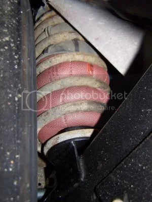

I know I shouldn't, but I can't stop myself. How does this even work? You just toss them in willy nilly in the coil and let them bounce around?
I guess you could use a combination of Tennis balls, racket balls, handballs and pickle balls until you get the compression resistance just right.
Do it right, do it once. A single football is adjustable.

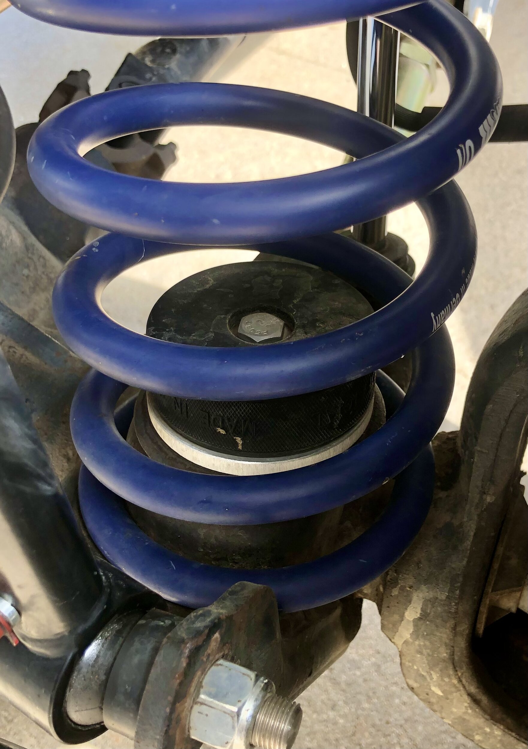

I've used hockey pucks, Don't glue them down, run a bolt through them with a large washer on top and then through the lower spring perch.
x2 for hockey pucks.
I counter sunk mine to bring the top of the bolt flush with the top of the puck. I actually needed just a bit more than the 1” the puck gave, so I cut some 3” dia disks out of some 1/4” aluminum stock to add to the bottom of the puck.
