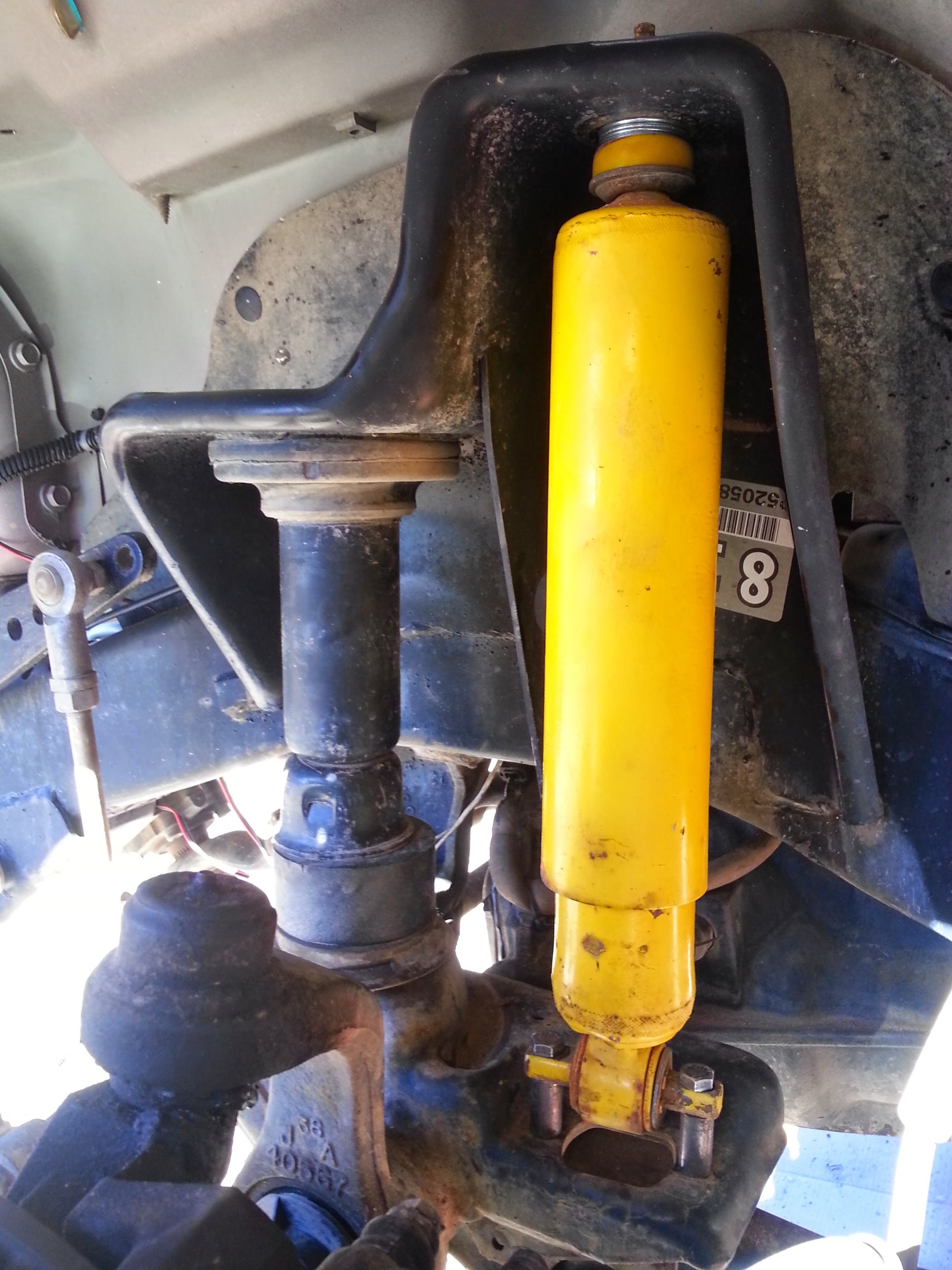

Since it’s mentioned sometimes splitting the extensions to the top and bottom for the front, I just want to know what is the max spacer thickness can go on the top of the jounce cup without getting caught in the springs during the bump? Can 3/4” or 1” spacer be added safely to the top?
I have a 1” space in the top
Reactions: AutoCrat
Thanks, as per my post #54 above, I may not even need bump stop extensions but just trying to be a bit cautious and thinking of adding 20mm (3/4”) spacers front and rear to be on the safe side. My driving is mostly on the street and some light gravel roads. Idea is to avoid drilling holes on the axle pad if I can.
Mine has a hole drilled in the bottom with about a 2 1/2-3” spacer with the 1” spacer up top. 35” tire, 11” shock, 4” spring lift and 1 1/4” body lift with stock fenders
