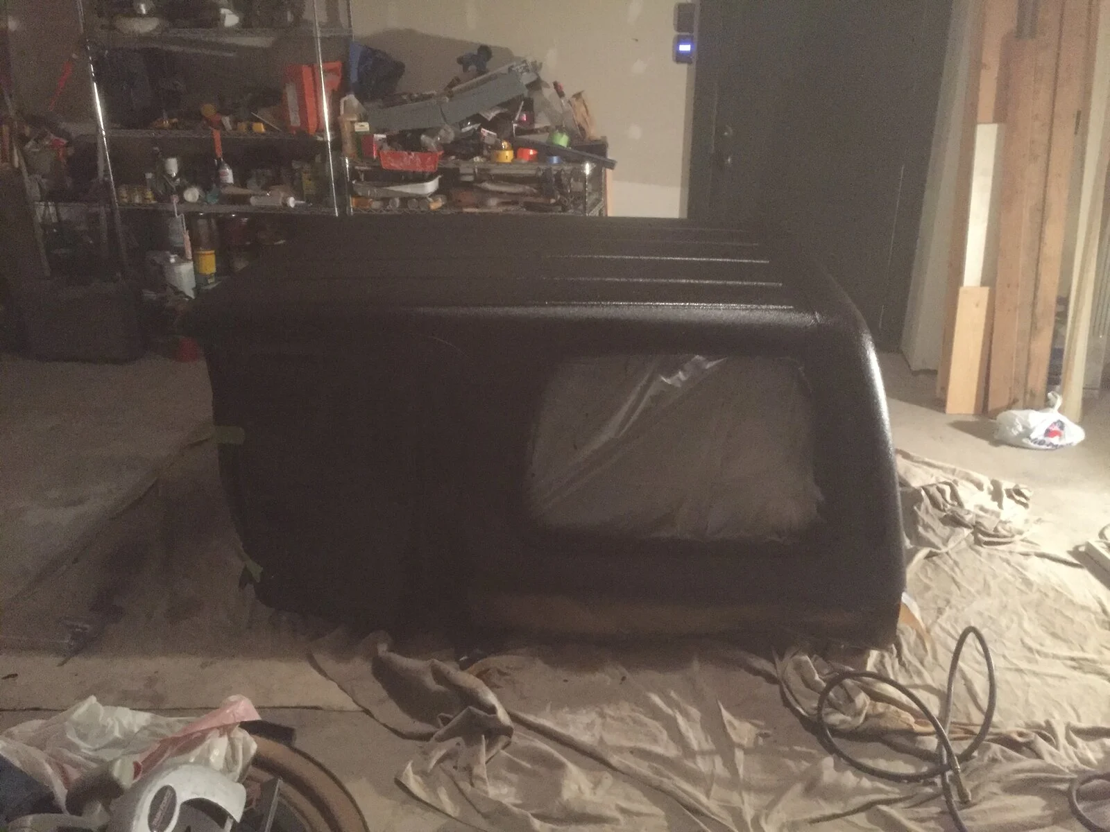

Pics on this post are after I removed the factory soft top and repaired a hard top I bought from a guy near Spokane. 500 bucks, top was in a light rollover, I repaired the fiberglass, Raptor lined the top (following all recommended procedures), and had the new window and seal that came with the top installed. This top came with a full interior carpet lining, and I absolutely LOVE it. Its quiet, Cool (temperature wise) and aesthetically, and it makes the Jeep interior really feel more like a finished car. 10 stars out of 5 for that. These pics also show the budget lift and move to 35" Coursair MXT's not bad tires. They do hold and throw rocks pretty bad. I have a set of RZR's on my toyota beater and those I love. I did a poor job getting the fenders and rails painted the first shot and rust found its way in quickly. I did not have the time on that go round to get a good job done, where I needed the vehicle to access a jobsite. I also had "experimented" a bit with the Raptor liners mix. Experimentation that on the first go round didn't go as intended but that I perfected in round 2. Also note the terrible surface rust on the hinges. Yes they were all that bad, No absolutely none of it is concerning all on the surface, but the frame, gas skid, cross members. All of it needed sanded and POR-15'd. I also had installed a set of JW speaker LED headlights by this point. Which are incredible and worth every penny. As you can also see I'm rocking a pretty sweet EAG bumper here. I also had beefed up my front steering with a drag link and tie rod from synergy and a fox 2.0 stabilizer to match the shocks. new shocks for the hardtop were installed also. That was pretty much where I started. Next post we'll get into tear down and paint prep.
