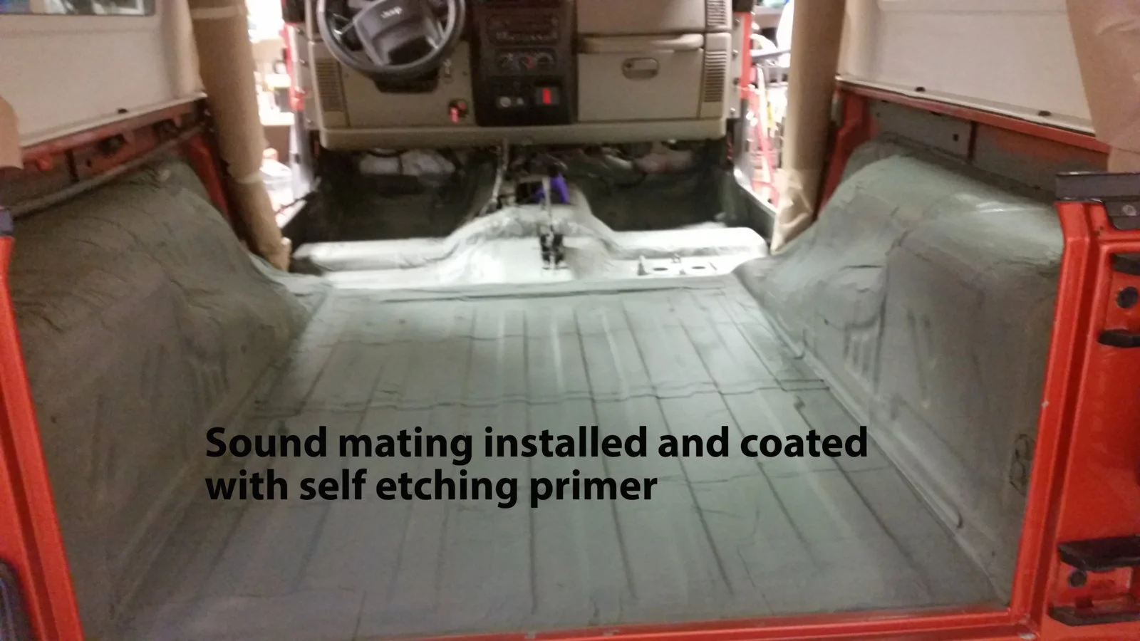

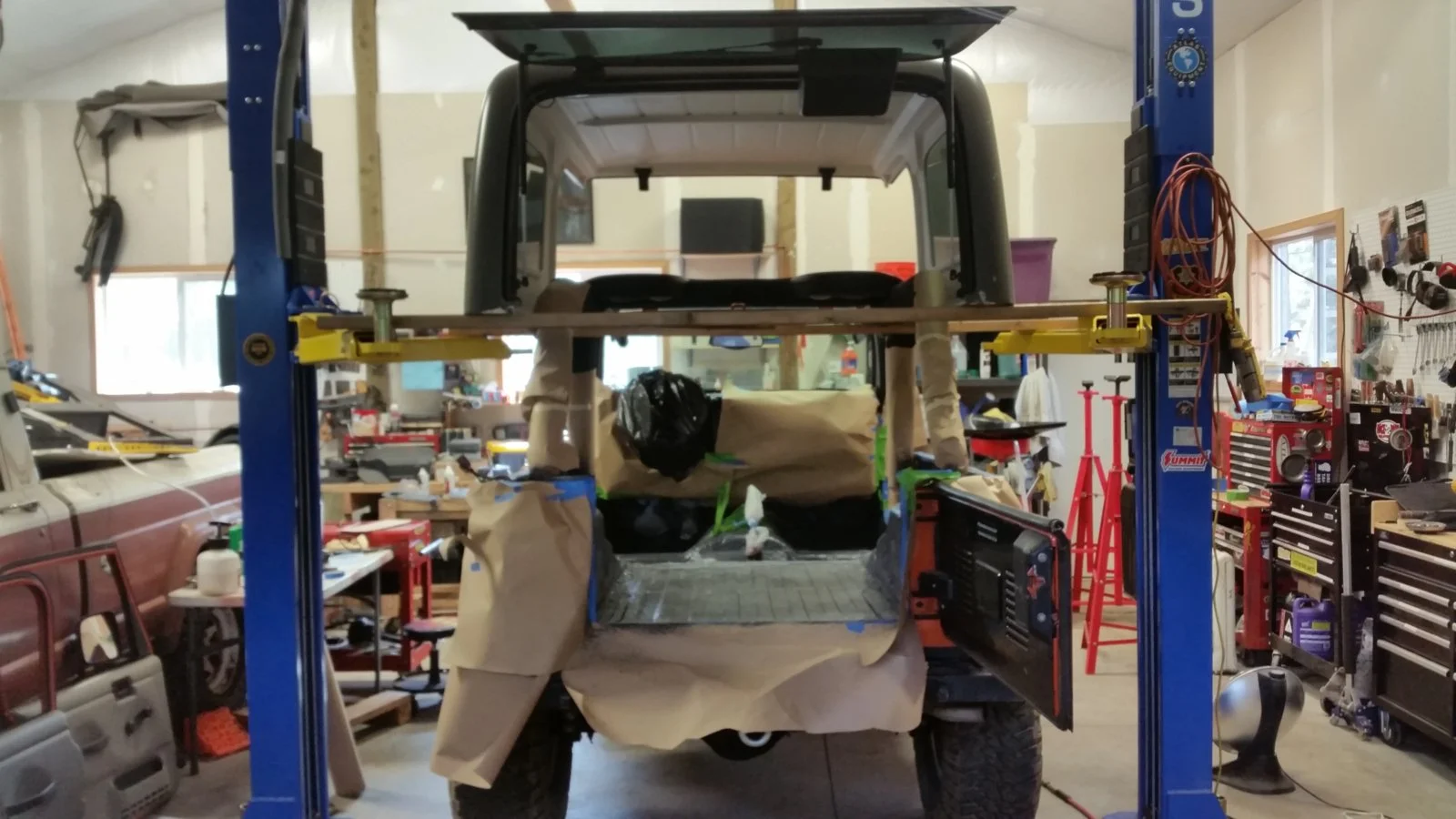

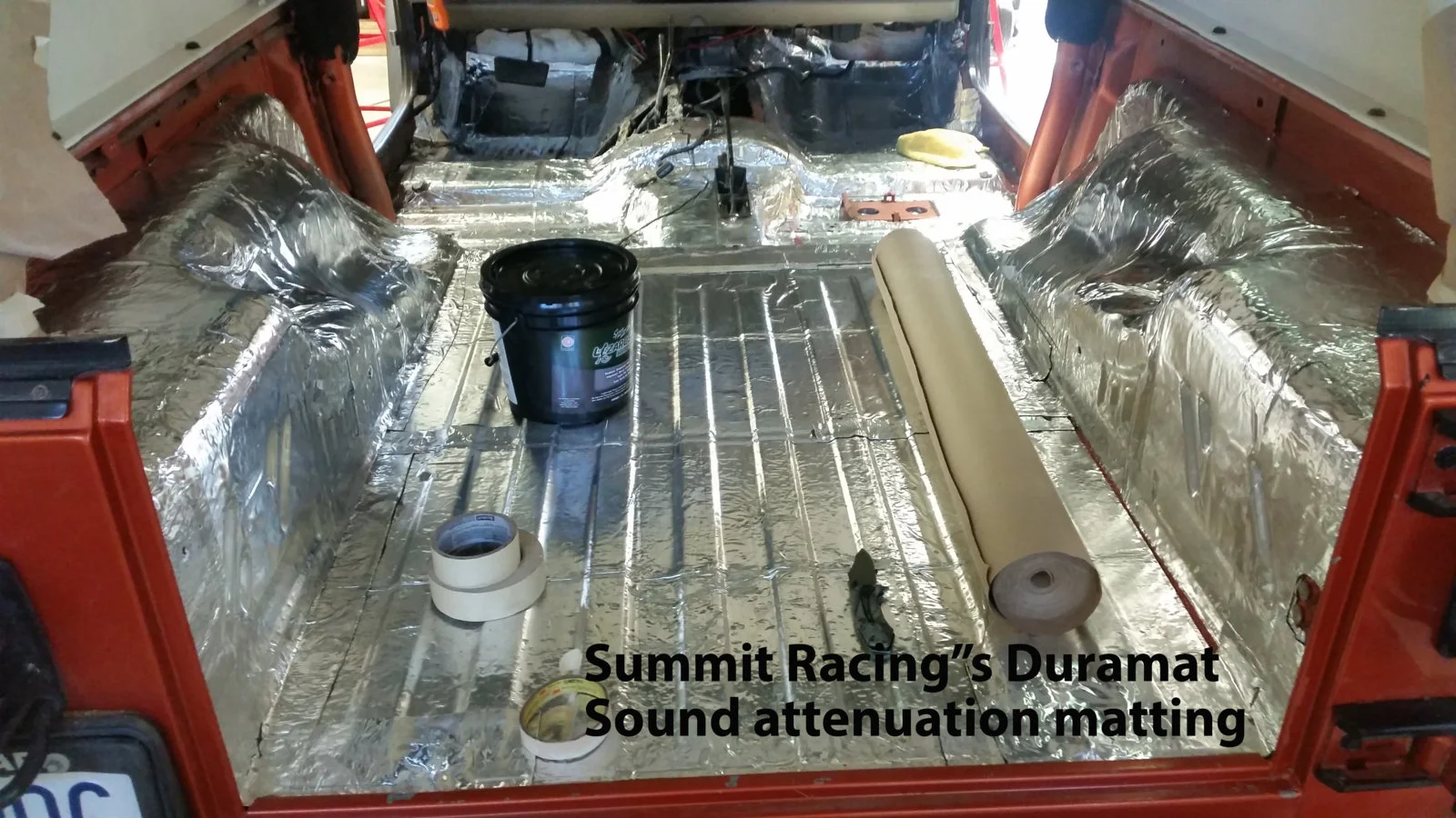

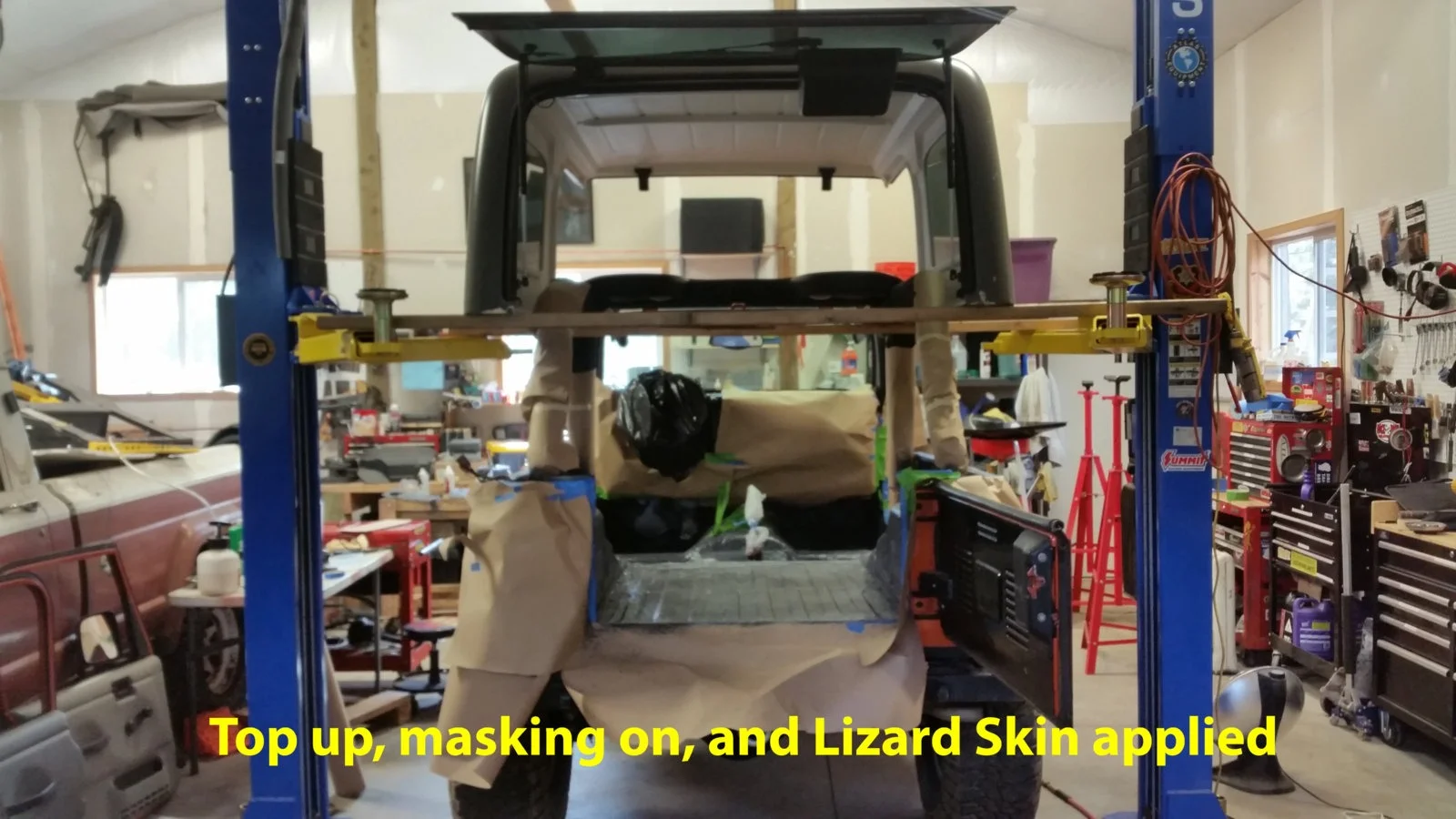

You'll have to let us know how much of a difference that sound deadening makes on the highway and long trips.
Chris I can already tell you the matting makes a 100 % difference. I have driven Stinger over to the big city of Redmond serval times with various stages of the matting installed. each time got better. Be really interesting to see what the Lizard Skin does. I only sprayed the sound control not the ceramic heat. But it already had a layer of each on there covered with color and clear coat
