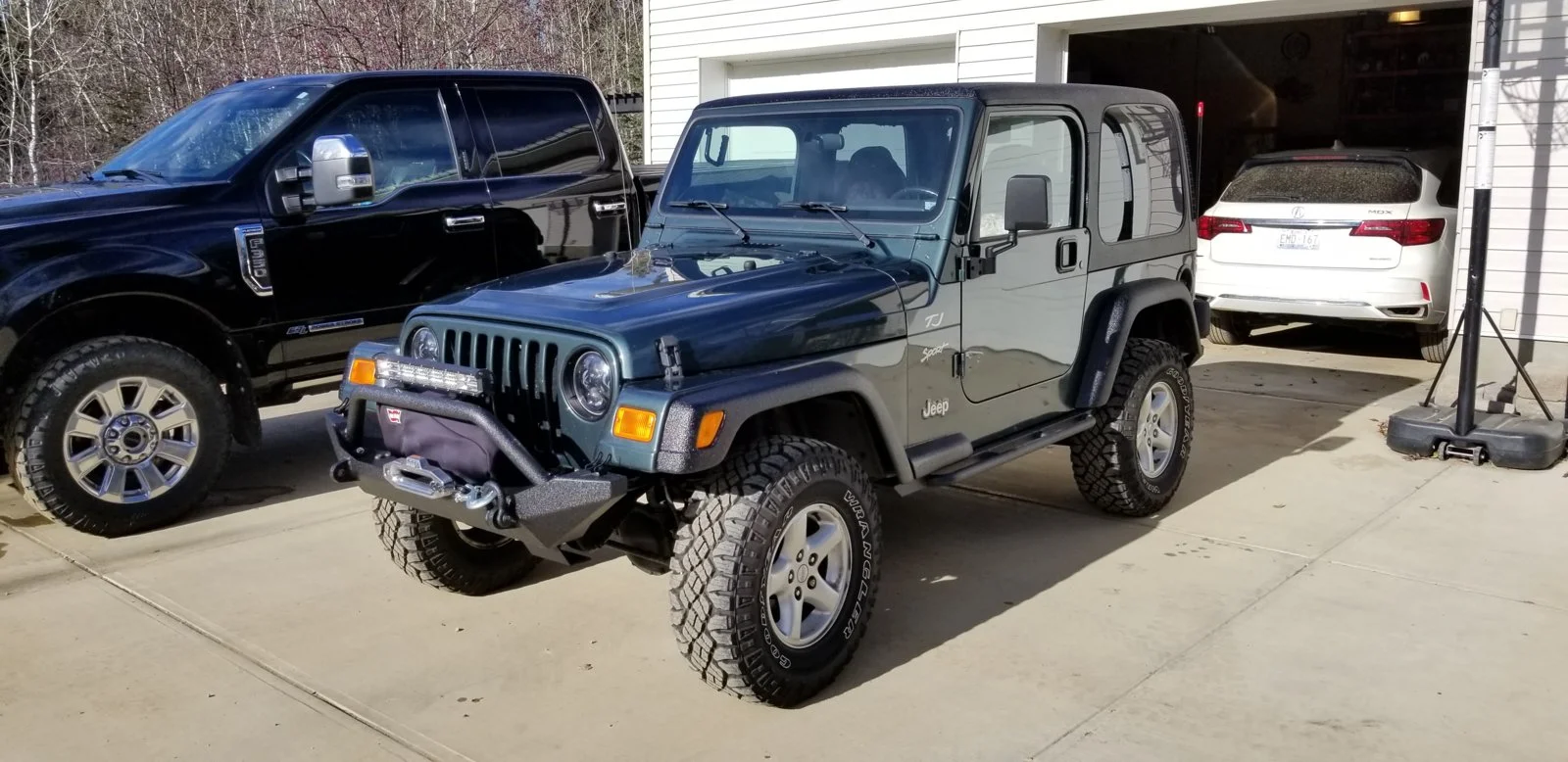

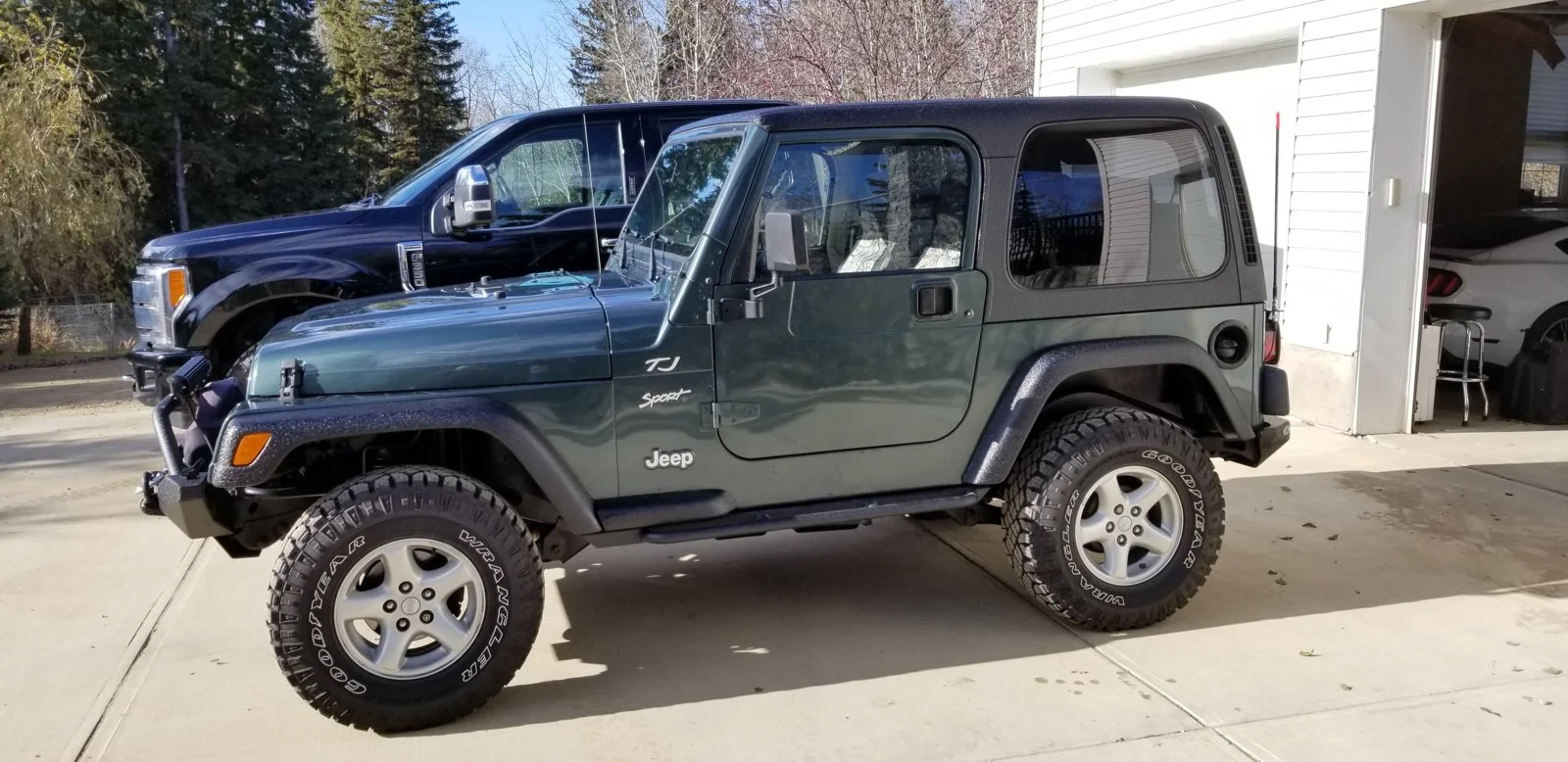

Hey, I know it's been months since I started this thread, but I've finished most of what I set out to do. Have the OME lift in, winch, bumpers, bedliner'd the hard top and fender flares, tires, tinted the rear windows etc. I even got my first deer with it yesterday with my little girl. My son and I have completed most of the projects together and that was what I was really after. it's been a lot of fun. I will have to read how to tune my CB radio as I don't think it is working properly yet. I did the TC drop when i did the lift but I still have some slight vibrations when taking off so I will likely still do the SYE. Or maybe the motor mounts.
The last thing is to re-gear and add e-lockers to the front and back but this will likely be next year... that's quite a pricey project.
After that, I've been thinking about looking for a jeep trailer that I can add a roof top tent to... there is certainly no end to the potential projects.
I would also like to try and make it to a jamboree next year.
Thanks to all for the immense knowledge base on this forum... i have learned so much.

Nice props! It looks real
Damn, that turned out great!
You'll really like it even more once you get it re-geared!
Ya it is a bit of a dog on the highway now... 3.07 gears... unreal.
Still debating lockers front and rear... not sure I need them but when you are doing gears it's the time to do it. I am pretty sure I will only ever really do trail riding and I'm not too interested in mudding or rock climbing... but don't really want to open the diff's up again. If only they weren't so much money.
That is a good looking jeep. I like the way it sits on the 31s, bedliner on the top and flares looks good as do the bumpers.
I just bought mine, and I'm debating on lifting to clear the 33's its came with or stepping down to 31's. I'm thinking I might go down to 31's.
